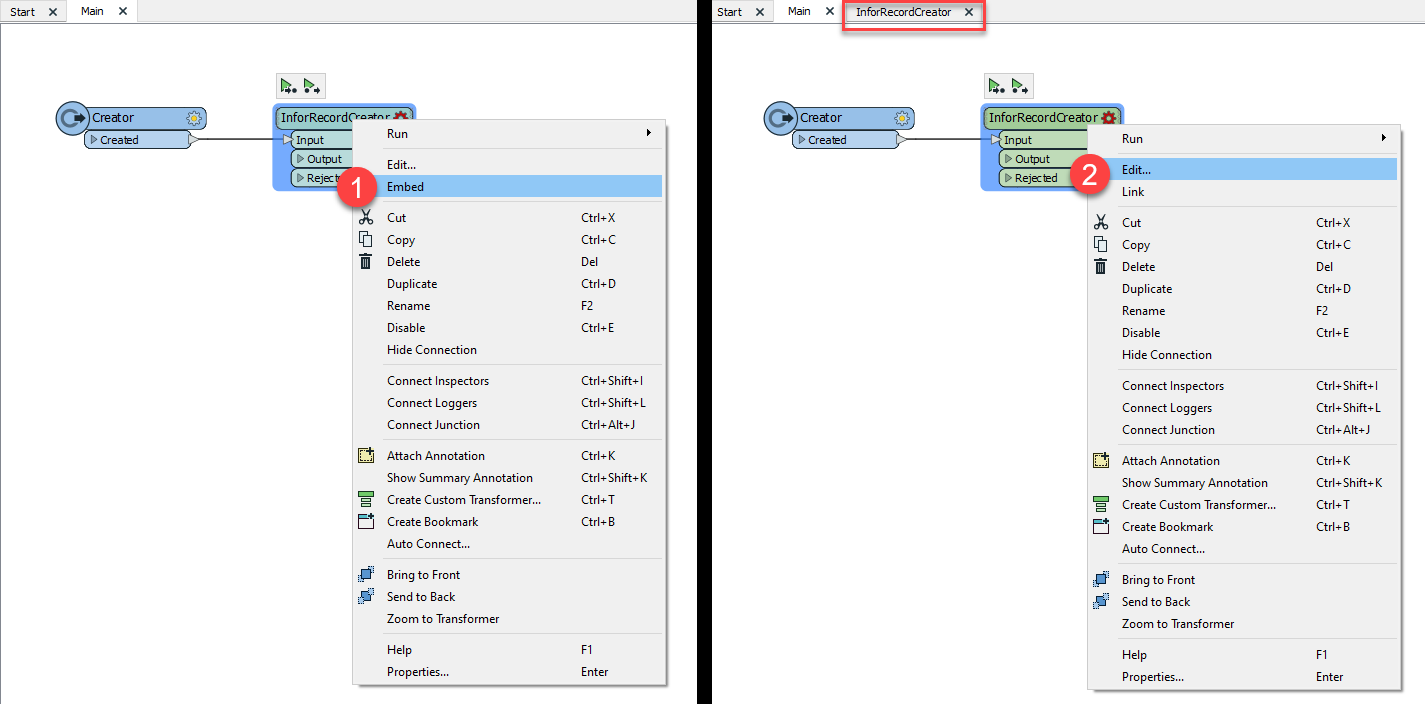

1. Right-click on the Hub Transformer and select Embed to embed the transformer into your workspace
2. Right-click on the embedded transformer and edit to enter the custom transformer tab

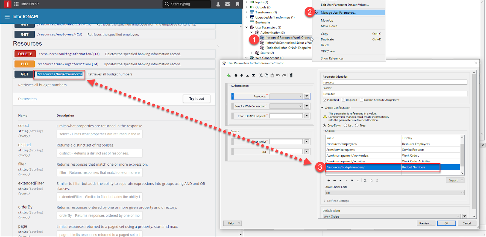

3. In the custom transformer, expand the User Parameters > Authentication section, right-click on the [resource] parameter, and select Manage User Parameters.
4. Expand the Choice Configuration section and add a new line to the Choices
Refer to the Infor Public Sector API documentation for the operation (i.e. /crm/servicerequests
5. Click OK to accept the changes and return to the Main tab to edit parameter values, run the workspace etc.
