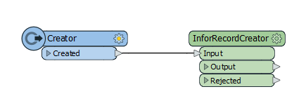

Starting from a blank workspace, add both a Creator and InforRecordCreator transformer to the canvas.

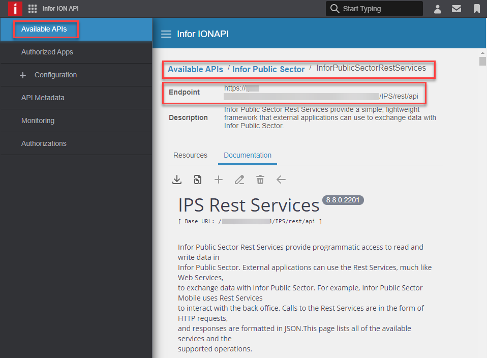

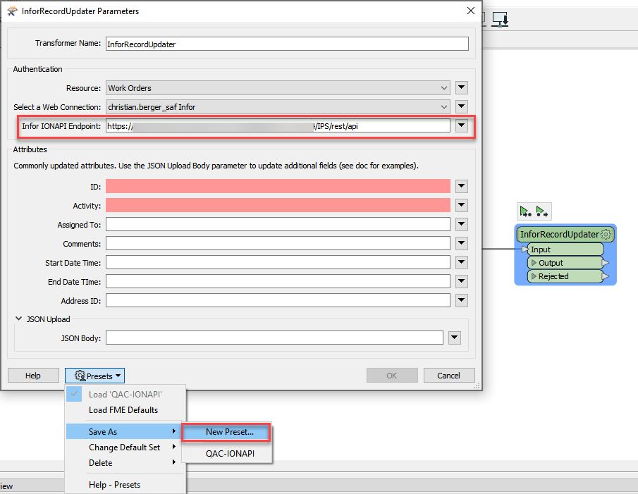

3. Add Infor IONAPI Endpoint
Add your Infor IONAPI Endpoint,  available in the Infor ION API documentation at the top of the page of the Infor
app. See the image below.
Bonus tip:
Save your IONAPI Endpoint and/or Web Connection settings as a default. You can also set this as the default parameters or easily reset using the presets drop-down menu.

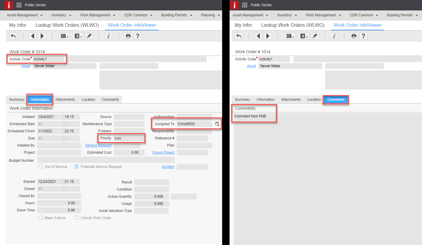

Updating an existing record using hardcoded values

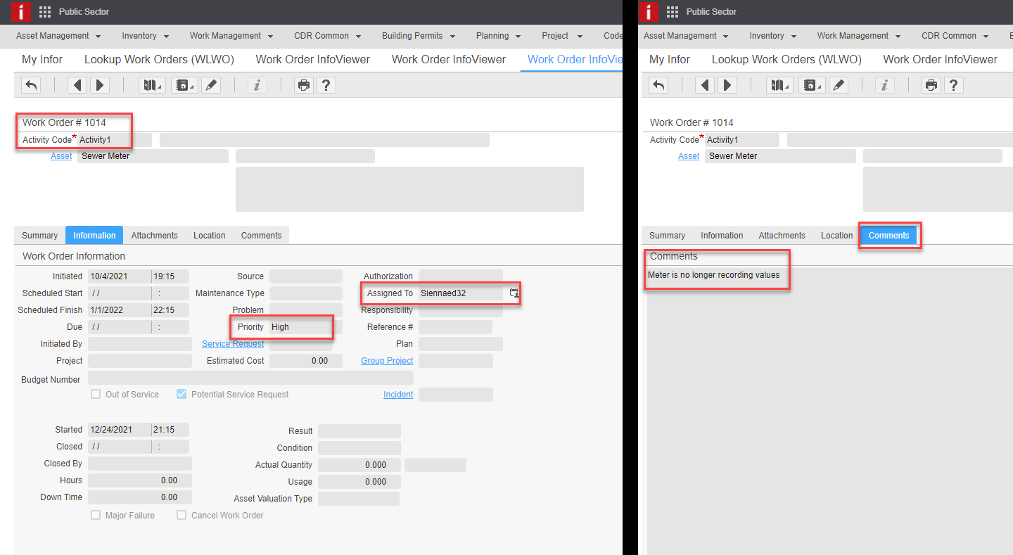

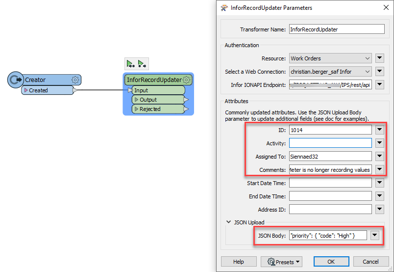

In this scenario, we will update the Assigned To, Comments, and Priority of an Infor Public Sector Work Order. In the InforRecordUpdater, set the ID parameter to the ID of the record you’d like to update (i.e., 1014). Similarly, set values for the AssignedTo (user ID in Infor) and Comment parameters.
In the JSON Body, since we will be updating the priority code, we will need to format the JSON as an array with a key-value pair. Set the value to:
"priority": { "code": "High" }

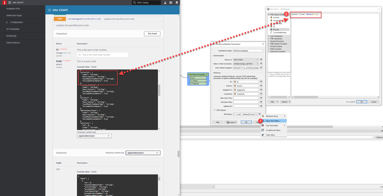

As demonstrated in this screenshot, reviewing the API documentation will provide you with the exact JSON formatting. It’s easy to copy and paste the JSON from the API and replace the “string” with the actual attribute value in the text editor. If you need to format a large number of attributes, consider using the JSONTemplater transformer.
