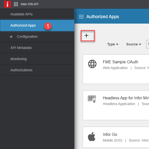

1. Add a new Authorized App in the Infor ION API
Access your Infor ION API dashboard and navigate to the Authorized Apps tab. On the Authorized Apps tab, add a new authorized app with the Web Application Type.

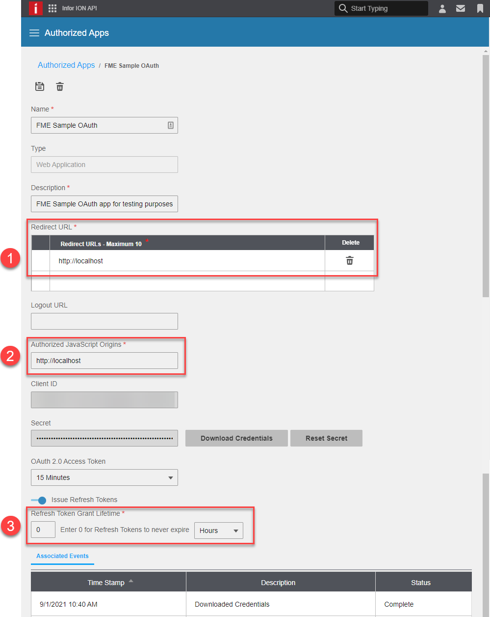

In the newly created Authorized Web App, set the Redirect URL and the Authorized JavaScript Origins to:
http://localhost
Lastly, set the Refresh Token Grant Lifetime to 0 (never expire)
Save the application settings and keep this page open, OR download the Credentials File.

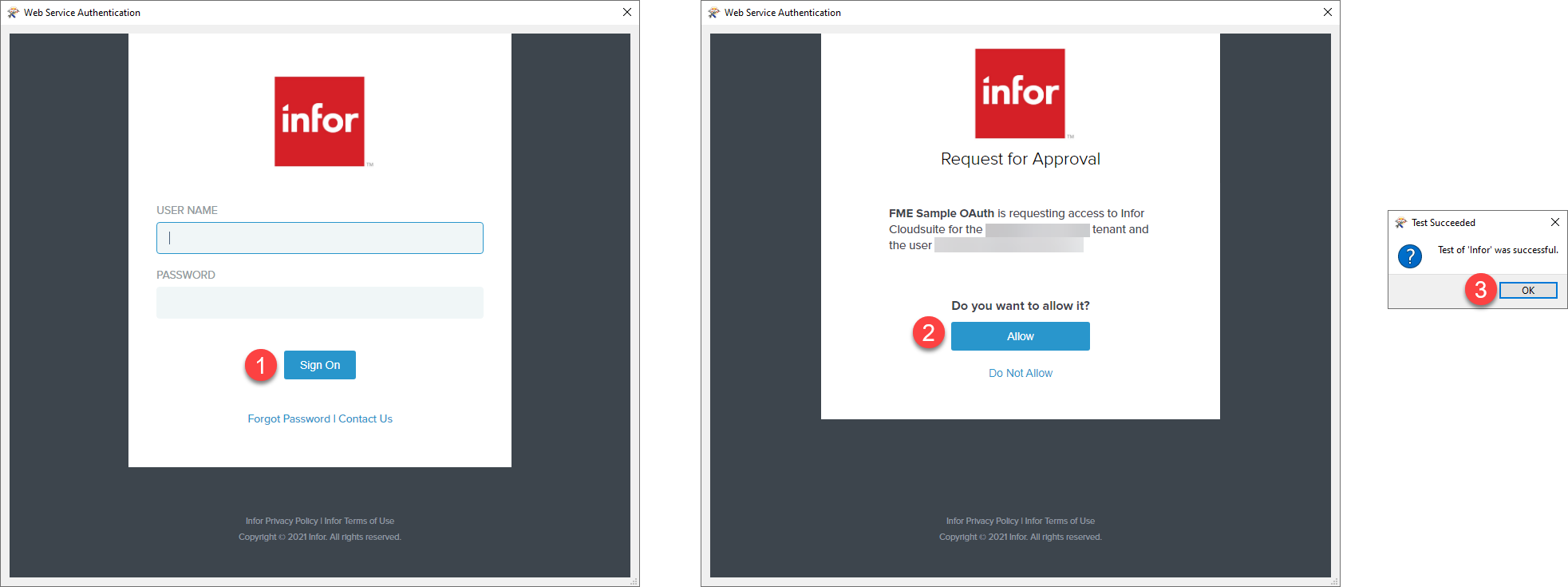

Once you have filled in the web service parameters, press the Test button to confirm that you can log in to the service. Once you sign in, click the Allow Request for Approval button and confirm the window closes with a Test Succeeded message.
If the window does not close, or if you are met with a blank white window, please confirm that you have your web service parameters filled out correctly and that your Infor Authorized app uses http:localhost as the redirect URI AND the Authorized Javascript Origins.
