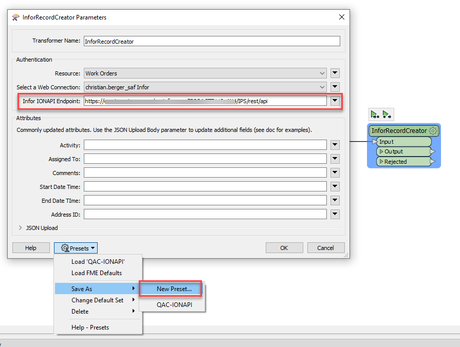

3. Add Infor IONAPI Endpoint
Add your Infor IONAPI Endpoint, available in the Infor ION API documentation at the top of the page of the Infor app. See below image.
Bonus tip:
Save your IONAPI Endpoint and/or Web Connection settings as a default. You can also set this as the default parameters or easily reset using the presets drop-down menu.

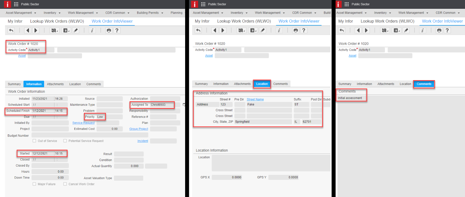

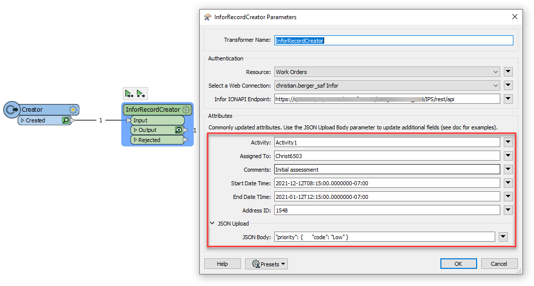

In this scenario, we will create a new record and set the Assigned To, Comments, and Priority of an Infor Public Sector Work Order. In the InforRecordCreator, set the Activity parameter (required & case sensitive), AssignedTo (user ID in Infor), Comment, Start Date, End Date, and Address ID (existing Address ID).
In the JSON Body, since we will be setting the priority code, we will need to format the JSON as an array with a key-value pair. Set the value to:
"priority": { "code": "High" }

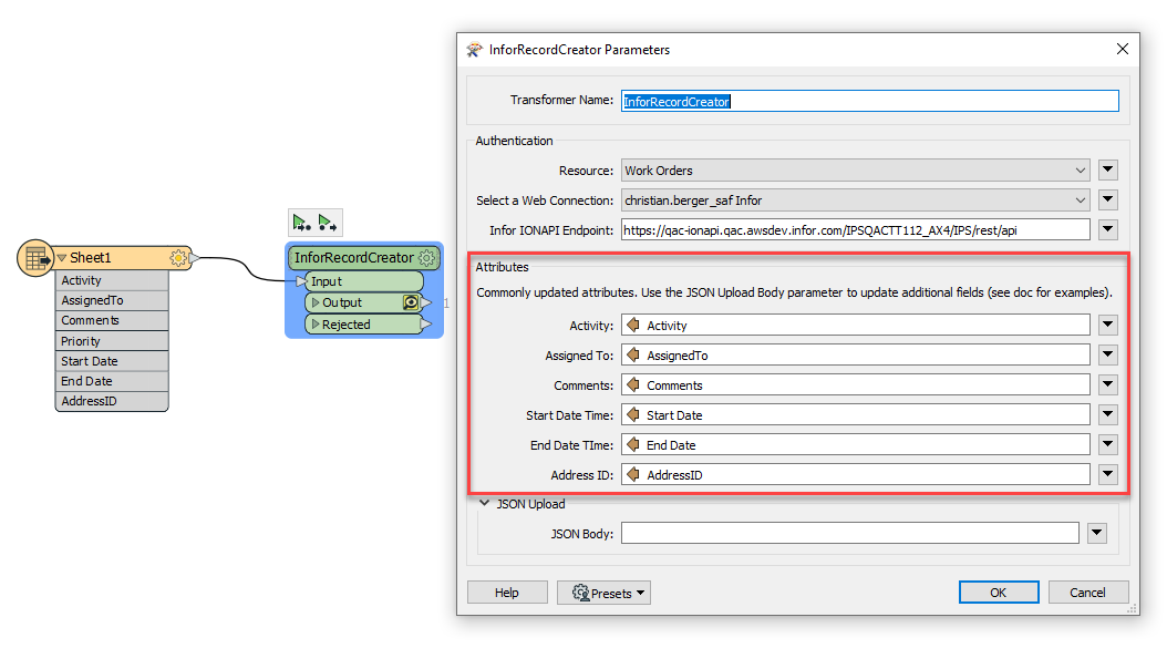

Example 2: Creating records using attribute values
In this scenario, we will create a new Infor Public Sector record using attribute values. In the InforRecordCreator, set the ID, Activity, Assigned To, Start Date, End Date, and comments to the attributes containing their respective attribute values. 4_Attributes_Mapped.png

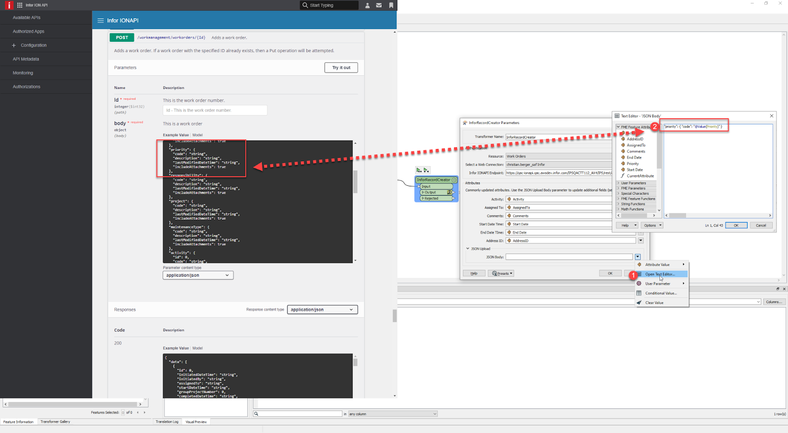

​​​​​​​As demonstrated in this screenshot, reviewing the API documentation will provide you with the exact JSON formatting. It’s easy to copy and paste the JSON from the API and replace the “string” with the actual attribute value in the text editor. If you need to format a large number of attributes, consider using the JSONTemplater transformer.
