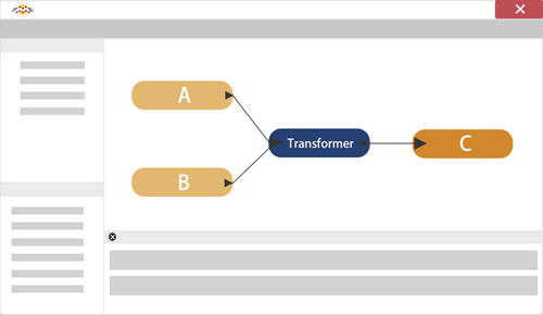

Merging or joining data together is different from connecting data streams in FME. When the data is merged, the attributes from each dataset are combined using a common identifier, and the resulting dataset is output as a single fused dataset. When the data streams are connected by drawing two connections to an input port of a transformer that isn’t a merging transformer, the data will be in a single stream, but the attributes will remain separate. For more information on combining data streams, see the Combining Multiple Streams of Data (Append vs. Merge or Join) article.

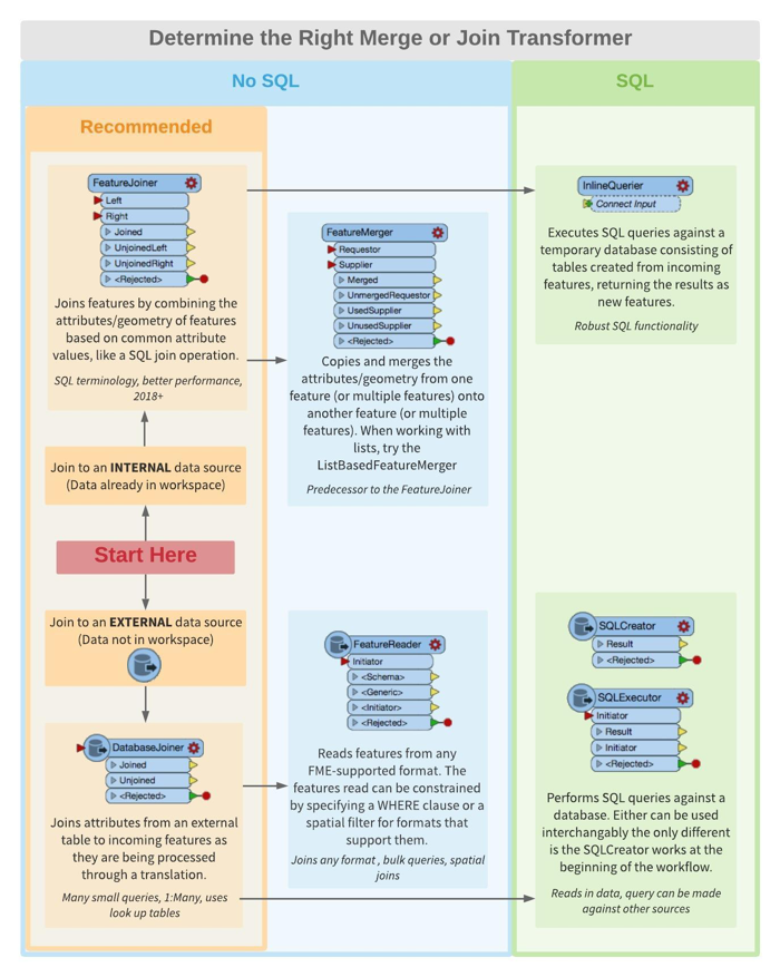

There are two main categories for merging or joining transformers, they are: SQL and no-SQL. The transformers that are in the SQL category require knowledge of SQL; these are the InlineQuerier, SQLCreator, and SQLExecutor. The no-SQL transformers have the same functionality as the SQL ones but can be set up easily without any database knowledge; these are the FeatureJoiner, FeatureMerger, FeatureReader, and DatabaseJoiner. This isn’t an exhaustive list; there are other transformers that allow data to be joined but are used for a specific task. For more information on these other transformers, see the documentation.
Now, when trying to decide which transformer is the correct one to use, follow the flowchart below to help. When trying to decide, inspect your data and ask the following questions:
1) Is all of my data already inside the workspace?
  • If yes: Follow the INTERNAL path
  • If no: Follow the EXTERNAL path
2) Does the FeatureJoiner for internal or DatabaseJoiner for external work for my data?
  • If yes: Great! End here
  • If no: Continue to question 3
3) Do I know or want to use SQL?
  • If yes: See the transformers in the green SQL box
  • If no: See the transformers in the blue No SQL box
4) Did any of those transformers work?
  • If yes: Great!
  • If no: Read the documentation to ensure that it was set up correctly and suits your needs
  • If unsure, re-read the documentation; if still unsure, ask a question in our community.
