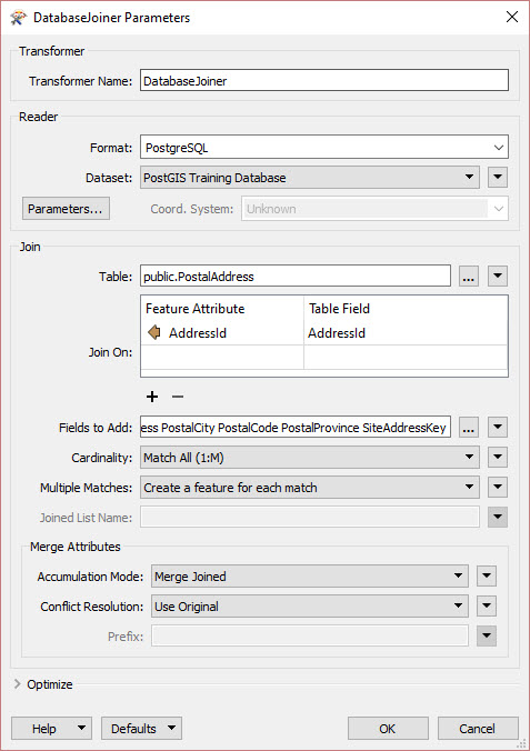

For example, a dataset of AddressPoints has an AddressId number, but no postal address. The DatabaseJoiner transformer is being used to join data from an address table onto the AddressPoints data. In this case the address point features are obtaining address data directly from an address table in a PostGIS database.
The parameters dialog for the DatabaseJoiner looks like this:
Again, AddressId is being used as the join key.

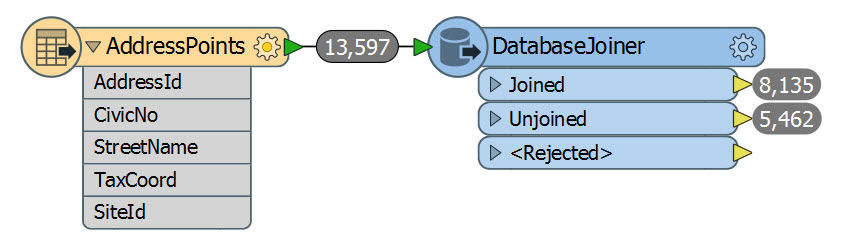

Incoming features (AddressPoints) that do not find a match in the join table (PostalAddress) are output via the Unjoined port and also have the attribute _matched_records = 0
Example workspace with DatabaseJoiner.
