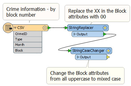

A starting workspace has been provided, which reads the CSV data and formats the Block attribute to match the formatting of the HBlock attribute in the Roads table.
1. Open the Starting Workspace.
Open StartingWorkspace.fmw, In this workspace, a StringReplacer has been used to replace XX in the Block attribute with 00. A StringCaseChanger changes the Block attribute from uppercase to mixed case.

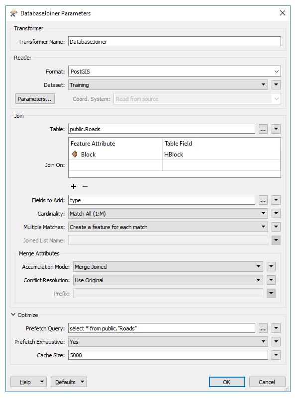

Select the feature attribute from the incoming CSV features, Block, and the corresponding PostGIS table attribute, HBlock, that will be used to find matches. Matches are made when the values of the CSV attributes equal the values of their corresponding PostGIS table fields.
For Fields to Add, select Type.
Open the Optimize panel on the DatabaseJoiner: Add a Prefetch Query to load all of the records from the database table into a
select * from public."Roads"
Because of the prefetch query, the DatabaseJoiner is not required to read from the database for each record. This can improve the performance and reduce the number of queries back to the database.
Use a DatabaseJoiner and join Block with HBlock. Then Set the Prefect Query to select * from public."Roads"

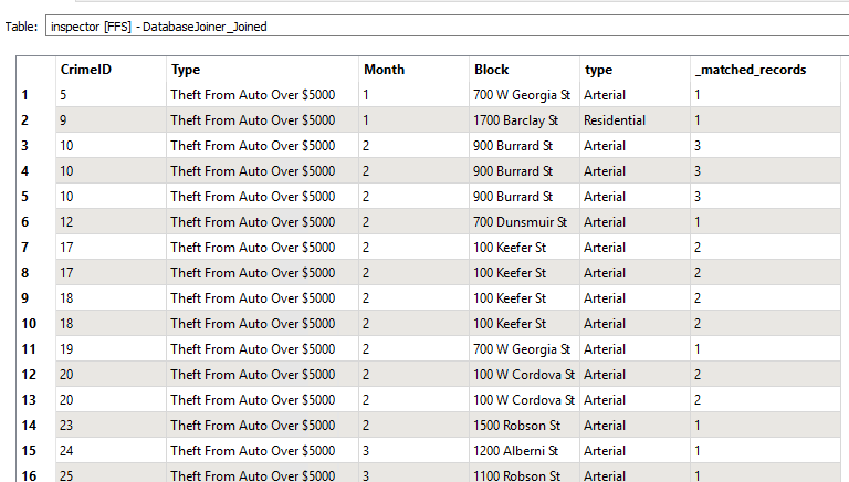

3. Add an Inspector
Connect and Inspector to the DatabaseJoiner to confirm that the road type attribute has been added.
Output of the dataset with the joined fields in the Data Inspector
