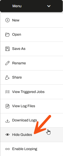

Now, let’s hide the Next Action guides to clean up the canvas and practice adding components manually. To do this, go to Menu, then select Hide Guides.

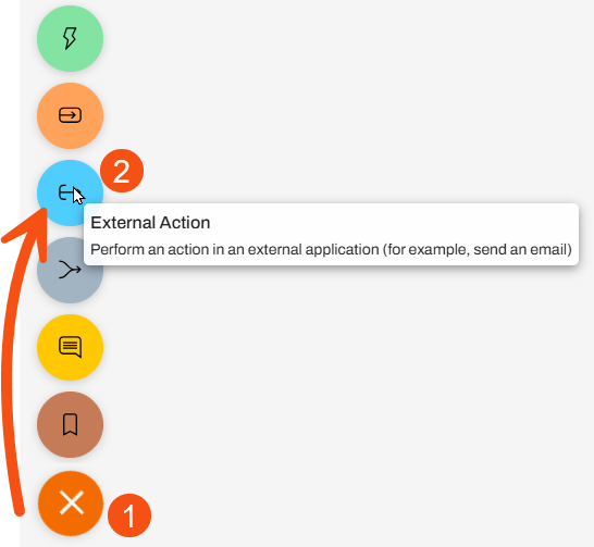

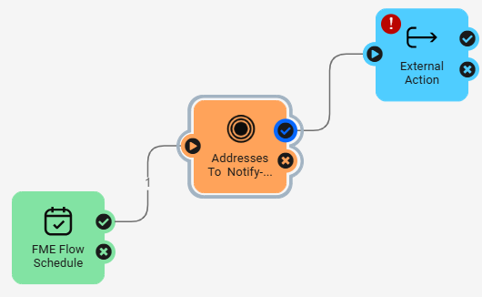

With the guides hidden, let’s manually add an external action. Click on the plus sign (+) in the bottom left corner to open the menu (1). Click External Action to select it (2). Now, click anywhere on the automation canvas to place it.
To connect the external action to the workflow, click the Success output port (checkmark) on the Address To Notify run workspace component, then click and drag it to the External Action component input port. Tidy up the canvas (if desired) by moving the components in-line, similar to FME Workbench.

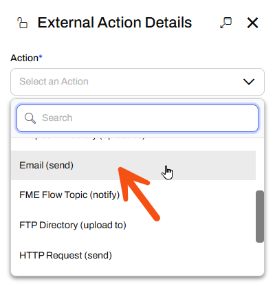

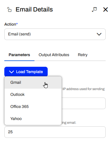

Double-click on the External Action component to open the parameters. In the External Action Details dialog, change the Action to Email (send). After selecting the action type, more options will appear.
To send an email from FME Flow, you will need access to an SMTP email account. FME Flow includes common SMTP templates, such as Gmail and Outlook. Gmail will be demonstrated in this tutorial. If your email provider is not listed, you can manually enter the SMTP Server and Port.
Click the Load Template button, then select Gmail; this will auto-populate the SMTP Server and Port fields.

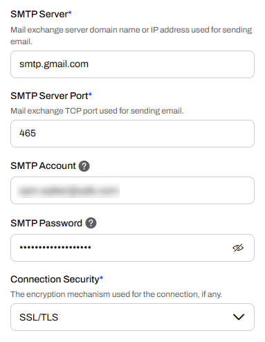

Next, enter your SMTP Account and Password and set the Connection Security. Typically, SSL/TLS is the default, but you may need to contact your email administrator or view your email properties to determine the security type.

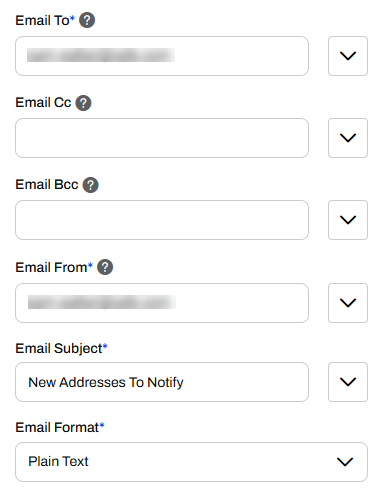

Then, set the Email To and Email From. The Email From field will match the SMTP account email. You can send the email to the same email address as the SMTP email for testing purposes. Now for the Email Subject, set it to:
New Addresses To Notify

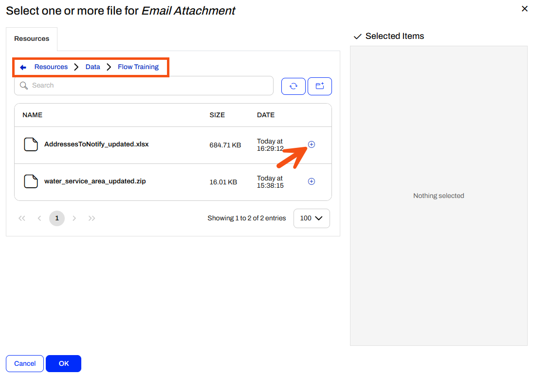

Next, click the ellipsis for the Email Attachment to open the file browser. Navigate to Data > Flow Training > AddressesToNotify_updated.xlsx, then click OK.

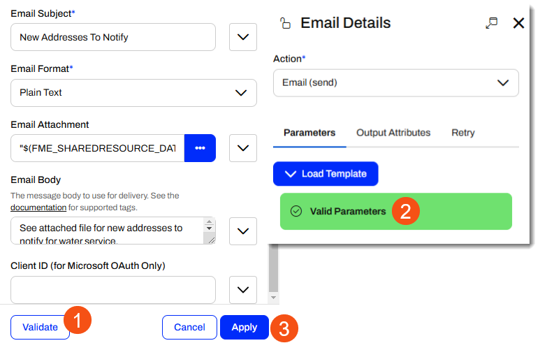

In the Email Body, enter:
See attached file for new addresses to notify for water service.
Once the parameters are set, click Validate (1) to ensure that the email credentials are correct. A Valid message will appear at the top under Load Template (2). After validating, click Apply (3).

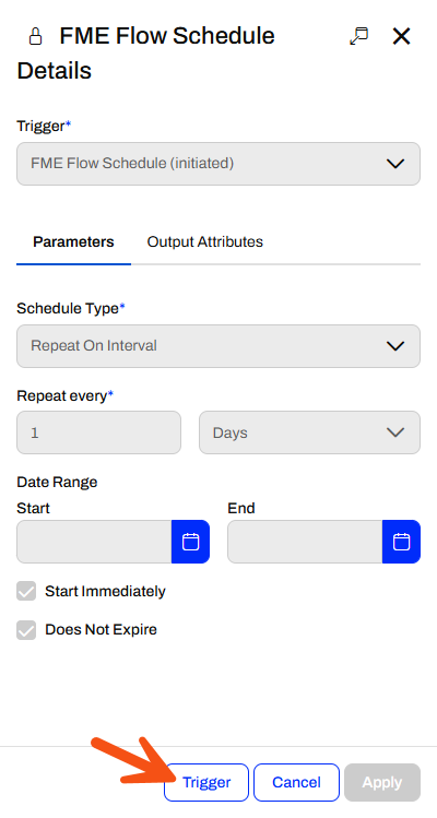

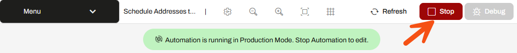

Click Start Automation. With the automation running, we can trigger it now, so we don't have to wait until tomorrow to see if the email works. Open the FME Flow Schedule component and click Trigger to trigger the schedule.

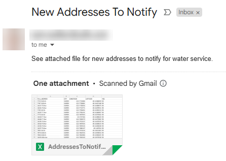

Open the email account that was set up in the Email To field. Confirm that an email was received with the attached AddressesToNotify_updated.xlsx spreadsheet.
