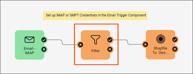

2. Add a Filter
Click on the plus sign in the bottom left corner of the automation, and drag out another Action (orange). Connect the new Action component between the Email Trigger and the Run Workspace Action. Remove the direct connection between the original components by clicking on the connecting line and pressing the Delete key.
Once the Action has been connected, it can be configured as a Filter. A Filter Action tests whether incoming messages contain a specified string and outputs the messages that match the success port. All other messages are routed to the failure port.
Because the automation only passes along the file name and path of the first email attachment, we will need the workspace to determine whether what has been archived is truly a Shapefile. However, it is helpful to do the first pass here to filter out any wrong files before spending more FME engine time on them.
Our workflow requires that input data meet two criteria: one, the input must be an Esri Shapefile, and two, for the automation to pass a reference to the Shapefile reliably, it must be bundled as a single archive. We will configure this exercise to pass .zip archives, but additional filters could be added downstream of the first filter’s failure port to route, e.g., .shz or .7z archives, into the workspace. If a Shapefile is emailed as a set of separate constituent files (.shp, .shx, .dbf…), whichever was stored first by FME Flow will be the only file path read into the automation.
Change the Action to Filter if you haven’t done so already. Then click the drop-down for the Attribute field and select Email Attachment. This setting corresponds to the email.attachment Event Attribute of the Email Trigger. In the Contains field, type .zip (omit wildcard characters). Click Apply.

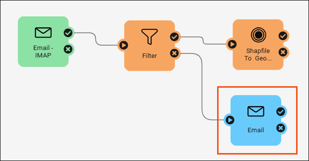

3. Send the User an Email if Attachment File Type is Incorrect
Now that we have our workflow in place, let’s automatically address some of the most common areas in the process that might break down. The first problem case is where the user emails an incorrect file type (or fails to archive the Shapefile components to a single file).
Drag out an External Action component and connect it downstream of your Filter’s failure port.
In the parameters, set the Action to Email (send). All emails sent will be via the SMTP protocol through an external account. Get SMTP Server parameters from your email provider, or use Load Template (as below) to fill in the blanks for some common providers.

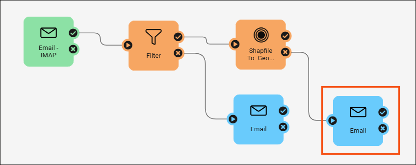

5. Send the Process Administrator an Email When a Job is Run
In this step, we will configure a third and final email, this time to ourselves as the manager of this particular automation. This email will include status details and an attached log for every job submitted by the automation so that we know at a glance when new data has been successfully integrated and when a job failure may need attention.
As in the previous step, copy your Email external action to avoid re-entering email account information. Now, connect it to both the success and the failure ports of the Email Trigger workspace action.
Whenever the workspace runs, we want to be informed, so change Email To from Sent from address to your own address (even if you are coincidentally sending and receiving with the same account). We will format the email to make it easy to tell at a glance when the job was successful and when a failure may require some troubleshooting.

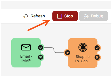

Continuing in the same automation from the previous section. Before you begin, stop the automation so it can be edited. Now, we need to create an Automation Parameter that will be used throughout the workspace.
