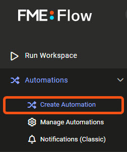

1. Create a New Automation
Log into FME Flow. On the left-hand menu, expand Automations and select Create Automation.

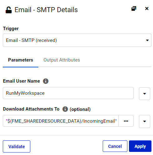

On the Automations canvas, double-click the Trigger node. Set your Trigger to Email - SMTP (received). Populate the Email User Name parameter with the local part of the email address to which the user would like to send it. The domain does not need to be included in this parameter. For example, if your FME Flow service which is accessible online through the site “http://myflowinstance.com/fmeserver” was given the Email User Name of “RunMyWorkspace”, any time a user sends an email to “RunMyWorkspace@myflowinstance.com” the automation will be triggered.
If you are using a separate server that relays emails to FME Flow, the same email User Name rules above still apply.
Click the ellipsis button to the right of the Download Attachments To field and specify a Resource folder to house any incoming email attachments (e.g., Data/IncomingEmail/). Click Validate and (if valid) Apply.

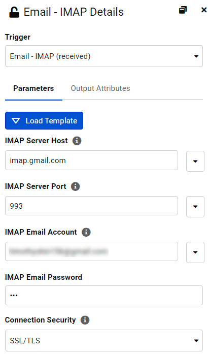

On the Automations canvas, double-click the Trigger node. Select Email - IMAP (Received) from the Trigger drop-down menu. You will need to enter details of the IMAP server to which you wish to connect; the Load Template button allows you to populate the required fields with information from several popular providers.
Input an IMAP Email Account to poll for new mail and enter its associated IMAP Email Password. If you created an application password, use that password instead of the email’s usual password. You may want to change the polling interval, as external email providers may refuse the connection if FME Flow polls too frequently.

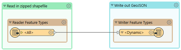

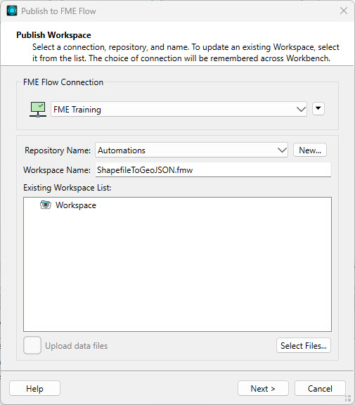

Download the ShapefileToGeoJSON.fmwt workspace from the Files section of this article (it's contained within the GettingStartedWithAutomations folder). This workspace can accept zipped Shapefiles as an input and then outputs them as GeoJSON.
Open the workspace in FME Workbench, then publish it to FME Flow. To learn how to publish a workspace to FME Flow, see the Publish a Workspace to FME Flow and Run It article. Publish the workspace to a Repository called Automations and ensure Job Submitter is enabled as the Service.
When supplying data for this workspace, it is important to archive (zip) your shapefile (any single-file archive supported by FME will do) because the attachment file path passed from the Trigger to Actions downstream will only point at the first attached file.

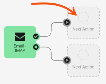

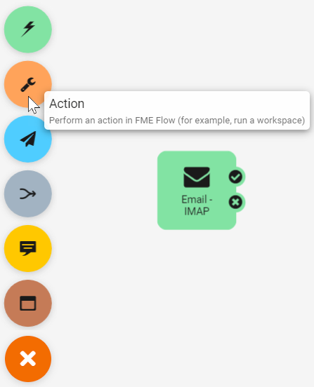

Return to the automation in FME Flow. If you have guides enabled, double-click the silhouetted Next Action component to open the parameters.
If Hide Guides was previously selected from the Automations menu, you would need to click on the component tray in the lower left of the canvas and drag out an orange Action component.

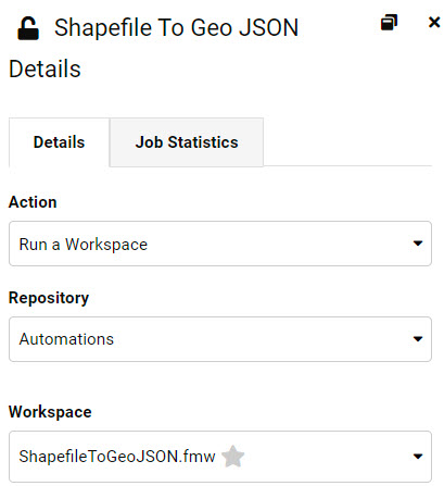

In the Action parameters, select Run a Workspace as the Action. Then select Automations as the Repository and ShapefileToGeoJSON.fmw as the Workspace.

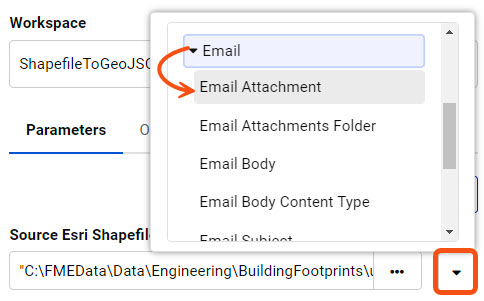

To set the user parameters, click on the drop-down arrow next to Source Esri Shapefiles, expand Email, and select Email Attachment. This is an upstream message, and it will use the data incoming from the Email Trigger component email attachment.

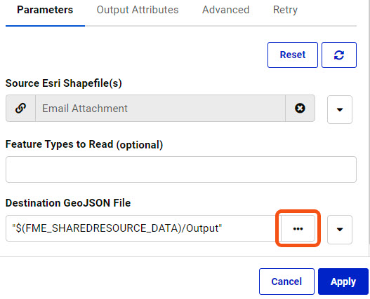

Next, select a destination folder for the GeoJSON file. Create a new resource folder in the Data folder called Output. Click Apply to save the parameters.

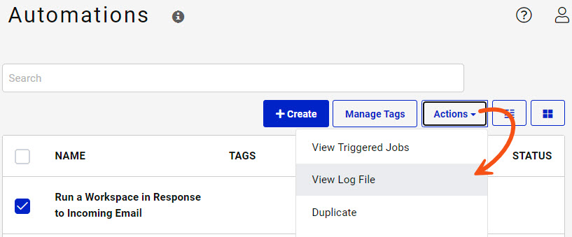

Wait for at least one polling interval, in this case, one minute, then check the Automation log. One way to do this is through Menu > View Log File when your Automation is displayed on the screen. You can also navigate to Automations > Manage, check the box next to the automation and select Actions > View Log File. It can be helpful to click the clock icon above the log to show timestamps for each log entry.

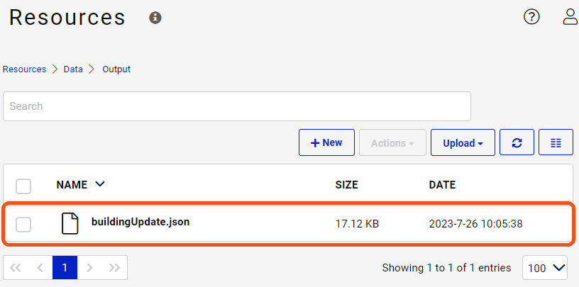

You can confirm the attached file was downloaded successfully by navigating to the Resource folder you specified in the Trigger and looking for a new subfolder named in the log entry.
