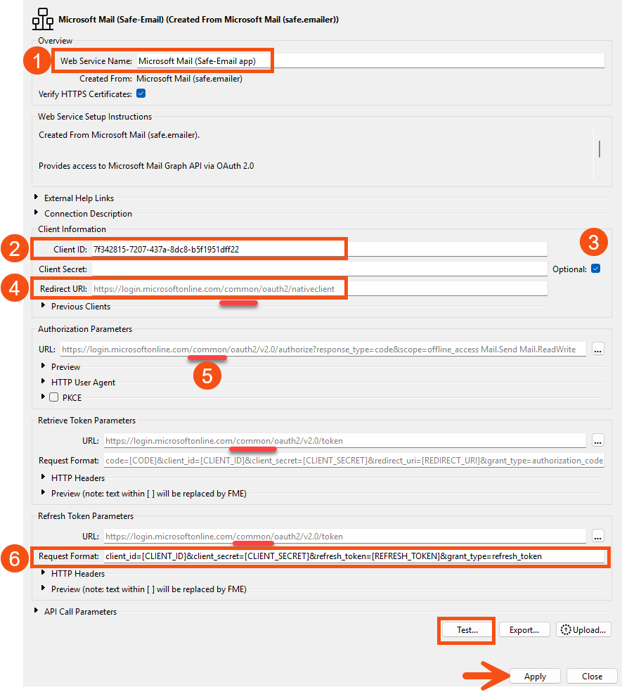

In the new web service, enter:
  1. Web Service Name: It's recommended to include the name of your Azure app registration for reference.
  2. Client ID: the Client ID from your Azure app registration (Found on the Overview of your app registration).
  3. Optional: check this off. Ensure nothing is entered into the client secret. The client secret is only for FME Flow. Using a client secret in FME Form will return errors from Microsoft Azure.
  4. For Multitenant Azure App registrations: leave the Redirect URI as https://login.microsoftonline.com/common/oauth2/nativeclient to match the Azure app registration.
  5. For Single Tenant Azure app registrations: replace the word "common" with your Tenant ID found on the app registration Overview in the Redirect URI, Parameters URL, Retrieve Token Parameters URL, and Refresh Token Parameters URL.
  6. Refresh Token Parameters URL: confirm the URL doesn't contain the hardcoded parameter and value "&redirect_uri=http://localhost/". Alternatively, you can add http://localhost to your app registration's desktop redirect URI list.
Click Test to test the web service connection. You will be prompted to enter Microsoft credentials and consent to the application's permissions in your Azure tenant. Click Apply.
