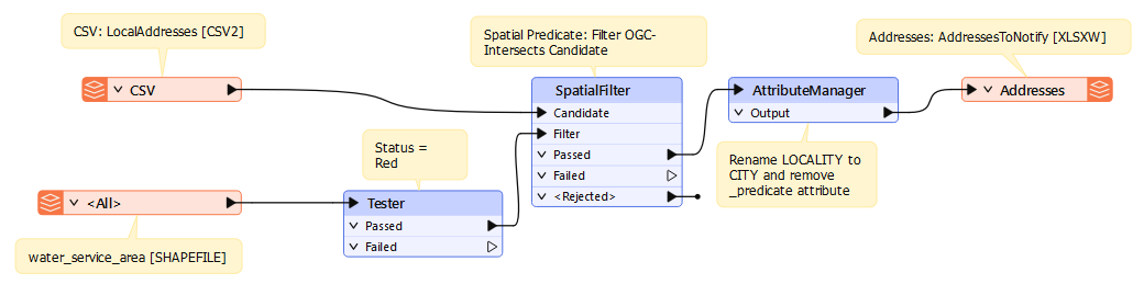

This workspace compiles a list of customers affected by a water pump failure to notify. It reads a CSV containing information about local addresses in the city of Surrey, BC, and a shapefile containing a polygon area of interest for water service maintenance.

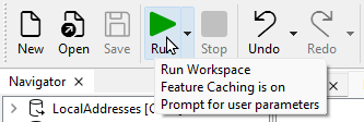

It is a good idea to run a workspace in FME Workbench before publishing it to FME Flow because, typically, if it doesn’t run in FME Workbench, it won’t run in FME Flow. Click on the green Run button to run the workspace.

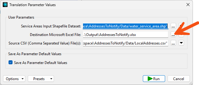

In the Translation Parameter Values dialog that appears, confirm the output location for the Destination Microsoft Excel File parameter. This will save the file to the same folder as the template workspace. If you want a different file destination, click the ellipsis [...] button (or file icon) and select a new folder. Click Run to finish running the workspace.
If the Translation Parameter Values dialog does not appear, you need to turn on Prompt for Parameters, which is accessed by the drop-down arrow next to the Run Button. After enabling Prompt for Parameters, click the Run button. The Translation Parameter Values dialog should appear, then follow the steps above to change the destination file location.

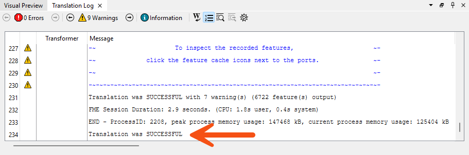

After running the workspace, review the Translation Log for the Translation was SUCCESSFUL message. If you did not receive this message, review the translation log for any red error messages and resolve them.

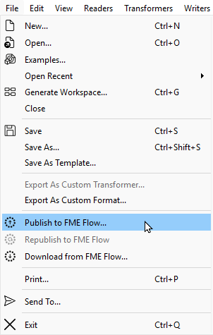

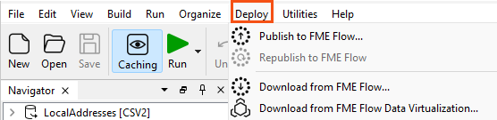

Now that we have confirmed the workspace works, we can publish it to FME Flow. With the workspace open, go to File > Publish to FME Flow on the top menu bar (2025.0 and earlier) or Deploy > Publish to FME Flow

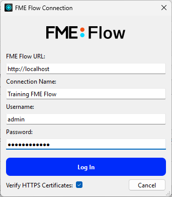

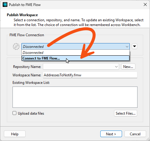

In the Publish to FME Flow wizard, we will need to set up a new connection to FME Flow. Click the drop-down under FME Flow Connection and select Connect to FME Flow.
The following instructions are for a basic connection, but if your FME Flow is set up for Microsoft Azure, SAML, or Windows Credentials, please see the Using Web Connections to Connect to FME Flow documentation.
An FME Flow Connection dialog will appear, where we will set up the connection. The connection information and credentials can be obtained from your FME Flow Administrator. If you have not yet logged into FME Flow after installing, please do so prior to continuing, as you will be prompted to change the password from the default, which is admin as the username and admin as the password.
  • Web Service: FME Flow
  • Server URL:  http://localhost or http://myservername/fmeserver
  • Connection Name: Training FME Flow
  • Authentication: Basic
  • Username: <your username>
  • Password: <your password>
The FME Flow Connection dialog will look a bit different depending on your FME version.
FME 2025.0 and later:
Before FME 2025.0:
Click Log In (FME 2025.0 or later), or OK (2024.3 and earlier). FME will try to authenticate the connection. Once authenticated, this connection will be available whenever you publish a workspace, so you only need to create the connection once.

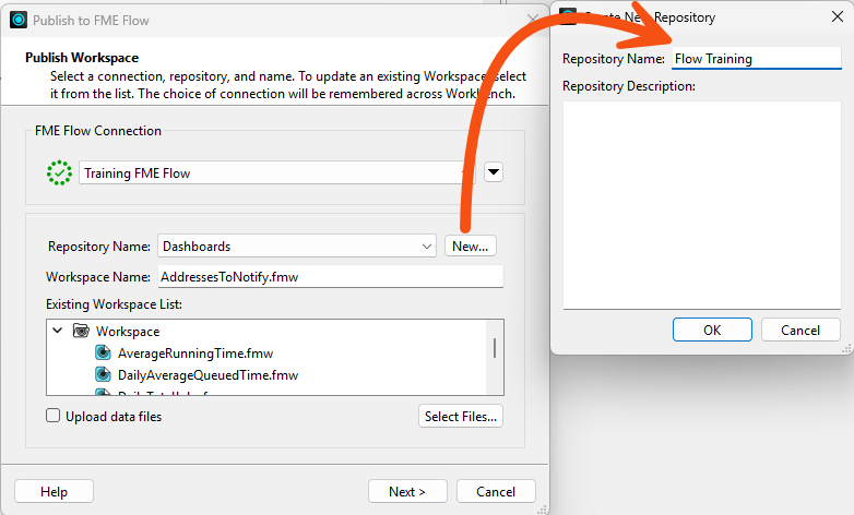

b. Create Repository
Now, we need to create a new repository to contain our workspace.

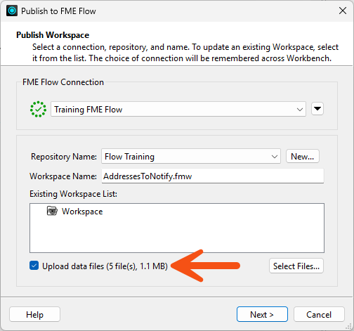

Next to Repository Name, click the New button to create a new repository. Enter Flow Training for the name, and you can optionally add a description. Click OK to close the Create New Repository dialog.
c. Upload Files
For our workspace to run correctly, we need to upload the files. Enable the Upload data files toggle at the bottom of the dialog. After enabling it, it should state 5 files for upload. Then click Next.

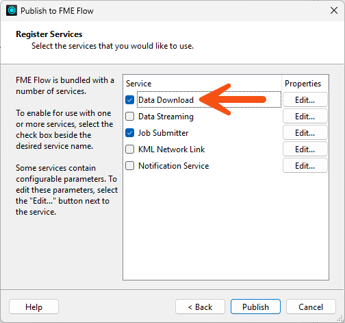

One last step before we can publish the workspace is to register it with a service. A service will control how the data is output after the workspace is run.
  • The services return results in slightly different forms:
  • The Data Download Service returns results as a downloadable zip file
  • The Data Streaming Service returns results as a data stream
  • The Job Submitter Service accepts and runs workspace job requests
  • The KML Network Link returns a KML Network Link that can be used in Google Earth
  • The Notification Service allows for event-driven messaging
We want to download our data after we run the workspace, so we will register with the Data Download Service. Ensure the Data Download Service is enabled (you can leave the Job Submitter enabled). Once enabled, click Publish.

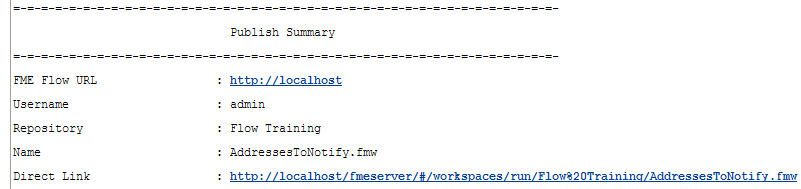

To confirm whether or not the workspace was published successfully, check the Translation Log. The Translation log will show which repository you published to, which files were included, and a quick link to run the workspace.

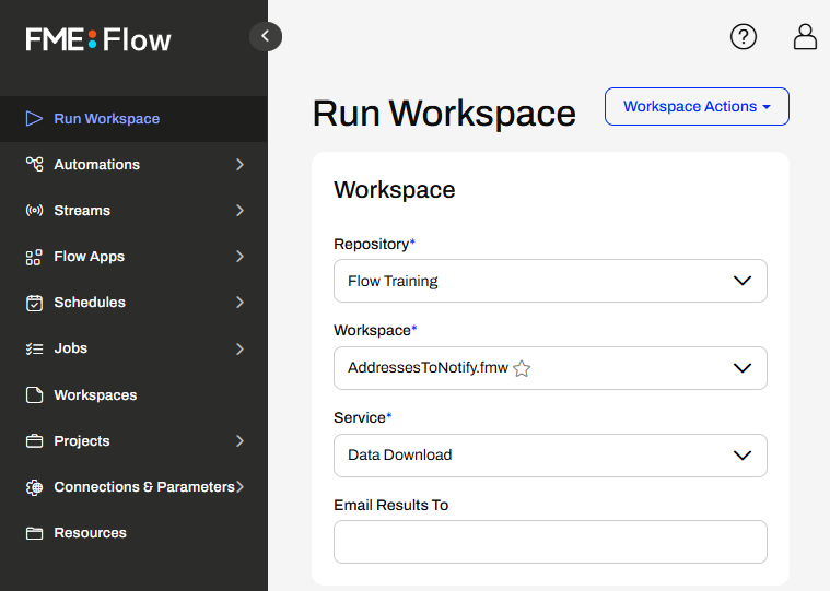

2. Run the Workspace
Click on Run Workspace on the side menu. On the Run Workspaces page, click on the drop-down arrows for each section to select the workspace:
  • Repository: Flow Training
  • Workspace: AddressesToNotify.fmw
  • Service: Data Download

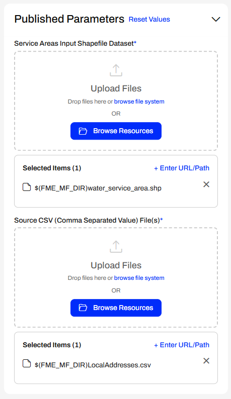

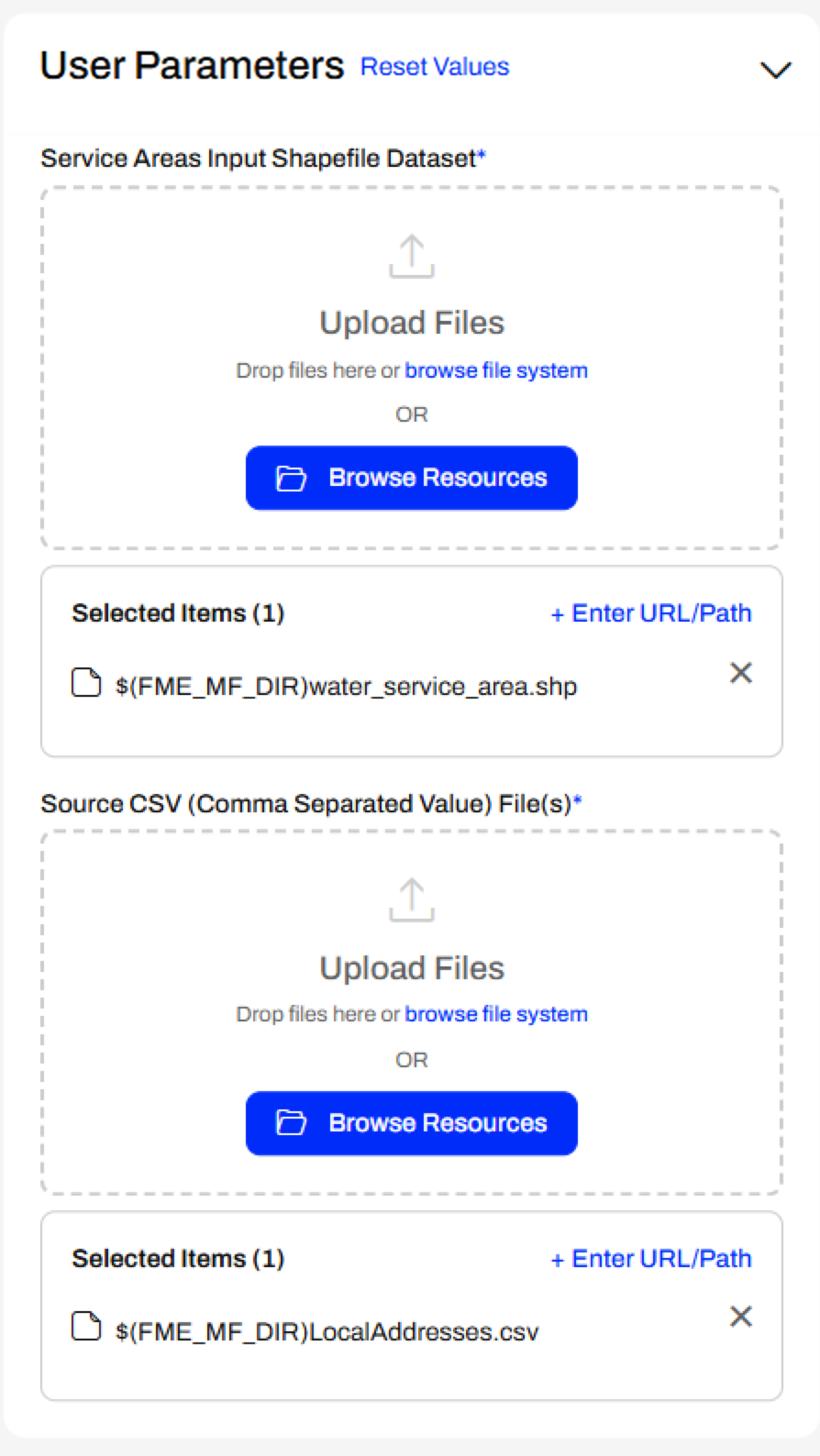

If any user parameters are available in the workspace, they can be set on the run workspace page. For this example, we can leave the User Parameters as the default values. Click Run to run the workspace in FME Flow.

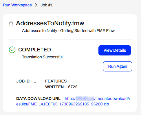

After the workspace runs, there should be a successful translation with summary information and a data download URL.
Click on the URL to download the zip file. Open the zip file to confirm that it contains a Microsoft Excel file.
