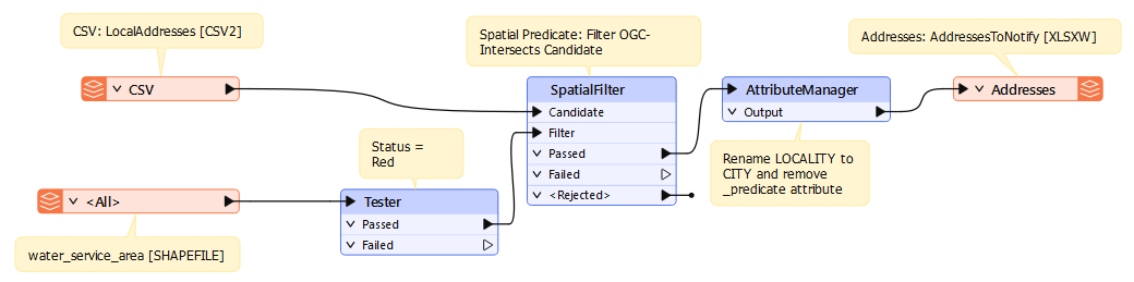

This workspace is compiling a list of customers to notify who were affected by a water pump failure. The workspace is reading a CSV containing information about local addresses in the city of Surrey, BC, and a shapefile containing a polygon area of interest for water service maintenance.
If you have completed Publish a Workspace to FME Flow and Run It, this is the same workspace.

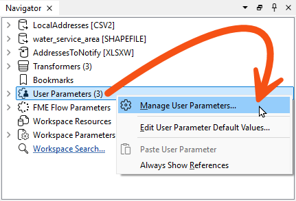

 In the Navigator window, right-click on User Parameters and select Manage User Parameters.
The Parameter Manager contains all of the user parameters in a workspace. This workspace only has the default parameters from when a reader and writer are added. Since we want to give the user the option to upload a new water_service_area file, we should clean up these parameters.  For more information on the Parameter Manager, see the Using the Parameter Manager article.

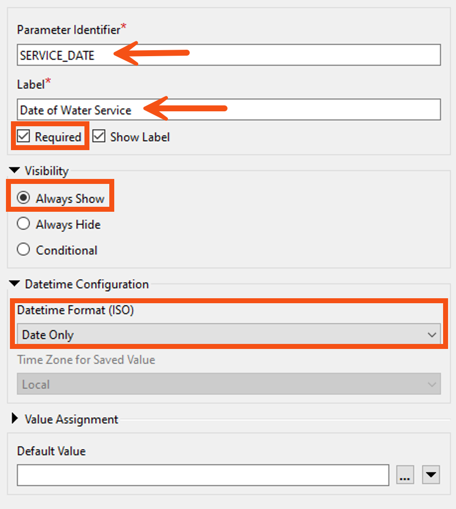

5. Create New Parameter

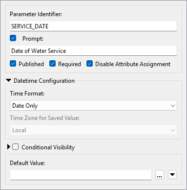

While we’re in the Parameter Manager, let’s create a parameter for the service date. The user will set this when the workspace runs, and it will be attached to the AddressesToNotify.xlsx spreadsheet.
Click the green plus sign (+) in the top-left corner, then select Datetime.
Then, on the right-hand side, enter the following parameter properties:
  • Parameter Identifier: SERVICE_DATE
  • Label: Date of Water Service
  • Required: Enabled
  • Visibility: Always Show
  • Datetime Format (ISO): Date Only
Click OK to close the Parameter Manager.

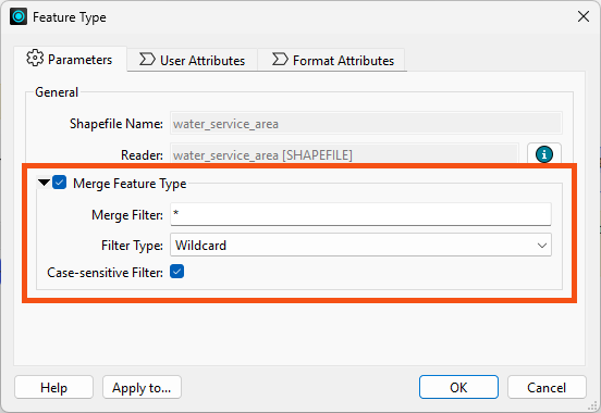

6. Modify the Shapefile Reader
Since we won’t know whether the updated file's filename will change, let’s change our shapefile reader to accept all filenames with the same schema.
Double-click on the water_service_area reader feature type to open the parameters.
In the parameters, enable Merge Feature Type and leave the other parameters set to their defaults, then click OK.
The reader feature type will now display <All>, meaning that any shapefile can be accepted by the reader as long as the schema matches.

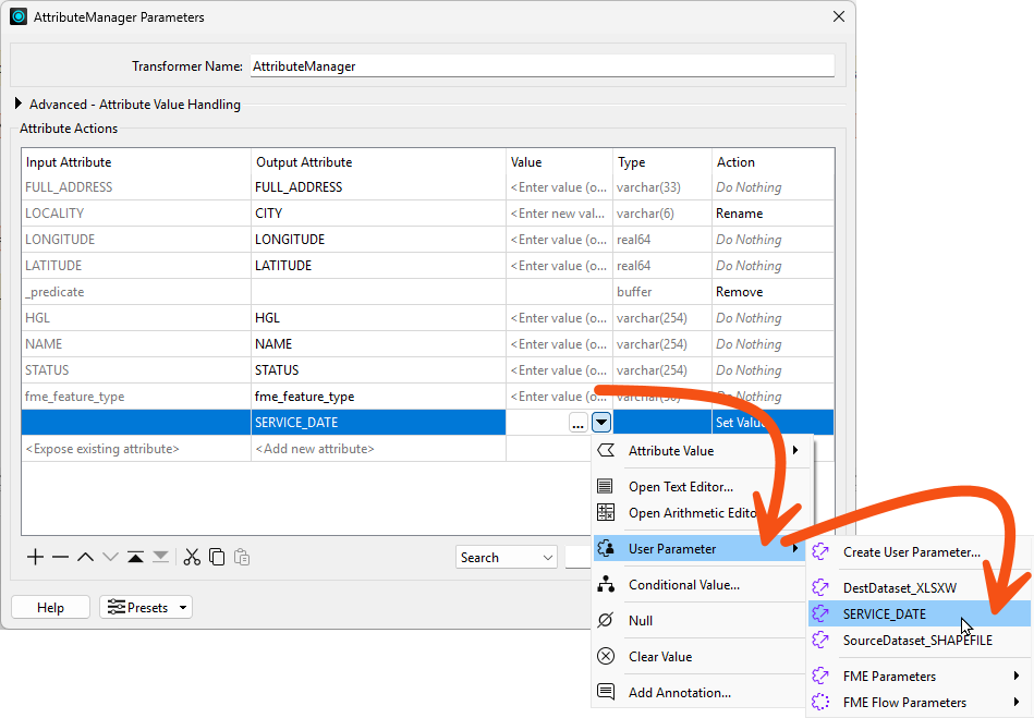

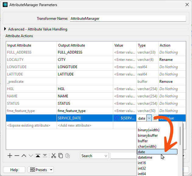

Double-click on the AttributeManager transformer to open the parameters. In the parameters, click in the <Add new attribute> box and then type in SERVICE_DATE as a new attribute.
Next, click the Value box next to SERVICE_DATE to display the drop-down. Click the drop-down button, expand User Parameter, then select SERVICE_DATE.
Click the box for Type, then select Date as the data type. Click OK to confirm the AttributeManager parameters.

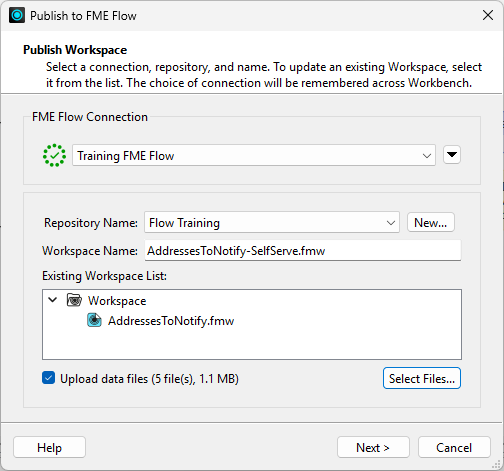

Now that we have the parameters set up and confirmed that the workspace runs correctly, we can publish it to FME Flow.
Before publishing, save the workspace. Once saved, go to File > Publish to FME Flow on the top menu bar.
Select an FME Flow connection, then select the Flow Training repository created in the previous tutorial or create a new repository. To differentiate between the workspace uploaded from the previous tutorial, add -SelfServe to the end of the workspace file name:
AddressesToNotify-SelfServe.fmw

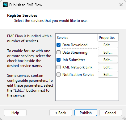

Enable Upload data files.
Click Next.
Confirm that the Data Download service is selected, then click Publish.

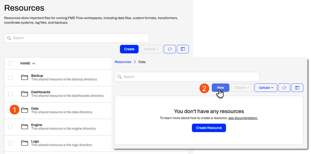

Open and log in to the FME Flow Web Interface.  When we run the workspace in FME Flow, we can upload the updated shapefile directly via the user parameter. The only issue with this method is that it gets uploaded to the Temporary files folder, which gets purged every month (by default). We want to reference this in an automation we will set up in the next tutorial, so let’s upload it to the permanent Data folder.

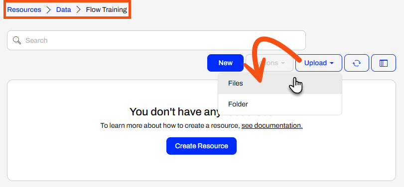

On the side menu bar, click on Resources.
Resources are where files are stored, such as log files, temp files, connections, and backup files. The Data folder is where users can store data outside of repositories for use across FME Flow. Open the Data folder (1), then click New in the top corner (2). Create a new folder called Flow Training, then click OK.

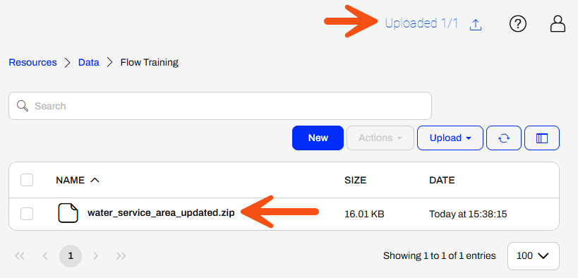

Open the new Flow Training folder, and click on Upload > File(s). Then select water_service_area_updated.zip, and click OK.
Now, this file can be accessed anywhere on FME Flow. After uploading data to FME Flow, the Resources Uploaded notification appears in the top-right corner, indicating how many resources were uploaded. Clicking it shows all the resources uploaded during the session.

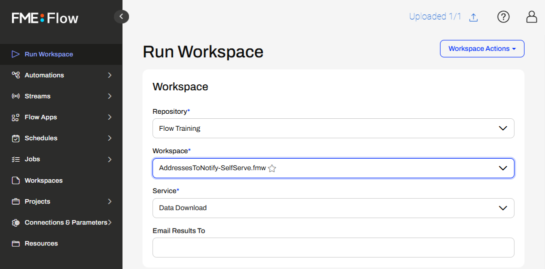

3. Run Workspace

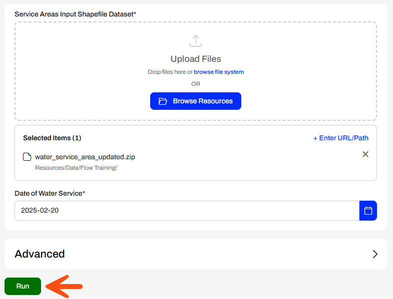

On the side menu bar, click on Run Workspace. On the Run Workspace page, select Flow Training for the Repository and the AddressesToNotify-SelfServe.fmw workspace. Select Data Download for the Service.

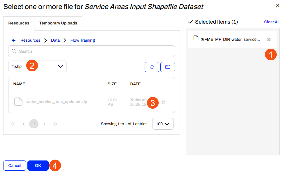

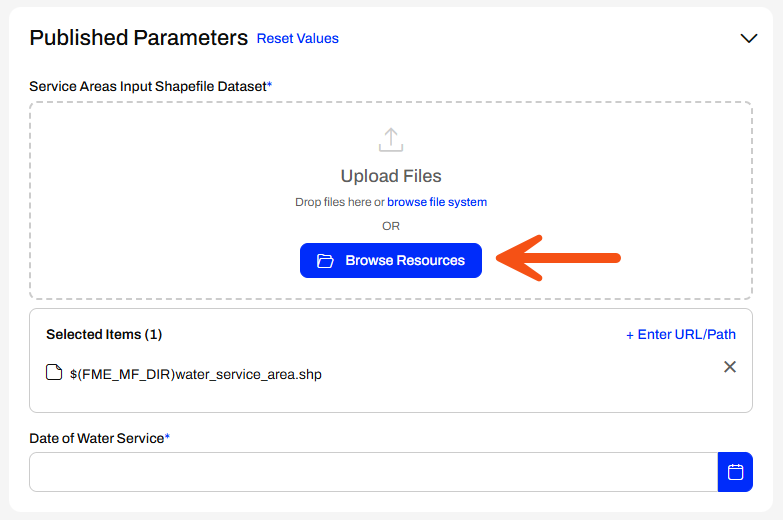

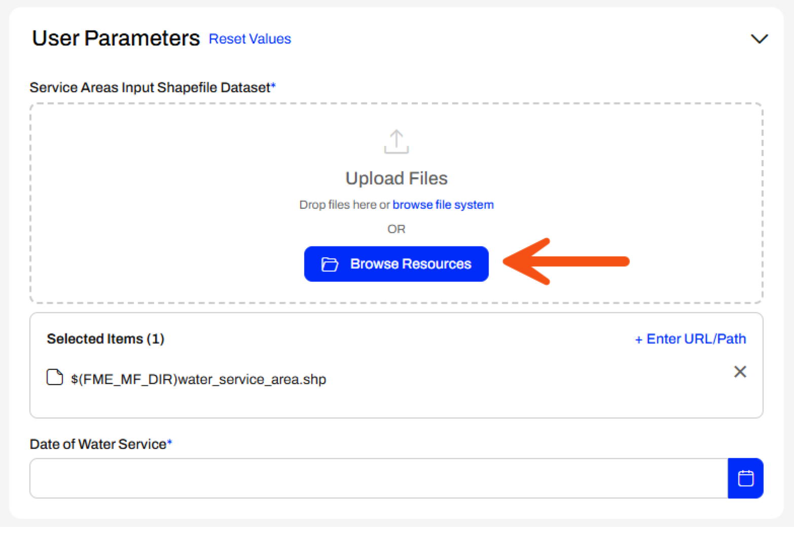

In the User Parameters section, there are two parameters that were set up in FME Workbench. For the Service Areas Input Shapefile Dataset parameter, click on Browse Resources.
In the Resource browser, click Data, then Flow Training. Remove the existing dataset by clicking the X next to $(FME_MF_DIR)water_service_area.shp on the right (1). Then, change the file ending filter to All Files so you can select the .ZIP file (2). Then, next to water_service_area_update.zip, click on the plus sign (+) to select the dataset (3). Click OK to close the Resource browser (4).
Note: If you are working with shapefiles that are not contained in a zip file, or with any other file types that have sidecar files, be sure to select ALL of the files when adding them to a parameter or workspace. If you are missing a file, the workspace won’t run correctly.
Next, click the calendar icon next to the Date of Water Service parameter and select a date within the next week.

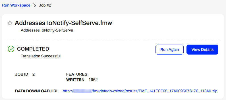

Once all of the parameters have been set, click Run at the bottom of the page to run the workspace.
4. View the Results
Click on the URL to download the zip file. Open up the zip file to confirm there is a Microsoft Excel file.
Optional: Open the file in Microsoft Excel or in FME Data Inspector to review the output.
