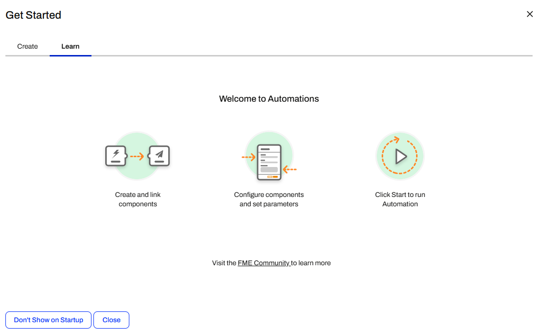

In Automations, a quick introduction will pop up; review it before closing.

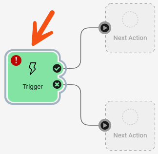

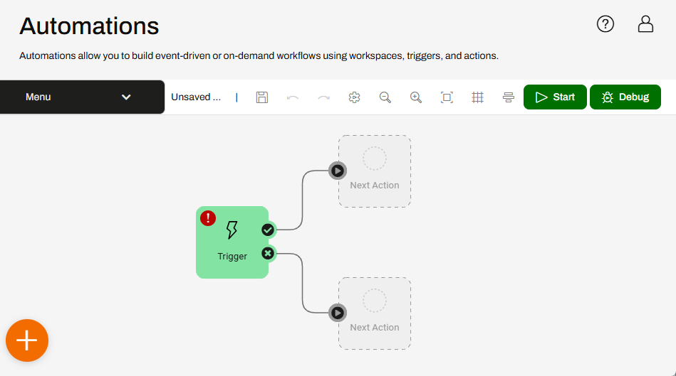

After closing the Get Started dialog, you’ll be on the Automation canvas with a Trigger component already added, as well as Next Action guides.
The canvas is where Triggers, Actions, and other components will be added to create an Automation workflow, similar to an FME workspace. For an in-depth look at automations, see Getting Started with Automations.
The Next Action guides will be used in the next step to quickly add and configure action components. The guides can be disabled by opening the Menu and selecting Hide Guides.

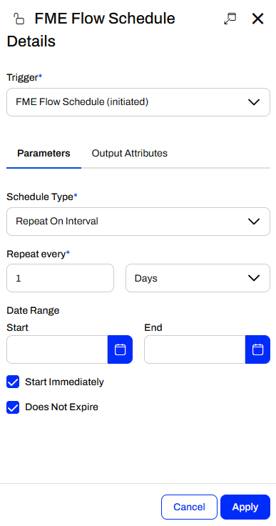

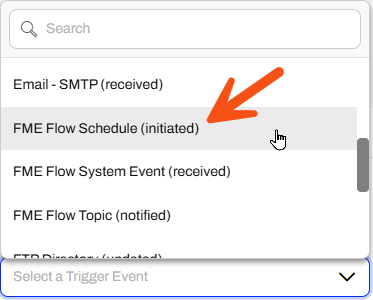

In the Trigger Details dialog, click the drop-down to expand the trigger options, select FME Flow Schedule (Initiated). After selecting a trigger type, more options will appear.
For this schedule, we want it to run once daily at the same time. Set up the Schedule Details as follows:
  • Schedule Type: Repeat on Interval
  • Repeat Every: 1 Day
  • Start Immediately: Enabled (this will set the schedule time to the time the automation is turned on. For a specific time, set the Start instead of enabling Start Immediately)
  • End: <set to one week from today>
Click Apply.

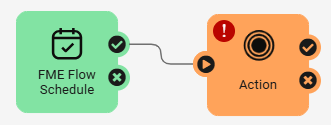

4. Add and Configure an Action

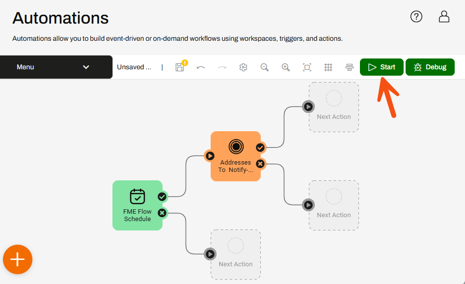

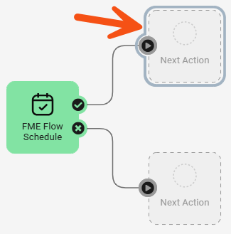

With the Schedule Trigger setup, we need to set up an action to trigger. Double-click the silhouetted Next Action Guide connected to the success output port (the one with the checkmark) to open the Next Action Details.

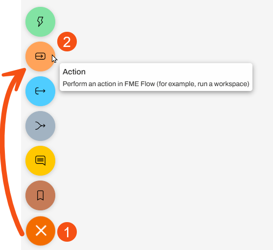

If Guides are disabled, click the orange plus sign (+) in the bottom-left corner to open the menu (1). Next, click on Action to select it (2), then click on the canvas to add the Action component. To connect the newly added Action component, click on the FME Flow Schedule component success port (checkmark) and drag the connection line to the Action input port.

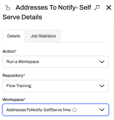

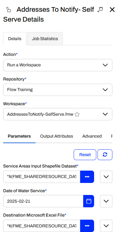

In the Next Action Details, select Run a Workspace from the drop-down menu. After selecting an action type, the dialog will display additional options.
Set the Action Details as follows:
  • Repository: Flow Training
  • Workspace: AddressesToNotify-SelfServe.fmw

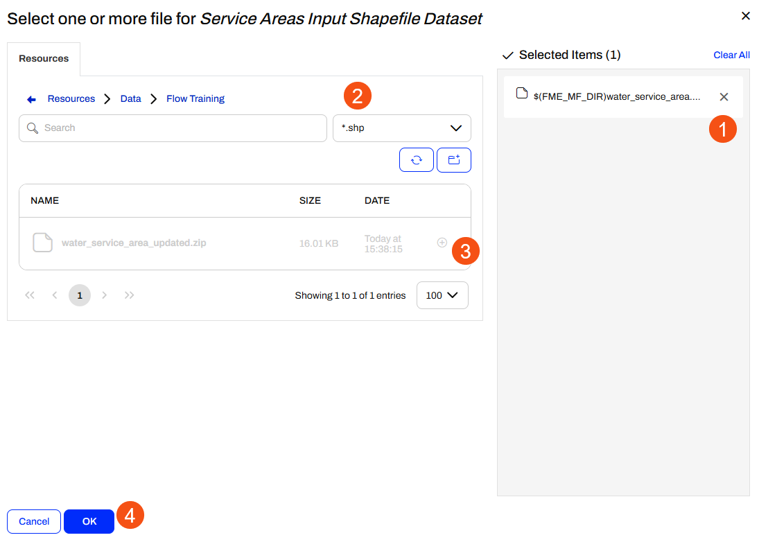

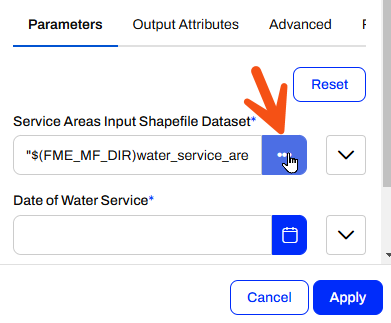

The Parameters will need to be modified as well. Click on the ellipsis [...] next to Service Area Input Shapefile Data to open the file browser.
Navigate to Data > Flow Training.
Remove the $(FME_MF_DIR)water_service_area.shp default dataset by clicking the X (1).
Change the file filter to All Files so you can select the .ZIP (2).
Click the plus sign (3) to add the water_service_areas_updated.zip. This dataset was uploaded in the previous tutorial. If you do not have it already uploaded, please see Part 2 of the previous tutorial.
Click OK to add the dataset to the parameter (4).
Then select a date for Date of Water Service; it can be sometime in the future.

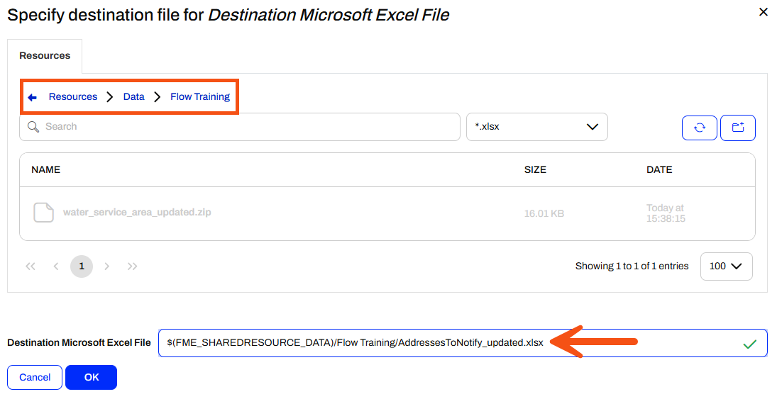

Finally, click on the ellipsis for the Destination Microsoft Excel File and browse to the Flow Training folder. In the lower address bar, after $(FME_SHAREDRESOURCE_DATA)/Flow Training/ type in:
AddressesToNotify_updated.xlsx
Click OK, then once the parameters are all set, click Apply.

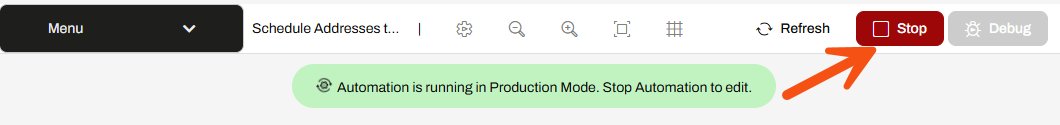

5. Save and Start Automation
This automation is simple but very powerful. It allows a workspace to be run daily without the user needing to do anything beyond setting up the automation. Before the schedule is initiated, the automation needs to be saved and started.
Click on the Start button in the top right corner.

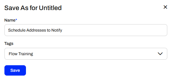

Since this is the first time we are starting the automation, we will be prompted to save. Save the automation as "Schedule Addresses To Notify," then click the plus sign to add a Tag. Enter the tag name Flow Training, then click OK twice to save the automation.
Note: If you only have the single Flow Training tag, Select All will be enabled. If your FME Flow has other tags besides the newly created Flow Training tag, Select All will remain disabled.
After saving the automation, it will start. To make any edits, it must be stopped.

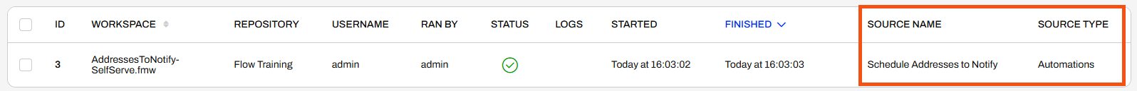

From the Automation page, click Menu > View Triggered Jobs. A list of jobs run by this automation appears. These jobs can also be accessed via Jobs > Completed. You will know the job is from automation because it will have the Source Type set to Automations and the name of the automation.

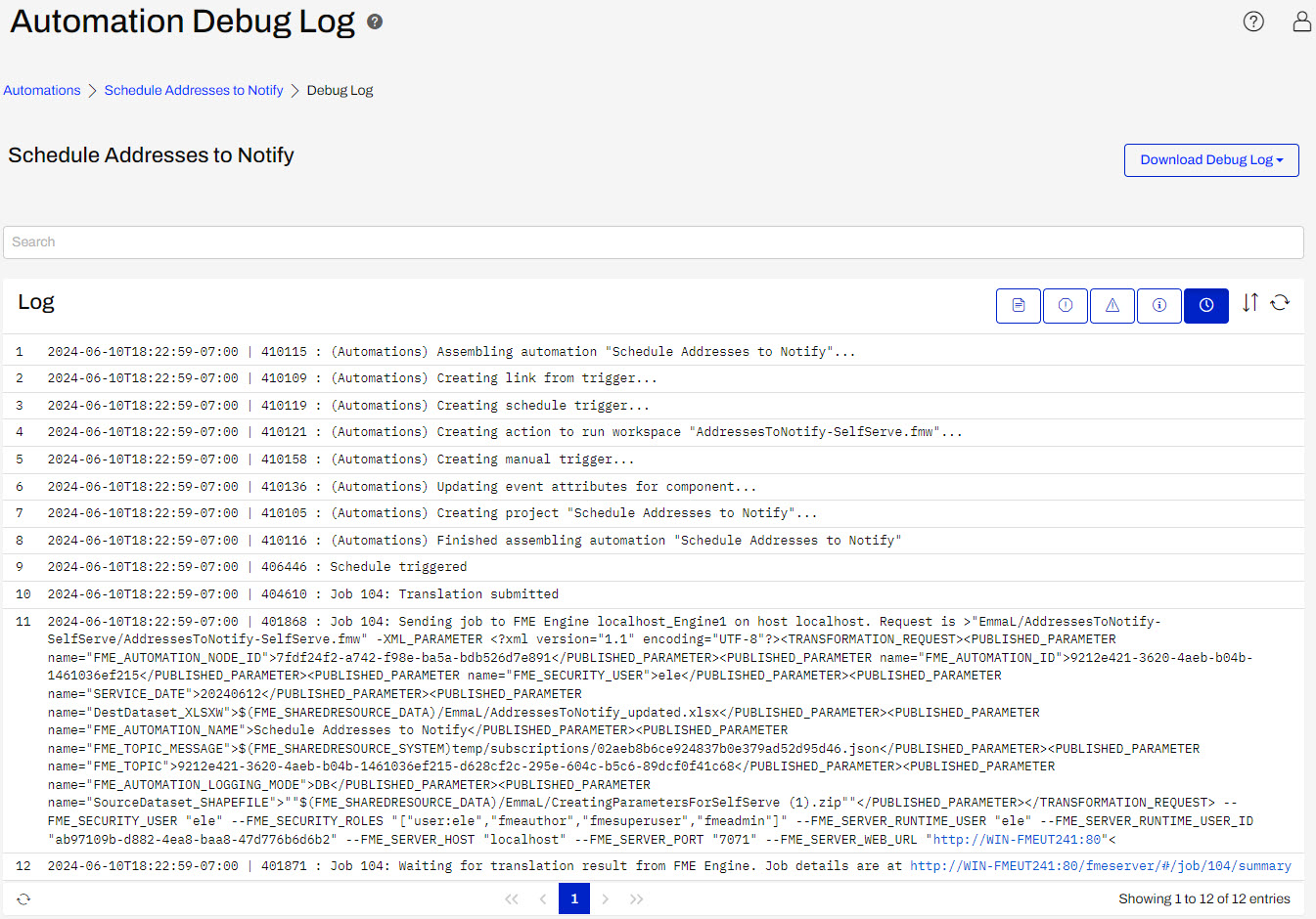

b. View the Automation Log File
The second way to verify whether the automation was successful is to check the log files. Stop the automation, click on the Debug button, and confirm Debug mode by clicking Debug. Then click View Debug Log:
