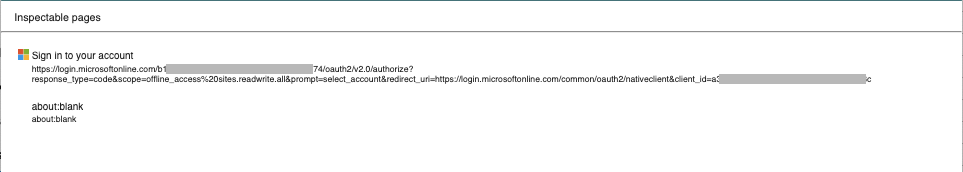

Navigate to http://127.0.0.1:8091 in your browser and refresh the page once an embedded browser is opened in FME. Here you can verify that the authorization URL has been formatted correctly, by comparing it to documentation for that web service or an HTTP client, like Postman.
Inspectable pages
Clicking on the URL will open a developer tools window where you can inspect the network traffic. Click on the >> to view the Network tab.

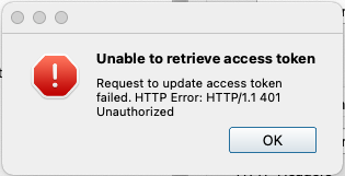

An example of a response in FME Form:
Unable to retrieve access token

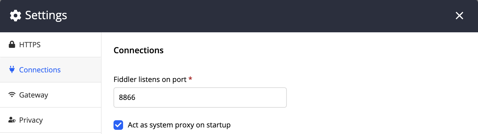

Once Fiddler is installed and running, open the settings to see which port it is running on:
Fiddler port
Configure FME to use a system proxy and make sure that it’s using the same port that Fiddler is listening on.

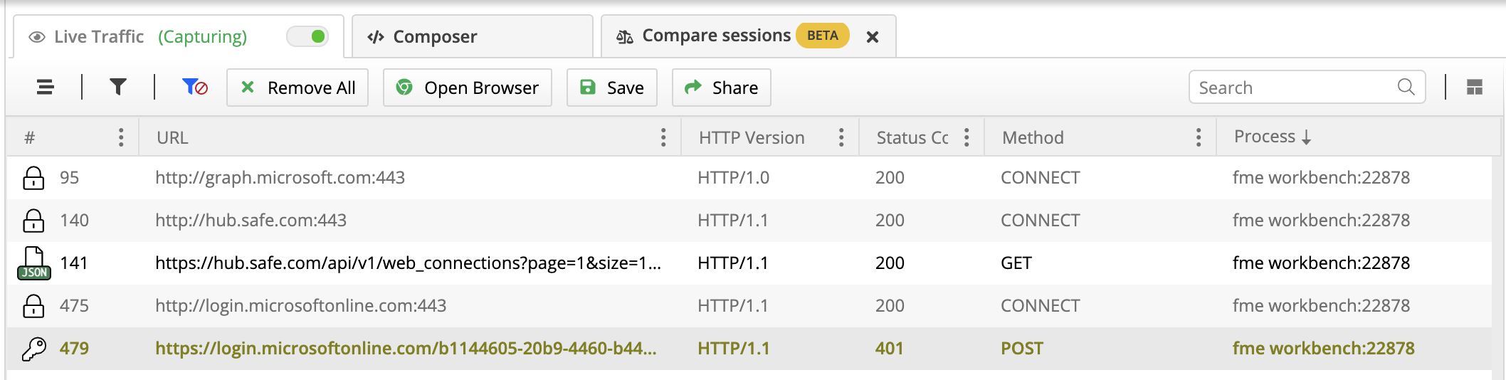

If you now test your web service, you should see requests to that service appear in Fiddler.
The error in FME shows that the web service was unauthorized, but doesn’t say why.

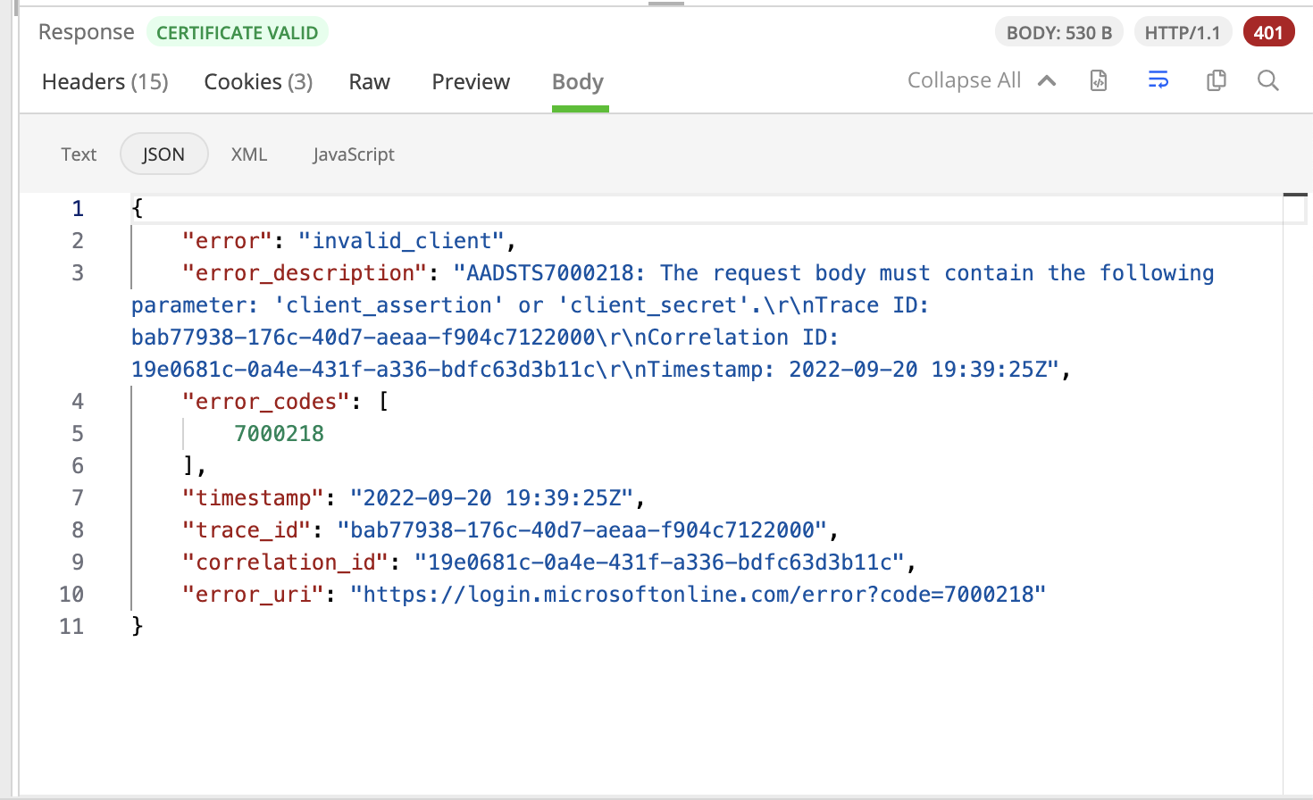

Clicking on that request in Fiddler (to login.microsoftonline.com) and then inspecting the response body confirms that this is due to a missing client secret. With this information you can now correct your web service definition in FME and try again.
