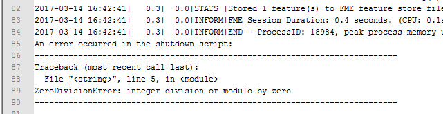

You can use the excellent traceback module to include a detailed error message in the job log.
Here's an example shutdown script:
import traceback
import fme
try:
   # Your code here
   test = 1 / 0
except:
   with open(fme.logFileName, 'a') as fmelog:
       # Re-open FME log file in append mode
       fmelog.write("An error occurred in the shutdown script:\n")
       fmelog.write("-" * 75 + '\n')
       fmelog.write('\n'.join(traceback.format_exc().splitlines()) + '\n')
   raise # Re-raise the original exception
This is the end of the job log:

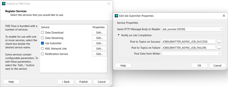

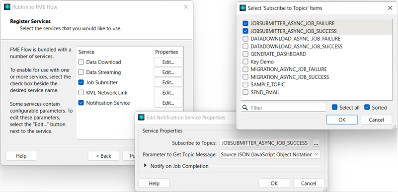

When you register a workspace with FME Flow, you can choose to post a job’s success/fail message to a topic on success or fail, which will contain the job ID.
You can create another workspace that subscribes to the topics listed above and receives this message as JSON. When you publish the log emailer workspace to FME Flow, register it with the Notification Service and send the Notification Data to the JSON Reader.

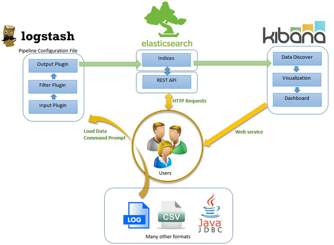

"Has anyone used Kibana to monitor FME Log files?"
You can pull certain FME Flow logs into an Elasticsearch database and use Kibana to monitor/analyze the activities in the logs.
You can create a 'Pipeline Configuration File' (see the attachment) in Logstash to extract the required information from a CSV file. Then Elasticsearch can be used to create indices which can be utilized by Kibana for data discovery, visualization, and dashboards. This testing is done with Elasticsearch 2.2.0, Logstash 2.2.0, and Kibana 4.4.0.
The process may be changed slightly with the new version of Elasticsearch. You can follow the Elasticsearch documentation for building the process.
