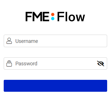

When using Internet Explorer and the web interface is visible but the login button is missing or appears as a blue bar without text [see screenshot below], go to Internet Options > Security and add FME Flow to the list of trusted sites. See this question for additional troubleshooting options.
