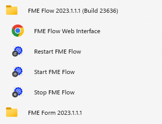

Note: If you are unsure of the correct port number, from the Start Menu select the “FME Flow Web Interface” shortcut on the system that has FME Flow installed. The interface will then load correctly using the port specified during installation.
