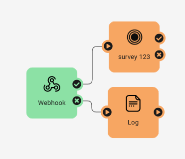

In this section, we will build a real-time pipeline using an FME Flow Automation and an ArcGIS Survey123 webhook. When an inspector submits a form, Survey123 sends the payload to FME Flow, which will trigger an FME Form workspace. That workspace parses the submission, sends any attached photos to an AI vision service for condition assessment, flags potential data quality issues, and writes the enriched record to a database.

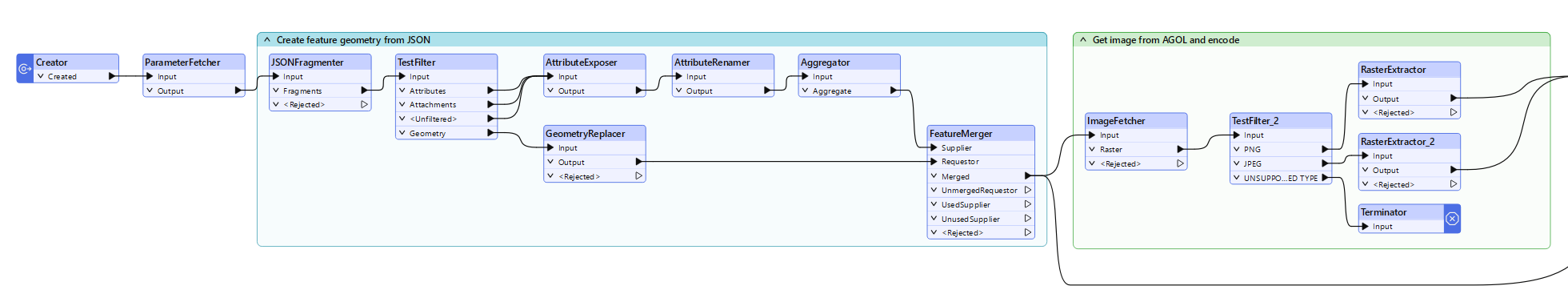

1. Set Up the FME Flow Automation and Survey123 Webhook

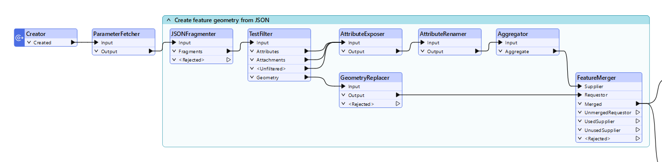

The first step in this workflow is to connect ArcGIS Survey123 to FME Flow via a webhook. Follow Parts 1 through 4 (until you finish Part 3 Step 8) of the article Push Data from ArcGIS Survey123 to an Application in Real-time with Webhooks to:
  • Create a Webhook Trigger automation in FME Flow
  • Register the webhook endpoint in ArcGIS Survey123
  • Create the first portion of the workflow to parse the JSON payload
Return to this article once you have completed Part 3. By this point, your Form workspace should look similar to this:

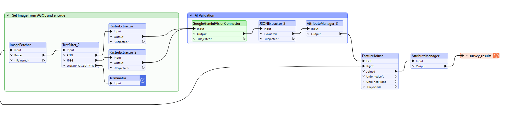

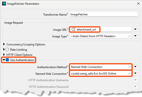

2. Fetch the Image Attached to the Survey123 Submission
To fetch the survey photo that was submitted with the Survey123 report, we’ll add an ImageFetcher to the canvas with the following parameters set:
Select your Esri ArcGIS Online web connection for this transformer to fetch the image.

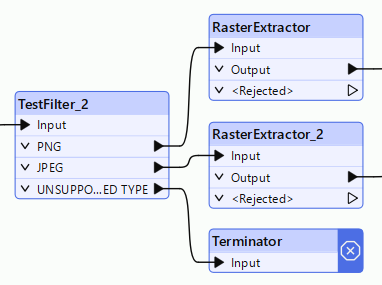

3. Filter by Image Type

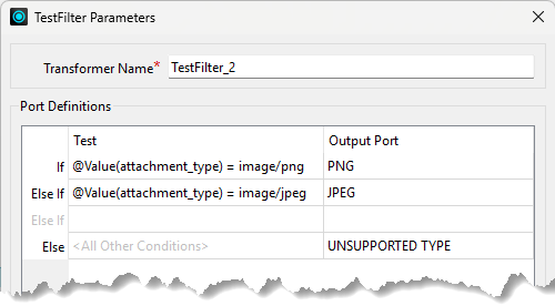

For this workflow, we’ll accept two image formats: PNG and JPEG. Use a TestFilter to sort the following 3 output ports:
4. Extract the Images Into a BLOB
Because the AI service expects raster input rather than a raw attachment, we first extract the image payload into a raster BLOB.
Connect a RasterExtractor to the TestFilter's PNG output port. Select PNG as the Format in the parameters.
Connect a second RasterExtractor to the TestFilter's JPEG output port. Select JPEG as the format.
Connect a Terminator to the “UNSUPPORTED TYPE” output port of the TestFilter. This will stop the translation if an unsupported image type is fed through the workflow.
5. Connect to AI Vision Service
Here, we feed the extracted raster to the AI Vision service. For example, we’ll use Google Gemini through the GoogleGeminiVisionConnector custom transformer available on the FME Hub.
Set the Input Type to Raster Geometry, then select the GoogleAI Parameters:

6. Parse the AI response
Since the AI returns a single JSON response rather than individual attributes, we need to extract each attribute to write it to the database.
Set the following parameters in a JSONExtractor to extract the target attributes:
JSON Document: _response
Target Attribute JSON Query
objectid JSON["objectid"]
ai_rating JSON["ai_rating"]
ai_flag JSON["ai_flag"]
confidence JSON["confidence"]
detected_asset_type JSON["detected_asset_type"]
reasons JSON["reasons"]

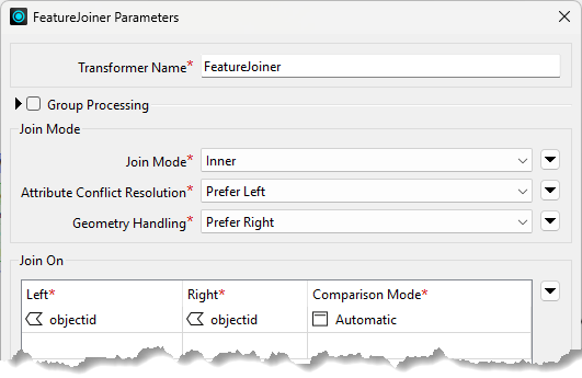

8. Join the Image with the Survey Point
To link the extracted raster back with our survey point data, we’ll use a FeatureJoiner set up like below:

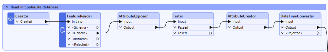

1. Read the Database
Because this workspace will be automated in FME Flow, we need a user parameter to specify the SpatiaLite database created in Part 1.
Add a Creator transformer, then connect a FeatureReader. Set the following parameters:
  • Format: SpatiaLite
  • Dataset: User parameter (so the database path can be configured at runtime on FME Flow)
  • Output Ports: Single Output Port

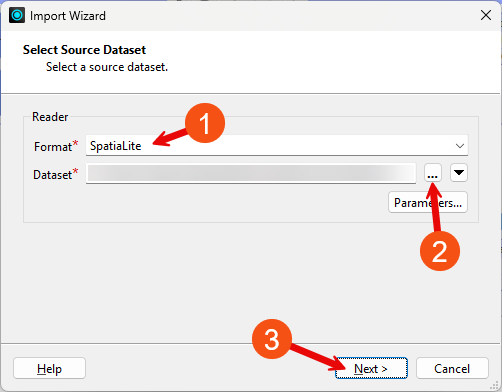

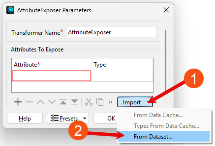

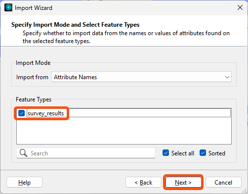

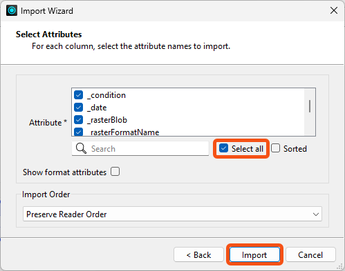

The database schema is not expected to change, so we can manually expose the attributes. Add an AttributeExposer transformer. In its parameters, click Import > From Dataset, then:
1. Select SpatiaLite as the format and
2. Browse to your SpatiaLite database file
3. Click Next, and ensure the feature type is selected
1. Click Select all to select all attributes
2. Click Import, then click OK

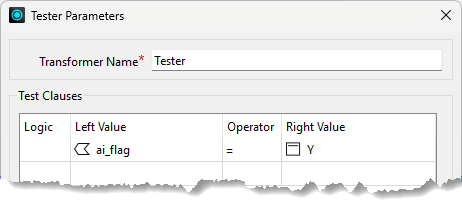

2. Filter For Flagged Records
We only want AI-flagged records to continue downstream. Filter using a Tester to only keep records where ai_flag = Y:

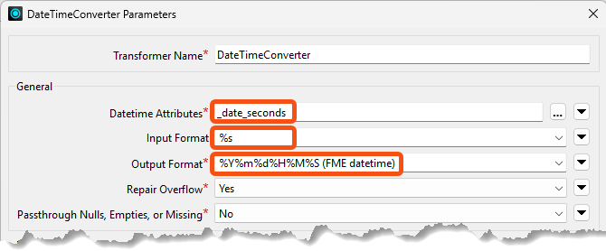

3. Convert the Database Date Attribute
Survey123 timestamps are stored in epoch milliseconds. We need to convert them to FME datetime format for date range filtering.
Add an AttributeCreator to create a new attribute called _date_seconds with the following value: @div(@Value(_date),1000).
Then connect a DateTimeConverter with the following settings:
Your workflow should look like this. Feel free to group this section in a bookmark:

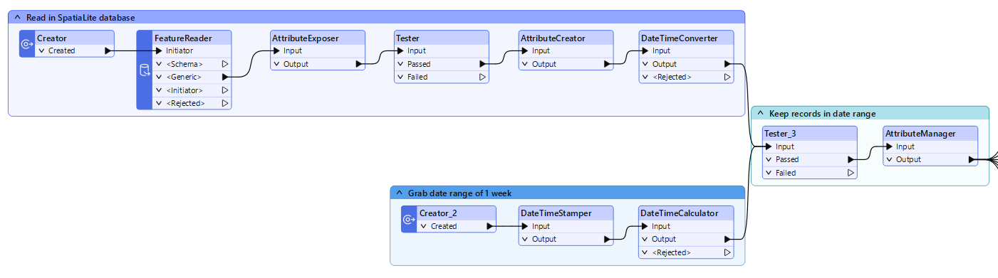

4. Grab the Report Date Range

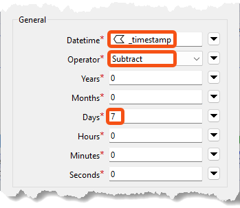

Because this workspace runs on a weekly FME Flow schedule, we need to dynamically calculate the start of the previous week at runtime.
Start with a Creator, then connect a DateTimeStamper with the default settings.
After, connect a DateTimeCalculator. Subtract 7 days from the time given by the DateTimeStamper to get the beginning of our 1-week range.
5. Keep Records Within Date Range
Now that we have both the converted submission dates and the 7-day window, we can filter to keep only records that fall within the past week and have a Tester. Connect the output ports of both the DateTimeConverter and the DateTimeCalculator to it.
Within the Tester, set the following test clause:
  • Left Value: _date_seconds
  • Operator: In Range
  • Right Value: [@Evaluate(@Value(_result_datetime)),@Evaluate(@Value(_timestamp))]
After the Tester, use an AttributeManager to remove the following attributes:
  • _date, _creation_instance, _timestamp, _result_datetime
Feel free to use bookmarks to group your workspace. Your workflow should look similar:

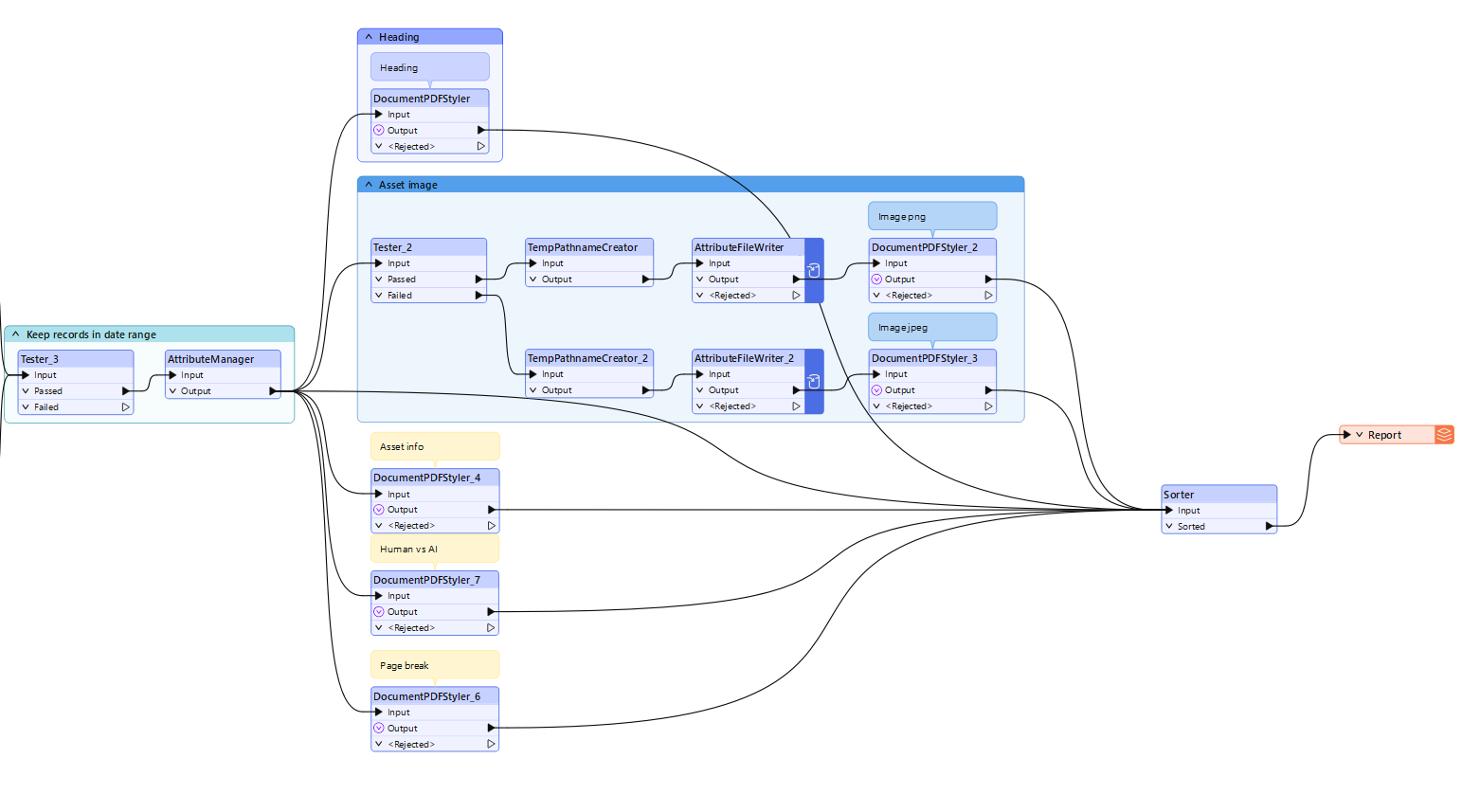

6. Format PDF Document
For the PDF report, use the DocumentPDFStyler transformer to apply formatting. Refer to the prerequisite article Getting Started with Document PDF Writing for detailed guidance on configuring the DocumentPDFStyler.
The report workspace uses the following sections, each styled with a DocumentPDFStyler:
  • Heading: A title block for the report
  • Asset Image: Writes each inspection photo to a temporary file using an AttributeFileWriter (via TempPathnameCreator), then feeds it to a DocumentPDFStyler as an image element. Two branches handle PNG and JPEG images separately.
  • Asset Info: A text block showing the Asset ID and inspection timestamp

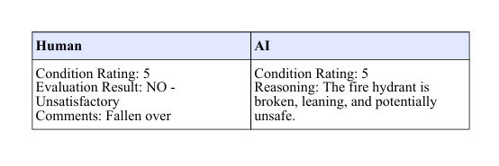

  • Human vs AI Table: A table showing the inspector’s rating and evaluation alongside the AI rating and reasoning

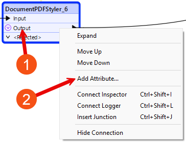

You can add attributes directly to an output port of a transformer. Right-click on a transformer’s output port, then select Add Attribute. Use this to determine the order in which the PDF document sections show up in the final output.
For the example workflow, an attribute named content_order was added to each DocumentPDFStyler, numbered in ascending order in the following order from 1 to 6:
  • Heading, PNG image, JPEG image, Asset Info, Human vs AI Table, Page Break
Connect all DocumentPDFStylers to a Sorter transformer to order the report records. Also, connect the AttributeManager's output port to the Sorter.

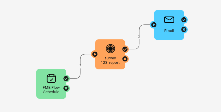

8. Set Up the FME Flow Schedule and Email Action

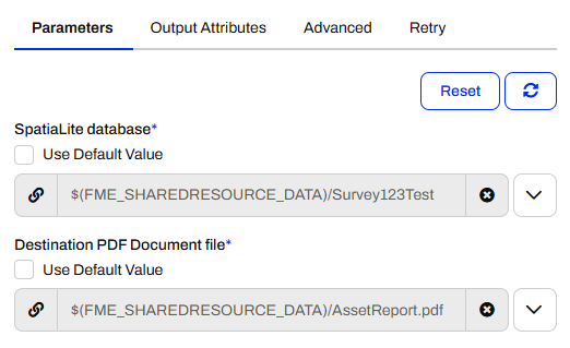

Publish the report workspace to FME Flow. Then create a new automation to run it weekly and email the resulting PDF to reviewers. For guidance on setting up the Email action in FME Flow, please refer to this article.
In FME Flow, navigate to Automations and create a new automation:
  • Trigger: FME Flow Schedule set to run weekly, eg, Monday at 8 AM.
  • Action: Run Workspace and select the report workspace published above. Ensure the parameters are set to use the resources published onto Flow.

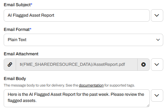

  • Action: Send Email
    • Set up your mail service, for example, Gmail.
    • Then, configure the subject, format, attachment, and body:
The Flow Automation should look similar to this:
Should you wish, you could also include an error-handling flow in the automation.

The final report presents each AI-flagged asset on its own page, including the inspection photo, inspector rating, evaluation, AI rating, and reasoning.
