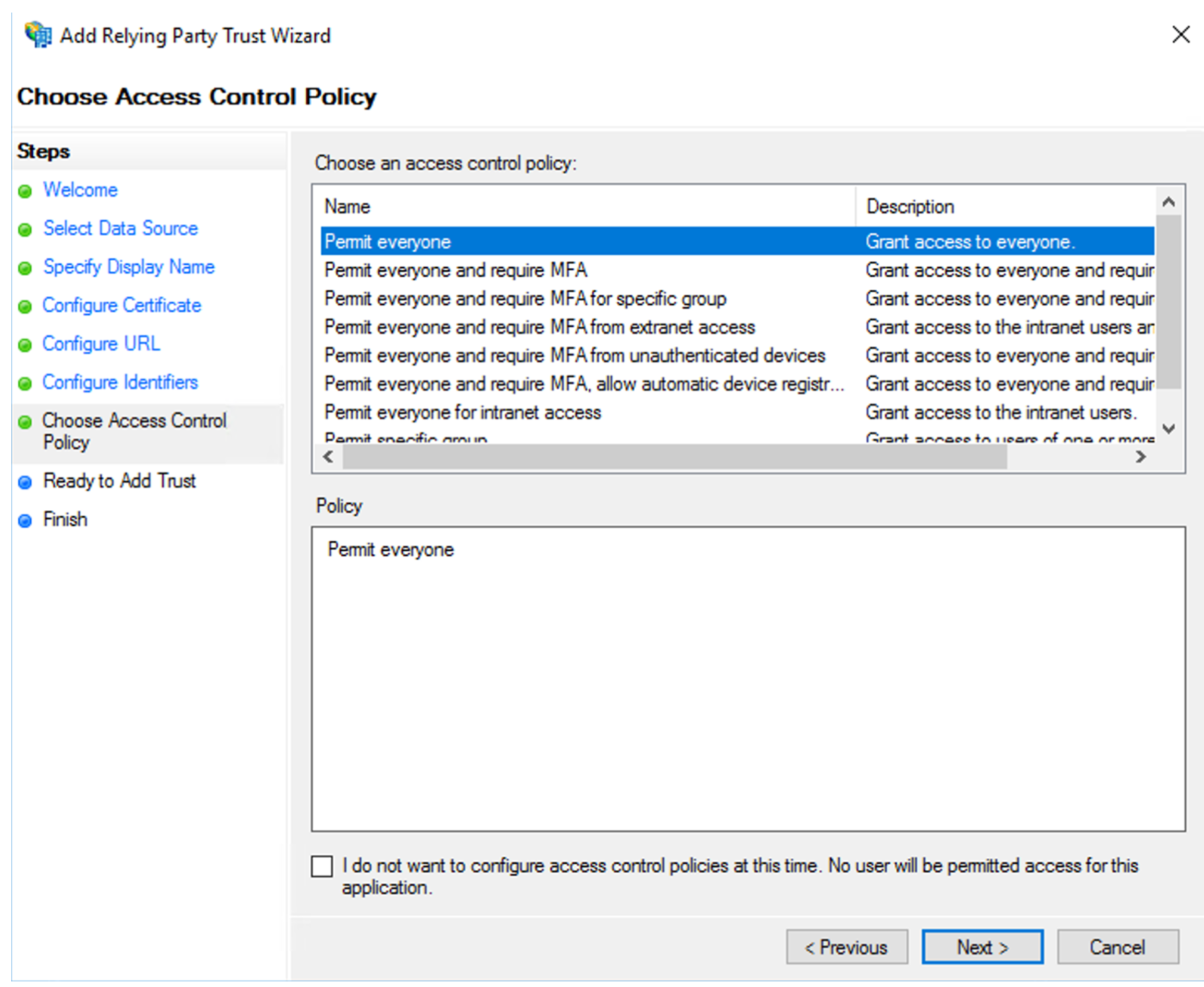

1. Open AD FS Management, right-click Relying Party Trusts, and select Add Relying Party Trust.
2. On the Wizard Settings:

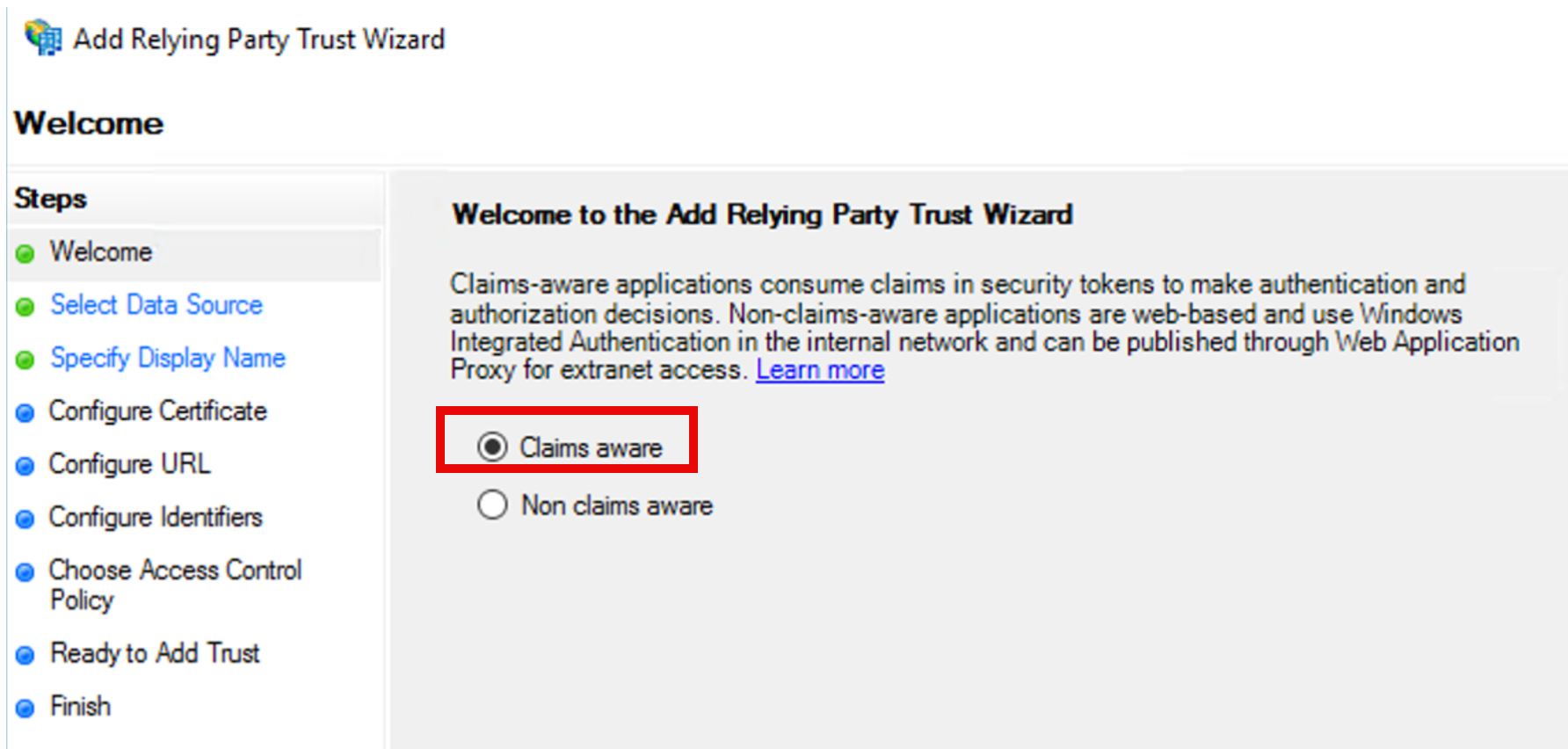

Select "Claims aware".

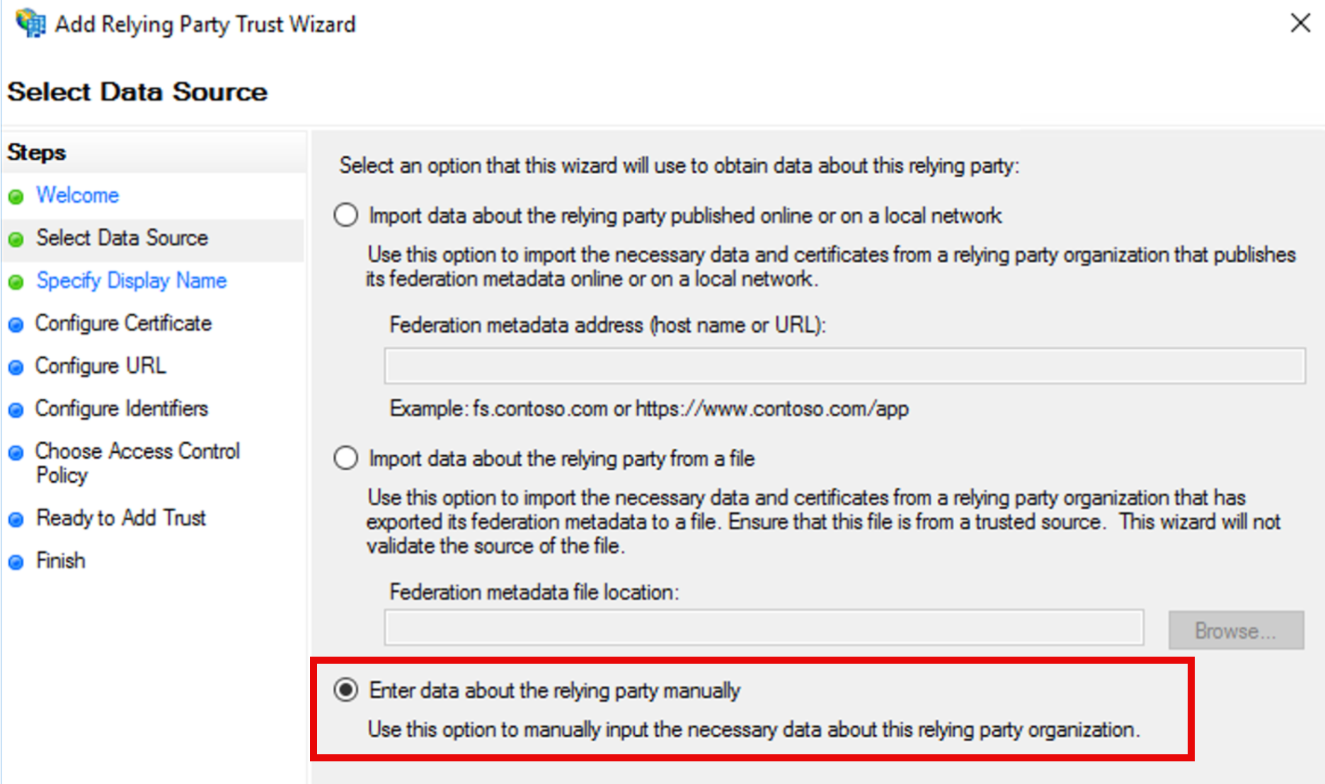

Choose "Enter data about the relying party manually".

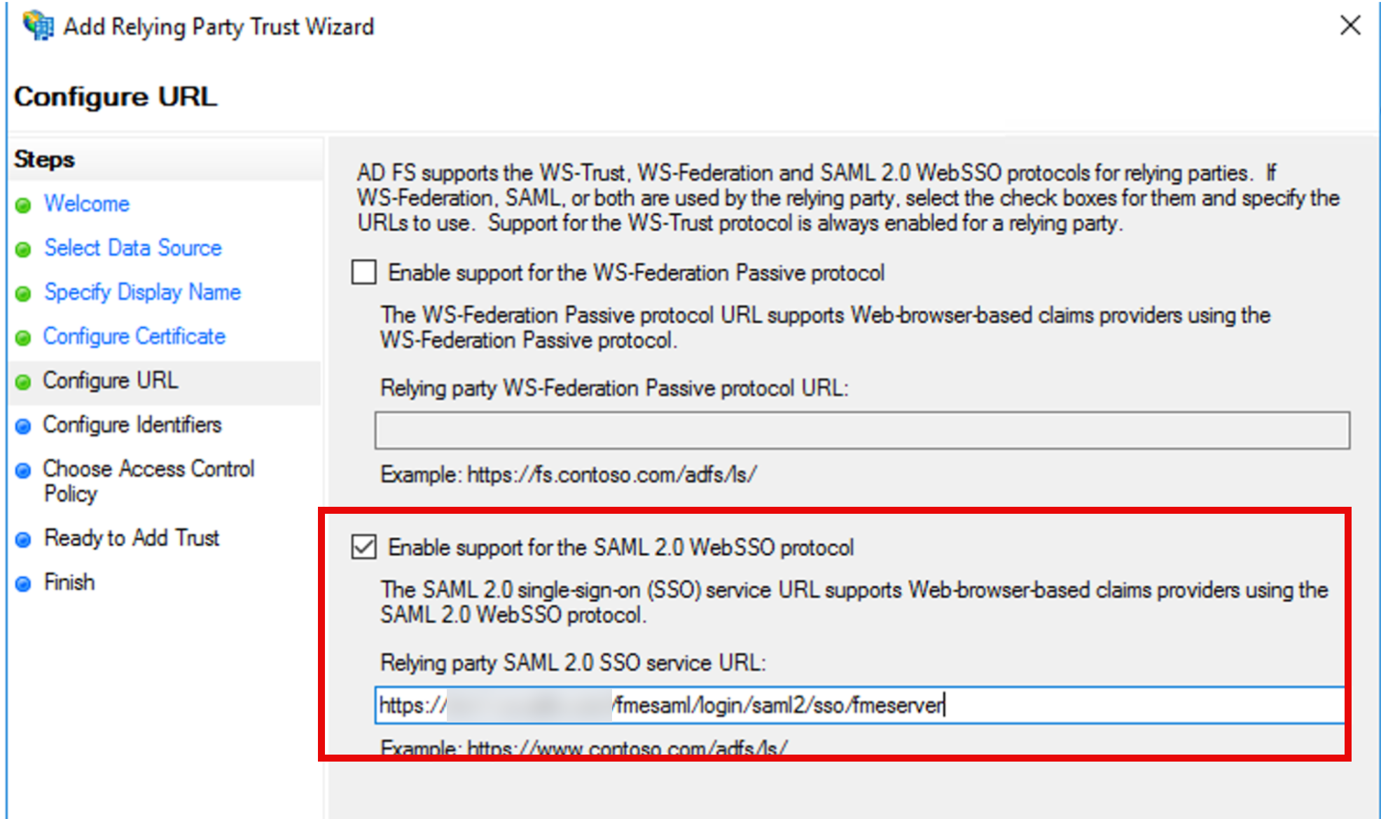

On the Configure URL page, check "Enable support for the SAML 2.0 WebSSO protocol". For Service URL, provide the Single Sign-On URL (ACS URL) as displayed on the FME Flow "SAML Configuration" webpage.

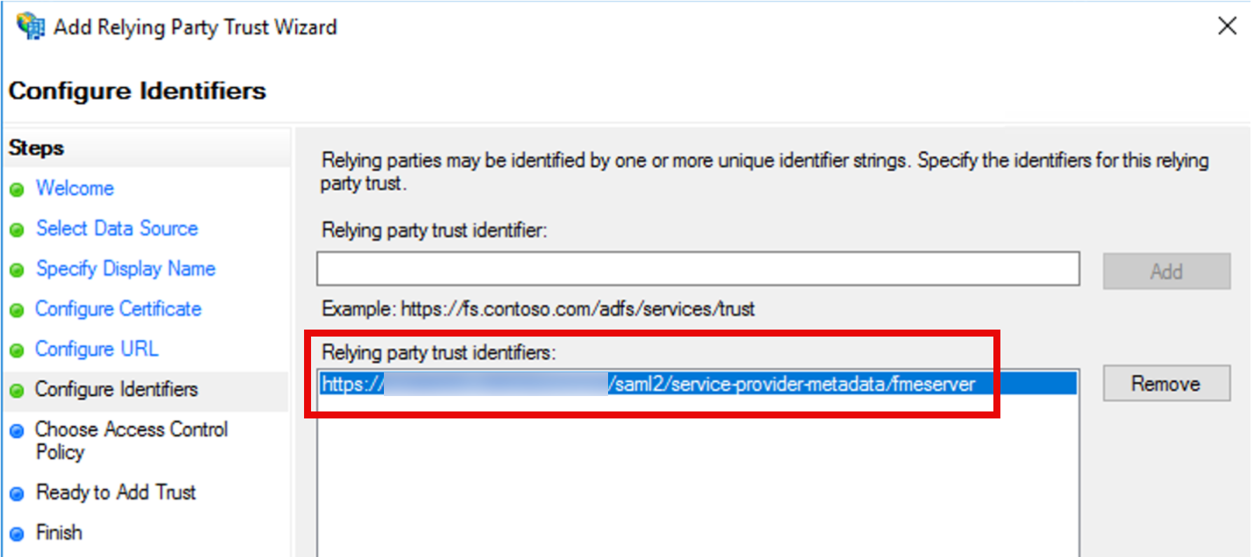

Add the Entity ID (Audience URI) from FME Flow "SAML Configuration" webpage as the Relying party trust identifier.
Choose Permit everyone or specify restricted groups.

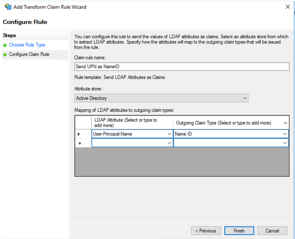

3. [OPTIONAL]Set Claim rules to map which user attributes (like Username or Email) to send to FME Flow. In the Edit Claim Issuance Policy window, click Add Rule.

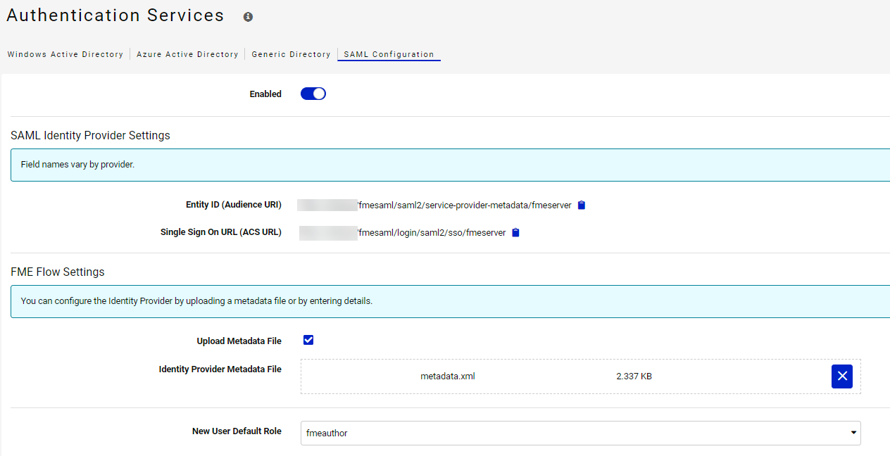

1. Open FME Flow
Open and log in to FME Flow. Navigate to User Management  SAML Configuration
2. Import SAML
Import your IdP Metadata or provide the certificate and values.
Select the default user role you wish users to have when they log into FME Flow. FMEFlowMetaData.png

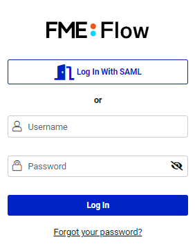

1. Log Out of FME Flow

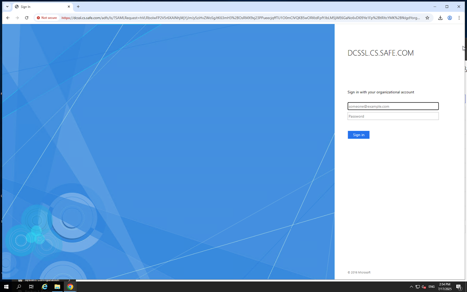

Log out of FME Flow, and you should now have the option to Log In With SAML. Once selected, you should be prompted to the ADFS Sign-in page; enter your credentials, and if the configuration is correct, you should be redirected back to the FME Flow home page.
Confirm that the user can log in and that the role and user information are as expected.
