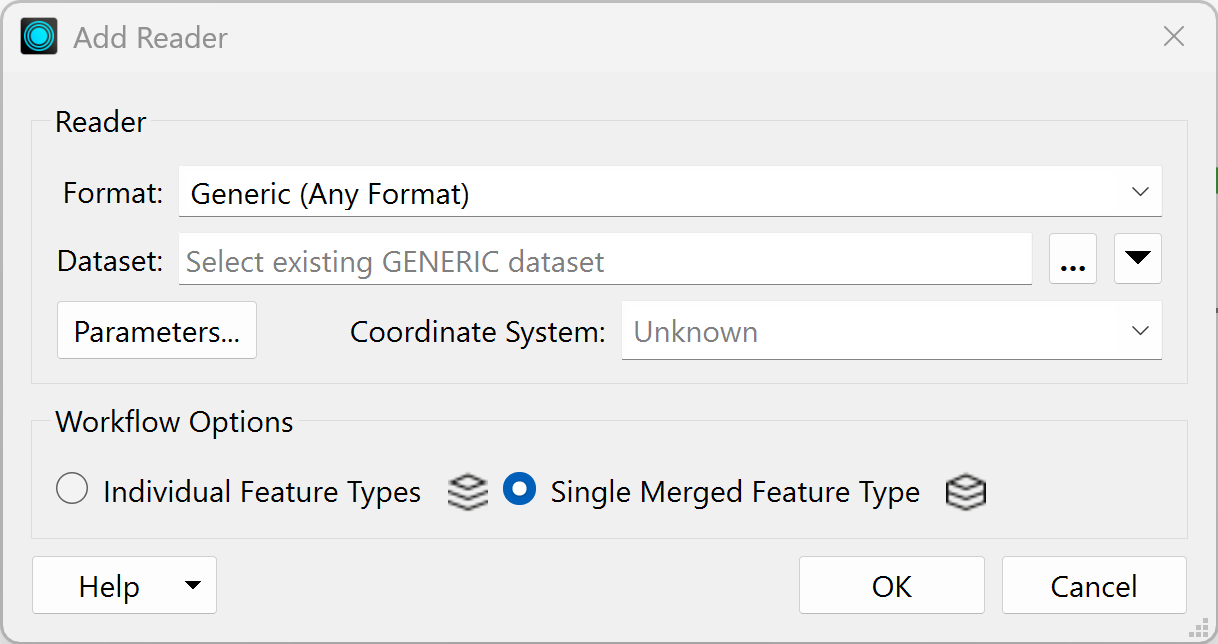

1. Add a Generic Reader
Open FME Workbench and create a new workspace. The first step in the workflow is to read in the source data using a dynamic reader. If the input data will always be in the same format, you can use a hard-coded format for your reader. In this example, we will use a Generic Reader, which will allow the workspace to accept any input file.
Add a Reader to the workspace and set the parameters as follows:
  • Format: Generic (Any Format)
  • Workflow Options: Single Merged Feature Type
Click OK to add the Generic Reader to the workspace.

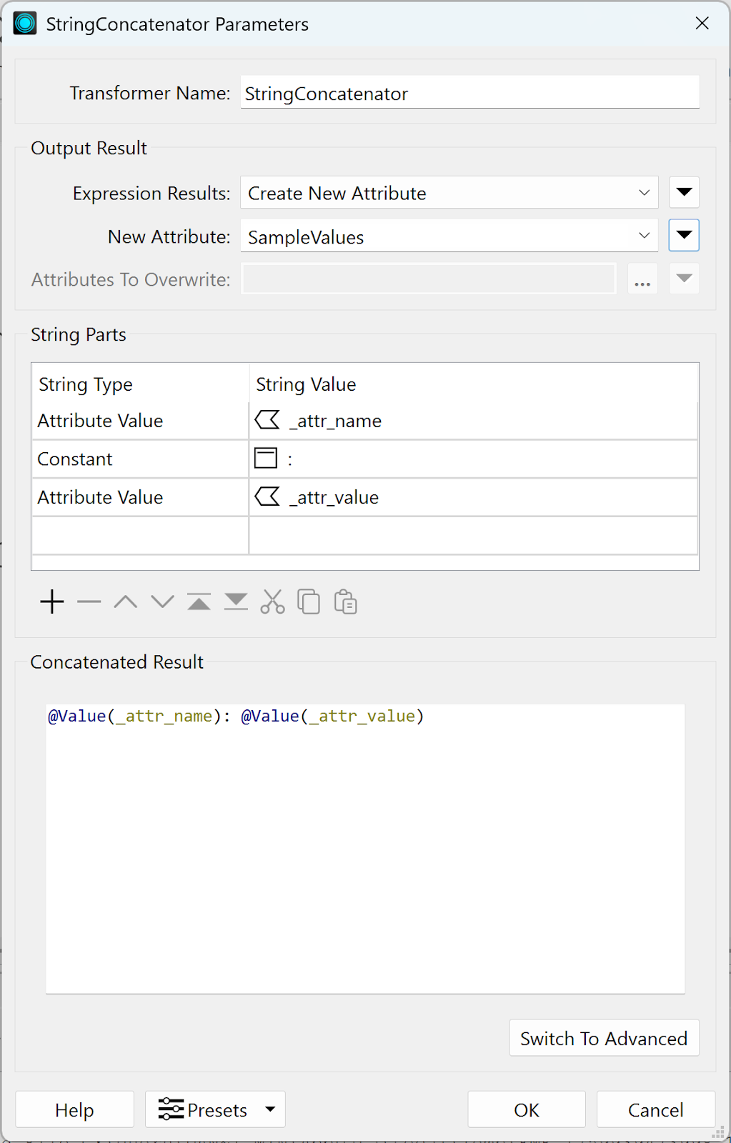

5. Add a StringConcatenator
Add a StringConcatenator to the workspace. Connect it to the AttributeExploder. Open the parameters and set it as follows:
  • Expression Results: Create New Attribute
  • New Attribute: SampleValues
  • String Parts:
    • String Type: Attribute Value
      • String Value: _attr_name
    • String Type: Constant
      • String Value: :
      • String Value: _attr_value
The Concatenated Results will show as: @Value(_attr_name): @Value(_attr_value)
Click OK to accept the new parameters.

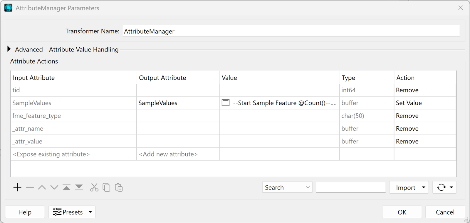

7. Add an AttributeManager
Add an AttributeManager to the workspace and connect it to the Aggregator. Open the parameters and set the following:
  • Update Attribute:
    • Input Attribute: SampleValues
      • Value:
        --Start Sample Feature @Count()--
        @Value(SampleValues)
        --End Sample Feature–
  • Remove Attribute:
    • Input Attribute: tid
      • Action: Remove
    • Input Attribute: fme_feature_type
      • Action: Remove
    • Input Attribute: _attr_name
      • Action: Remove
    • Input Attribute: _attr_value
    • Action: Remove
Click OK to accept the parameters.

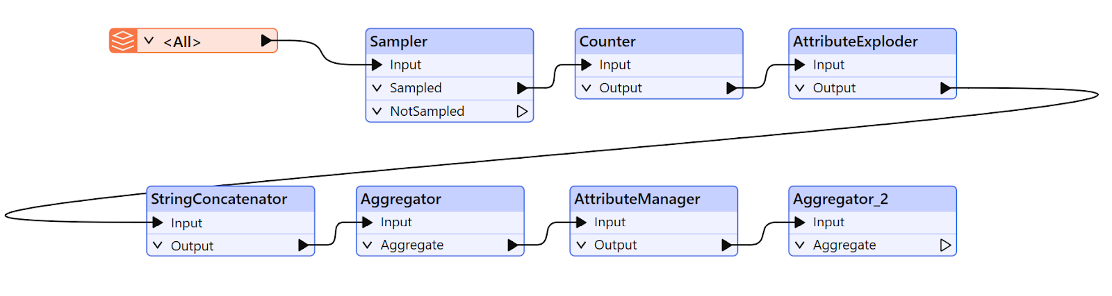

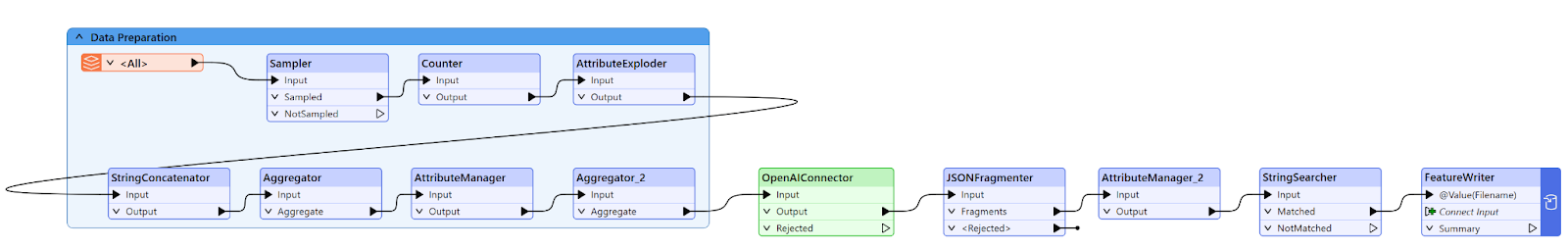

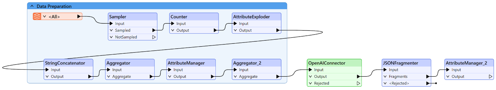

Your workspace should now look like this:

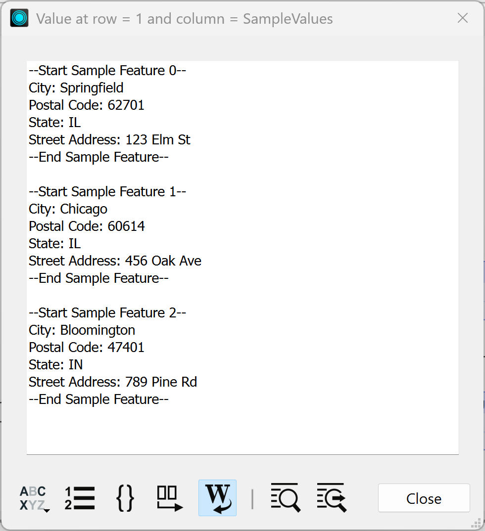

With Data Caching enabled, run the workspace with the SpatialExample1.json file.
After finishing, inspect the output of Aggregator_2 in the Visual Preview window. You should see the following result:
You have successfully transformed the raw, individual features into a single aggregated record. The data is now ready to be passed to the AI service.

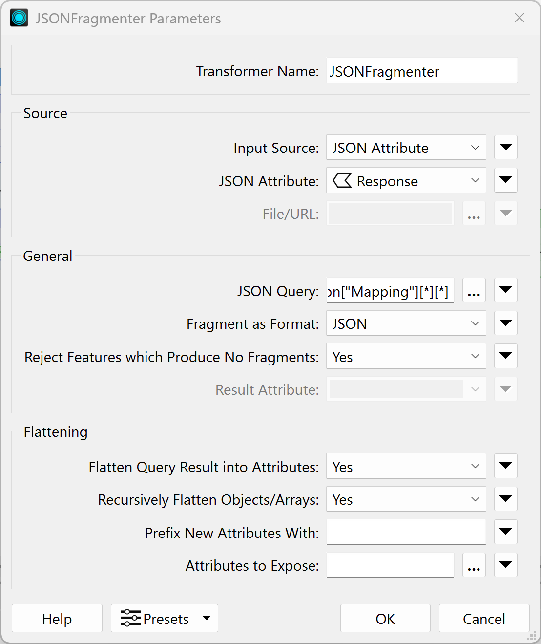

1. Add a JSONFragmenter
This final step creates the lookup table by extracting mappings from the AI's JSON response. Add a JSONFragmenter to the workspace and connect it to the OpenAIConnector. Open the parameters and set them as follows:
  • Input Source: JSON Attribute
  • JSON Attribute: Response
  • JSON Query: json["Mapping"][*][*]
  • Flatten Query Results into Attributes: Yes
  • Recursively Flatten Objects/Arrays: Yes

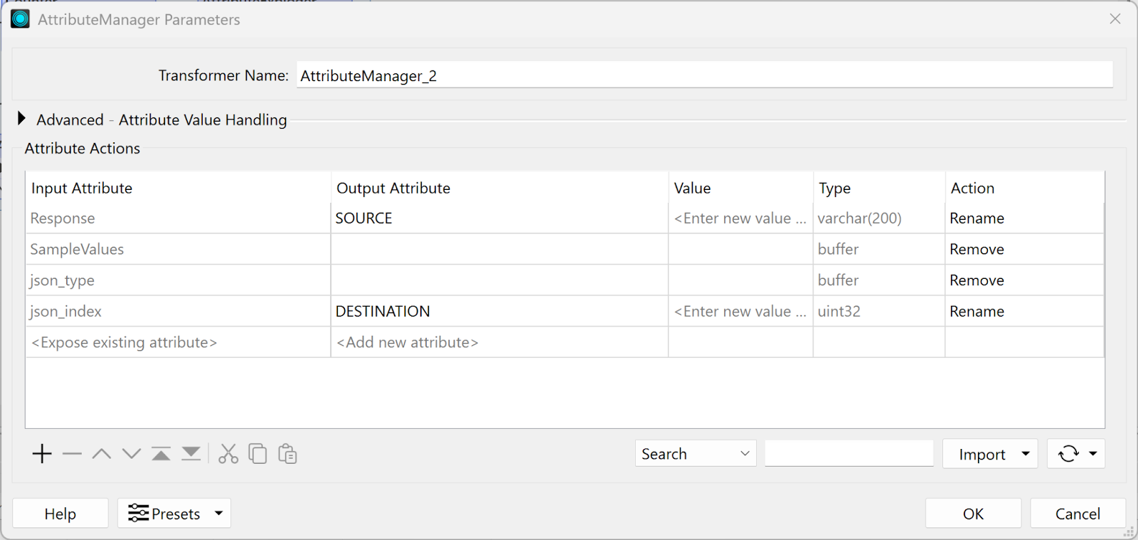

2. Add an AttributeManager
Add an AttributeManager to the workspace and connect it to the JSONFragmenter. Open the parameters and set them as follows:
  • Update Attribute:
    • Input Attribute: Response
      • Output Attribute: SOURCE
  • Update Attribute:
    • Input Attribute: json_index
      • Output Attribute: DESTINATION
  • Remove Attribute:
  • Remove Attribute:
    • Input Attribute: json_type
Your workspace should now resemble this.

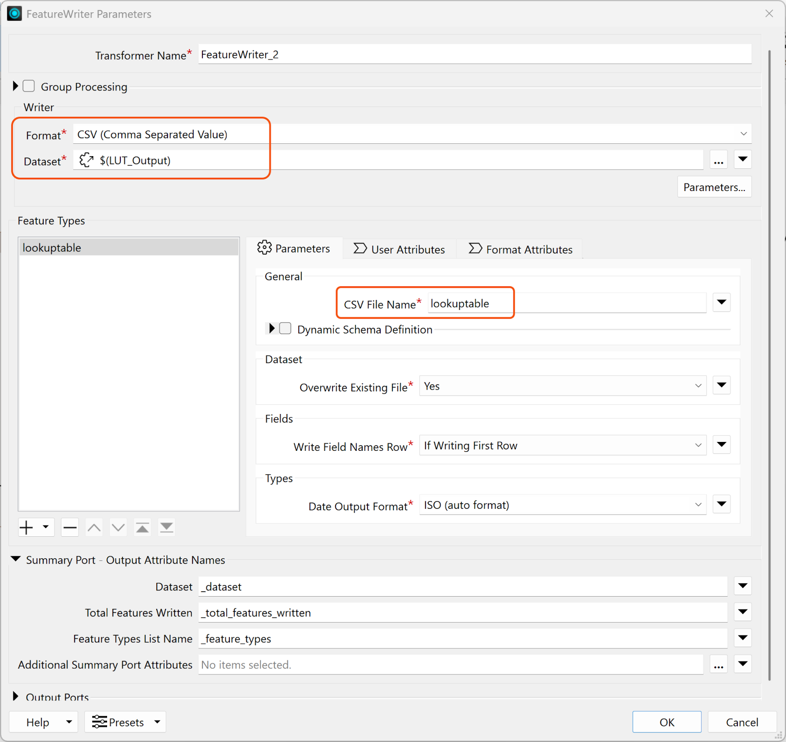

3. Add a FeatureWriter
Add a FeatureWriter to the workspace and connect it to the AttributeManager. Open the FeatureWriter parameters and set them as follows:
  • Format: CSV (Comma Separated Value)

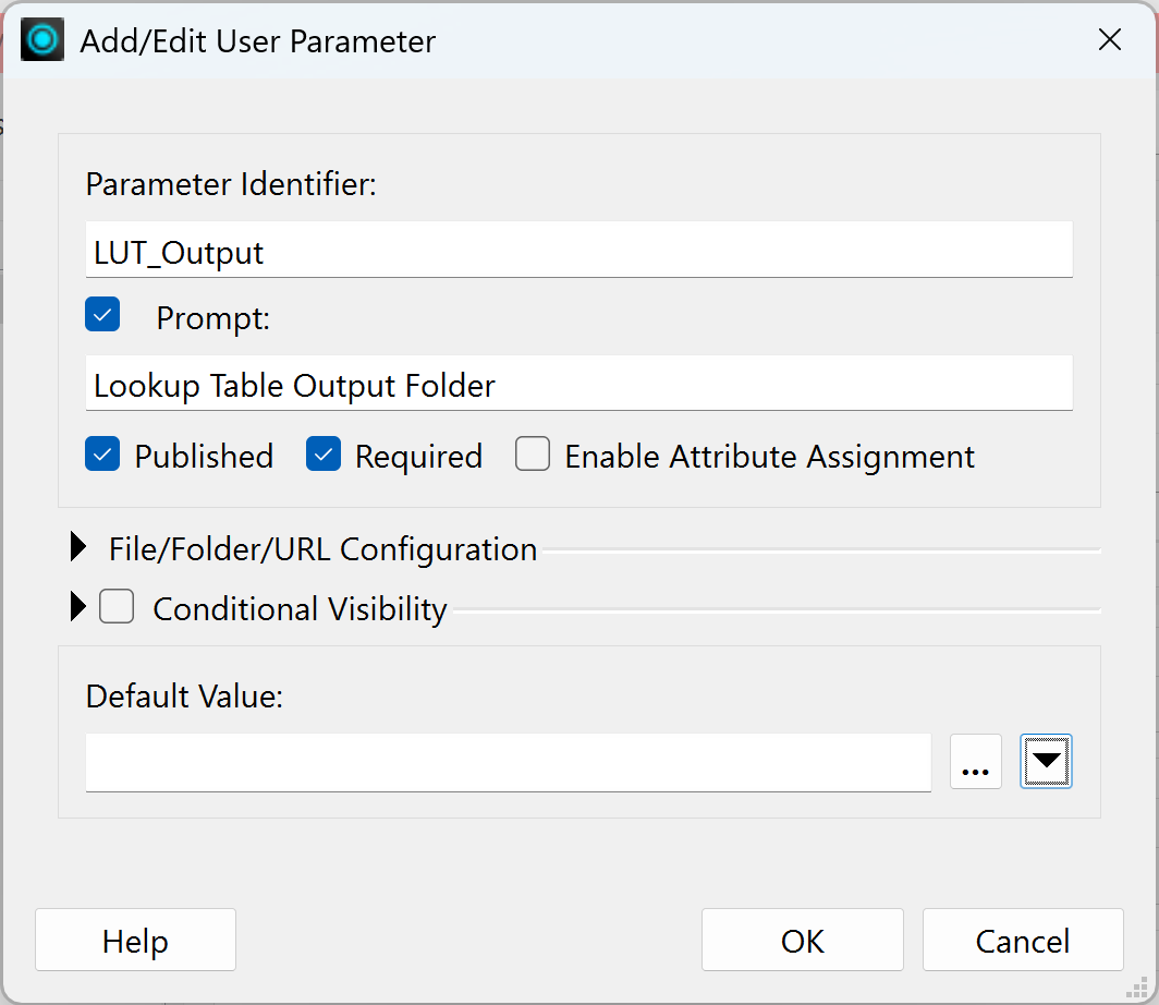

  • Dataset: select the drop-down arrow > User Parameter > Create User Parameter. Set the parameters as follows:
    • Parameter Identifier: LUT_Output
    • Prompt: Lookup Table Output Folder
Click OK to add the user parameter.

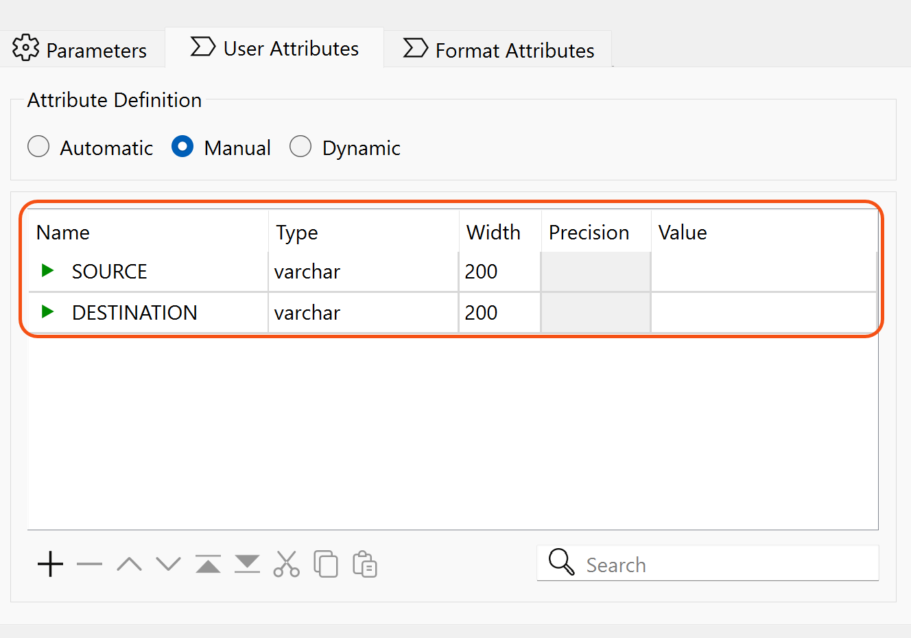

  • CSV File Name: lookuptable
Click on the User Attributes tab and set the Attribute Definition to Manual.
We only want the SOURCE and DESTINATION fields in our output dataset, so remove any others that may be present.
Make sure that the Type for both attributes is set to varchar 200.
The complete workspace should look something like this.

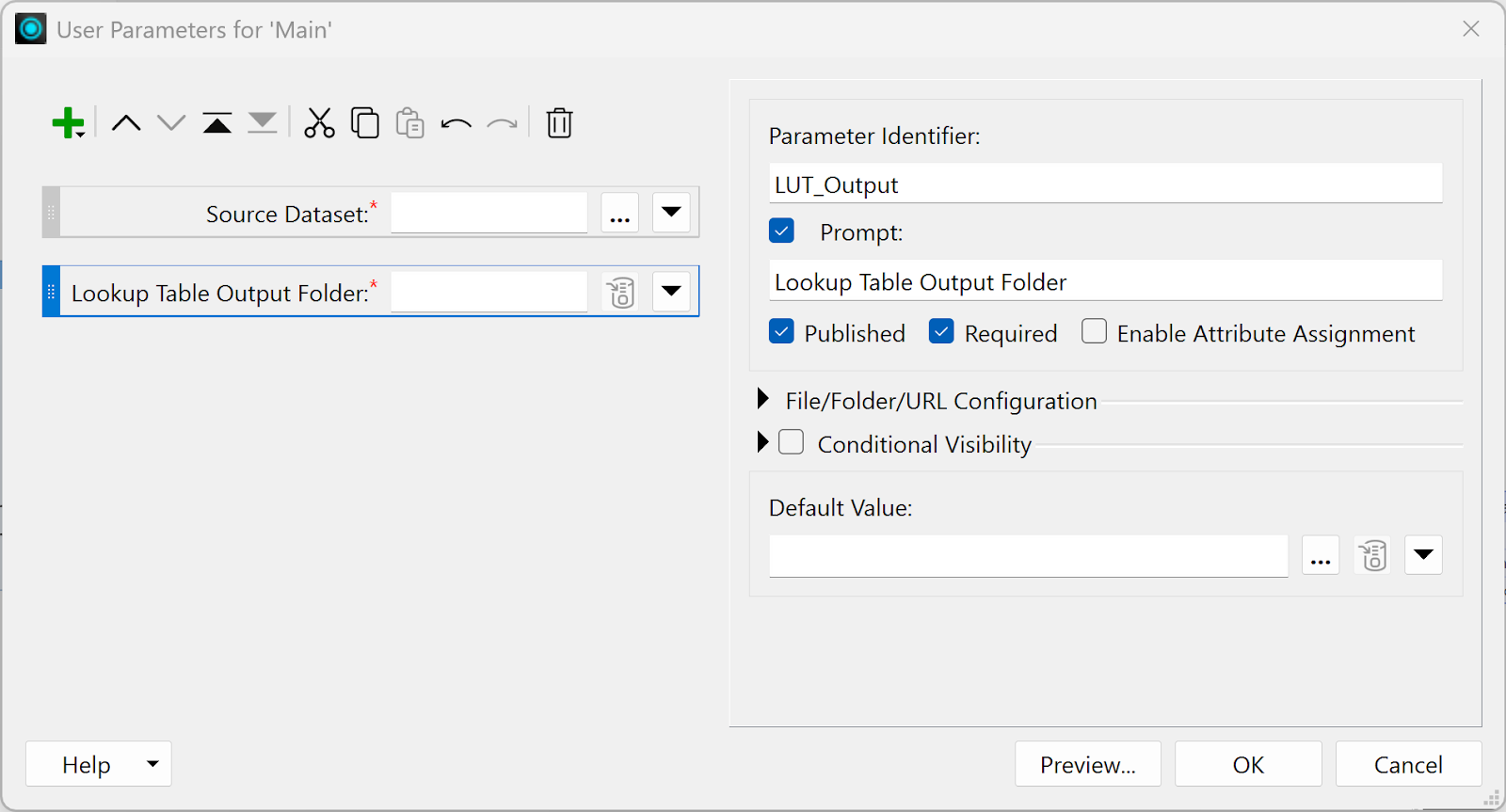

4. Configure the User Parameters
Before running the workspace, the user parameters need to be cleaned up so that users are only prompted for the Source Dataset and the Lookup Table Output Folder.
  • In the navigator window, right-click on User Parameters and select Manage User Parameters.
  • Select the Feature Types to Read parameter and delete it.
  • You should be left with just the two parameters mentioned previously. Source Dataset and Lookup Table Output Folder
Click OK to accept the parameters. Save your workspace.

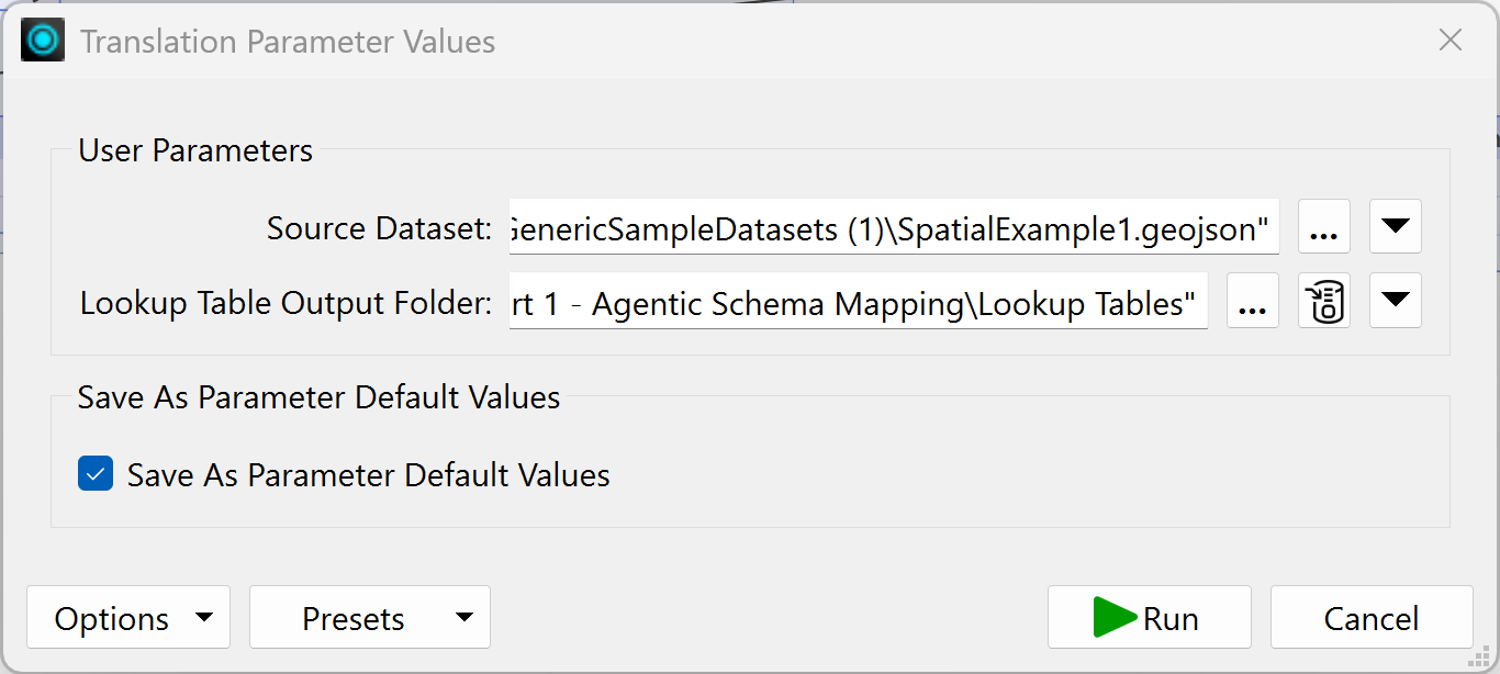

5. Test the workspace
The final step is to test the workspace to ensure that the OpenAIConnector generates the correct format for the lookup table and that the rest of the workspace can extract data from the JSON output and write it to a CSV file.
Click Run. When prompted, specify a Source Dataset and a Lookup Table Output Folder. For the source dataset, you can use one of the sample datasets available to download in this article.

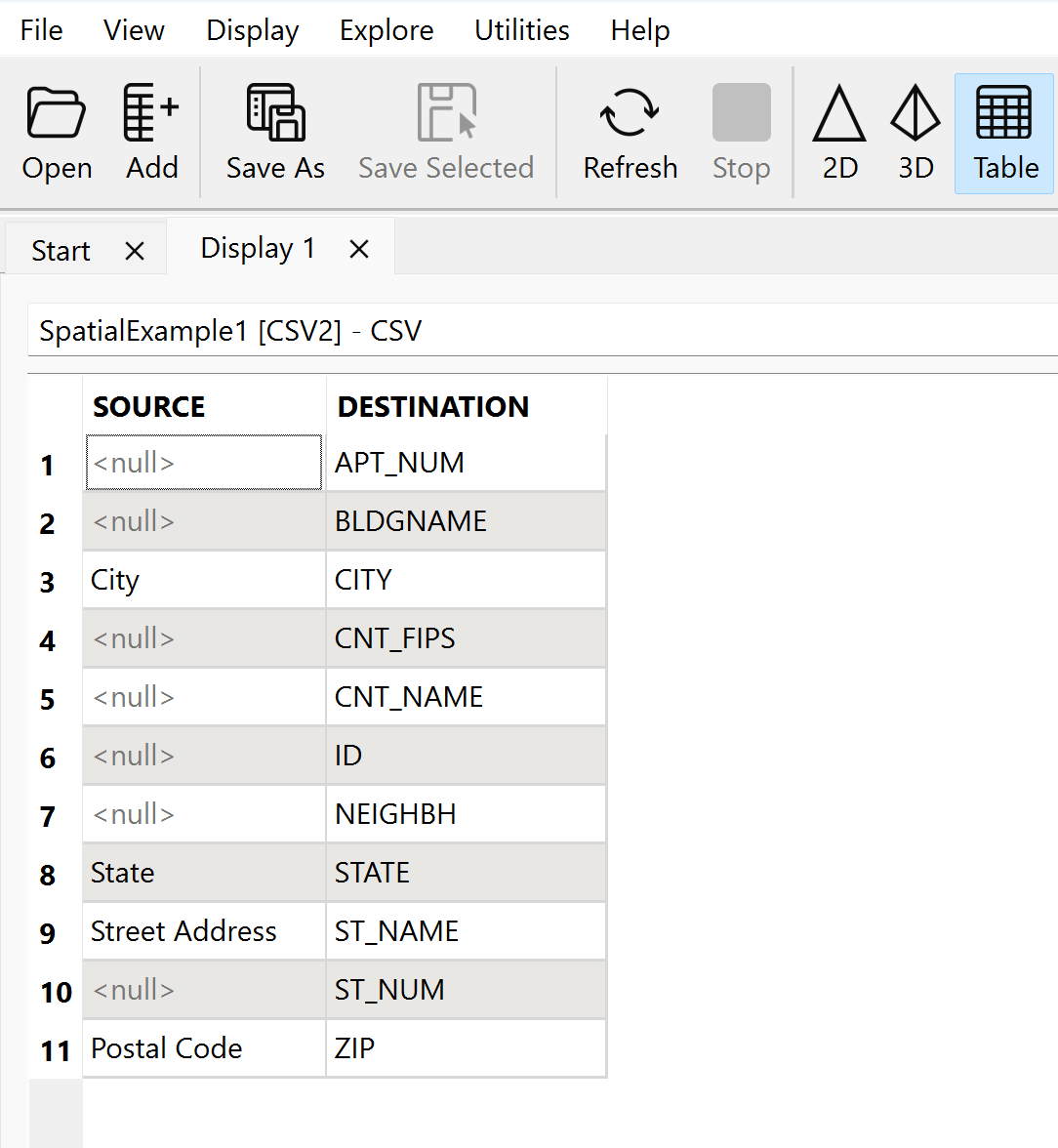

Once the workspace has finished running, locate the output folder and open the CSV file in the FME Data Inspector. Depending on the dataset you selected, you may get different results.
If a matching field is not found in the source dataset, then it will be left as <null> in the output.
