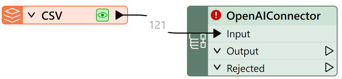

Transformers in FME will process an action once per feature. In other words, AI connectors run a query row‑by‑row. As a result, a single prompt can yield varied answers for each input feature.

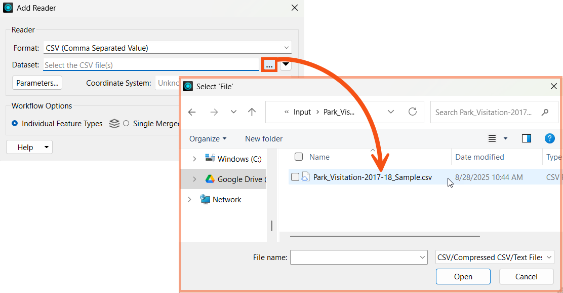

1. Open a new workbench in FME Form
Download the data Park_Visitation-2017-18_Sample.csv, then add the data using a CSV Reader. Set the following parameters in the reader:
  • Format: CSV (Comma Separated Value)
  • Dataset: Park_Visitation-2017-18_Sample.csv
    • Click on the ellipsis to navigate to the file location on your computer

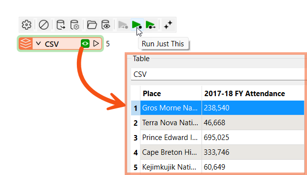

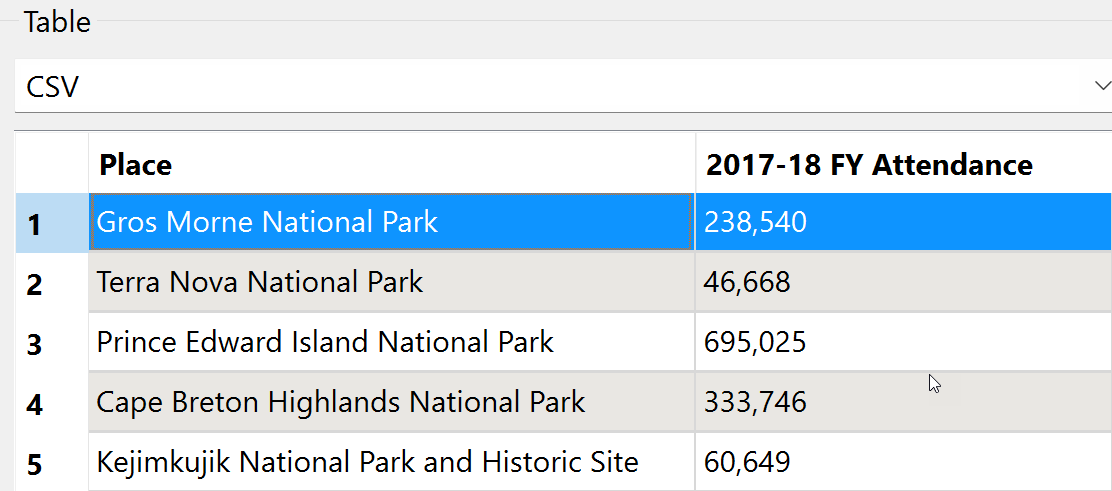

2. Run the Workspace
Check the data preview using the green eye icon on the reader.
The Data Preview shows our simple dataset with 5 rows of features with two attributes:
  1. Place - the park names
  2. 2017-18 FY Attendance - the number of visitors in a fiscal year
2. Add an OpenAIConnector to the Canvas
The OpenAIConnector is a custom transformer that is not included with FME. You can download this package from the FME Hub.
This connector automatically defaults to the latest OpenAI model; however, you can enrich this dataset with any preferred model or AI service.

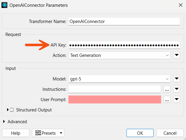

3. Configure the OpenAIConnector
Double-click on the OpenAIConnector transformer to open the parameters. Under the Request heading, you can enter your API key.
Besides the API Key, the User Prompt is the only other required parameter. For this example, most other parameters can be left either blank or as the default, like Action as Text Generation.

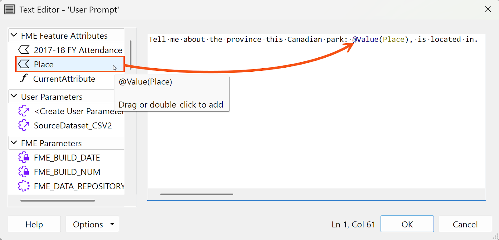

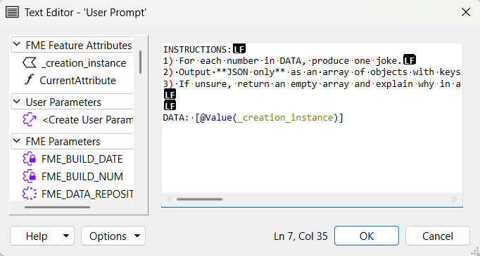

3. Create the User Prompt
Click the three dots next to User Prompt to open the Text Editor
The User Prompt’s Text Editor is a simple interface for building prompts. It allows you to reference and combine references to FME objects like feature attributes and user parameters, to be replaced by real values from the dataset.
4. Create the Prompt in the FME Feature Attribute

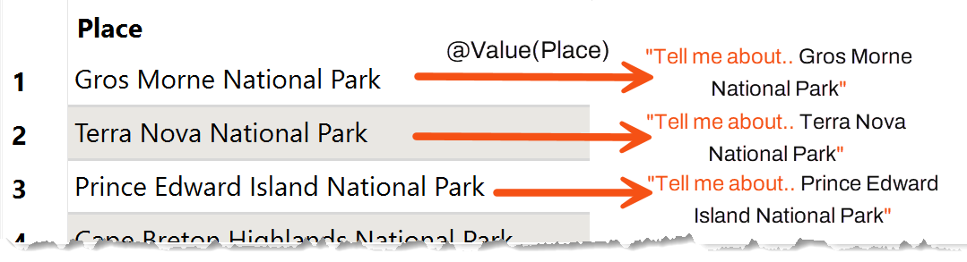

Using the FME feature attribute, Place, in the Text Editor, create the prompt:
Tell me about the province this Canadian park: @Value(Place), is located in.
@Value(Place) is a reference to the feature attribute, Place. It is essentially a placeholder that references the features in the Place column, specifically each park or site in this dataset. At runtime, the prompt replaces the corresponding features in each row of the Place column to generate a unique query.
For example, if the 'Place' value is 'Banff National Park', the prompt for that feature becomes: 'Tell me about the province this Canadian park: Banff National Park, is located in.'

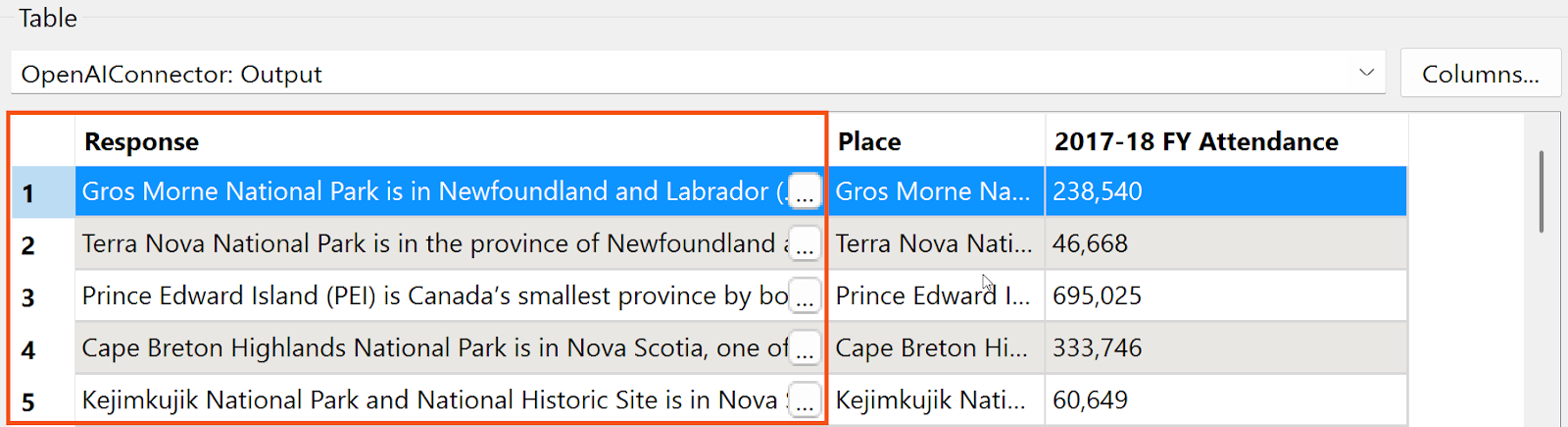

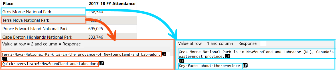

4. Run the Workspace Again
Look at the Data Preview. The result is a new Response attribute with 5 rows of responses corresponding to each Place feature.
Notice that the same prompt produced slightly varied answers for each park feature, like this case for the first two Newfoundland and Labrador parks, which had noticeable differences in wording, content, and response length.
This varied output can be desirable in some cases, but we can maintain more consistency and predictability by implementing prompting techniques and tips.

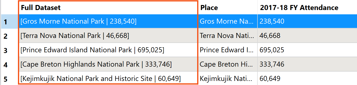

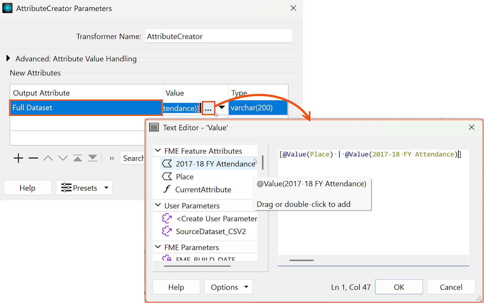

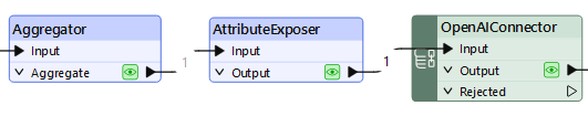

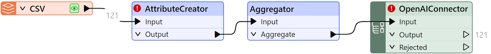

Insert an Attribute creator and Aggregator between the Creator and OpenAIConnector
Double-click on the AttributeCreator to open the Parameters window. Set the following:
  • Output Attribute: Full Dataset
  • Value: [@Value(Place) | @Value(2017-18 FY Attendance)]
Referencing the attributes Place and 2017-18 FY Attendance this way will clearly indicate to the model which park and attendance values correspond to each other.

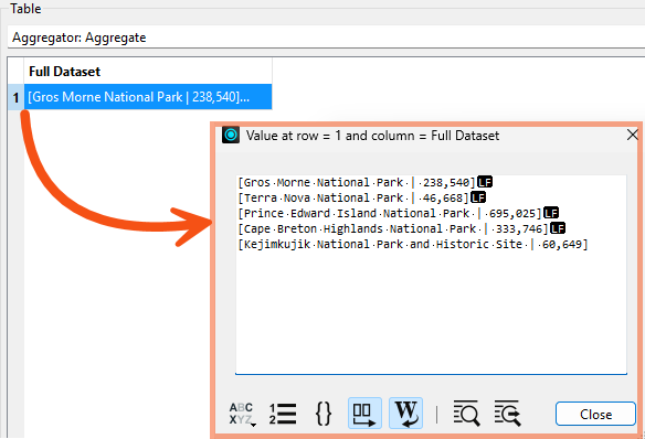

2. Run and View the AttributeCreator Output:
You’ll see that after runtime, the feature attributes referenced, Place and 2017-18 FY Attendance, are combined within the Full Dataset attribute.

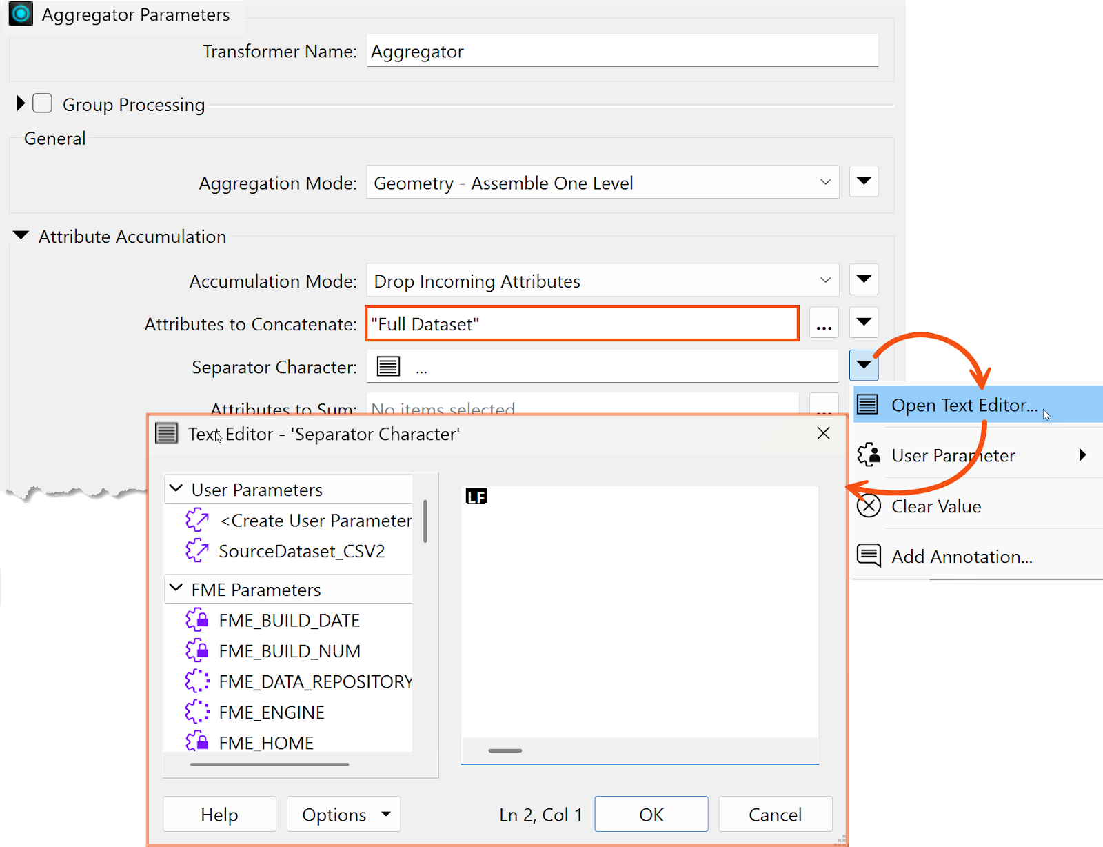

3. Configure the Aggregator Parameters:
Double-click on the Aggregator transformer to open the Parameters and set the following:
  • Attributes to Concatenate: Full Dataset
  • Separator Character:  Open Text Editor, then click the tab button
Run the workspace again and view the Aggregator output:
The dataset is even more self-contained, with all the data within one feature in the Full Dataset column. This will make it easier to pass all the necessary information as context to the AI model.

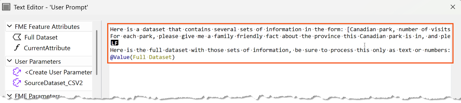

4. Update the User Prompt in the OpenAIConnector
Return to the User Prompt parameter, then replace the old prompt with:
Here is a dataset that contains several sets of information in the form: [Canadian park, number of visits per year].
For each park, please give me a family-friendly fact about the province this Canadian park is in, and please tell me if the corresponding number of visits is 100,000 or above 100,000.
Here is the full dataset with that set of information. Be sure to process this only as text or numbers:
@Value(Full Dataset)

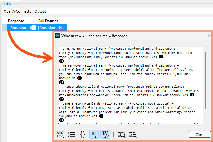

5. Run and View the Connector Output
The output shows much more consistent content. However, while it is approachable, conversational, and flexible, it still has several issues:
  • Ambiguous scope → Mentioning “Canadian parks” resulted in the model ignoring historic sites that were also in the dataset.
  • Unstructured output → the free-form bullet points that aren’t easily parsable.
  • Visitor count missing → The prompt didn’t mention retaining the original data, so the output is harder to verify against the source data.
  • Extra narrative text → Added extra headings and notes, “Here are the parks..”
  • No error/confidence handling → Model guessed provinces without a way to signal uncertainty.
  • Vague threshold wording → “100,000 or above 100,000” is redundant; no explicit categories were defined, so responses were inconsistent.

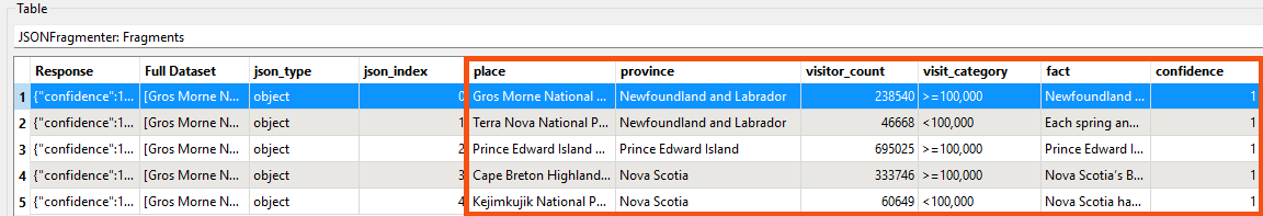

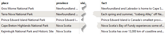

Part 3: Rework the Prompt Utilizing Structure
In this section, we improve our current prompt for an output that is more structured, auditable, and automation-ready. Also, adding some structure to your actual user prompt not only helps the model break down and understand your request better, but also helps with future user readability and maintenance.
1. Update the User Prompt
Next, we want the output to take on a structure and require JSON. To achieve this, we will update the user prompt:
TASK
1. You will receive a dataset with entries in the format: [Place | visitor count], where each entry is separated by an enter tab.
2. For each entry, output one object with these keys
   - "place": string (the place name)
   - "province": string (the province or territory)
   - "visitor_count": integer (the numeric visitor count)
   - "visit_category": string (either "<100,000" or ">=100,000")
   - "fact": string (a family-friendly fact about the province/territory)
   - "confidence": number (decimal between 0.1 and 1.0; 1.0 = high confidence)
RULES
- Parse numbers from text, e.g., "1,131,418" → 1131418.
- Set "visit_category" based on visitor_count and the 100,000 threshold.
- If the province/territory is uncertain, output your best guess and lower "confidence".
- Do not add keys beyond the six listed above.
- The final output MUST be a single JSON array only, with no additional commentary.
DATA
A few key improvements of this prompt are:
  • Clear task framing  → “...entries in the format …” sets the model up
  • Explicit keys  → “... ‘place’  ‘province’...” adds structure
  • Rules section → Details parsing numbers, threshold logic, uncertainty handling, and schema adherence, ensuring we cover edge cases
  • Avoids irrelevant information → not mentioning “Parks” avoids limiting the scope to exclude historic sites and landmarks

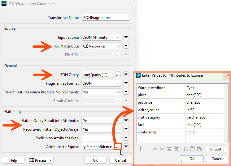

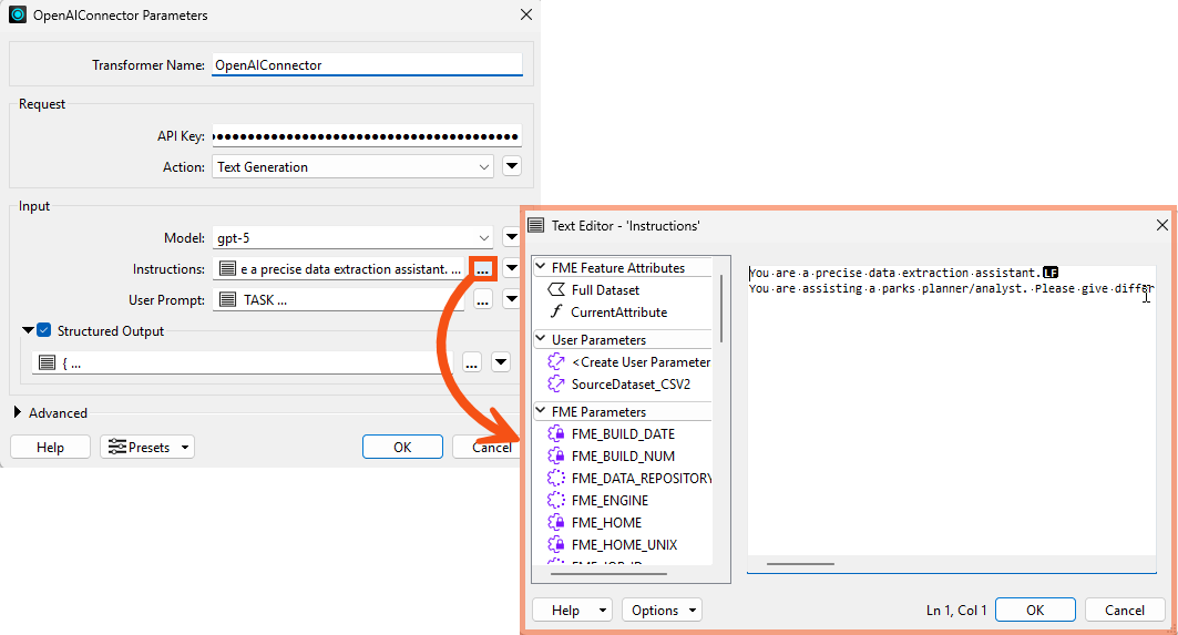

2. Adjust OpenAIConnector Parameters

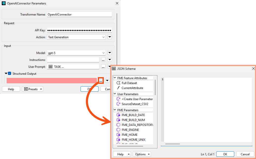

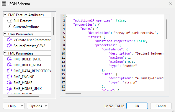

Return to the parameters to enable the Structured Output, then open the JSON Schema editor

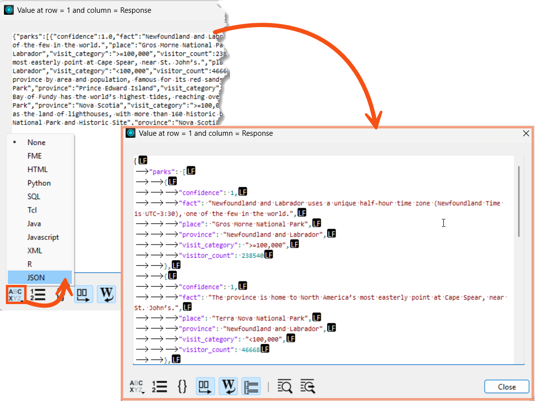

3. Add the JSON Schema:
Using the JSON Schema parameter adds a stricter assertion on the output structure.
"additionalProperties": false,
"properties": {
"parks": {
"description": "Array of park records.",
"items": {
"properties": {
"confidence": {
"description": "Decimal between 0.1 and 1.0, where 1.0 = high confidence.",
"maximum": 1,
"minimum": 0.1,
"type": "number"
"fact": {
"description": "A family-friendly fact about the province/territory.",
"type": "string"
"place": {
"description": "The name of the place.",
"type": "string"
"province": {
"description": "The province or territory where the place is located.",
"type": "string"
"visit_category": {
"description": "Categorization of visit count.",
"enum": [
"<100,000",
">=100,000"
"type": "string"
"visitor_count": {
"description": "The numeric visitor count.",
"minimum": 0,
"type": "integer"
"required": [
"place",
"province",
"visitor_count",
"visit_category",
"fact",
"confidence"
"type": "object"
"minItems": 1,
"type": "array"

4. Rerun the Workspace and Inspect the Response.
Note: Without this JSON Schema parameter, you might get extra text in the output like: ```json... or Here is your data... While string-manipulating transformers can clean those outputs, the exact response is hard to predict every time, making the process less automated.
To see the structure of the response, turn on JSON Syntax Highlight. Click the ABCXYZ button in the bottom left of the preview and select JSON.
The result shows a parsable response that is much more consistent with the format and content. There is also no additional text outside of the data we wanted to model to return, making downstream formatting much more efficient and predictable.
5. Add a JSONFragmenter
Connect the transformer after the OpenAIConnector and configure the parameters:
  • Source:
    • JSON Attribute: Response
  • General:
    • JSON Query: json["parks"][*]
  • Flattening:
    • Flatten Query Result into Attributes: Yes
    • Recursively Flatten Objects/Arrays: Yes
  • Attributes to Expose:
    • “place”
    • “province”
    • "visitor_count"
    • "visit_category"
    • "fact"
    • "confidence"
6. Run the JSONFragmenter and View the Output.
The JSON transformer parsed the attributes, making for downstream-friendly data for additional processing.
If you need more practice with JSON formats, especially working with more nested ones, please check out our Getting Started with JSON Articles:
Part 4: Add System Prompting Instructions
This section will show how system prompts affect model responses. By assigning the AI model a role or key rules/guides to follow, we can assert how it should understand and complete the task.
1. Open the OpenAIConnector and Configure the Instructions parameter:
You are a precise data extraction assistant.
You are assisting a planner/analyst. Please give different facts for provinces that are listed so that every place has a unique fact, regardless of whether they share the same province.
Key things about this system prompt are:
  • Assigning the AI model a role → “you are a” gives the model a clear goal
  • Giving context to the problem → “assisting an analyst” gives problem context
  • Rules to output → “unique facts” establishes a clear rule for how to respond
2. Run the Workspace and View the Output
You’ll notice that the facts for provinces are different when previously they may have been the same:

The JSON Schema parameter accepts specific formats, so a great tip is to use the schema here as an example, then ask an AI model to create a schema for your project.
Here is an example prompt to get a valid JSON Schema for another project:
I want a JSON Schema for a dataset of Canadian lakes.
- The top-level schema must be an object.
- It should have one property called "lakes", which is an array of lake objects.
- Each lake object must include:
   - "name": string
   - "area_km2": number
   - "is_great_lake": boolean
 Here is an example of what the schema should look like:
  "type": "object",
  "properties": {
    "parks": {
      "type": "array",
      "minItems": 1,
      "items": {
        "type": "object",
        "properties": {
          "place": {
            "type": "string",
          "province": {
            "type": "string",
          "visitor_count": {
            "type": "integer",
            "minimum": 0,
          "visit_category": {
            "type": "string",
            "enum": ["<100,000", ">=100,000"],
          "fact": {
            "type": "string",
          "confidence": {
            "type": "number",
            "minimum": 0.1,
            "maximum": 1.0,
        "required": [
          "place",
          "province",
          "visitor_count",
          "visit_category",
          "fact",
          "confidence"
  "required": ["parks"]
