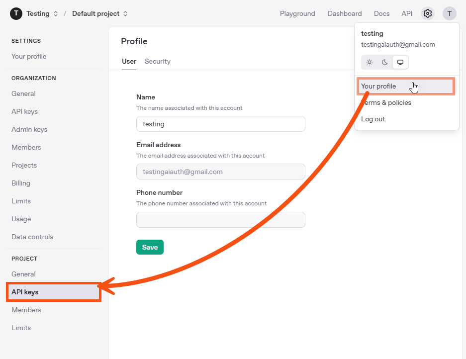

2. Navigate to the API Keys Page
Logging in will redirect you to the API Dashboard or another landing page. If the API/API keys section is not visible on the screen. Navigate to your user profile first, then to the API section in the left sidebar.

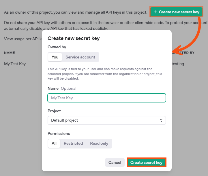

3. Create New API Key

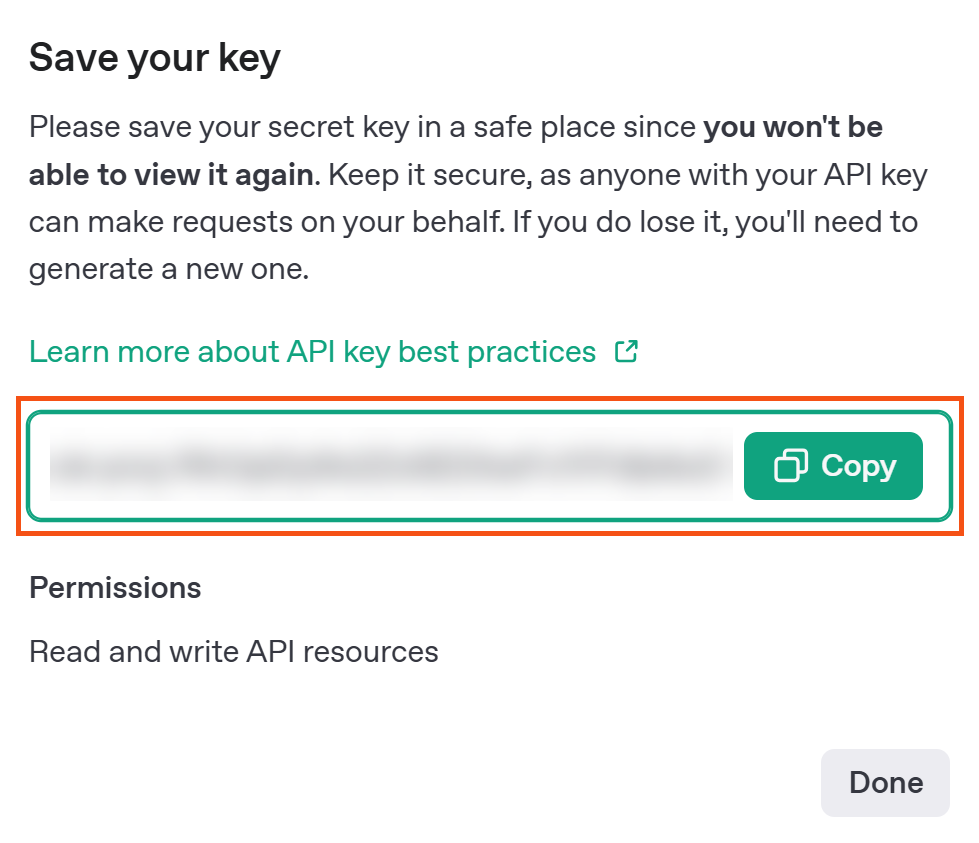

Create a new API key on the API Keys page by clicking either the “Create new secret key” or “Generate key” button. Then, when prompted, assign the project and, optionally, the key name.
Once generated, the key will be displayed only once. Copy and store it securely, such as in a password manager, FME Flow Deployment Parameter, or encrypted environment variable.
After closing this window, the key’s string of characters will no longer be viewable, and if not recorded or lost, a new key needs to be created.

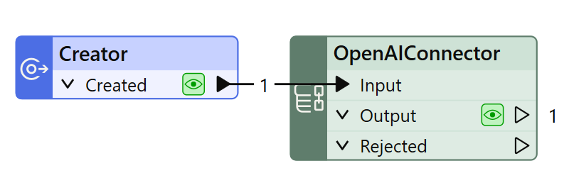

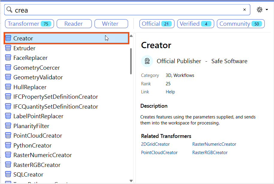

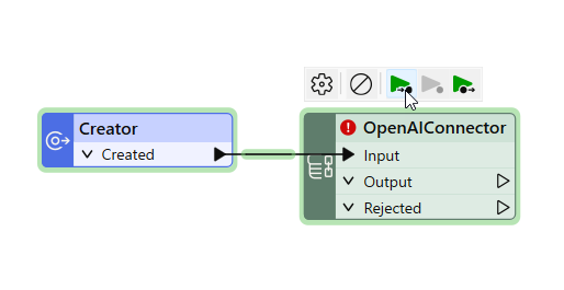

4. Open FME Workbench and Add the Creator
Open FME 2025.0+ and start typing Creator on the canvas to add the transformer.

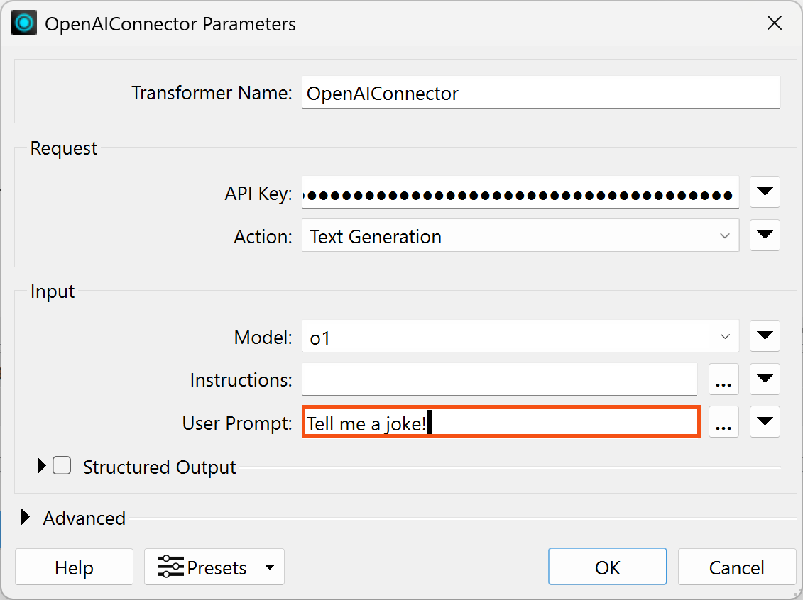

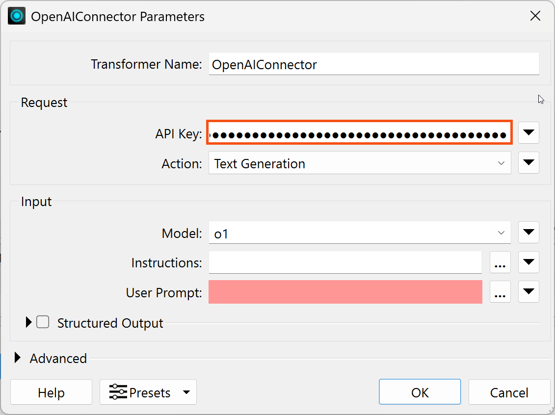

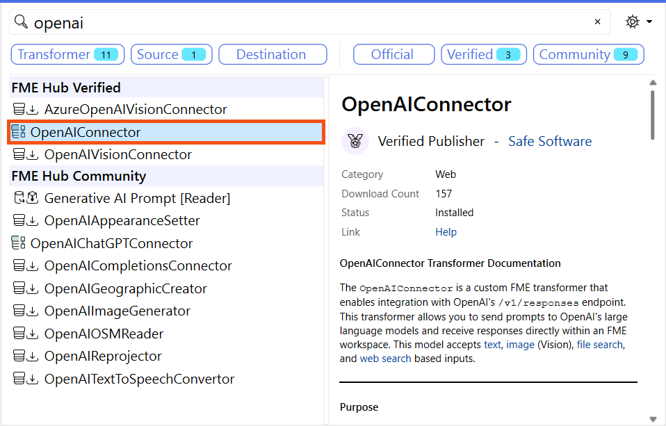

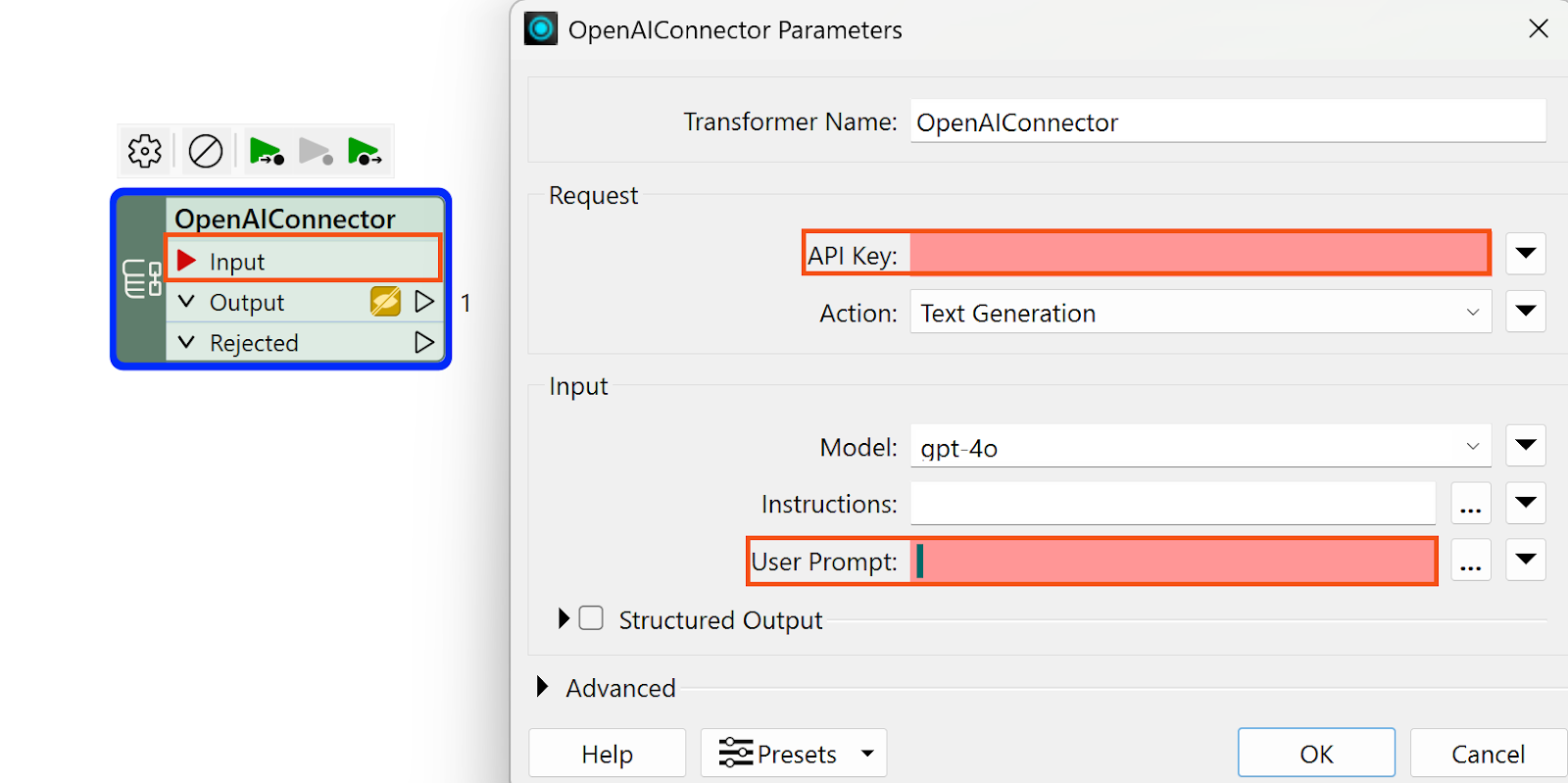

5. Add an OpenAIConnector
Start typing on the canvas to bring up the OpenAIConnector transformer, then add it to the canvas, and import if prompted.
Double-click on the transformer to open the OpenAIConnector parameters and configure them as follows:
  • API Key: <newly generated API Key>
  • User Prompt: Tell me a joke!
Then click OK.
6. Run the Workspace

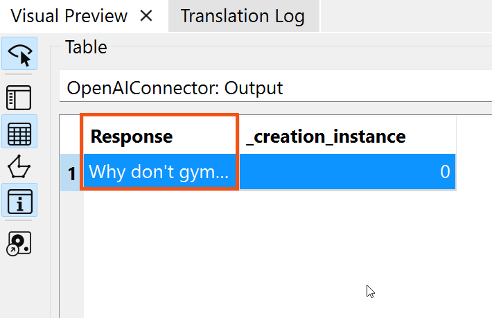

Run the workspace.
View the API response in the Visual Preview under the Response attribute.

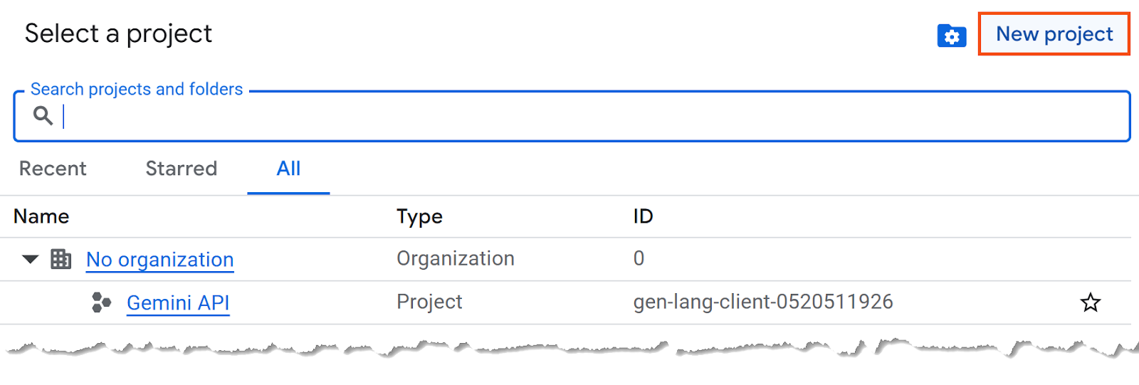

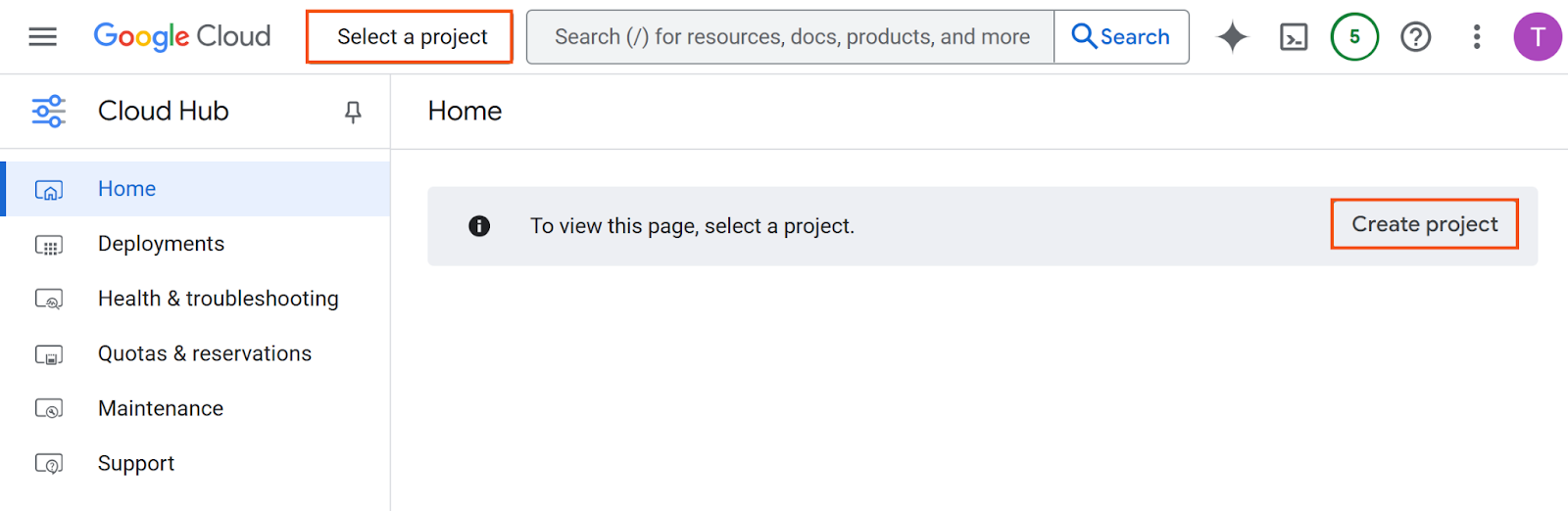

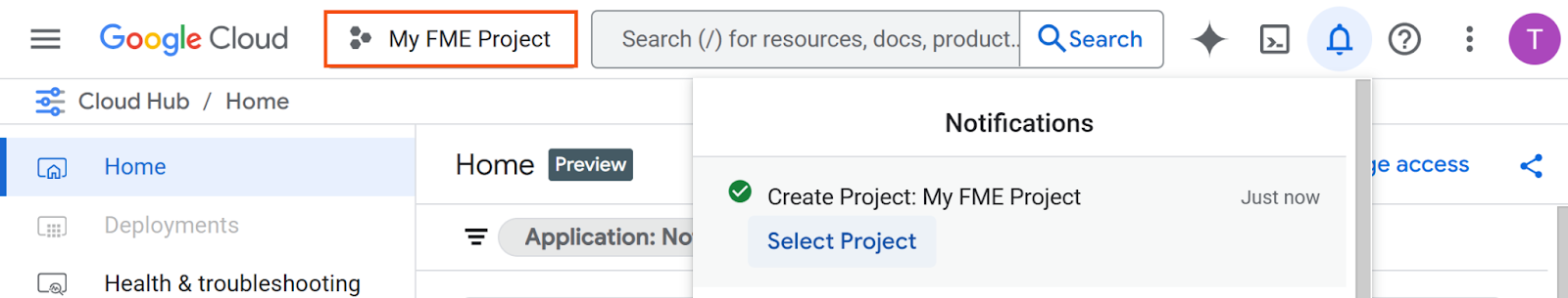

1. Log in and Create a Project
Log in to Google Cloud Console using a Gmail account, then click on either the Create Project or Select a Project button near the top of the Home or landing page.
That will either redirect to the project details page or redirect to a Select a Project dialog, where clicking New Project will redirect to the same page.

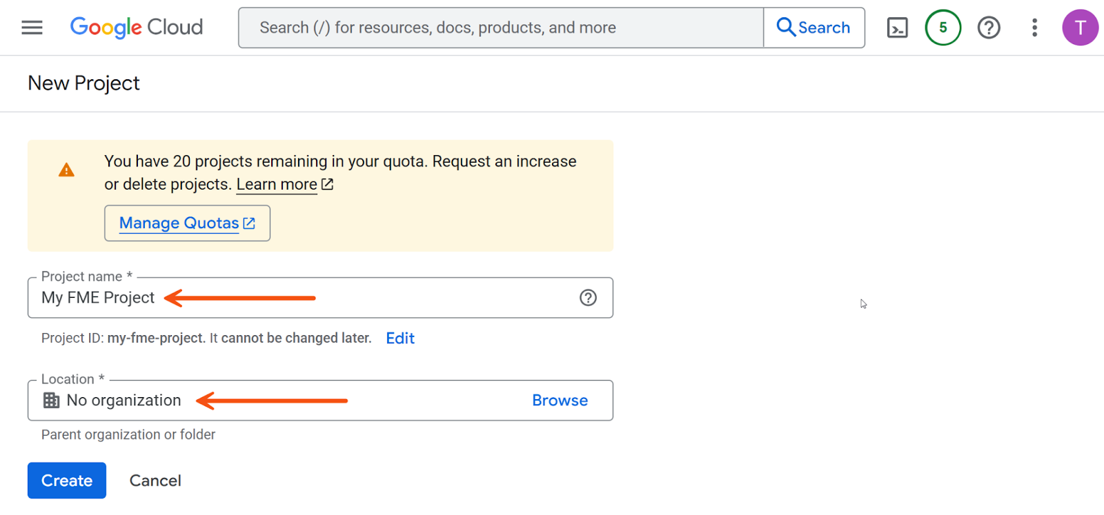

2. Fill in Project Details
Details like Project name and Location help manage multiple projects in the Google Cloud Console, so fill in the Project name and Location that suit your needs.  For example:
  • Project name: My FME Project
  • Location: No Organization
Clicking Create will default all settings to the newly created project, which can be confirmed (or changed) by selecting the top left button near the Google Cloud icon.

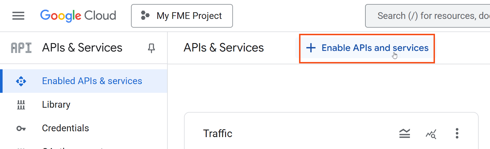

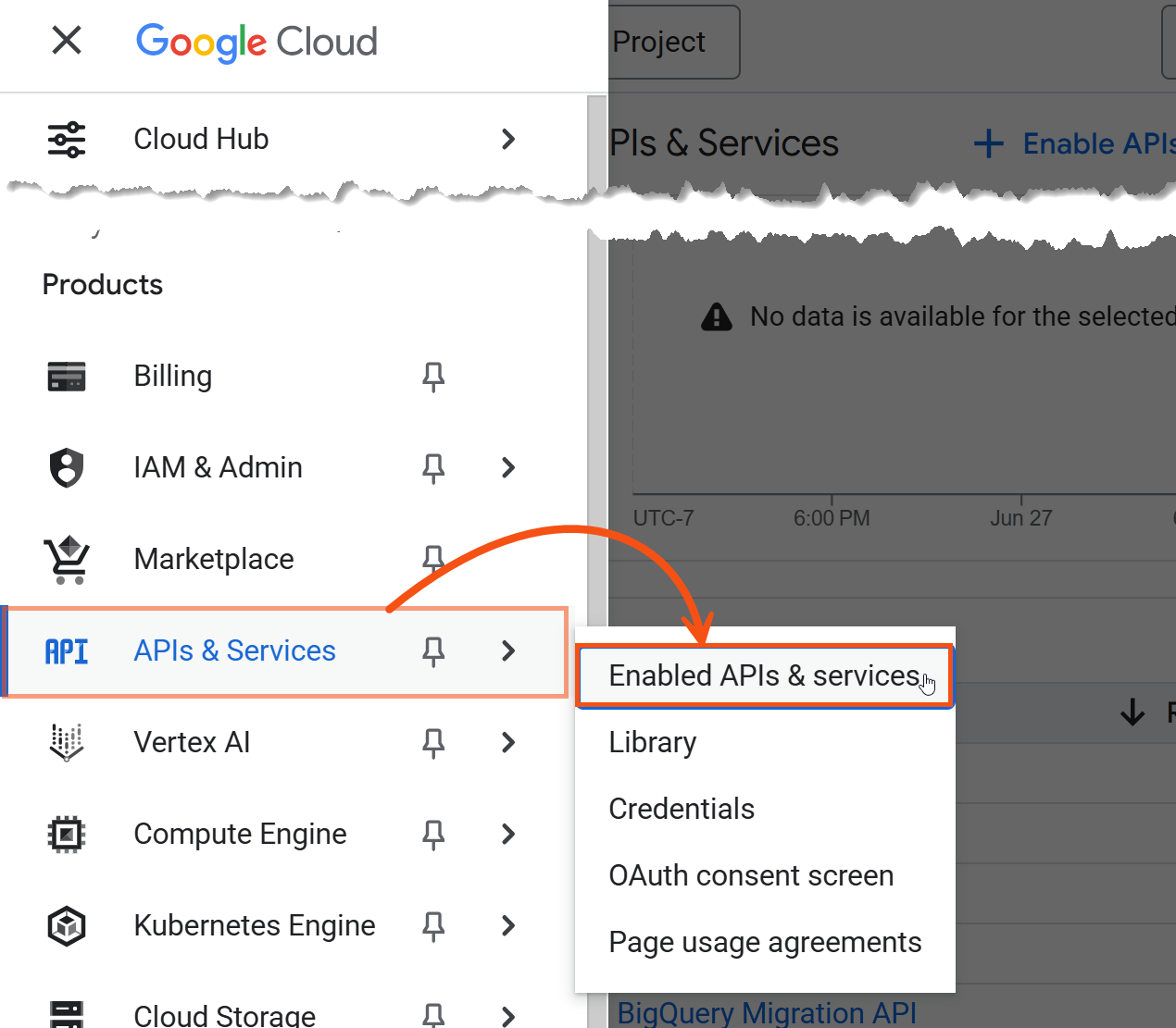

3. Navigate to the Enable API & Services Page
The Enable APIs & services page can be accessed in several ways, but one is to navigate to the left bar under the APIs & Services product tab.
Then click the button to Enable APIs and Services
This will redirect to a page to grant API access for the Project (Web Application).

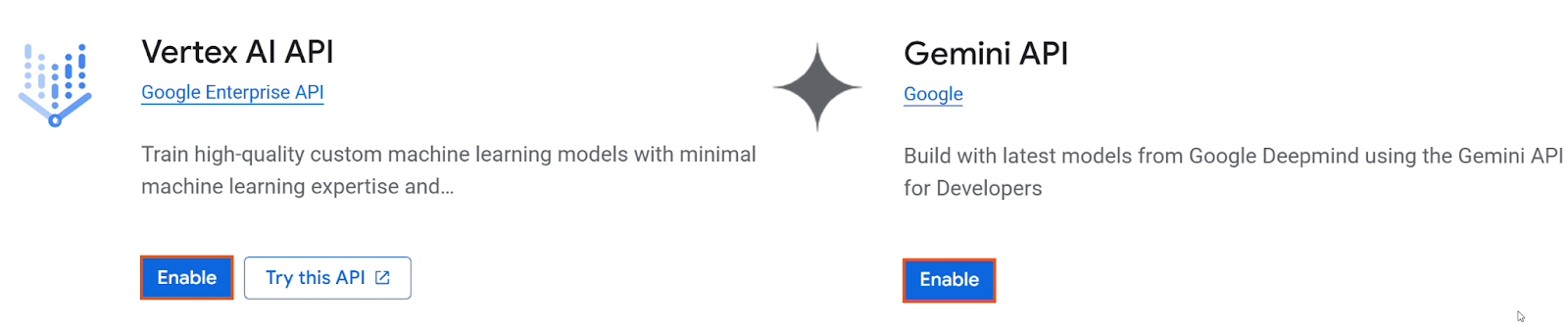

4. Grant the Project/Application Access to the Necessary APIs
Now, within the Enable APIs and services page, search for and enable:
  • Vertex API
  • Gemini API

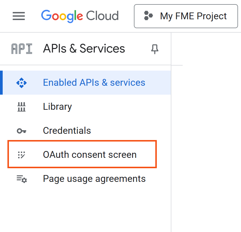

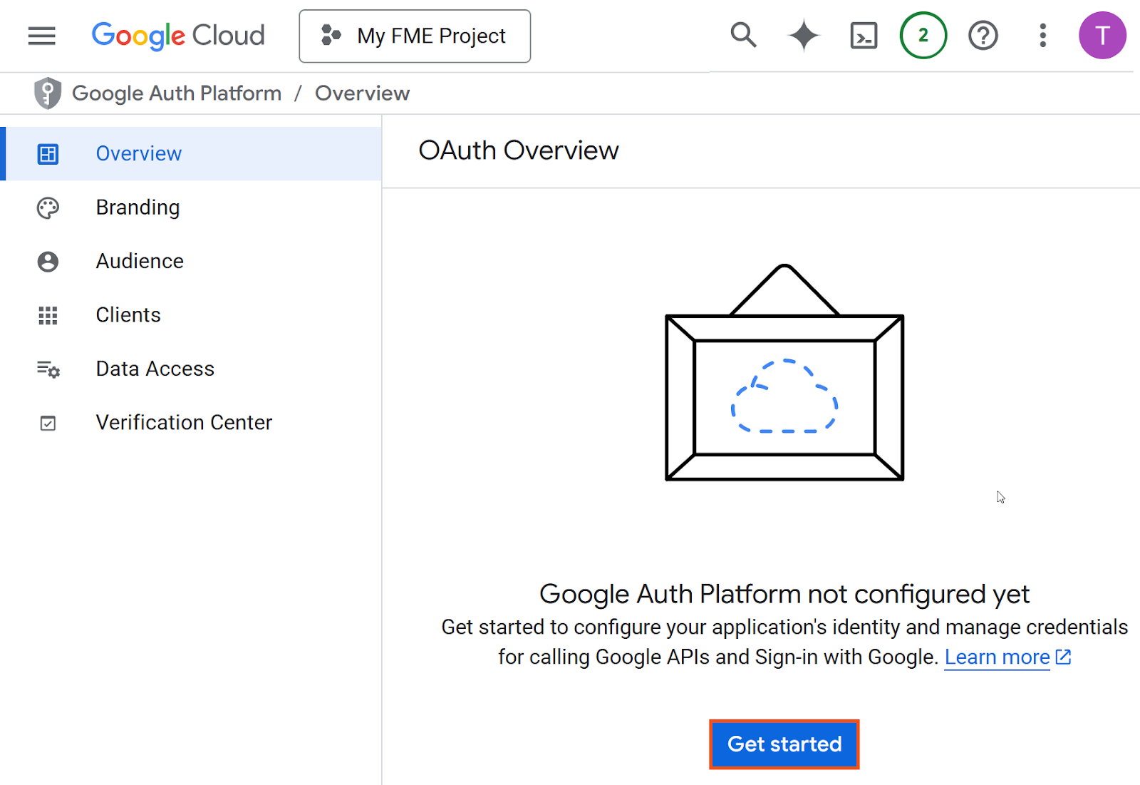

5. Navigate to the OAuth Consent Screen
Navigate to the OAuth consent screen, which may be accessed in several ways, but one way is from the APIs & Services page
This will redirect to an Overview page to Get Started with registering our Web Application (FME) with Google.

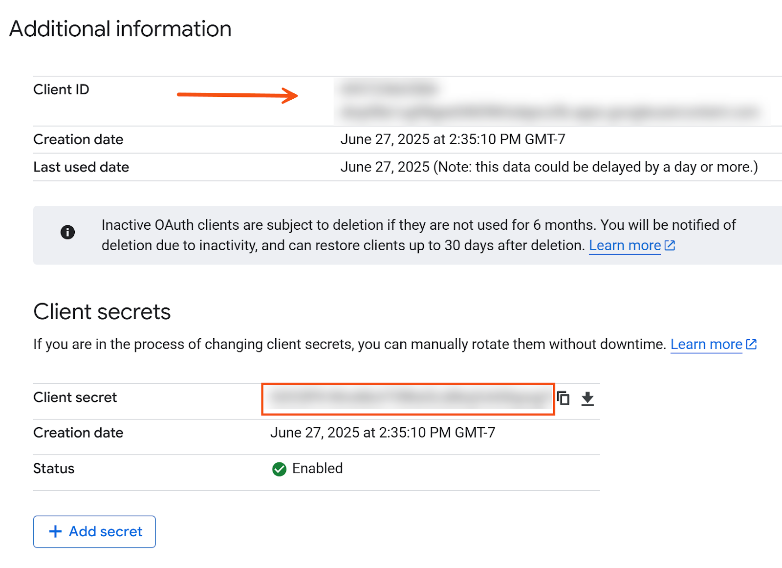

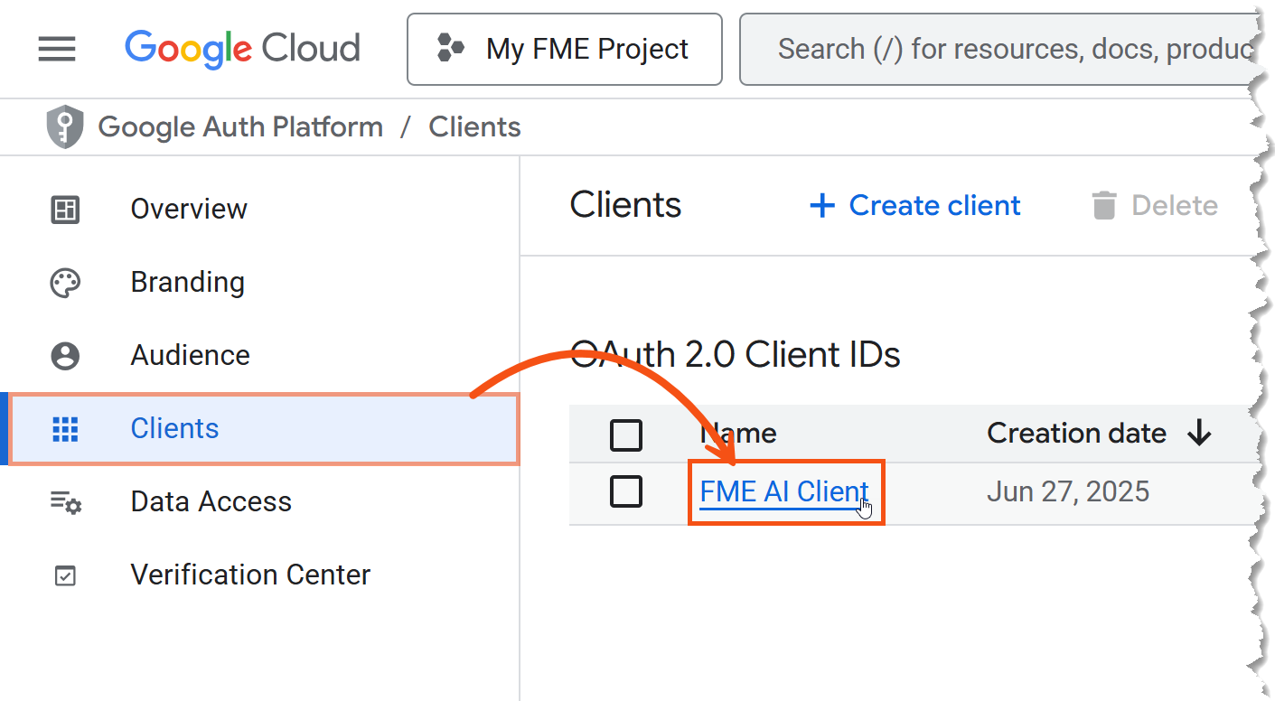

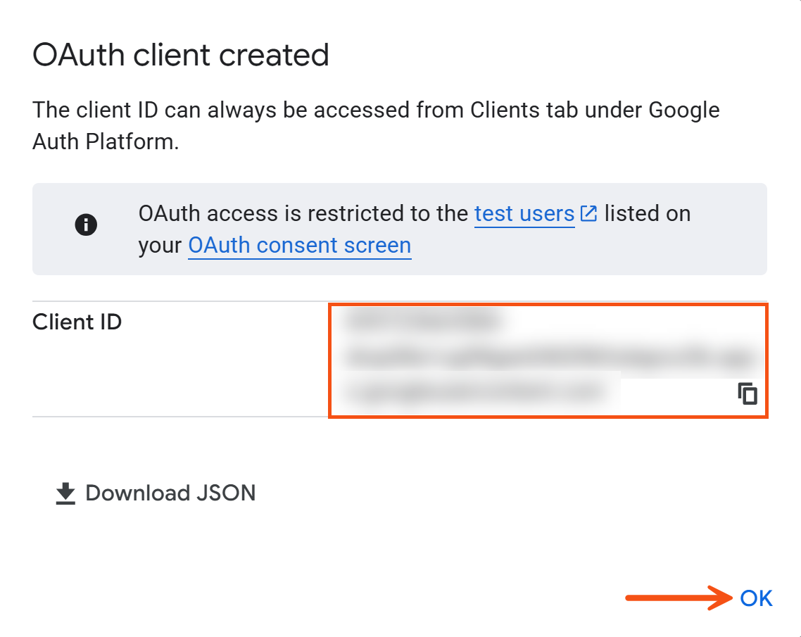

8. Save the Client ID and Secret
After creating the OAuth client, the newly created client details should appear. First, copy and save the Client ID, then click OK.
Then, from the Client page, click on the newly created client
Then, under Additional Information, the Client secret should be visible. Copy and save the Client Secret.
The Client secret will only be visible for a limited time after closing this page, and a new Client secret will have to be created if this one is lost.

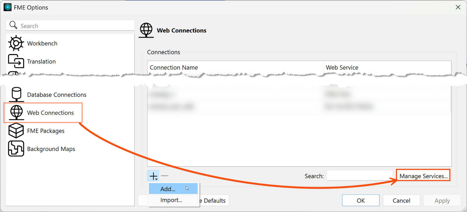

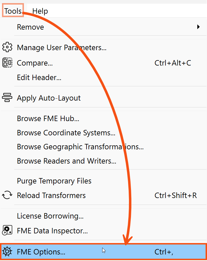

1. Open FME Workbench and Navigate to FME Options
Open up FME Workbench 2024.0+, then navigate to FME Options.

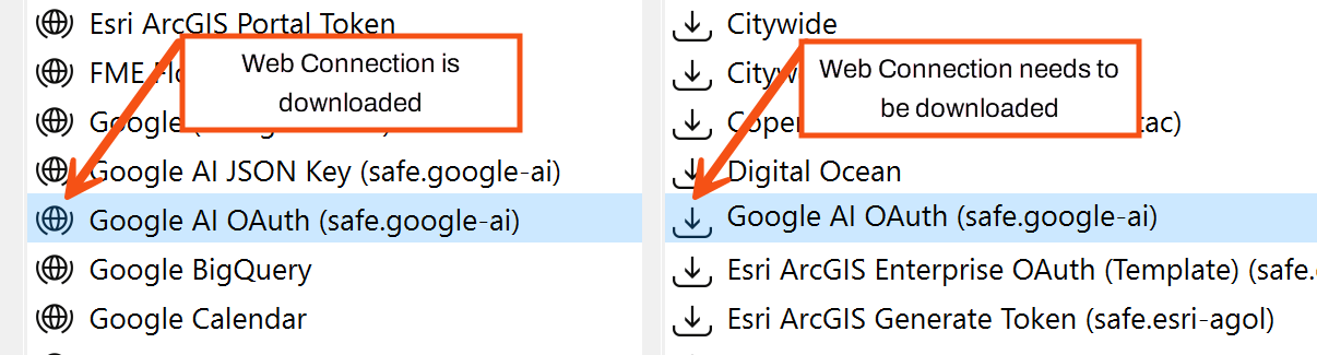

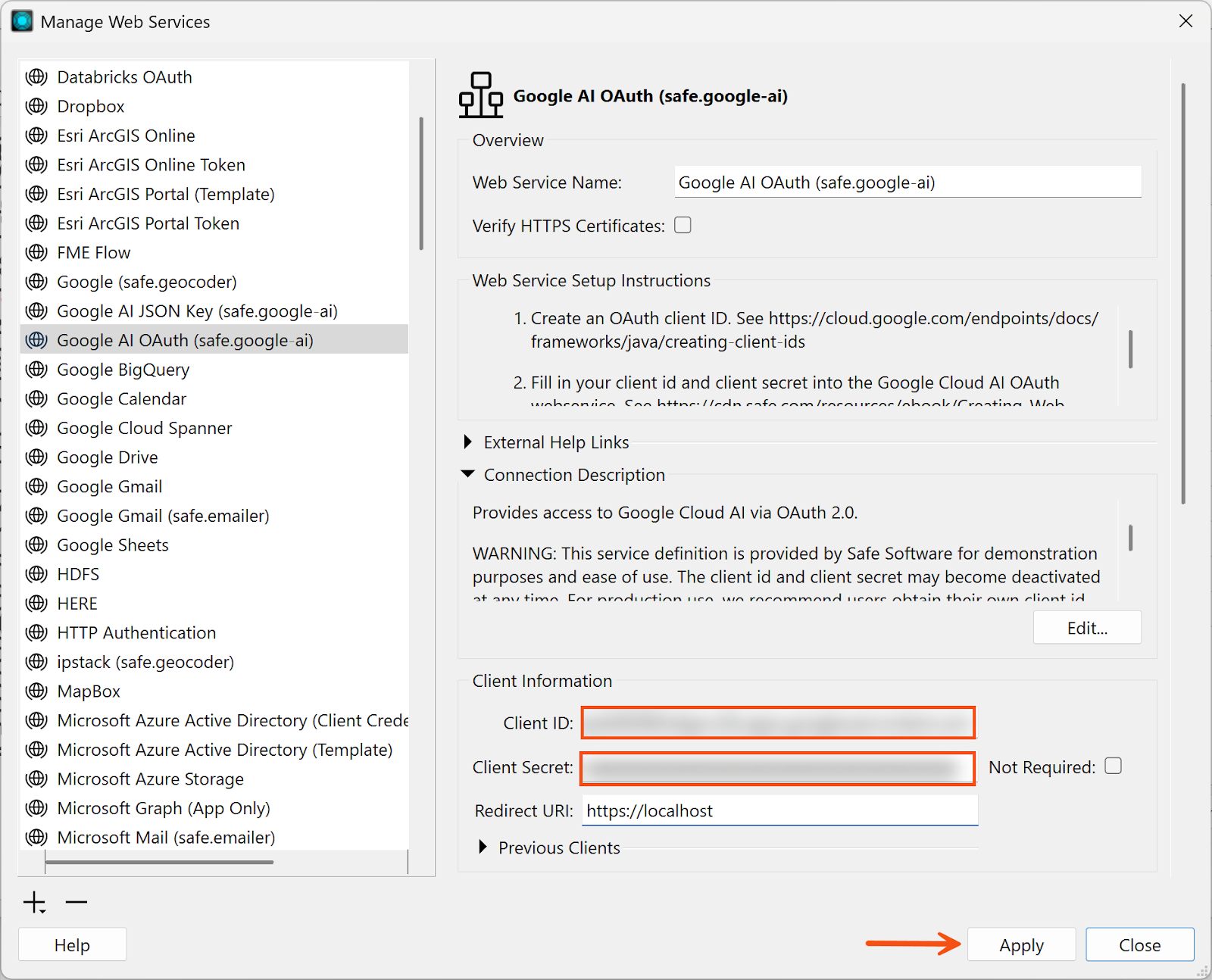

2. Access the Google AI OAuth (safe.google-ai) Web Service
Then, under Web Connections, click Manage Services.  To open FME’s Web Services Dialog.
From there, scroll down to search for Google AI OAuth (safe.google-ai) web service. This may appear as an already available service or as a downloadable service, indicated by its left icon.
Download or simply click on the Web Service.
3. Edit the Web Service Credentials
Now we want to edit the OAuth application details directly in the downloaded web service. Click on the Google AI OAuth (safe.google-ai) in the Manage Web Services dialog to configure it. Add the following details:
  • Client Information
    • Client ID: <your client id>
    • Client Secret: <your client secret>
Then click Apply and Close.

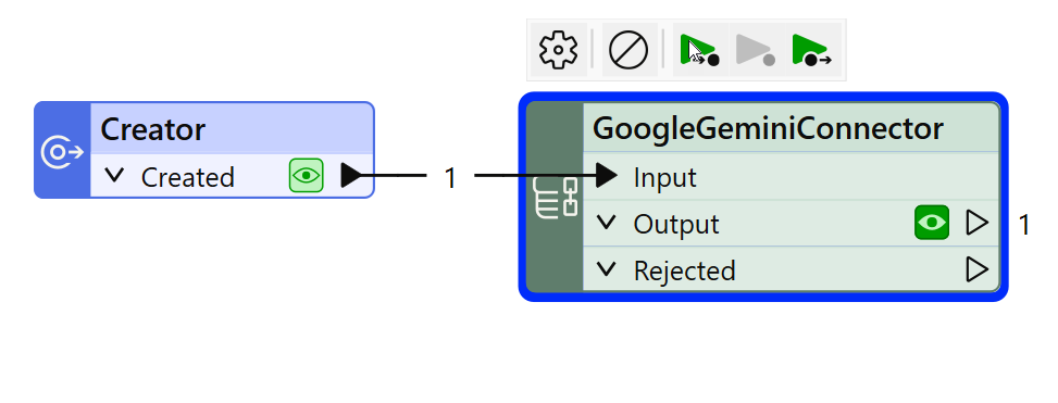

4. Add a Creator and GoogleGeminiConnector
To substitute for real data, start typing Creator to add the transformer to the canvas.

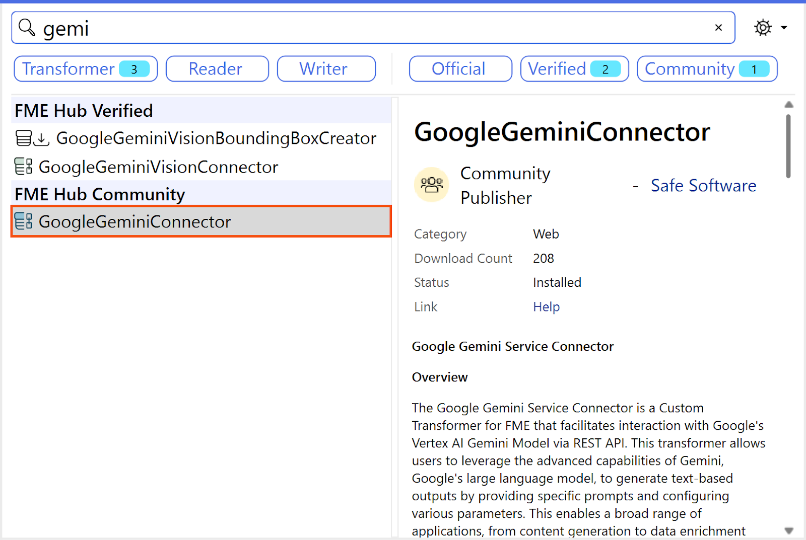

Select OK when prompted, then start typing GoogleGeminiConnector on the canvas to add the FME Hub transformer, installing it if prompted.

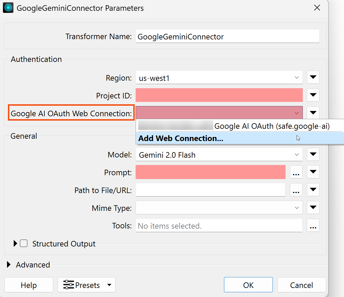

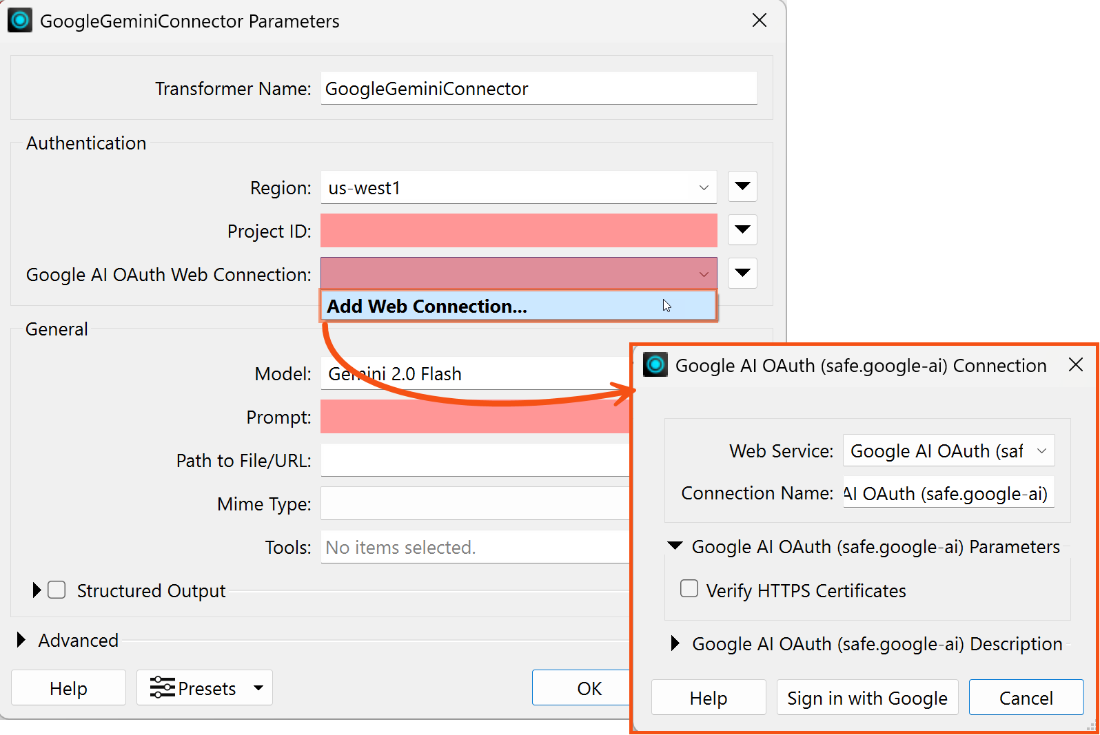

5. Open the Web Connection Dialog
Double-click on the GoogleGeminiConnector transformer to open the parameters, then click the Google AI OAuth Web Connection parameter to add a Web Connection. This should open up the Google AI OAuth (safe.google-ai) Connection dialog.
6. Sign In to Web Service
Click Sign in with Google to open the Sign-in screen. Enter Gmail account credentials, then log in.

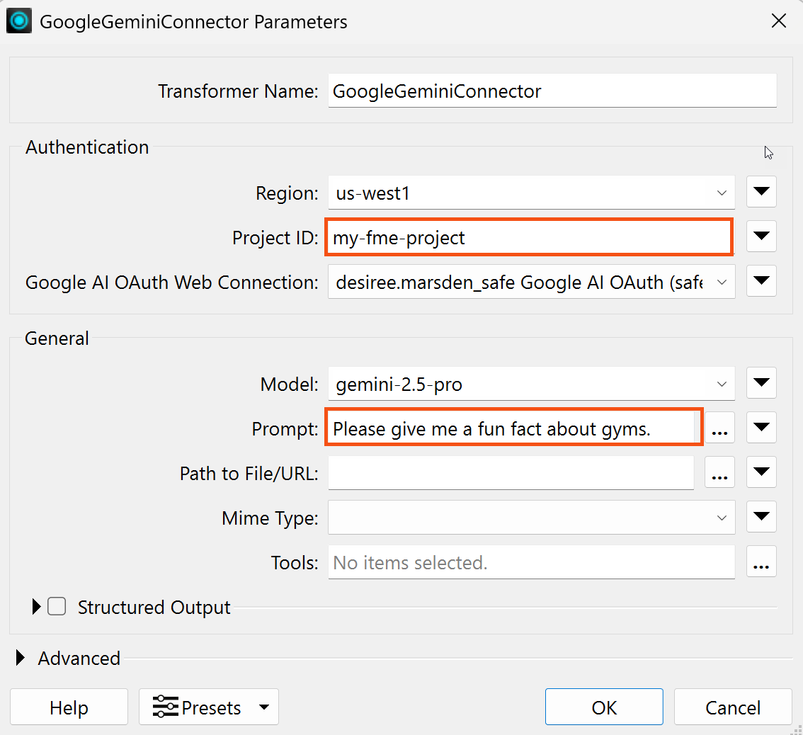

7. Add Parameters to Test
After successfully logging in, the GoogleGeminiConnect only needs two other parameters to run:
  1. Project ID
  2. Prompt

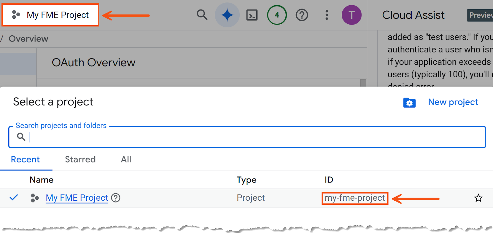

The Project ID can be viewed in various ways in the Google Cloud Console, including by clicking the Project to open the general project details.
The prompt can be anything to test. Enter the following as an example:
  • Project ID: <your project ID>
  • Prompt: Please give me a fun fact about gyms.

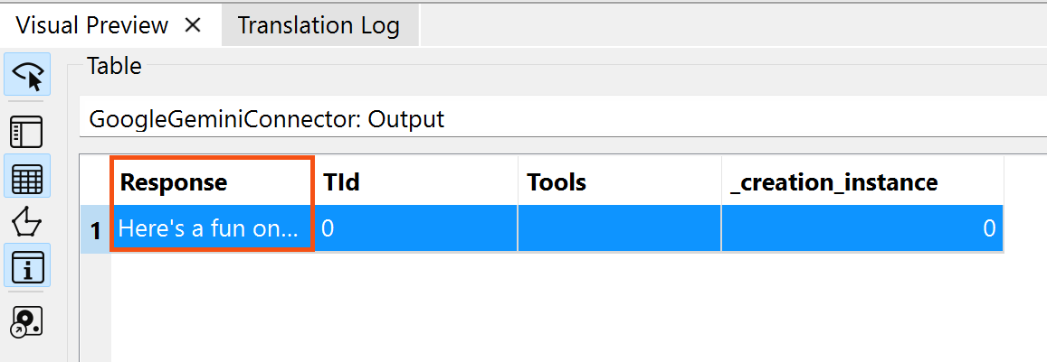

8. Run Workspace
Finally, click OK, then start typing Creator to add input for the connector transformer.
The result for this example will appear in the Visual Preview under the attribute Response.

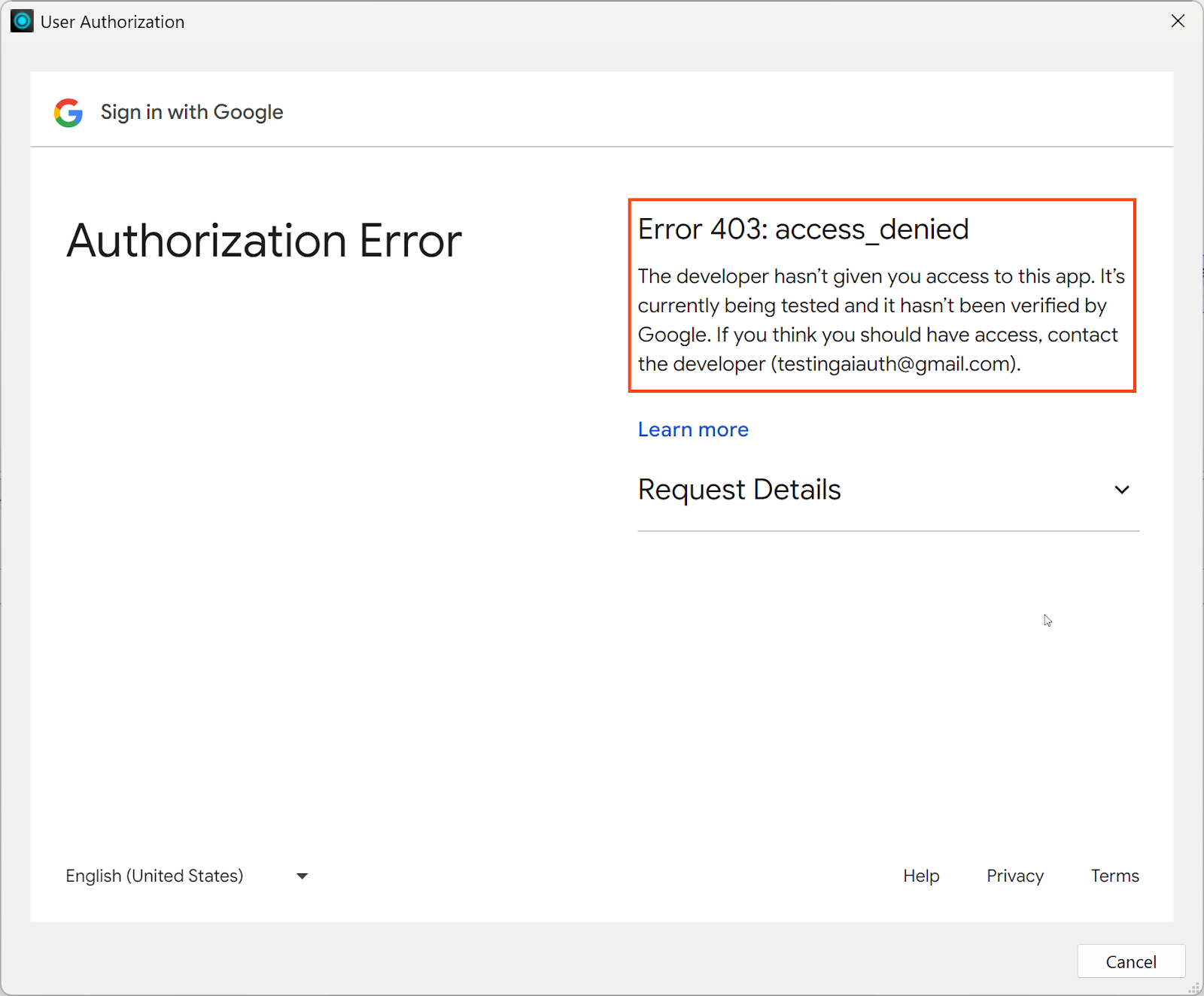

  • Error 403: access_denied error or Permission 'aiplatform.endpoints.predict' denied on resource
  • The Audience needs to be configured within Google Cloud Console by navigating to Apps & services> OAuth Consent screen>Audience, then either:

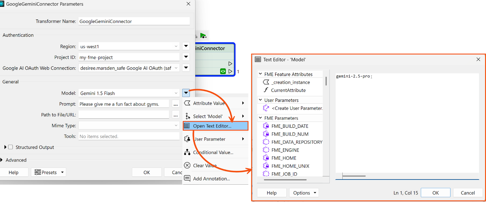

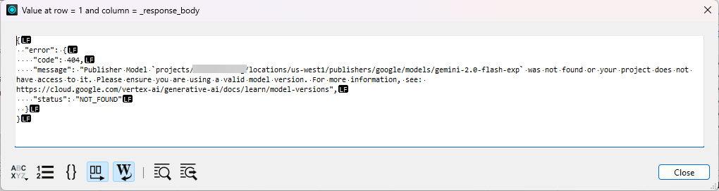

  • 404 Publisher Model… was not found, or your project does not have access to it for the Gemini Connector
    • The Gemini model used in the Vertex AI API may be deprecated or unavailable to your Google Cloud project. Try substituting the existing ID for another model ID within the Model prompt. The connector's Model parameter is editable text, so either delete the existing text or use the Open Text Editor... option from the arrow.
