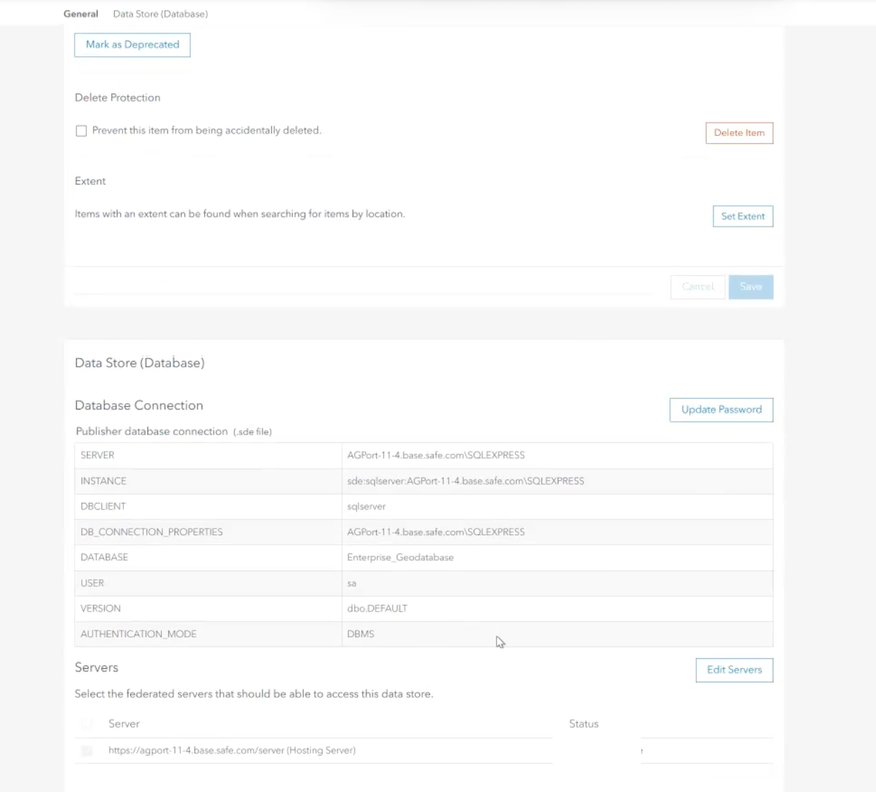

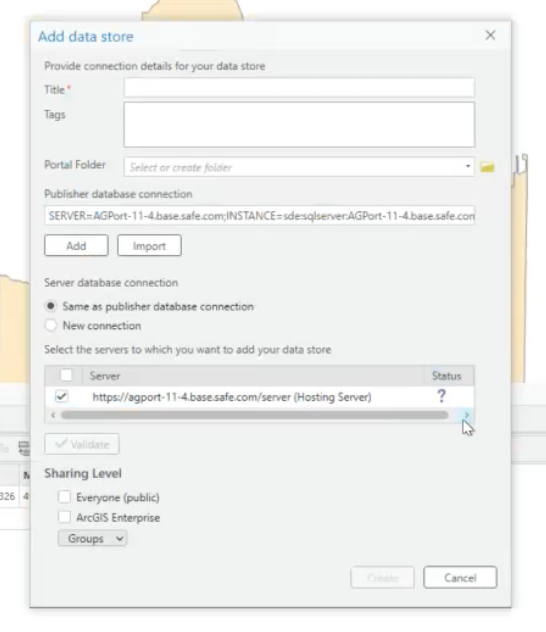

1. Register the Database as a Data Store
Still in ArcGIS Pro, create a connection to the database and register it with your Portal.
  • Open the Add Data Store dialog
  • Choose the Publisher Database Connection
  • Select the federated server where you want to register it
  • Validate the connection
The data store connection will now appear in ArcGIS Portal.

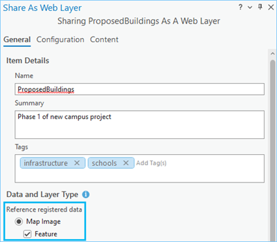

2. Share a Referenced Web Layer
Now that the data store is registered, select a feature class from it and publish it as a Referenced Web Layer.
  • Right-click the dataset and choose Share As Web Layer
  • In the dialog, make sure:
    • Reference registered data is selected
    • Feature is selected under Layer Type
    • Enable Edit, Query, and Sync as needed
This layer will serve as the bridge between FME and your Enterprise Geodatabase.
