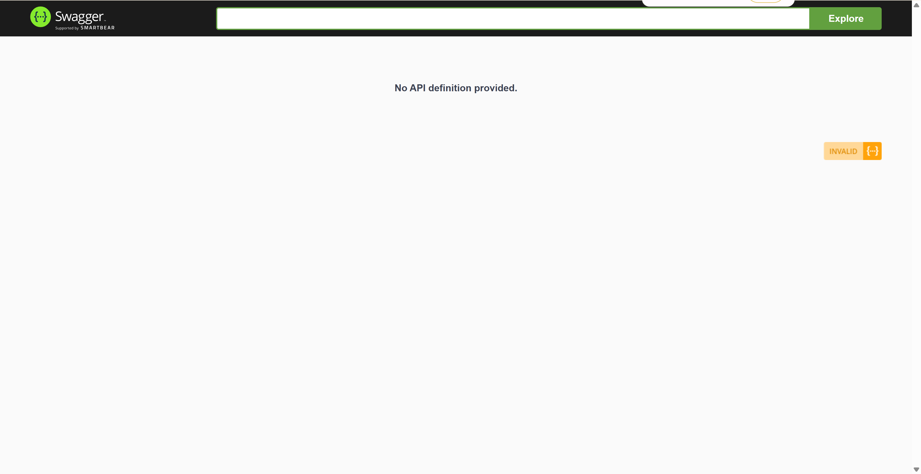

When a reverse proxy is set up using IIS and ARR, Data Virtualization APIs' docs don't load when accessed over HTTPS.
The error "No API definition provided" is shown, as is a yellow "INVALID" button.
This error message is different from when the docs of an API with no endpoints are viewed. In this case, the error message "No operations defined in spec!" is shown alongside the API's base URL.

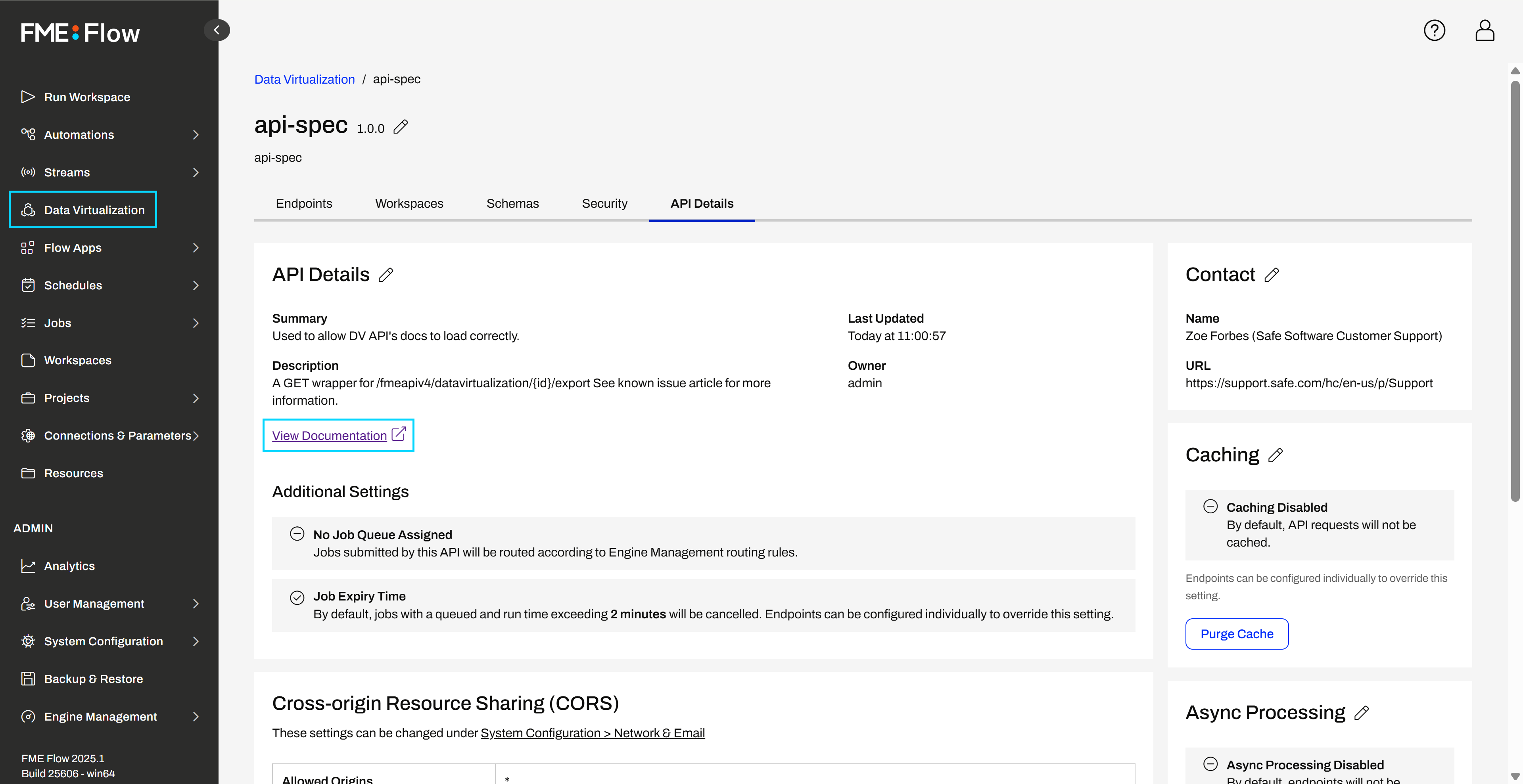

1. Import the Project
Download api_spec.fsproject from the attachments section.
In the Flow UI, head to Projects > Import, and upload the attached .fsproject file. If you are not importing from an admin account, an admin might have to manually grant permissions.
Check that the project was imported correctly. First, navigate to Data Virtualization and look for the API with the title "api-spec". Next, navigate to Connections & Parameters > Deployment Parameters and check that the frontend_hostname parameter is shown.

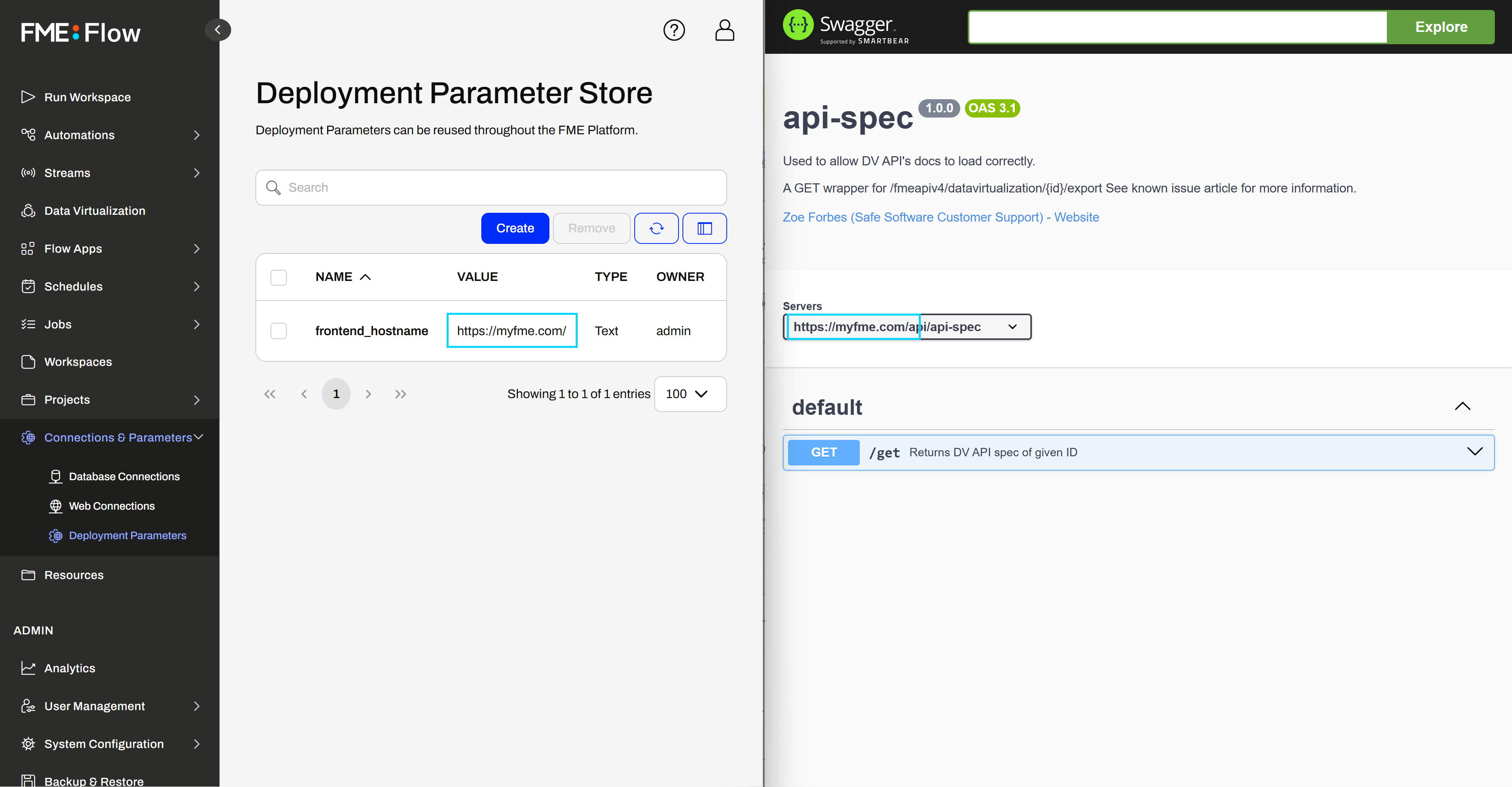

2. Set the Frontend Hostname
Select the frontend_hostname Deployment Parameter and set its value to the URL users will see in the docs. Use the format https://myfme.com/.
This value will be displayed in the API docs:

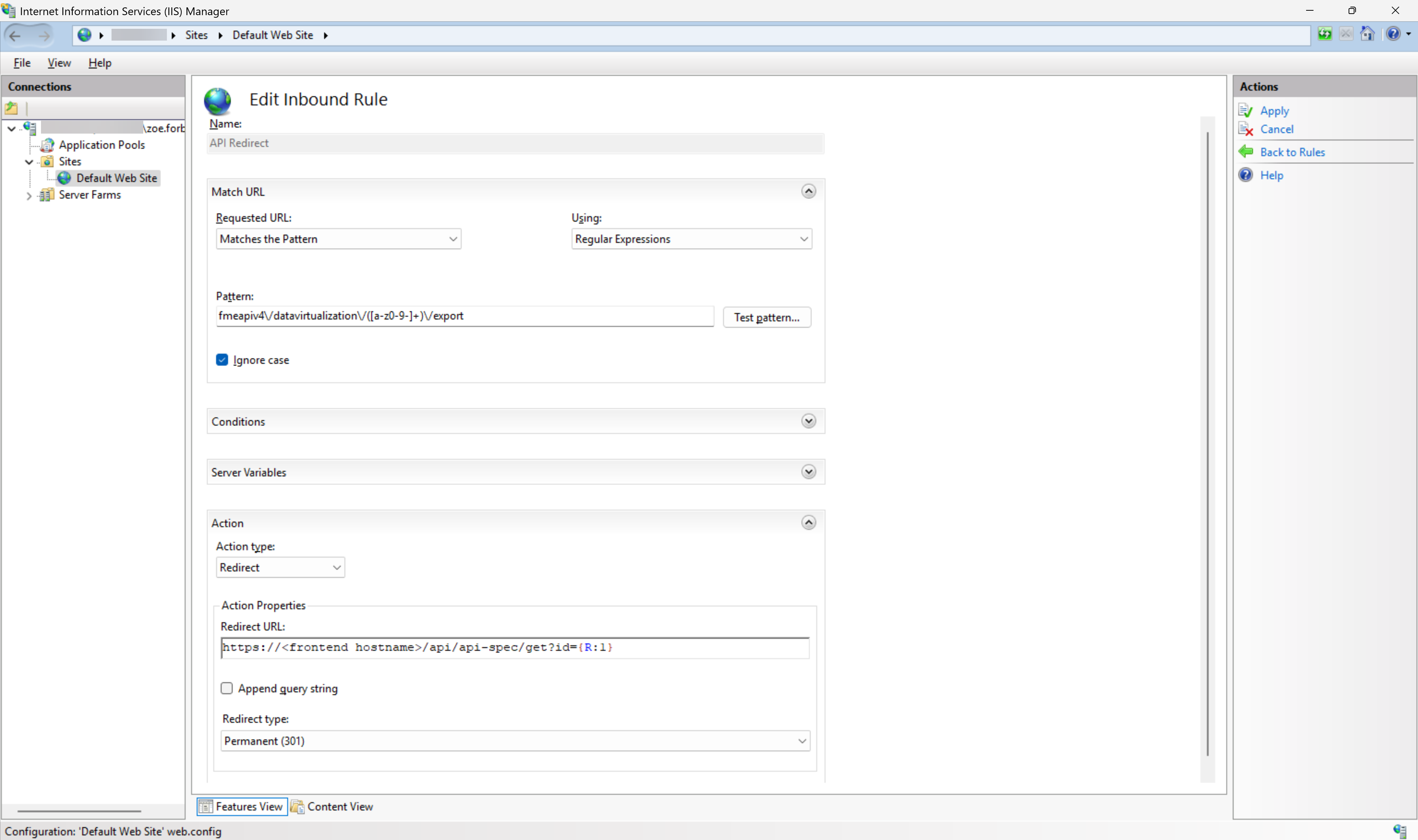

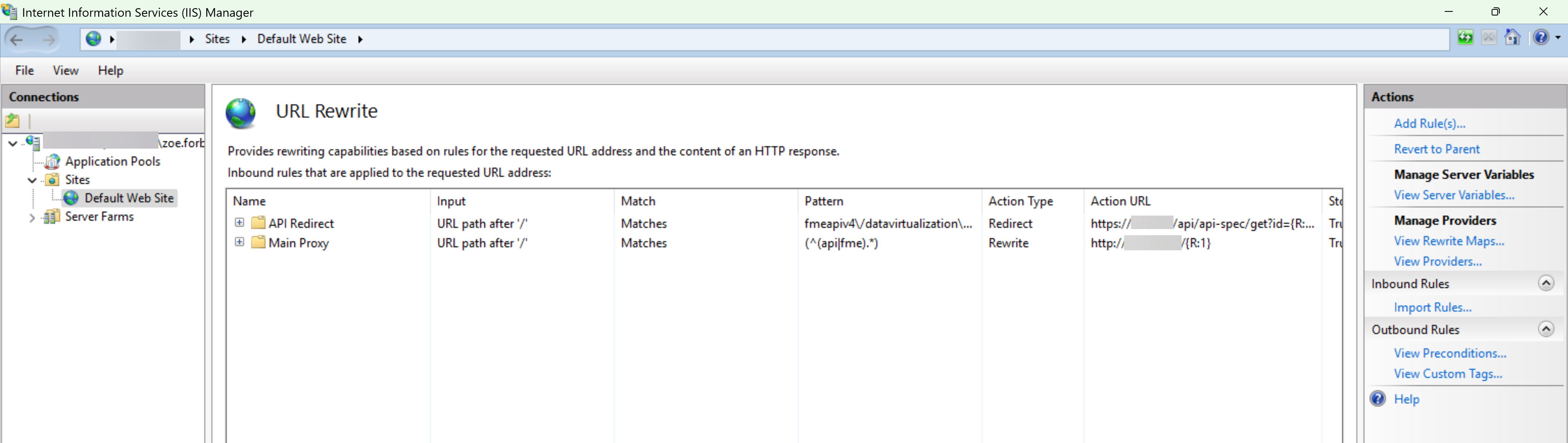

4. Add a New URL Rewrite Rule
Add a new URL Rewrite rule under the Default Web Site. The rule should be configured as follows:
Under Match URL:
  • Requested URL: Matches the Pattern
  • Using: Regular Expressions
  • Pattern: fmeapiv4\/datavirtualization\/([a-z0-9-]+)\/export
Under the Action heading:
  • Action type: Redirect
  • Redirect URL: https://<frontend hostname>/api/api-spec/get?id={R:1}
  • Append query string: [unchecked]
  • Redirect type: Permanent (301)
Ensure the Rule is Enabled and Above Any Others

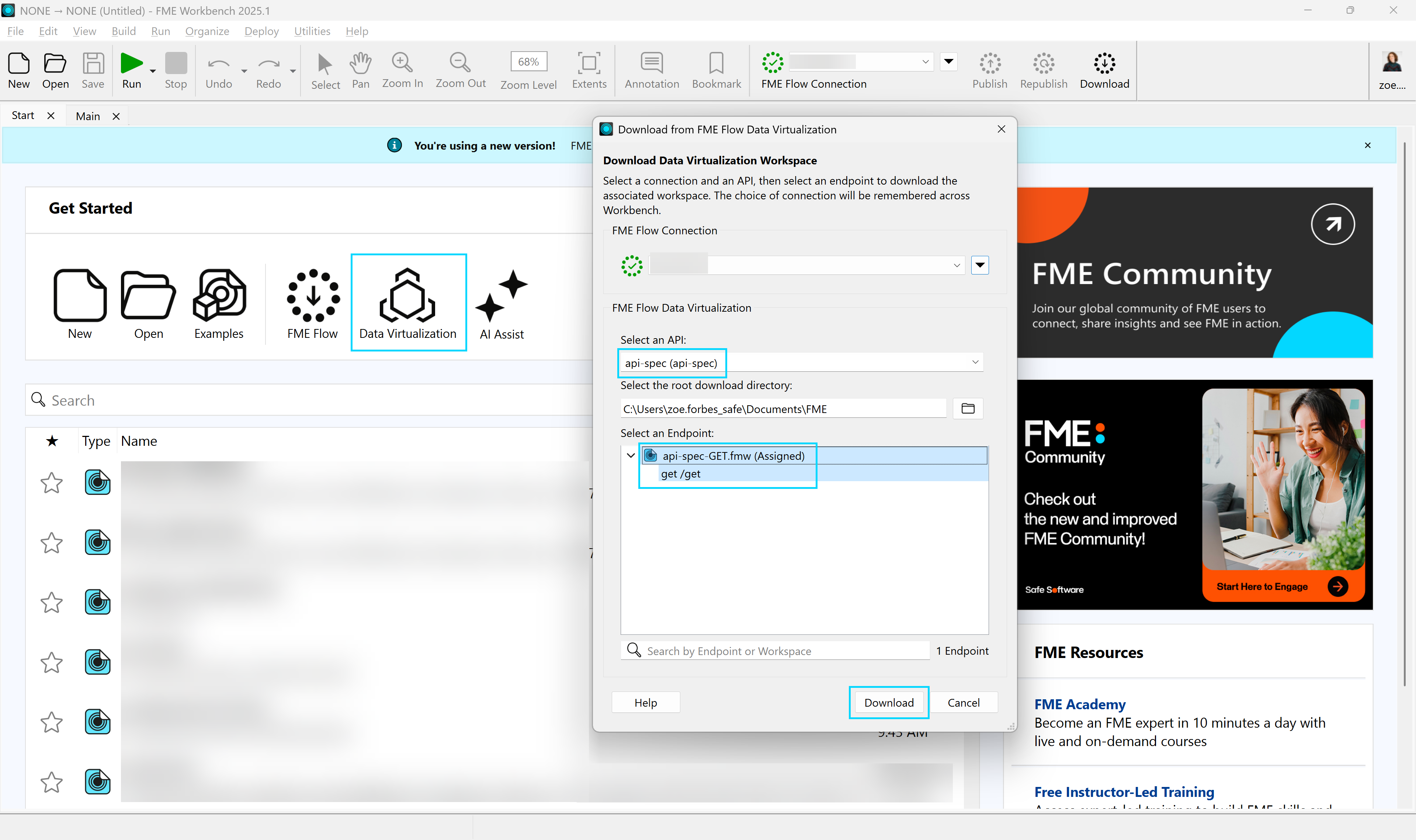

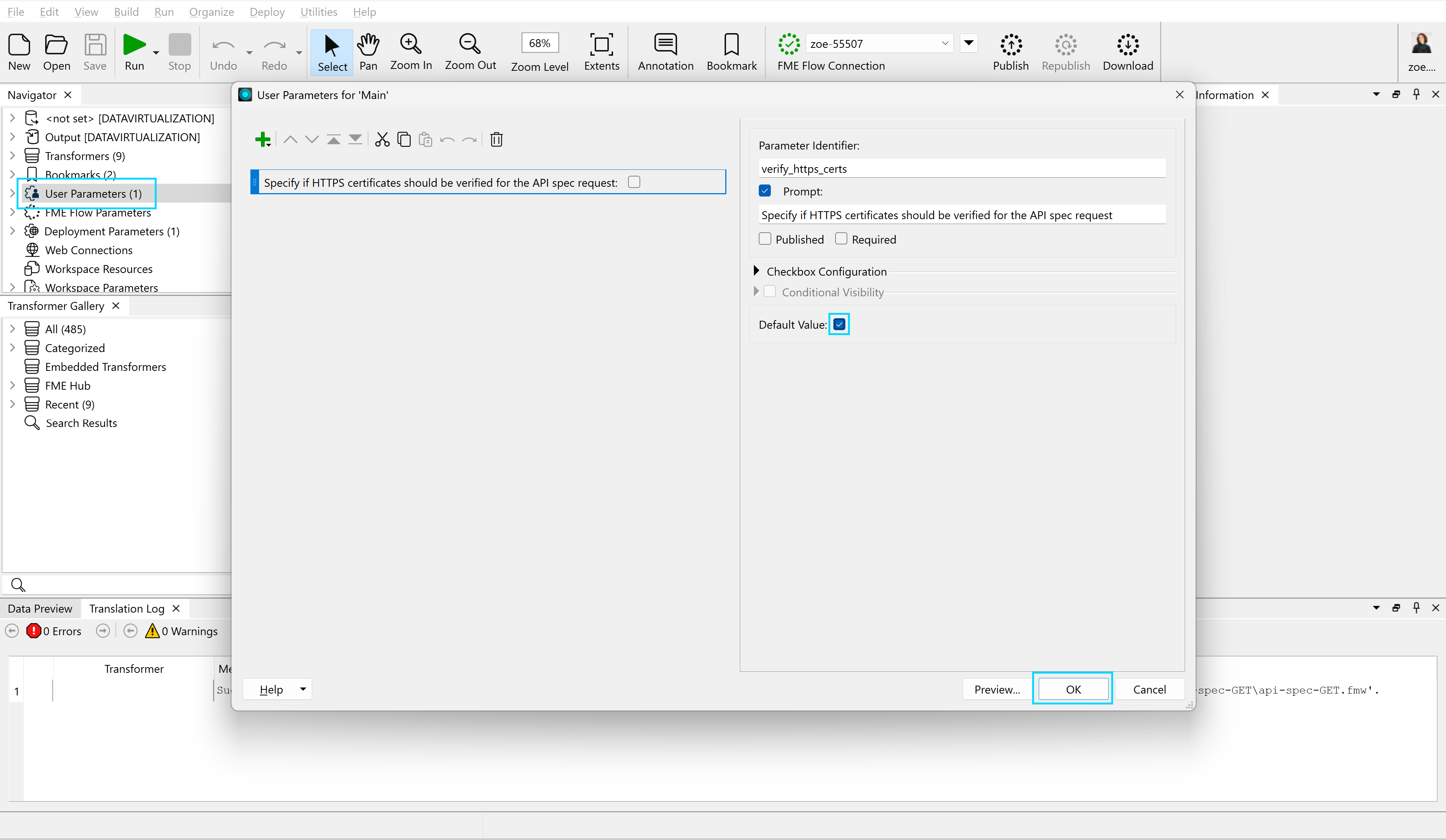

By default, the workspace does not verify HTTPS certificates when requesting the API docs from the backend Flow server. To change this:
1. Open the Endpoint Workspace in Workbench
2. Set the Default Value of the User Parameter to Selected
3. Save and Publish to Flow

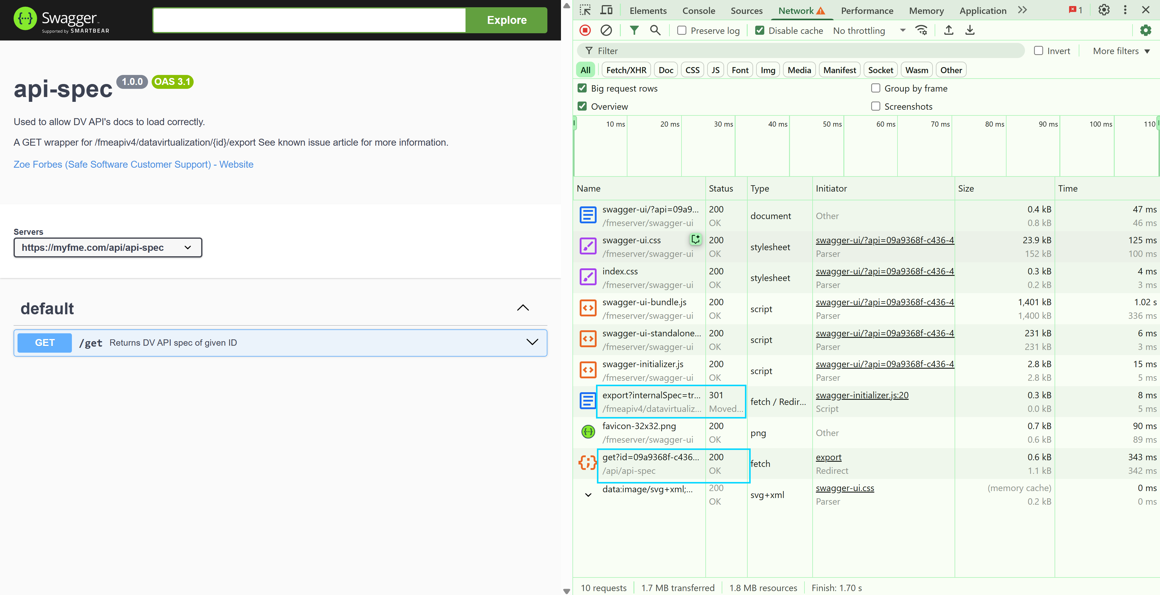

The best way to troubleshoot is to use Developer Tools. In your browser, open Developer Tools (F12 for Chrome on Windows), navigate to the Network tab, and refresh the page. The expected behavior is for the /export endpoint to return a 301 response, and the /get endpoint to return a 200 response.
  • If the /export endpoint returns a response other than 301, check your IIS configuration.
  • This is likely expected behavior if the /get endpoint has a 404 or a 422 response. Click the endpoint, navigate to Response, and check the error message.
