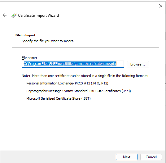

7. Import the PFX Certificate into the Windows Certificate Store
You have two options to import the certificate:
  • Logged on as the Service Account: Log on to the machine using the service account credentials, then import the PFX certificate using the Certificate Import Wizard.
  • Using Elevated Permissions with runas: Open an elevated command prompt and execute the following command
runas /user:DOMAIN\username mmc.exe
Replace DOMAIN\username with the appropriate service account details. This should open mmc.exe

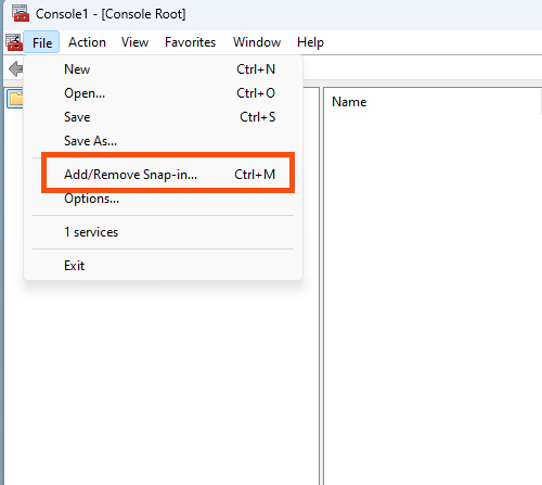

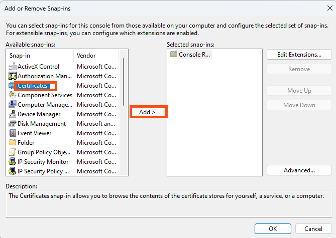

To add the Certificates Snap-in, navigate to File > Add/Remove Snap-ins.
Click Certificates, then click Add > Click ok

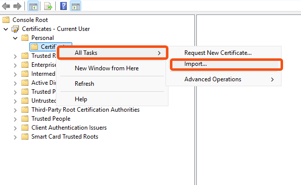

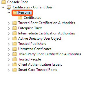

Under Console, Click Certificates> Personal
Right click certificate > All Tasks > Import > Next
Click Browse and navigate to the certificate file location
