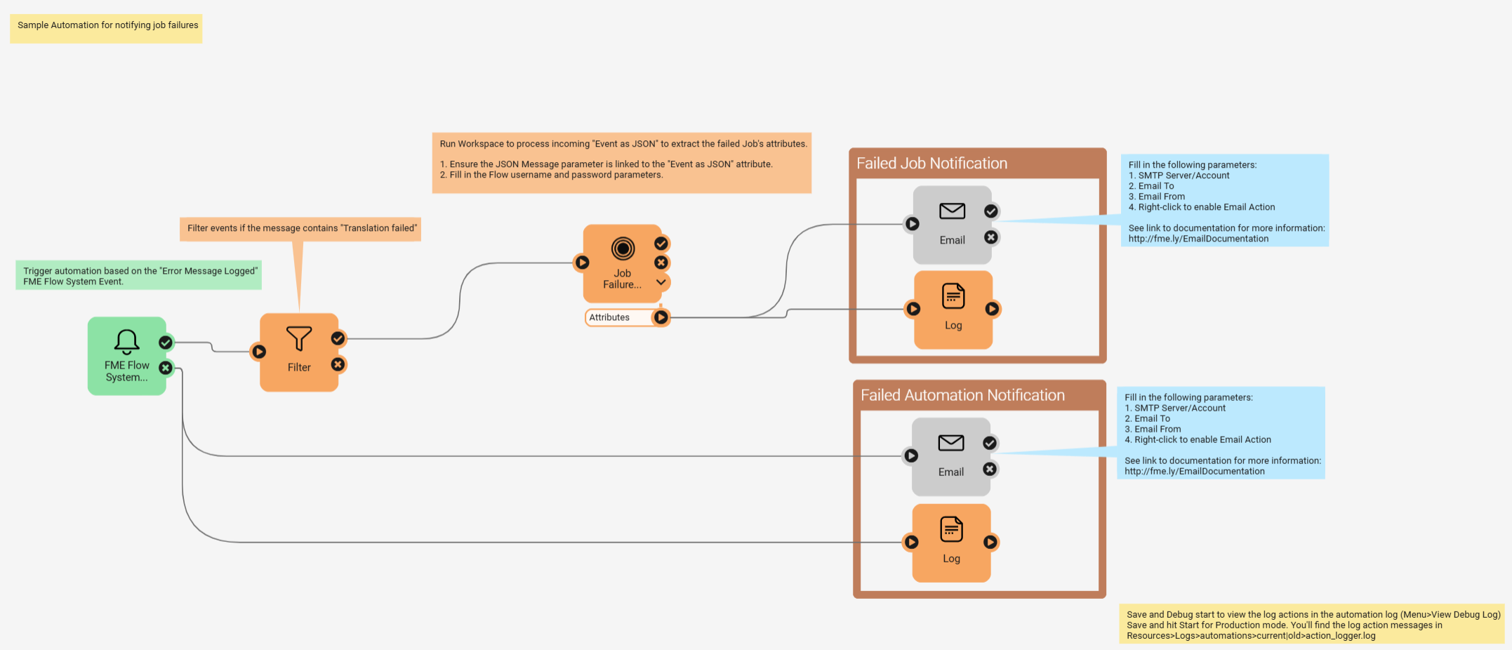

Automation:
  1. System Events Trigger: watch for Error Message Logged
  2. Filter Action: filter message content containing “Translation failed”
  3. Workspace Action: JSON user parameter linked to Event Attributes> Event as JSON.
  4. Email Action: Linked to the Automations writer port

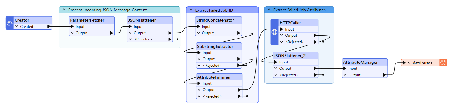

Workspace:
  1. Processes incoming JSON message from the “Event as JSON” attribute
  2. Extract the failed job ID using string transformers
  3. Extract failed job attributes using FME Flow REST API V3  or FME Flow REST API V4
  4. Clean up attributes before writing out to the Automations writer

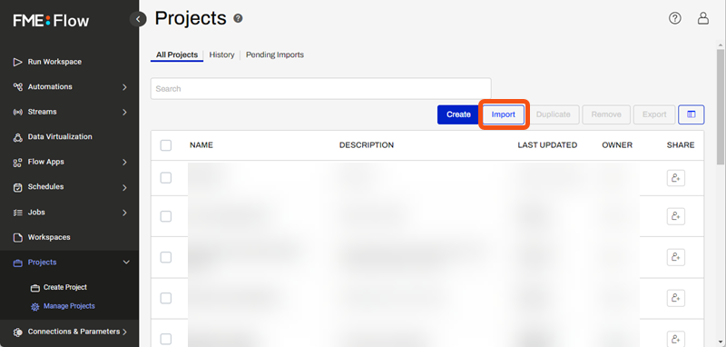

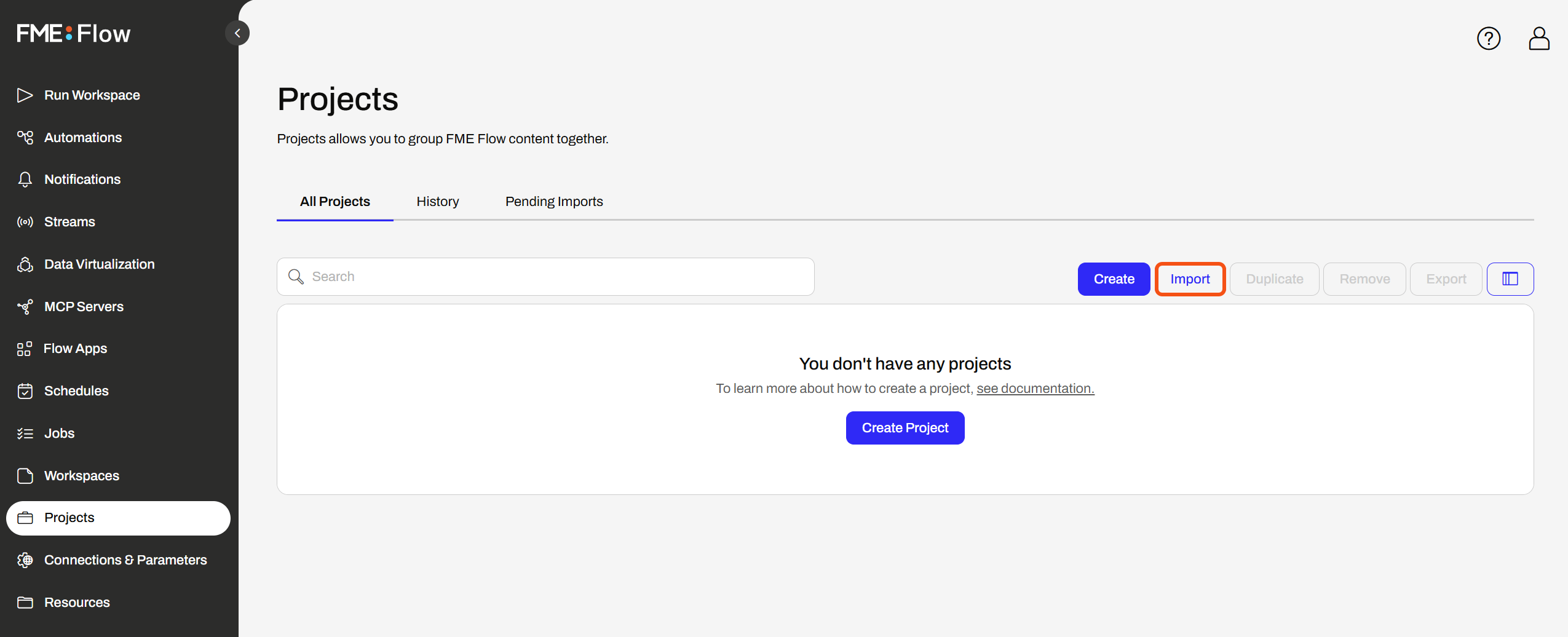

From the Files section of this article, download the linked FME Flow project, Sample Notify Job Failure.fsproject (updated in FME Flow 2026.2). Import the project file to FME Flow by selecting Projects > Import.

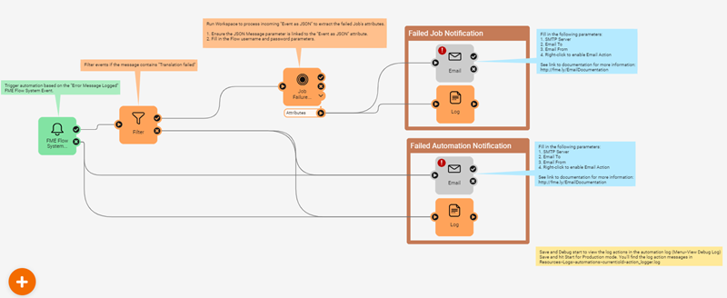

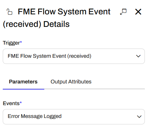

From the FME Flow web interface, go to Automations and open the new JobFailureNotify automation. The automation starts with the FME Flow System Events trigger to watch for the “Error Message Logged” events.
These events can be viewed from the System Configuration > System Events page.

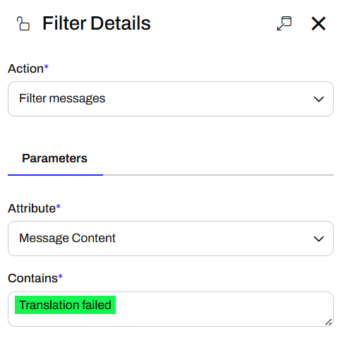

From the trigger’s success port, we have the Filter Message action to filter the Message Content that contains the “Translation failed. Any error message logged in System Events that contains “Translation failed” will be passed to the success port and processed by the workspace.

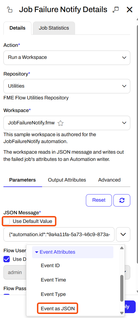

JobFailureNotify workspace action parameters:

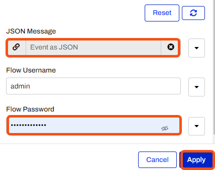

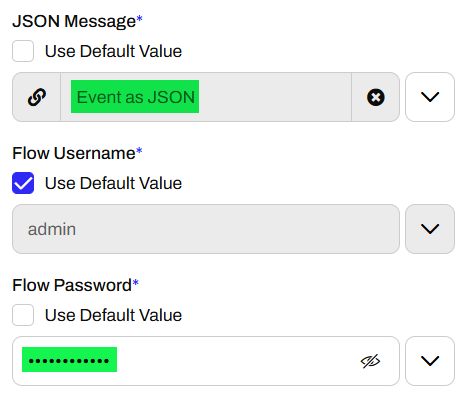

Ensure the JSON Message user parameter is set to “Event as JSON”. You can deselect the Use Default Value checkbox, then use the drop-down arrow next to the parameter input to select Event Attributes > Event as JSON.
Set the admin username and password parameters, and update the account password from the default placeholder value. Click Apply and save the changes.

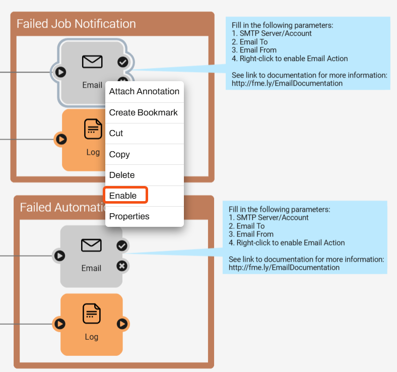

Configure the Email action in the “Failed Job Notification” bookmark.
Right-click the Email action and select “Enable”. The Email action will turn blue when enabled.
Double-click the Email action and fill in the parameters. Input your SMTP Server domain name and set the “Email To” and “Email From” parameters. Notice that the Email action input port is linked to the Attributes port of the JobNotifyFailure workspace action node.

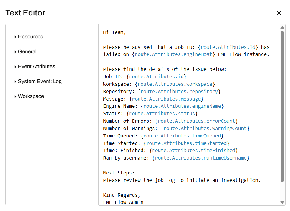

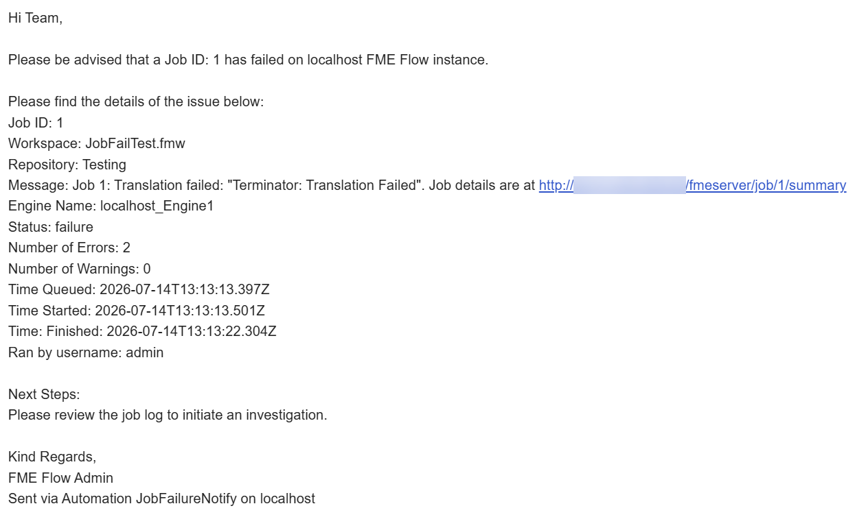

The Automations writer port enables workspaces to route data throughout the automation. This allows us to gather more data on the failed job and send the attributes to the next downstream action. You can also edit the sample email body and make use of automation parameters and attributes to include more detailed descriptions of the failed job.
Hi Team,
Please be advised that a Job ID: {route.Attributes.id} has failed on {route.Attributes.engineHost} FME Flow instance.
Please find the details of the issue below:
Workspace: {route.Attributes.workspace}
Repository: {route.Attributes.repository}
Message: {route.Attributes.message}
Engine Name: {route.Attributes.engineName}
Status: {route.Attributes.status}
Number of Errors: {route.Attributes.errorCount}
Number of Warnings: {route.Attributes.warningCount}
Time Queued: {route.Attributes.timeQueued}
Time Started: {route.Attributes.timeStarted}
Time: Finished: {route.Attributes.timeFinished}
Ran by username: {route.Attributes.runtimeUsername}
Next Steps:
Please review the job log to initiate an investigation.
Kind Regards,
FME Flow Admin
Sent via Automation {automation.name} on {route.Attributes.engineHost}

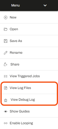

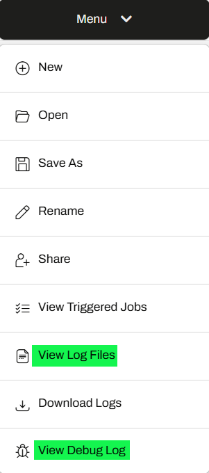

Save and click “Debug” to start the automation in debug mode. To view the automation log, from the automation’s Menu drop-down, select “View Debug Log”. Clicking the Start button will run the automation in production mode.
You'll find the log action messages in Resources > Logs > automations > current|old > action_logger.log.

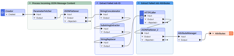

In this section of the tutorial, we will explain how the workspace works. The JobFailureNotify workspace can be divided into three main sections (outlined using bookmarks). Follow the steps below to go through each section. The workspace is complete and configured, but you may follow along by downloading the workspace (JobFailureNotify.fmw) file from the files section.
1. Process JSON Message Content

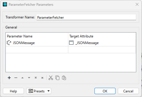

The workspace starts with the Creator transformer and connects to the ParameterFetcher, where we can grab the incoming JSON message and assign it to an attribute
The incoming JSON message from the FME Flow System Events trigger looks something like this:
{"automation.id":"9a4a11fa-5a73-46c9-873a-8a10709cb422","systemEvent.description":"Triggered whenever an error message is logged to fmeserver.log.","source":"system-event","time":"2025-11-26T12:29:03-03:30","message":"Job 5: Translation failed: \"Example job failure message.\".\". Job details are at https://FlowHostname:443/fmeserver/job/5/summary","event.id":"5ee8b0a8-9a38-4b8a-bd41-77673963de21","automation.name":"JobFailureNotify","systemEvent.title":"Error Message Logged"}

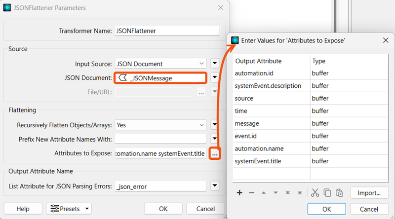

After assigning the JSON message to an attribute, we can use the JSONFlatterner transformer to parse the data. In the JSONFlatterner transformer, use the JSONMessage attribute as the JSON document and select the Attributes to Expose.
2. Extract Failed Job ID

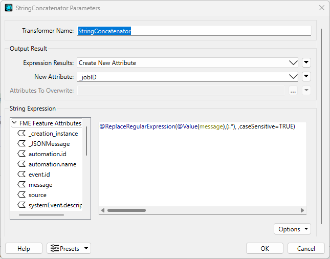

Once we have the attributes we’re looking for, we can use string-manipulation transformers to extract the failed job's ID. In the StringConcatenator transformer, we will use Regex to parse out the job ID and write to a new attribute, _jobID.
Paste the following into the String Expression text box: @ReplaceRegularExpression(@Value(message),(:,*), ,caseSensitive=TRUE)

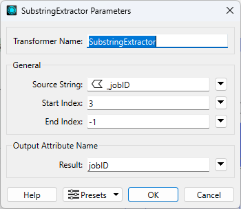

With the SubstringExtractor transformer, we will further isolate the job ID

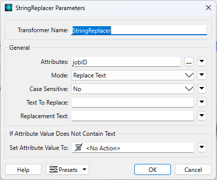

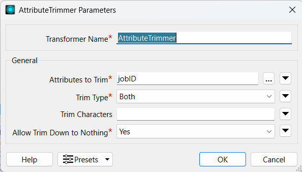

With the AttributeTrimmer transformer, we can remove any spaces in the jobID string value and replace them with a blank.
3. Extract and Expose Failed Job Attributes

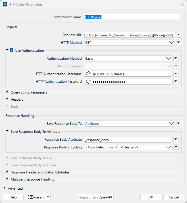

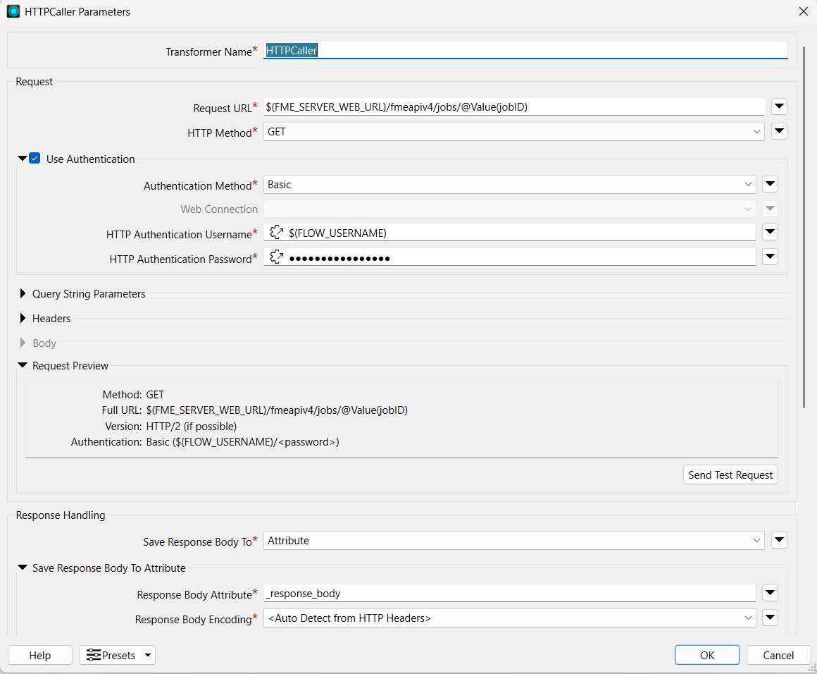

With the FME Flow REST API (V3 for 2025.0 and older), we can use the job ID to request more information on the failed job. To retrieve the job record according to the specified ID, we can use the following request:
GET <FMEFlowWebURL>/fmeapiv4/jobs/<ID>
With the HTTPCaller transformer, we can paste the request URL, set the HTTP Method, and authenticate as needed. We can save the response body as an attribute for further processing

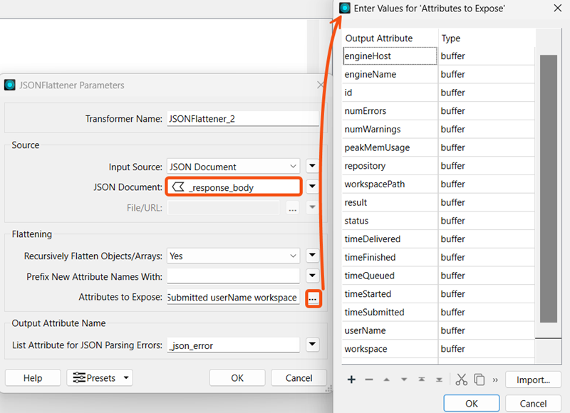

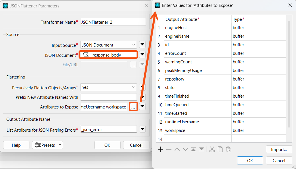

With the JSONFlattener transformer, we can expose the attributes from the response body

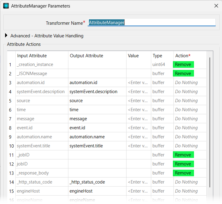

Before assigning the job attributes to the Automations writer, we can clean them up using the AttributeManager transformer.
In the AttributeManager, remove the following attributes:
  • _creation_isntanace
  • _JSONMessage
  • _jobID, jobID
  • _response_body
Note: You may also use the AttributeRemover transformer here.

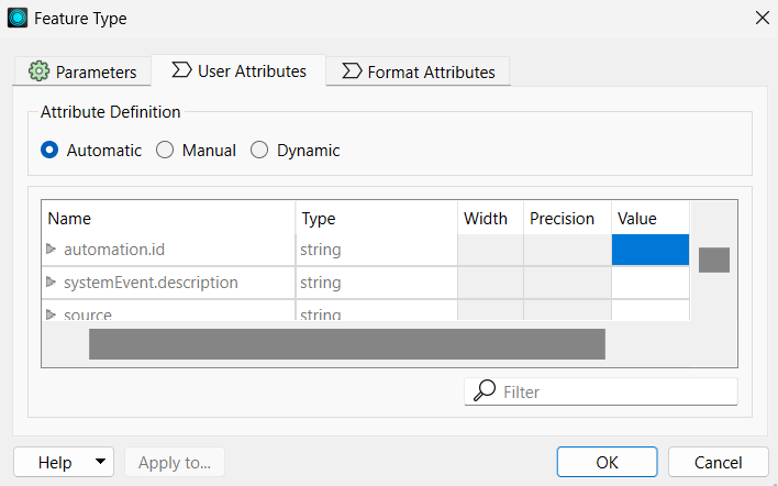

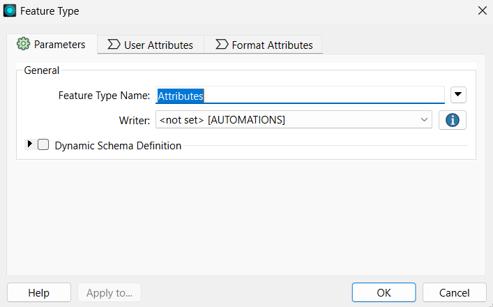

We can now add the FME Flow Automations writer to the canvas and set the Feature Type Name parameter as Attributes. Ensure the User Attributes definition is set to Automatic.
The workspace can be published to FME Flow and used in your automation workflows. You may go back to Part 1 to review how to create the automation.
