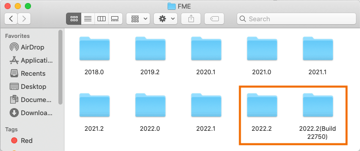

macOS
In macOS, the default directory is Major.Minor release, for example FME 2022.2. If you want to install multiple builds of the same Major.Minor release, you will need to manually rename the already installed version in a Finder window under /Applications. As a best practice, change the default name of the folder to include the build number. After renaming the existing installation, proceed with the new installation.
