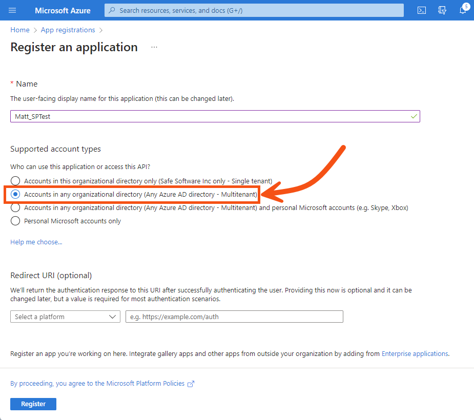

1. Register an App in the Azure Portal
Log in to the Azure portal and go to App Registrations.
App Registration

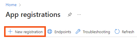

Add a new registration.
New App Registration
Choose ‘Accounts in any organization directory (Any Azure AD - directory - Multitenant)’. Leave the Redirect URI blank for now, we will update this in a later step. Click Register.

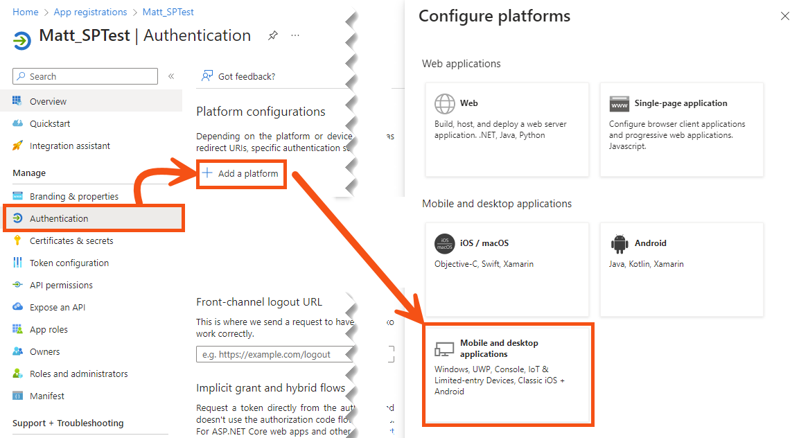

3. Add the Platform and Redirect URI

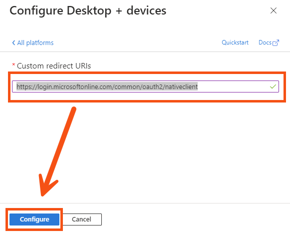

Click Authentication and then 'Add Redirect URI'
For the Platform, Choose Mobile and desktop applications.
For the redirect URI, enter http://localhost
Click Configure.
You should now see Mobile and desktop applications with the redirect URI added in the previous step.

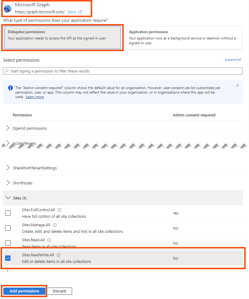

Choose Microsoft Graph from Request API permissions.
Graph API Permissions
Click Delegated permissions. Search for and then check off Sites.ReadWrite.All. Click Add Permissions.
Configure Graph API Permissions
Once added, you should see the Sites.ReadWrite.All permissions in the list of Configured permissions.

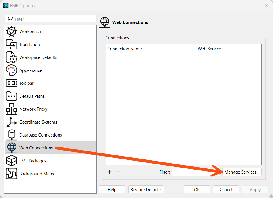

1. Open Web Services
In FME Form, go to Tools > FME Options > Web Connections > Manage Services.

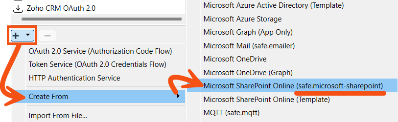

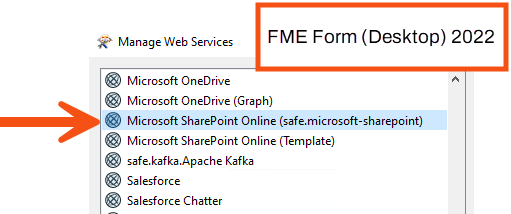

2. Create a New Web Service
On the Manage Web Services screen, click the plus sign below the list of web services and then Create From > Microsoft SharePoint Online (safe.microsoft-sharepoint).
Do not choose Microsoft SharePoint Online (Template). It is for the Legacy SharePoint List Reader/Writer and will not work with the SharePointOnlineConnector or SharePoint Online List Reader/Writer.

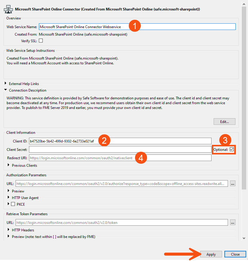

3. Populate the Web Service
  1. Web Service Name: provide a unique name. It’s recommended to include the Azure app registration name, so that you can cross-reference it.
  2. Client ID: the Application (client) ID from the Azure multitenant tenant app
  3. Not Required: leave this checked - the client secret should only be added in FME Flow
  4. Redirect Strategy: Choose 'Loopback Interface Redirect'. If you are using a version of FME before 2025.2, this option is not available, and the internal FME browser will be used. To learn more, please read External Browser Authentication
  5. Redirect URI: http://localhost to match what was entered in the Azure multitenant app.
It’s important to ensure that the web service’s Redirect URI value matches the custom redirect URI that was applied to the Azure registered application in Create the Azure App Registration step 3. If these two values do not match, the web service will not function properly.
Click Apply.

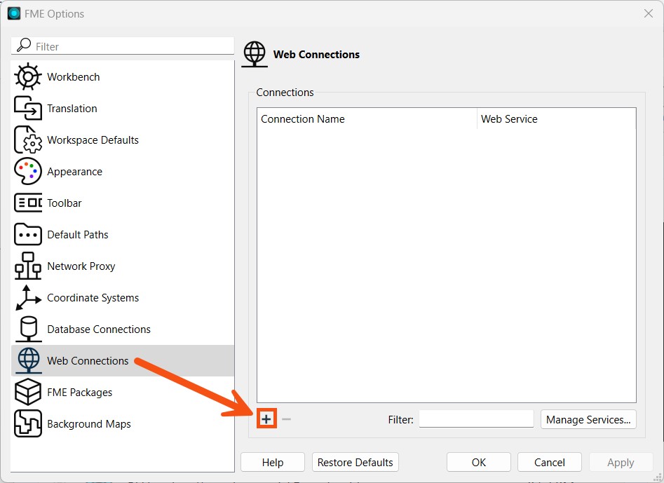

5. Create the Web Connection
From Web Connections, click the plus (+) button to add a new connection.
Choose the web service you created and give the connection a unique name. Click OK.
