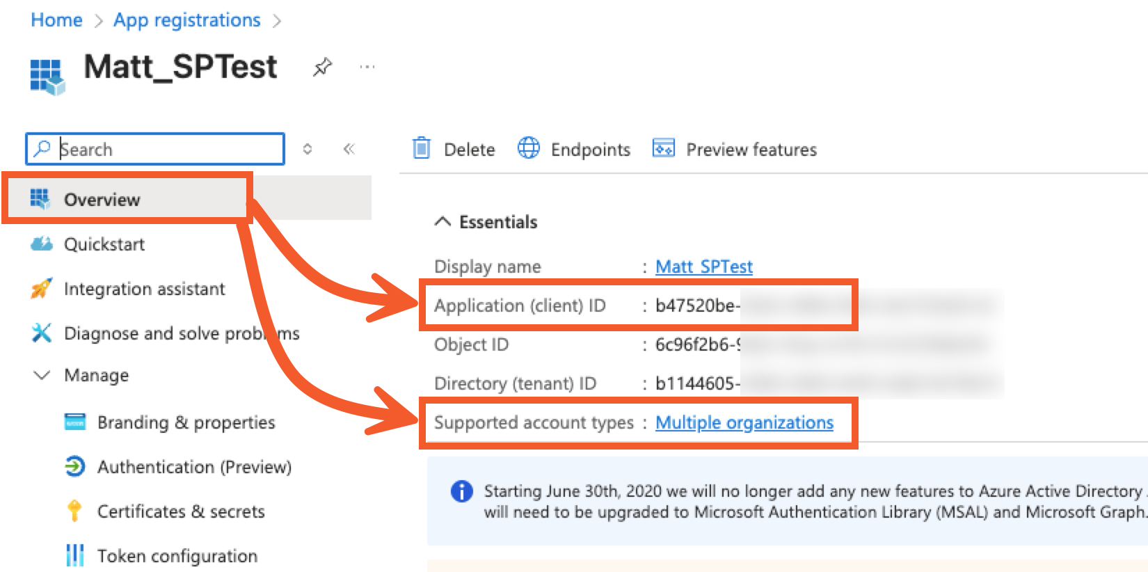

2. Obtain the Client ID and Tenant ID
On the new app’s Overview page, take note of the Application (client) ID. This will be used to configure the web service later.
You can confirm that your app is a multitenant app if the value of ‘Supported account types’ is ‘Multiple organizations’.

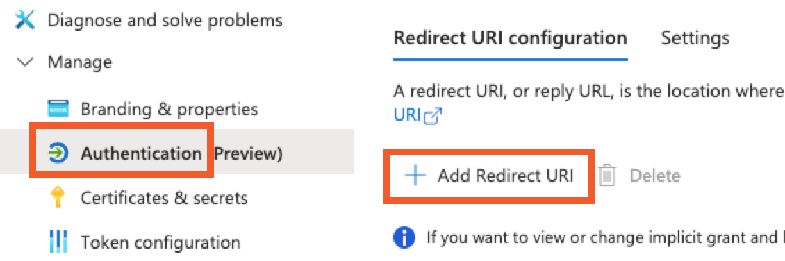

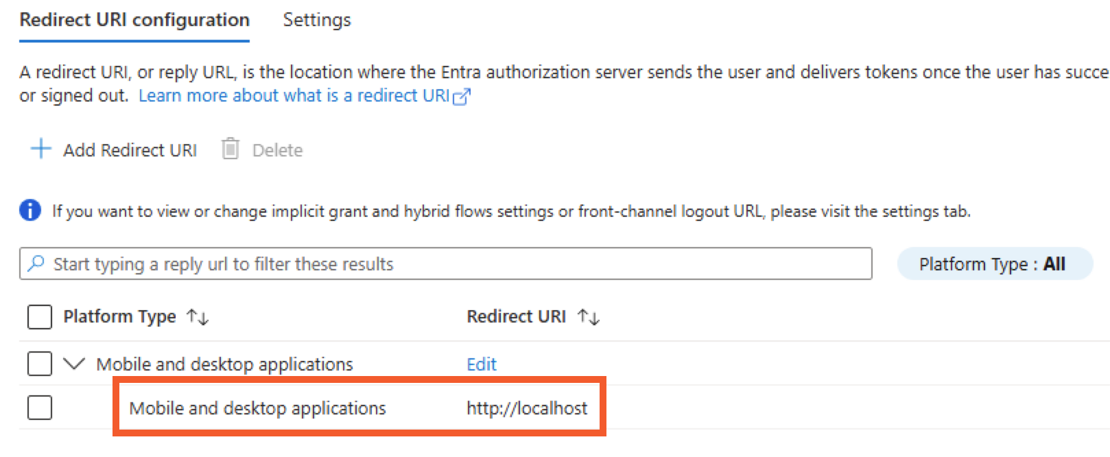

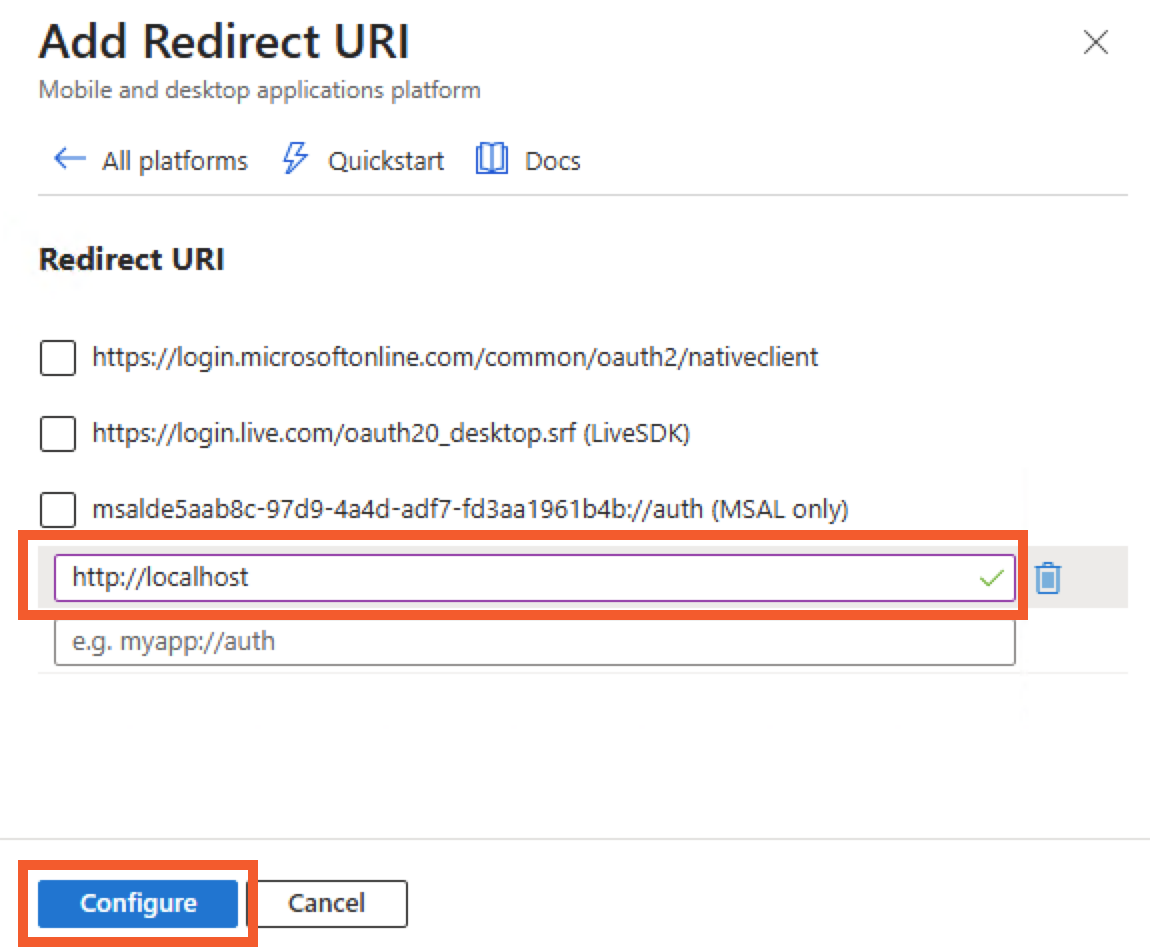

3. Add the Platform and Redirect URI
Click Authentication and then 'Add Redirect URI'

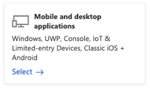

For the Platform, Choose Mobile and desktop applications.
For the redirect URI, enter http://localhost
Click Configure.
You should now see Mobile and desktop applications with the redirect URI added in the previous step.

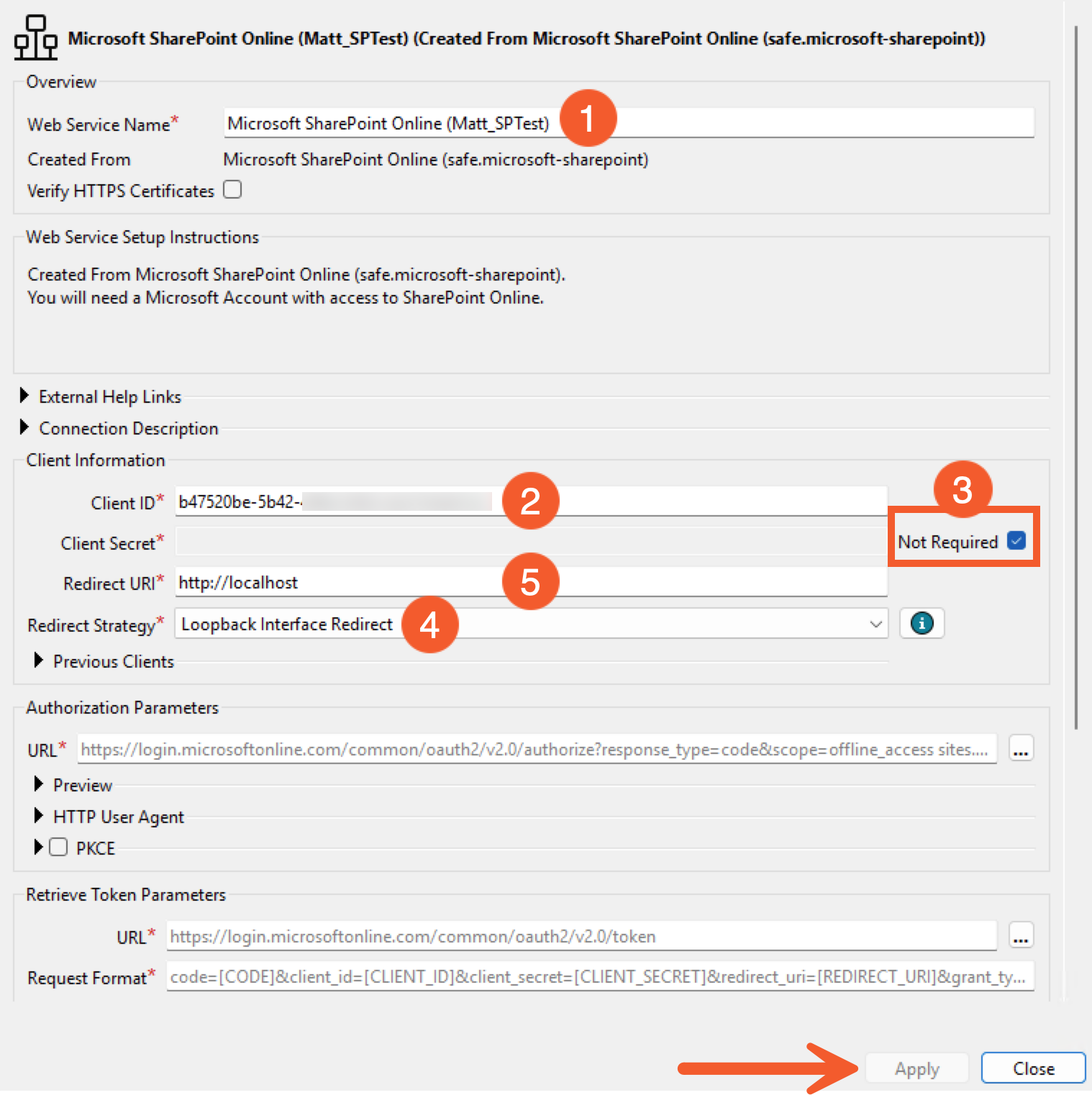

3. Populate the Web Service
  1. Web Service Name: provide a unique name. It’s recommended to include the Azure app registration name, so that you can cross-reference it.
  2. Client ID: the Application (client) ID from the Azure multitenant tenant app
  3. Not Required: leave this checked - the client secret should only be added in FME Flow
  4. Redirect Strategy: Choose 'Loopback Interface Redirect'. If you are using a version of FME before 2025.2, this option is not available, and the internal FME browser will be used. To learn more, please read External Browser Authentication
  5. Redirect URI: http://localhost to match what was entered in the Azure multitenant app.
It’s important to ensure that the web service’s Redirect URI value matches the custom redirect URI that was applied to the Azure registered application in Create the Azure App Registration step 3. If these two values do not match, the web service will not function properly.
Click Apply.

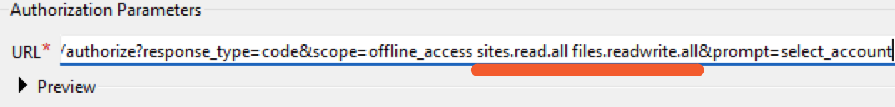

Note: If you assigned more restrictive API permissions when creating your Azure app registration in the previous section, then you will need to modify the Authorization Parameters URL to match those permissions. For example, if you granted the Sites.Read.All and Files.ReadWrite.All Graph API permissions to your Azure app registration, it would look like this:

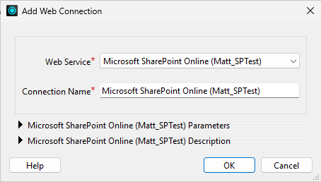

5. Create the Web Connection
From Web Connections, click the plus (+) button to add a new connection.
Choose the web service you created and give the connection a unique name. Click OK.

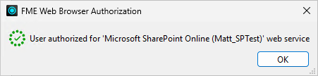

You will be prompted again to authorize with Microsoft.
After successful authorization, your web connection and service are ready to use in FME Form.
