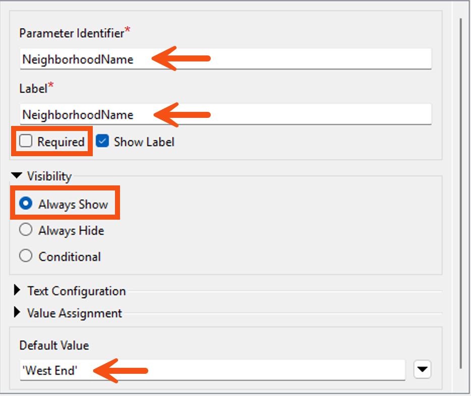

1. Add a User Parameter
Before beginning, ensure that you have completed the previous steps up until Step 4. In the Navigator pane, right-click on User Parameters and select Manage User Parameters.
In the top-left corner, click on the green plus (+) sign and select Text as the parameter type.
Next, on the right-hand side of the dialog, enter the following parameter properties:
  • Parameter Identifier: NeighborhoodName
  • Prompt: Neighborhood Name
  • Visibility: Always Show
  • Required: Disabled
  • Default Value: ‘West End’
Ensure that there are single quotes around ‘West End’ and then click OK.
