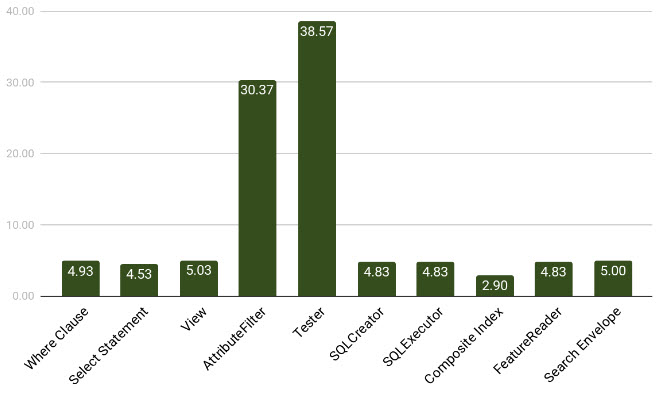

The following chart compares the translation times when accessing a smaller subset of features (19,412 features) from the Oracle database in the exercise workspace:
Reading in all of the data using an Oracle Spatial Reader, with a Tester to filter for COUNTRYCODE = CA, takes approximately 300 seconds.
The where clause, select statement, and view methods are quite comparable with a smaller number of features. Using a larger subset of features, the select statement proves to be a faster read since it also limits the number of attributes being read in.

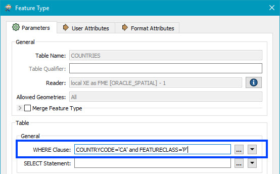

Example 1: Table with Where Clause
Notice that by using the Where clause in the Navigator, FME will limit the features read to those that satisfy the condition.

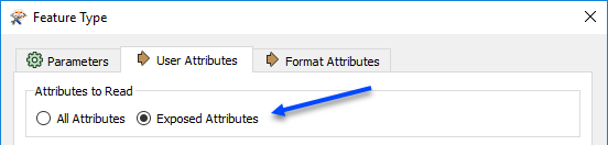

An alternative way to reduce the number of attribute read is to use the Exposed Attributes option, along with a WHERE:

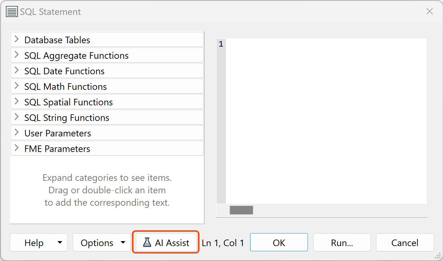

In FME 2023.1 and greater, you can access the AI Assist through the SQL Statement Editor. It will appear as a button in the bottom left corner of the window.

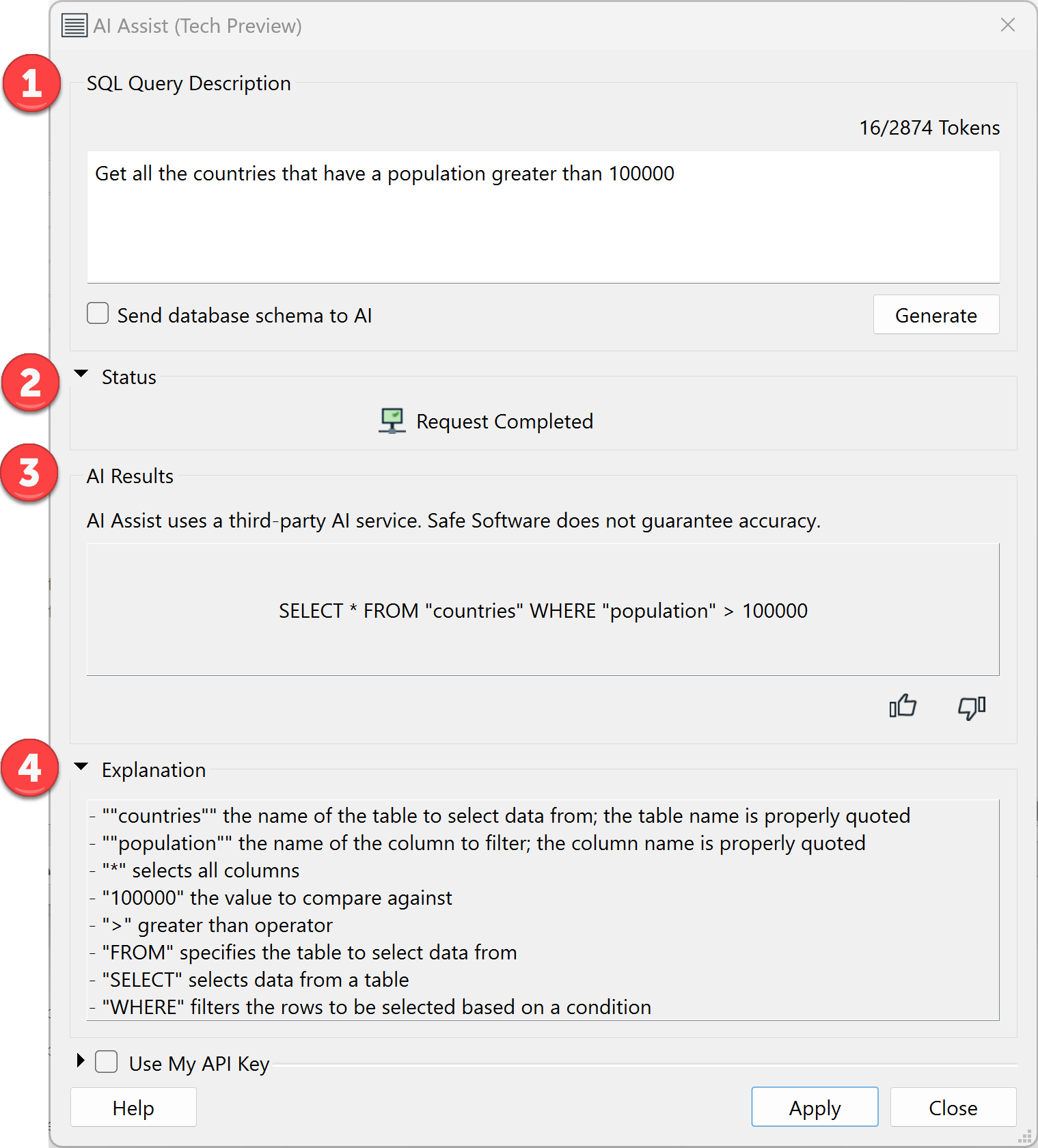

Using the sample screenshot below, we will provide an overview of each component of the AI Assist window.
1.  SQL Query Description
This is where you can specify your request in plain English. For example:
"Find all the countries that have a population greater than 100000"
This would return a SQL statement such as:
SELECT * FROM “countries” WHERE “population” > 100000
Send database schema to AI
When enabled, FME scans your database schema to provide a more accurate result from the AI Assist. The resulting SQL is tailored to the tables and columns in your database instead of providing generic naming.
Let's use the following example request:
With Send database schema to AI enabled, the AI will try to match the SQL query with the tables and columns in your database.
The AI returns the following SQL statement:
SELECT * FROM "public"."Countries"
WHERE "population" > 100000
Tip: The Send database schema to AI parameter can prolong the time it takes to return a SQL query from the AI Assist. This is because FME must parse through all the database tables and column names and send them to the AI. The number of tables and columns in each table will dictate how long it takes FME to scan your database schema.
2. Status
Provides an overview of the status of the AI request and whether it succeeded or not.
3. AI Results
This is the result from the description after it has been run through the AI data model. This will include a functional SQL query to use in the SQL editor. If Send database schema to AI is enabled, then the query may include accurate table and column names.
4. Explanation
To help users understand the AI results, each object within the SQL query is broken down with an explanation.

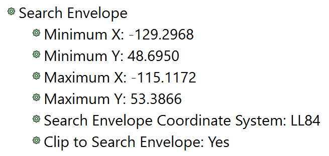

Example 8: Using the Search Envelope
In the Navigator, you can define a Search Envelope to help limit the number of features being read in. Specify the four coordinates and the coordinate system. There is also an option to Clip to Search Envelope. This is faster than reading in all of the data and then clipping by the coordinates in the workspace.
