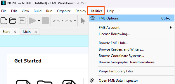

In FME Workbench or FME Data Inspector, on the top menu bar, go to Utilities > FME Options (Windows), FME Workbench > Preferences (macOS and Linux).
For FME 2025.0 and older, please go to Tools > FME Options

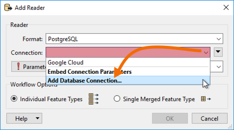

The other option for creating a Database Connection is from within the Add Reader/Writer dialog in FME Workbench or FME Data Inspector. After selecting either PostgreSQL or PostGIS as the Format, the dialog will change from Dataset to Connection. Click the drop-down in the Connection dialog, then select Add Database Connection. This drop-down will also show other database connections for this format that you may have already created. Proceed to Add Credentials and Testing.

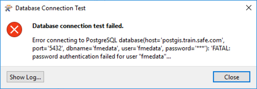

Click Test. If the test is successful, click Save, and the database connection is ready to use.
If the Test fails, confirm that the credentials were filled in correctly. If the Test still fails, ensure that the database is turned on, or, if you are using a cloud-based database, that your computer or network IP address has been set as an Authorized Network (see Google Cloud example documentation). If you are still having trouble, see the Troubleshooting section for PostgreSQL or PostGIS in our documentation.

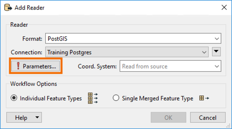

In a blank FME Workbench canvas, add a PostGIS reader. If you haven’t already set up your database connection, click on the drop-down next to Connection and then follow the steps listed in Connecting to a Database. Once you have selected or connected to the database, click the Parameters button.
In the Parameters dialog, click on the ellipsis next to Table List to open up the PostGIS/PostgreSQL database. Select which tables you would like to read in. Once the table has been selected, click OK twice to add the reader to the canvas. For this example, read in public.AddressPoints
