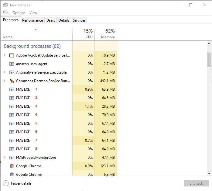

2. FME.exe not terminating
If you receive this error but are not attempting to run more than 8 concurrent workspaces then check in your Task Manager for any idle fme.exe processes that have failed to terminate upon earlier job completion.
Idle (0% CPU) FME EXE processes still showing in Task Manager after a job is canceled

  • Check the Task Manager / Activity Monitor for any idle fme.exe processes that may have failed to terminate upon job completion and manually shut these down to clear the error.

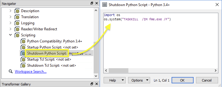

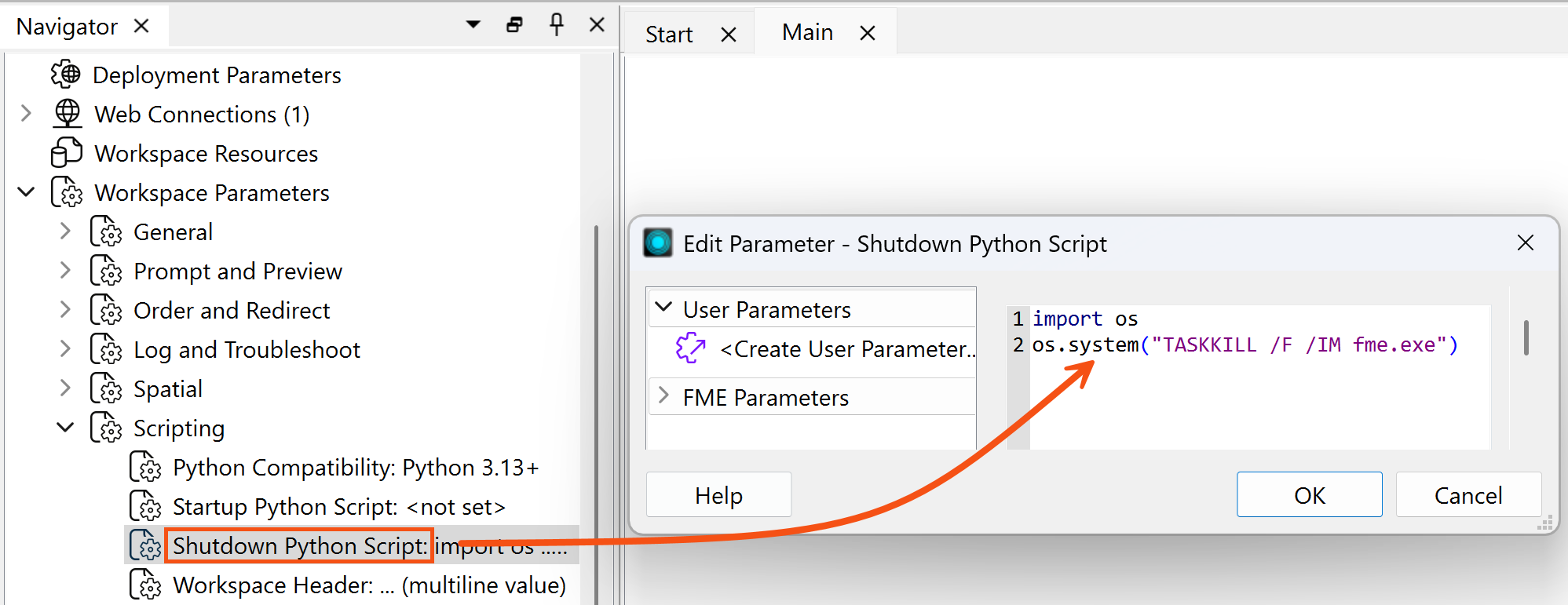

If this is a recurring issue, a workaround is to set up a Python Shutdown Script to end all fme.exe processes after the workspace in question is done. You can find an example script here.
Example Shutdown Python Script
Note: You will not be able to do this if there are other fme.exe processes still running as these will also be terminated, but you could set up a schedule for a script to run at times you know the there are no other running workspaces.

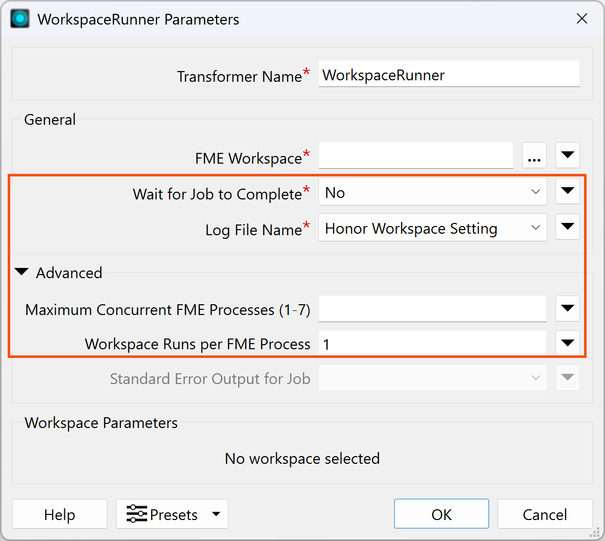

If you are using a WorkspaceRunner
The WorkspaceRunner transformer was developed so that running one workspace would trigger the run of a series of child workspaces. This works by spawning a new FME process and is useful for batch processing however using this transformer can generate the licensing error. You can control the spawning of new FME processes in the transformer parameters to help reduce the risk of this error occurring.

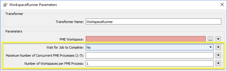

The key parameter to be aware of is ‘Wait For Job to Complete’:
  • If this is set to Yes (default) then the transformer will wait for each job to complete before processing the next feature so will not spawn off additional FME processes.
  • If this is set to No then the user is essentially allowing parallel processing and two more parameters become available:
    • ‘Maximum Number of Concurrent FME Processes’ - defines the number of FME processes to be launched so that multiple workspaces can run simultaneously. The main workspace uses a single fme.exe process leaving a further 7 processes available to be launched for use by the child workspace. If no value is set then the maximum of 7 concurrent processes will be used.
    • ‘Number of Workspaces per FME Process’ - controls the number of workspaces to be run consecutively on a single FME process before it is shut down. This may help prevent the chance of hanging fme.exe processes.
WorkspaceRunner parameter editor
Adjusting these parameter settings should help you to avoid further encounters with the licensing error. For example: setting the ‘Maximum Number of Concurrent FME Processes’ to 5 would leave 2 FME processes available to run other workspaces.

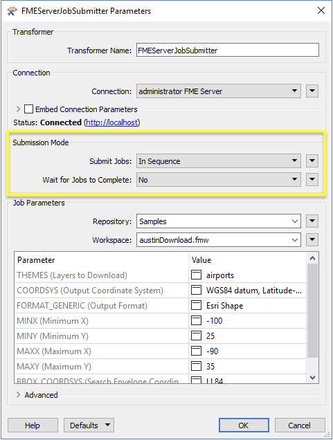

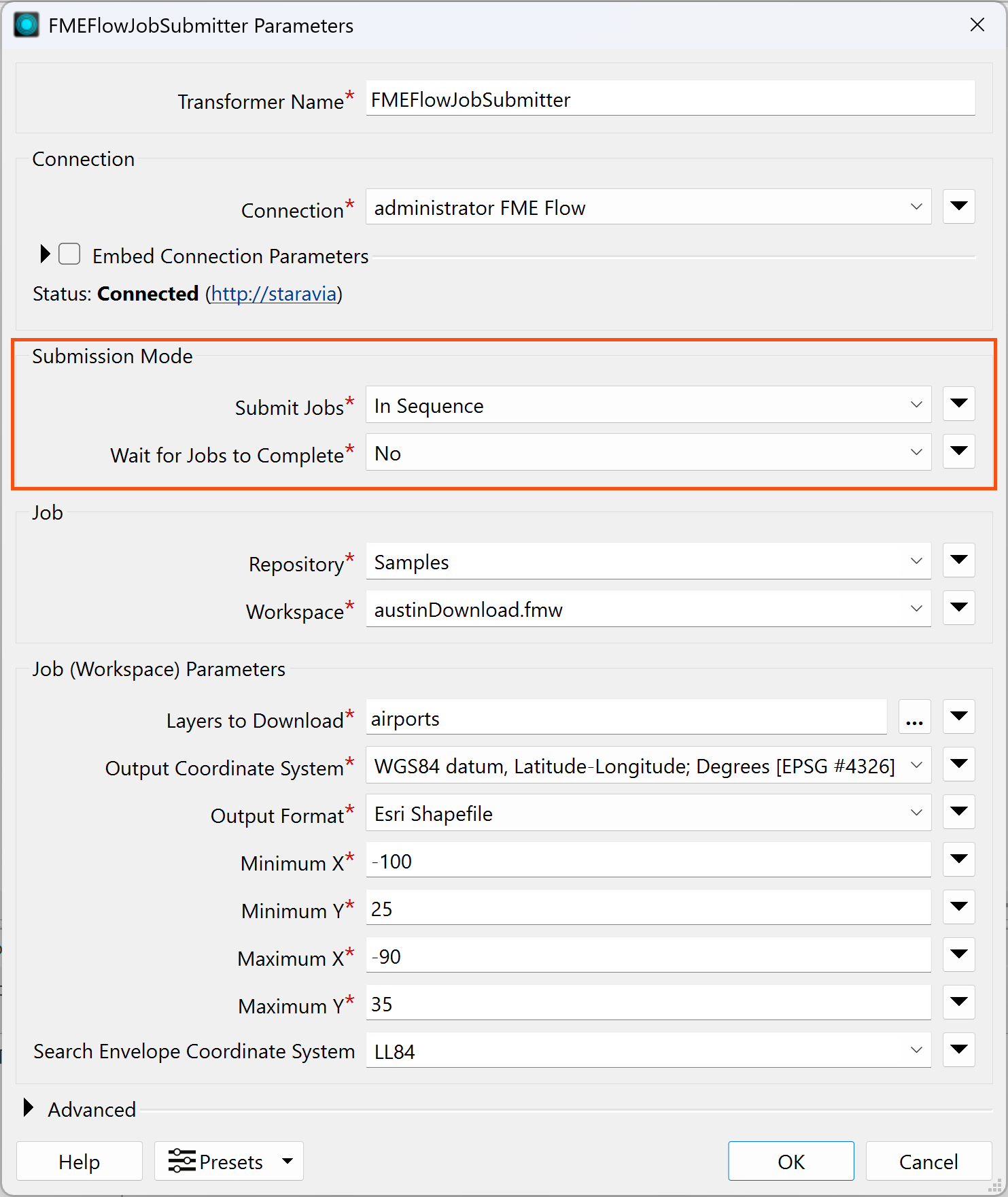

The FMEServerJobSubmitter has the same underlying role as the WorkspaceRunner but provides additional parameters such as designating a Job Queue. This transformer submits one job per feature that enters it but key parameters to be aware of here are found under Submission Mode:
  • ‘Submits Jobs’ - this transformer determines whether a request is submitted as soon as an initiating feature has arrived (In Sequence) or whether it waits until all input features have been received before sending out the requests (In Parallel).
  • ‘Wait for Jobs to Complete’ -
    • If this is set to Yes then the jobs are run synchronously, that is the transformer will wait until the job is completely processed and the initiating feature is output via the Succeeded port with additional attributes added to it.
If this is set to No then the jobs are run asynchronously, meaning the job id is output via the Submitted port as soon as the server receives the request.
