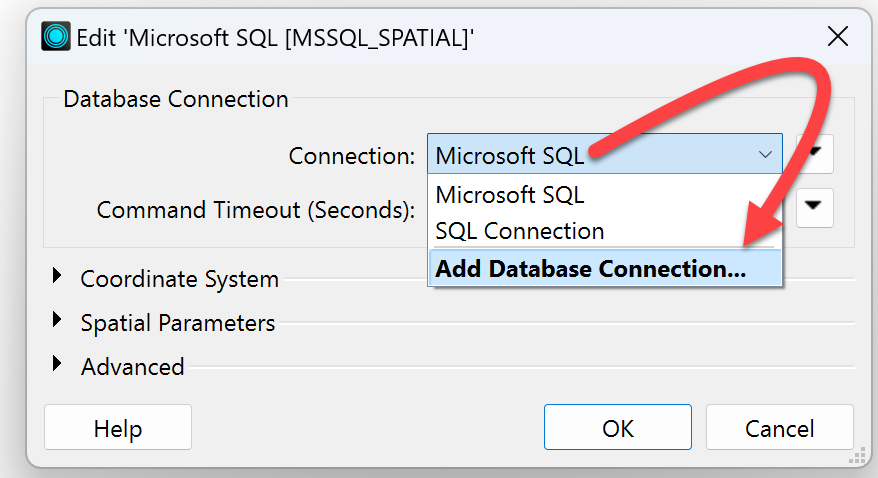

In the Edit ‘Microsoft SQL [MSSQL_SPATIAL]’ dialog, click the drop-down next to Connection and click Add Database Connection.
Then add your Microsoft SQL database connection parameters. For more information on setting up a Microsoft SQL database connection, please see the article Viewing and Inspecting SQL Data. Once the connection has been added, ensure it is selected, and click OK.

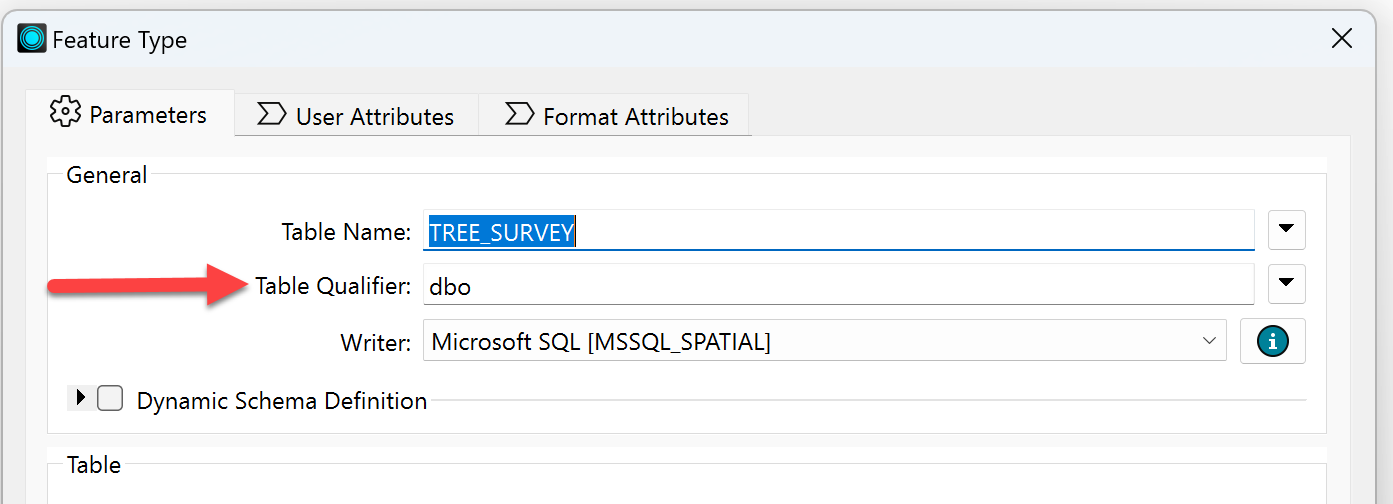

There is one more thing to change before we can run this workspace. Double-click on the SQL Writer feature type to open the Feature Type parameters. Change the Table Qualifier name to the username of your database. For this example, we are using the dbo username. Once that is updated, click OK.

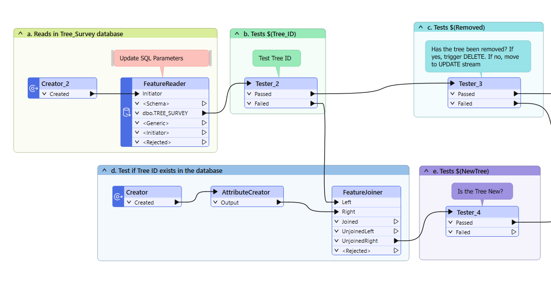

Close the first workspace and then open TreeSurvey.fmw. This workspace will read the database and then based on the user parameters either INSERT, UPDATE, or DELETE the data in the database.
There are a variety of user parameters created to allow user input when we upload this workspace to FME Flow.

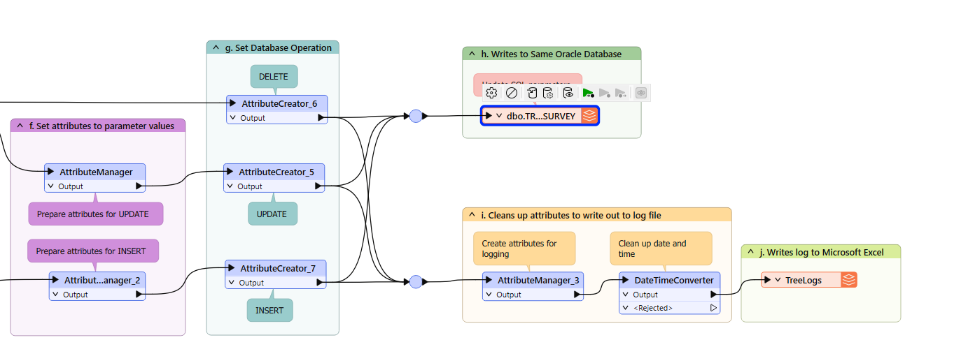

Let’s go through what this workspace does:
a. Reads in the Tree_Survey database table created with CreateTableInSQL.fmwt
b. Tests the user parameter $(Tree_ID), if the Tree_ID exists, it will move on to the UPDATE or DELETE section. If it doesn’t exist, it will move to the INSERT section.
c. Has the tree been removed? This is based on the $(Removed) user parameter. If yes, then it triggers the DELETE workflow. If no, then it moves to UPDATE.
d. Joins the $(Tree_ID) user parameter with the Tree_ID attributes in the database to see if the value input for the user parameter exists in the database. If it doesn’t, it moves onto the INSERT workflow
e. Tests the new Tree_ID and if the tree is new. If it is new, then it continues the INSERT workflow, if it is not new, the workspace ends.
f. Sets the additional user parameters to include in the UPDATE or INSERT
g. Sets the database operation with the FME specific attribute fme_db_operation, additionally for DELETE and INSERT it uses a WHERE clause to identify exactly which record to DELETE or INSERT.
h. Writes out to the same SQL database table as the FeatureReader, and switches the database operation based on the previous AttributeCreators.
i. Cleans up attributes in preparation to write out to a log file.
j. Writes out the Database Operation, Date and which attributes were written to the database in a Microsoft Excel file. This file can be used to monitor changes to the database.

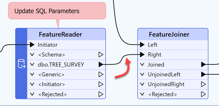

5. Update FeatureReader

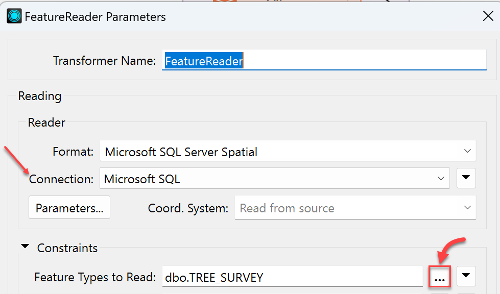

In this second workspace, open the FeatureReader parameters and change the Connection to the Microsoft SQL connection you created in the previous workspace. Additionally, click the ellipsis next to Feature Types to Read and select the Tree_Survey in your database. Click OK to close the Feature Reader.
When you update the FeatureReader ensure that the output port yourusername.TREE_SURVEY is connected to the Tester_2.

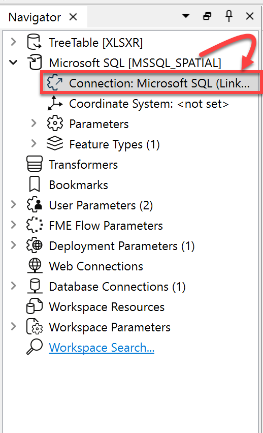

Next, we will need to update the connection parameters for the Microsoft SQL Writer. In the Navigator window, change the Microsoft SQL connection to your connection, the same way as the previous workspace.
Once the connection is created, open up the SQL Writer Feature Type and change the Table Qualifier to the username you used in the previous workspace, in this example, we are using dbo. Also change Table Name, if necessary.

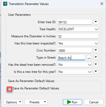

In the Translation Parameter Values dialog enter the following:
  • Tree ID: 59152
  • Tree Health: EXCELLENT
  • Measure the Diameter in Inches: 52
  • Has the Tree Been Inspected: Yes
  • Civic Number: 1800
  • Type in Street: Beach Av
  • Has dead tree been removed?: No
  • Is this tree new for this year?: No
  • Uncheck: Save As User Parameter Default Values
Once the parameters are entered, click Run. This will trigger an UPDATE in the database. You can inspect the database to confirm this update. As well, you can also view the Microsoft Excel TreeLog, which will include the parameters we just set, the database operation UPDATE and today’s date and time.

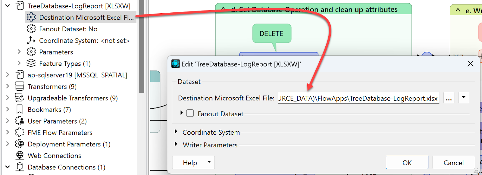

Before publishing to FME Flow, you need to decide if you want your Excel log file to be available to the user running the Flow App. If you do not, you can either leave the Excel file to be updated locally on your machine OR you can set it up to update in the FME Flow Resources folder.
To update the file to save it to FME Flow, expand the TreeDatabase-LogReport writer in the Navigator window. Then double-click on the Destination Microsoft Excel File parameter to open up the edit dialog. In the edit dialog, click on the drop-down next to Destination Microsoft Excel File, then choose User Parameter > FME Flow Parameters > FME_SHAREDRESOURCE_DATA. Then after $(FME_SHAREDRESOURCE_DATA) type in \FlowApps\TreeDatabase-LogReport.xlsx
$(FME_SHAREDRESOURCE_DATA)\FlowApps\TreeDatabase-LogReport.xlsx
Click OK. Save the workspace, and then click on the Publish icon in the top toolbar.

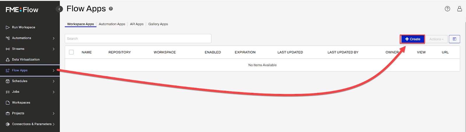

1. Log into FME Flow
Log into FME Flow with an account that has privileges to create FME Flow Apps. Once logged in, go to the Flow Apps section and then click on Create.
Additionally, you can create an FME Flow App through the Run Workspace Page Advanced section.

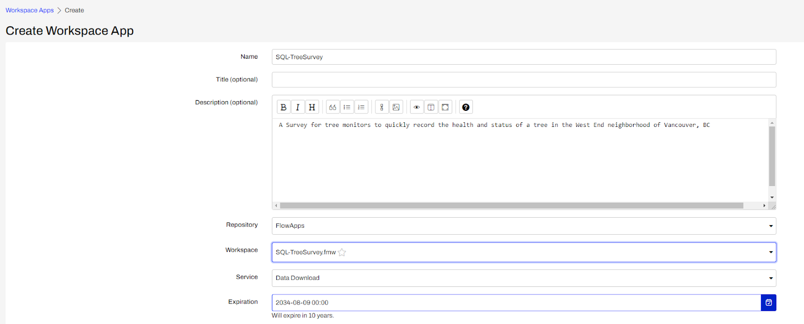

2. Create FME Flow App
On the Create Flow App page, give your app a name and short description. Then select the Repository and Workspace.
Choose which Service you want to use. Remember if you want your log file public, use the Data Download service, if you want it private, use the Job Submitter.
Next, check the Expiration date. By default, apps are set to expire in 10 years. It might be a good idea to set this expiration date to a shorter time. This expiration time can be changed at any time.

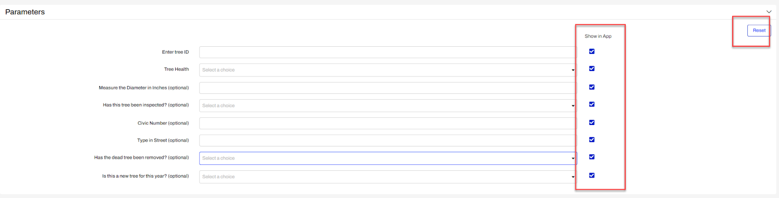

Now expand the Parameters section, and double-check the defaults for the app. If your parameters have values next to them, click on the Reset button. By setting all the values to blank, this will ensure that the user doesn’t miss a parameter when they enter their own values. Also ensure that all of the desired parameters are being shown in the app, which is indicated by the green checkmark next to each parameter.
Finally, you can expand the Customize Appearance section and add color, text, or images to your final app page.

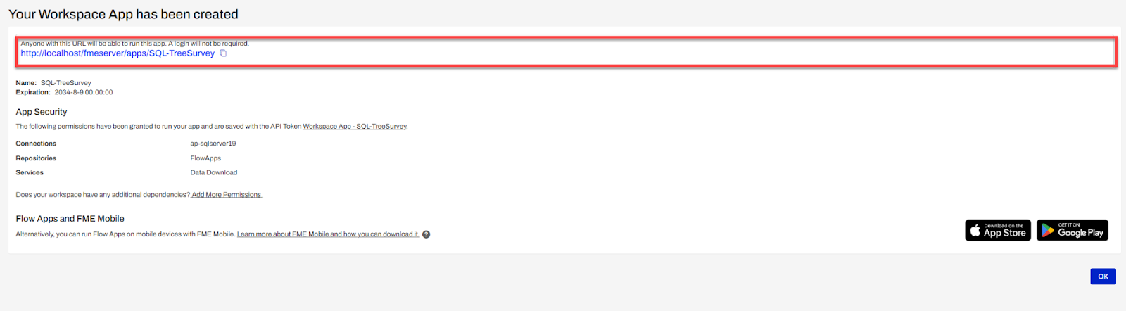

Once you are satisfied with your app, click OK. You will get a URL that links to your app.
3. Test App
Click on the URL that was provided at the end up the app setup.
To share the FME Flow App with anyone, the FME Flow must be accessed externally, not internally using localhost.
If you navigated away from the page with the URL, you can reaccess it by going to Flow Apps on the side menu and then clicking on the URL icon next to your app name.
