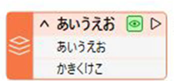

The source file contains attribute names which consist of Japanese characters. Without UTF-8 process encoding, these Japanese characters are replaced
Users working in FME 2022+ and who read the same source file as in the above two examples, on a machine that allows applications to adjust process encoding to UTF-8, will see encoded string values from the source dataset being read correctly:
The source file read by this CSV reader is the same file that produced the error reported in the image above. Its file name and attributes all contain encoded (Japanese) characters.

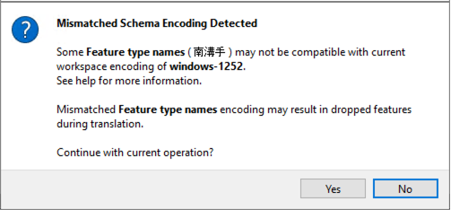

A workspace that was built using a machine set to one locale (eg. windows-1252), but is then opened on a machine set to a different locale (eg. UTF-8), which may trigger a Mismatched Schema Encoding notice if the workspace contains characters that are not compatible between the two locales involved, and the user tries to add a dataset that conflicts with the locale in which the workspace was built.
  • If users wish to keep the workspace compatible with the original locale, users should avoid adding datasets that may conflict with the original locale, or accept that there may be dropped features
  • If users wish to upgrade the workspace to the new locale, it is recommended that users recreate the workspace on a machine set to the desired locale (eg. UTF-8)
