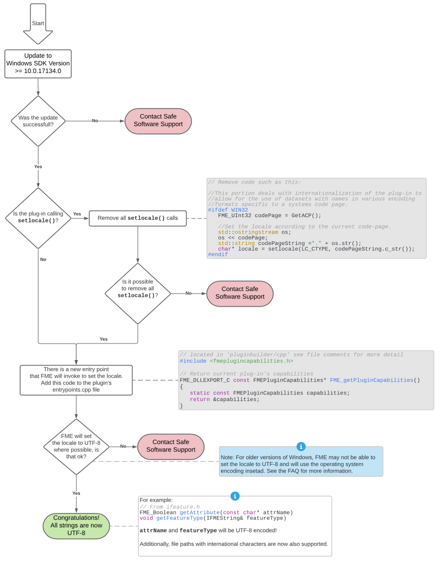

All existing plug-ins must be upgraded to work with FME 2022.0 or newer. Upgrading to use the new FME 2022.0 API version requires recompilation of the plug-in, making a few entry point changes, and potentially adjusting locale usage to work correctly with the UTF-8 or operating system encodings used by FME.

The Windows SDK version is the target that the plug-in will be compiled against and is defined per plug-in in the Visual Studio project settings and must be at least 10.0.17134.0.

For FME plug-ins for versions 2021.1+, FME introduced a new DLL entry point which is a centralized way for a plug-in to advertise and customize various capabilities. FMEPluginCapabilities is located in
<fme install directory>/pluginbuilder/cpp/fmeplugincapabilities.h.
Below is the recommended default implementation of the new entry point for all plug-ins:
// located in 'pluginbuilder/cpp' see file comments for more detail #include <fmeplugincapabilities.h> // Return current plugin's capabilities FME_DLLEXPORT_C const FMEPluginCapabilities* FME_getPluginCapabilities() { static const FMEPluginCapabilities capabilities; return &capabilities; }

The setPluginLocale() method on the FME Plug-in SDK allows FME to set up the default string encoding when communicating with a plug-in.
As of FME 2022.0, the default process locale and encoding are UTF-8. When using the default implementation of FME_getPluginCapabilities, the following can be expected from all API calls:
- All const char * and IFMEStrings without an accompanying encoding parameter will be UTF-8 encoded
- All strings returned via const char* and IFMEString by the plug-in are expected to be UTF-8 encoded
- File paths containing international characters are now supported
If a plug-in is compiled with a C++ Shared Runtime (/MD):
- Whenever setlocale() is called from any shared runtime DLL, the setting affects all DLLs using the same shared runtime, including every compilation unit in the DLL.
- As of the FME 2022.0 release, FME sets the locale for all shared runtime DLLs to UTF-8. Plug-in authors should avoid calling setlocale() anywhere within the plug-in if using the C++ shared runtime.
- If calling setlocale() is unavoidable, or the plug-in requires a specific locale please contact Safe Software support to discuss potential options for resolving this issue.
