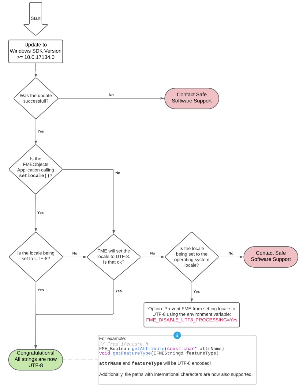

Upgrading to use the new FME 2022.0 API version requires recompilation of the FME Objects application, making a few entry point changes, and potentially adjusting locale usage to work correctly with the UTF-8 or operating system encodings used by FME.

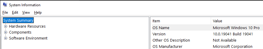

The Windows SDK version is the target that the plug-in will be compiled against and is defined per the FME Objects application in the Visual Studio project settings and must be at least 10.0.17134.0.
The Windows SDK version is distinct from the Windows operating system version, which can be seen in System Information on Windows. Note: Windows 10 must be at least version 1903 or Windows Server 2019 must be at least version 1809 and build 17763.1339 to support a UTF-8 encoding via setlocale() and _wsetlocale().

By default, in FME 2022.0+ the process locale will be UTF-8. This includes all FME Objects applications. However, the environment variable FME_DISABLE_UTF8_PROCESSING will allow using FME with the operating system locale.
- FME_DISABLE_UTF8_PROCESSING=yes
- Launches FME with current operating system locale
- For example, a Windows-1252 encoding on an English US locale
- All other values of FME_DISABLE_UTF8_PROCESSING or the lack of the environment variable would enable UTF-8 processing in FME

However, the FME_createSession() function was kept as an inline function that delegates to the new entrypoint, so recompiling your application is the only action to take. No source code changes are required.
If the FME Objects application was looking up the FME_createSession entry point via GetProcAddress, code changes would be required to access the new entry point (FME_createSession2) directly. Please refer to the documentation for isession.h in your SDK package for more details.
