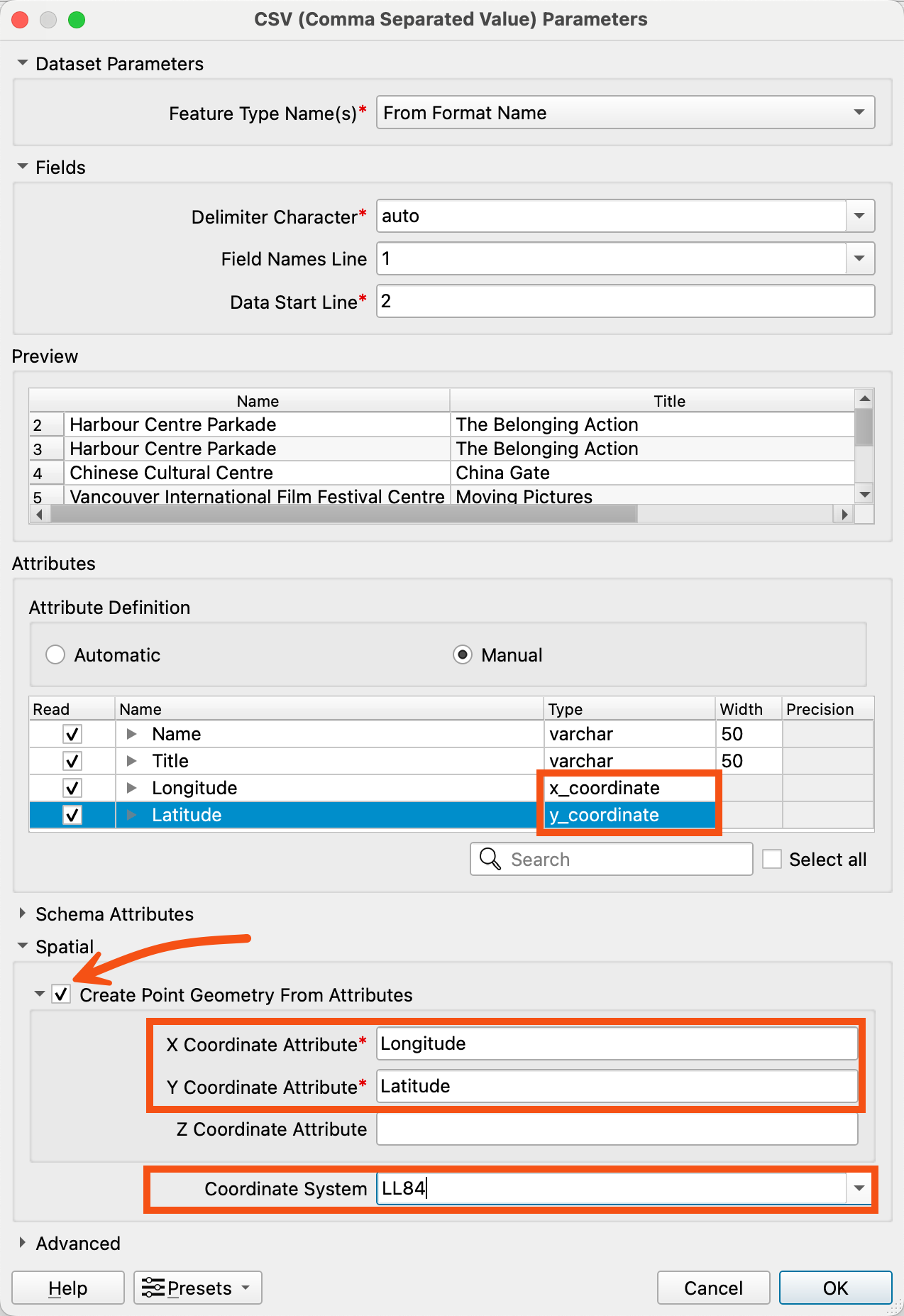

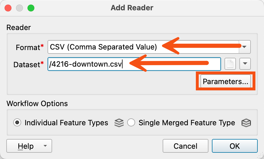

1. Add the CSV Reader
As of FME 2025.2, the Coordinate System parameter is now configured within the Parameters dialog of each reader/writer format. For more information, including details about the change and affected transformers, please see Coordinate System Parameter Location Change.

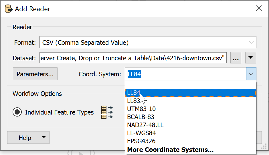

  • In a blank workspace, click the Add Reader icon and add a reader with the following parameters:
    Format: CSV (Comma Separated Value)
    Dataset: /4216-downtown.csv
    ReaderCSV

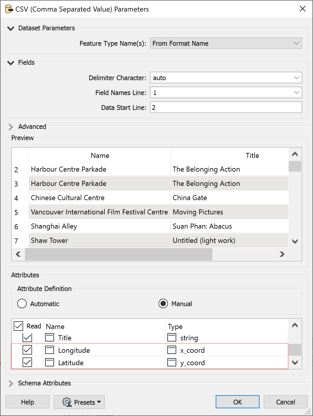

    Click the Parameters button to set the coordinate system:
    Attribute Definition: Manual
    Type: x_coordinate
    Type: y_coordinate
    Create Point Geometry from Attributes: Enabled
    X Coordinate Attribute: Longitude
    Y Coordinate Attribute: Latitude
    Coordinate System: LL84
    ReaderCSV
    Click OK to add the reader to the workspace.

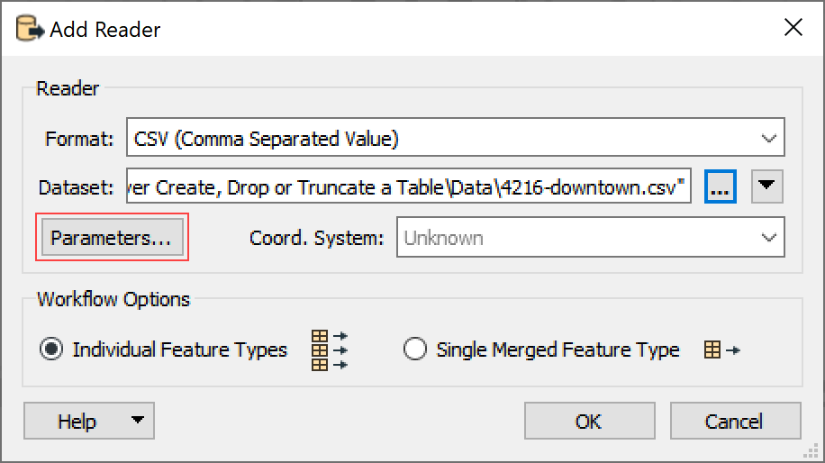

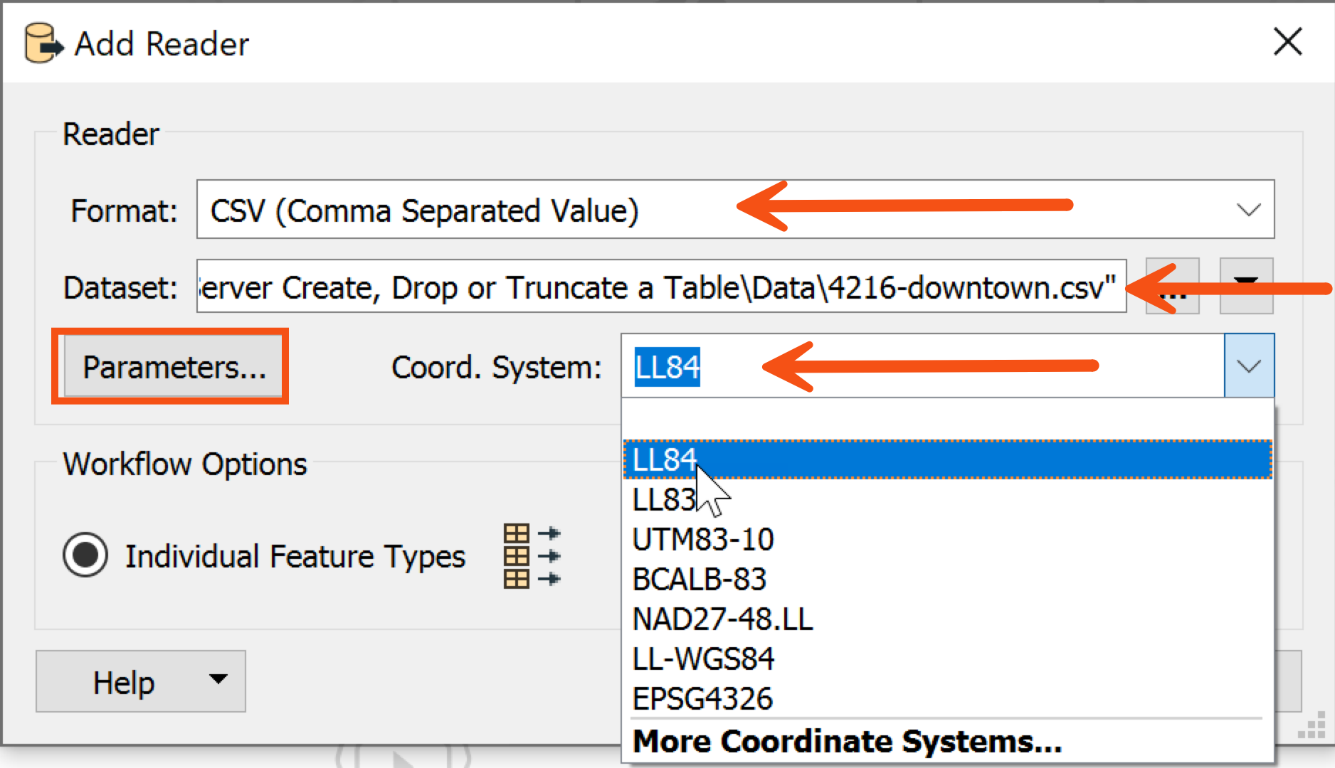

    ReaderCSV
    In the Parameters dialog, confirm that the Longitude and Latitude attributes are set to x_coordinate and y_coordinate, respectively. If they are not, change the Attribute Definition to Manual, then manually set.
    AttributeDefinition

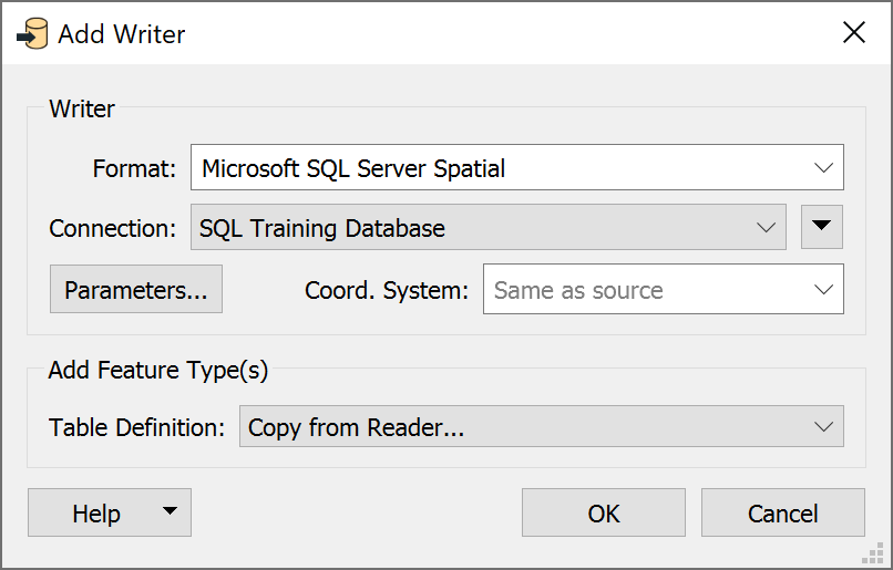

From the Writers menu, Add Writer.

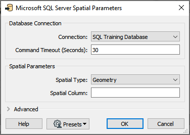

Set the format to Microsoft SQL Server Spatial, and the dataset to the SQL Training Database connection established in Viewing and Inspecting SQL Server data.
Starting in FME 2025.2, many formats that support both spatial and non-spatial data have been combined into a single reader or writer. For an up-to-date list of the formats this change has been applied to, please see Combined Spatial and Non-Spatial Readers and Writers.
Open the Parameters dialog for the Reader and set the Spatial Type to Geography. Clear the contents of the Spatial Column.
If you do not have this named database connection, select the option to Embed Connection Parameters, and after selecting Parameters, enter the parameters manually:
  • Server: sql.fmetraining.ca
  • Database: fmedata
  • Authentication: SQL Server Authentication
  • Username: fmedata
  • Password: SQLtraining2016
  • Spatial Type: Geography
Set the Table Definition to Copy From Reader, so that the attributes from our source are copied into the SQL Server database table.

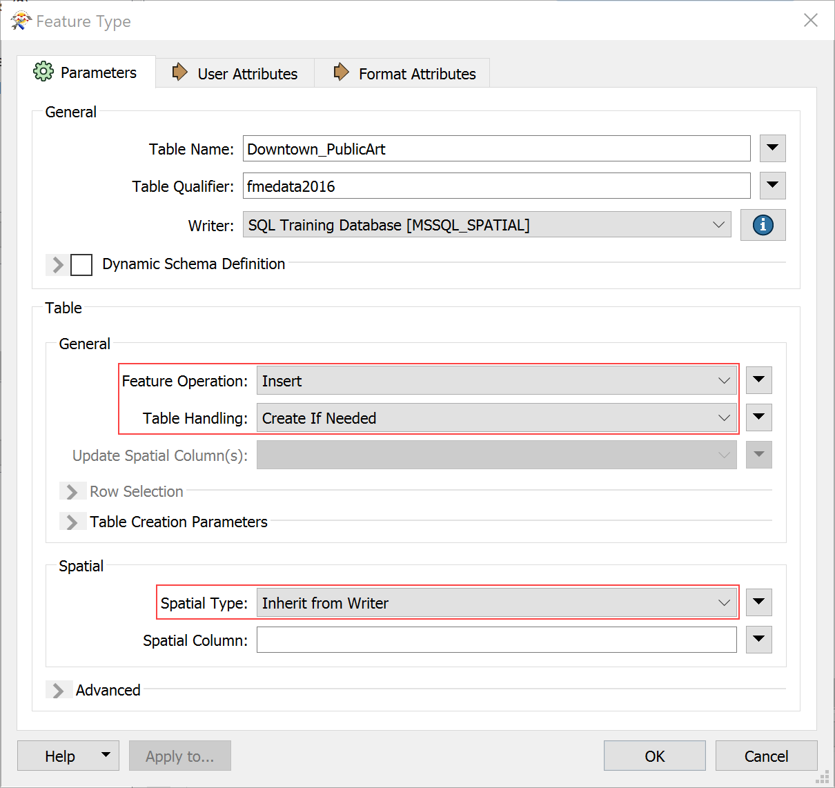

After adding the Writer to the canvas, open the Feature Type Properties. In the General tab, change the Table Name to Downtown_PublicArt, and enter the Table Qualifier as fmedata2016.
The Table Qualifier is the same as the Schema for the Table Listing in the previous Reader parameters. It is specified per database table, as one could write to multiple schemas using the same database writer.
In the Format Attributes tab, check the Table Settings parameters. When creating a new table in SQL Server and adding data to it, the Feature Operation should be set to 'Insert', and the Table Handling should be set to 'Create If Needed'. The Spatial Type can be left as Inherit From Writer.
Click OK to close the parameter window, then connect the Reader to the Writer.

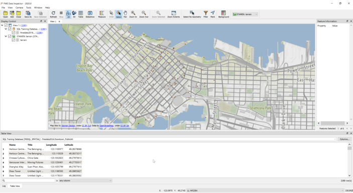

3. Run the Workspace
The SQL Server database will now have the Downtown_PublicArt table. Right-click on the Writer and select Inspect to see the geometry and attributes of the table displayed in FME Data Inspector.
