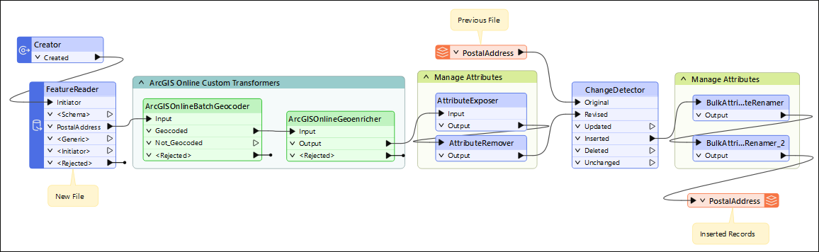

Want to use Microsoft Excel and ArcGIS Online in an automated workspace? Create a workspace in FME Form and create an automation on FME Flow that looks at an Excel sheet of addresses and publishes the final product to ArcGIS Online. Find the sample workspace in the Files section to the right of this article. This example showcases FME's ability to use ArcGIS Online custom transformers, change detection, and directory watching.

Transformers Used
Creator
All workspaces need a source to start the transformation, usually a file or database in a reader. This transformer initiates the workspace by creating a number of empty objects to pass to the next transformer when you run it.
FeatureReader
This transformer reads in a file using a published user parameter so that it can be passed in when you eventually publish it to FME Server.
ArcGISOnlineBatchGeocoder
This is a custom transformer that uses ArcGIS Online’s REST API to perform an analysis service. This service matches point geometry with features that have addresses attached to one or more of their attributes.
ArcGISOnlineGeoenricher
This is a custom transformer that uses ArcGIS Online’s REST API to perform an analysis service. This service matches points with demographic data of your choice, such as age, population, or household income.
AttributeExposer
This transformer exposes certain attributes embedded as list attributes of a feature. The previous custom transformer, the ArcGISOnlineGeoEnricher, does not expose those attributes dynamically.
AttributeRemover
This transformer is used to remove unwanted attributes from the features.
ChangeDetector
This transformer detects changes from one dataset to another, given a key or attribute that would be unique to compare. It has multiple output ports, such as inserted and updated. We use the inserted output port for this example.
BulkAttributeRenamer
This transformer removes spaces and replaces them with underscores “_” so that ArcGIS Online can upload the data in the attributes, the same as the previous file.
Below is the sample workspace with all the transformers mentioned above. To run the workspace on your machine, you'll need to configure the two custom transformers, ArcGISOnlineBatchGeocoder and ArcGISOnlineGeoenricher, with your own Esri connections.

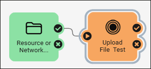

We will create an automation with a "Resource or Network Directory" trigger that checks a specified directory for new files. When new address files are uploaded to the directory, the workspace will run and add those addresses to the geodatabase on ArcGIS Online. Getting Started with Automations has many more examples and detailed instructions of how to set up and run automations.
