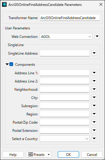

ArcGISOnlineFindAddressCandidate
This custom transformer sends geocoding requests to ArcGIS Online using a full single-line address or separate address components. It’s useful when your data is split into parts like street, city, and postal code. The transformer can be edited after being embedded in a workspace to support additional parameters or customization.

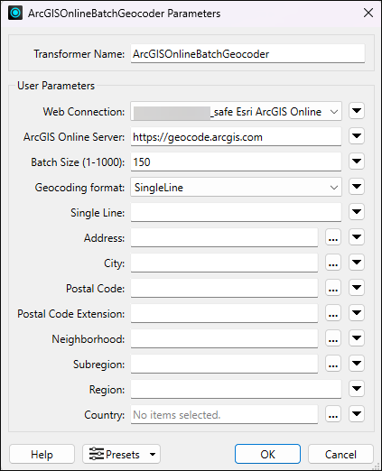

ArcGISOnlineBatchGeocoder
This transformer lets you send up to 1,000 addresses in a single request, reducing the number of HTTP calls and improving performance for large datasets. It is best suited for high-volume geocoding tasks that require efficiency.
