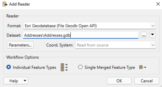

3. Add the Data to the Canvas
After unzipping the Addresses.gdb.zip that you have downloaded, add the Addresses.gdb to the canvas. You can achieve this by either adding a File Geodatabase Open API reader and browsing for the file, or drag and drop the file onto the canvas itself. Select OK.
Select the PostalAddress Feature Class when adding. Select OK again.

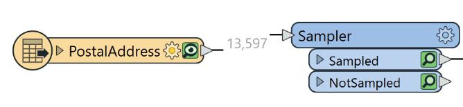

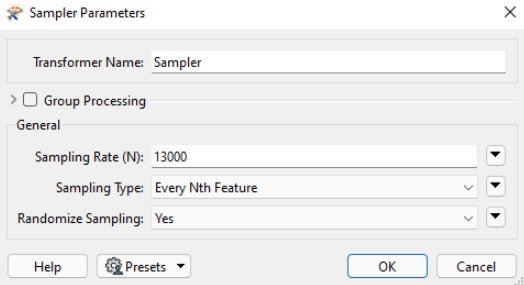

4. Add a Sampler
Add a Sampler with quick add by typing freely on the canvas. Choose a large number for the Sampling Rate and connect it to the reader.
This is because the transformer can only take one input at a time, making an individual HTTP request for every input feature, which would potentially take up more time. If you would like to input all points to be geocoded, then we suggest using the ArcGISOnlineBatchGeocoder.

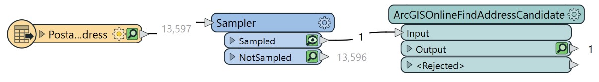

5. Add an ArcGISOnlineFindAddressCandidate transformer
Next, add the ArcGISOnlineFindAddressCandidate custom transformer to the canvas. Connect the ArcGISOnlineFindAddressCandidate to the Sampler.

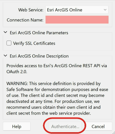

6. Using the ArcGIS Online API
In the ArcGISOnlineFindAddressCandidate parameters, select “Add Web Connection” from the drop-down of the AGOL Web Connection highlighted in red. Then give the connection a name and select “Authenticate” at the bottom. This will bring you to the authentication web connection page and prompt you for your username and password. This is needed because this service requires credits to complete the process.

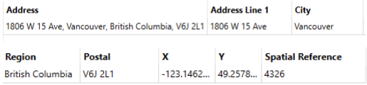

8. Run the Workspace and View the Output
Run the workspace with Feature Caching Enabled, then view the output in Visual Preview. You will have four outputs from the ArcGISOnlineFindAddressCandidate transformer:
  • Output: This provides the input address as a Single Line, the split of each attribute based on commas, the X and Y coordinates, and the spatial reference number.
  • <Rejected>: Input features are output via this port if the API calls fail. Any error message is stored in the fme_rejection_message attribute.
Final Workspace
