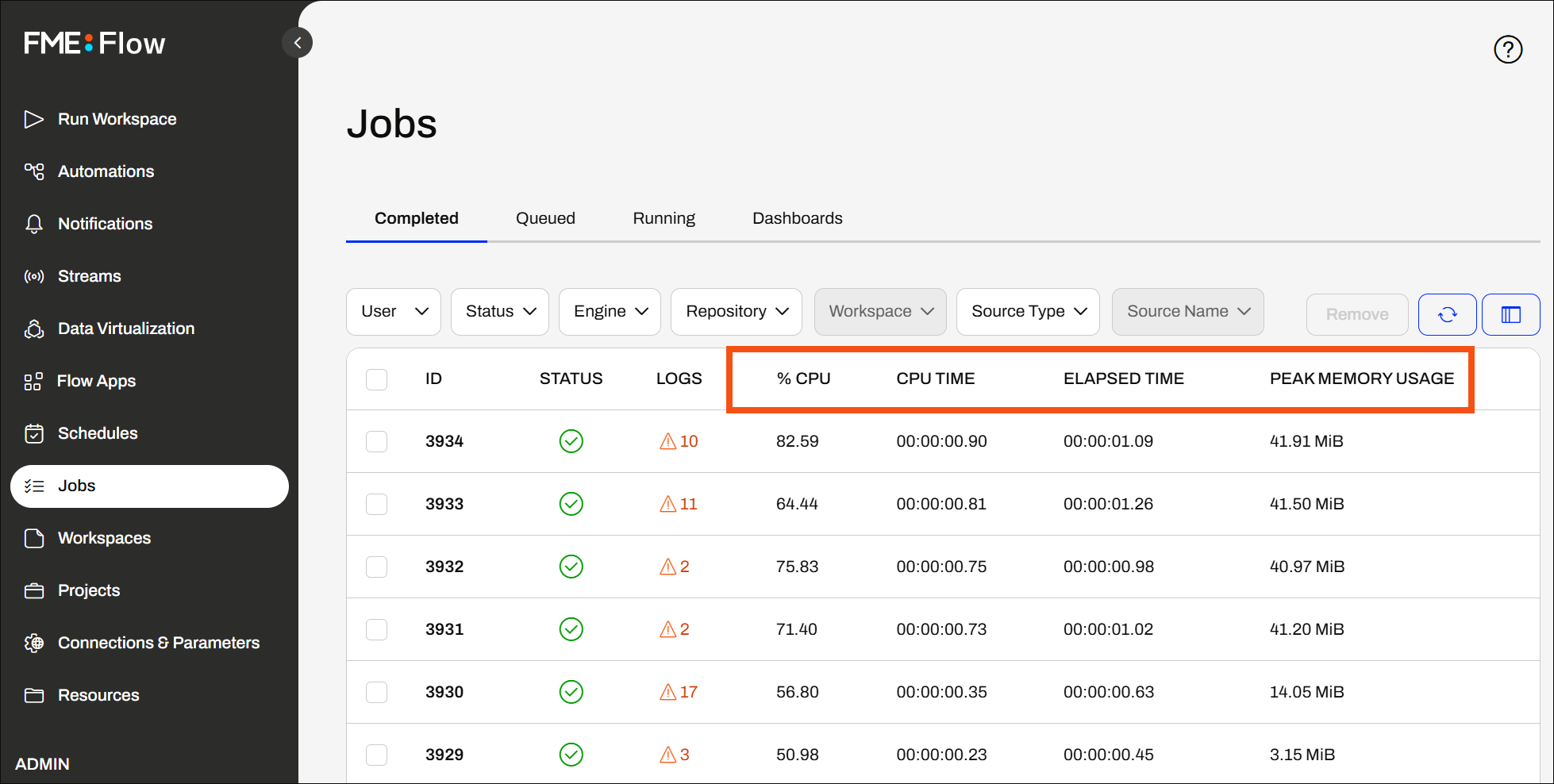

Statistics Available Per Job
- Elapsed Time: Total processing time for an FME Workspace (End Time - Start Time).
- CPU Time: Total CPU time for an FME Workspace (User time + System time).
CPU Time is time spent doing work on the CPU (as opposed to waiting for
input, disk, network, etc.).
CPU Time can be further subdivided between User (FME doing work) and System
(the
OS doing work on FME's behalf).
You may observe discrepancies between the CPU time recorded in an FME Form/Flow
job log and the time presented through Job Statistics (on the Jobs Completed
page or via the REST API). This is expected because the time reported by
Job
Statistics includes the additional start and end scripting that cannot be
captured
by FME Form/Flow logging processes.
- CPU Percent: The percentage of total processing time that is recorded as CPU time (CPU Time / Elapsed Time).
- Peak Memory Usage: The net memory usage is calculated as the peak memory used by an FME Engine process at the end of translation, subtracting the memory in use by the FME Engine before the translation begins.
Unlike in FME Form, the FME Flow Engine processes do not shut down after every job, and this can lead to unintentional memory leaks between translations. To account for this accumulation and return a more accurate value for peak memory consumption, the above calculation is performed. This can result in different values presented through Job Statistics (on the Jobs Completed page or via the REST API) and in the FME Form/Flow log files. The latter shows only the peak memory used by the FME Engine process at any time during the translation, without taking into consideration the memory already in use at the start.

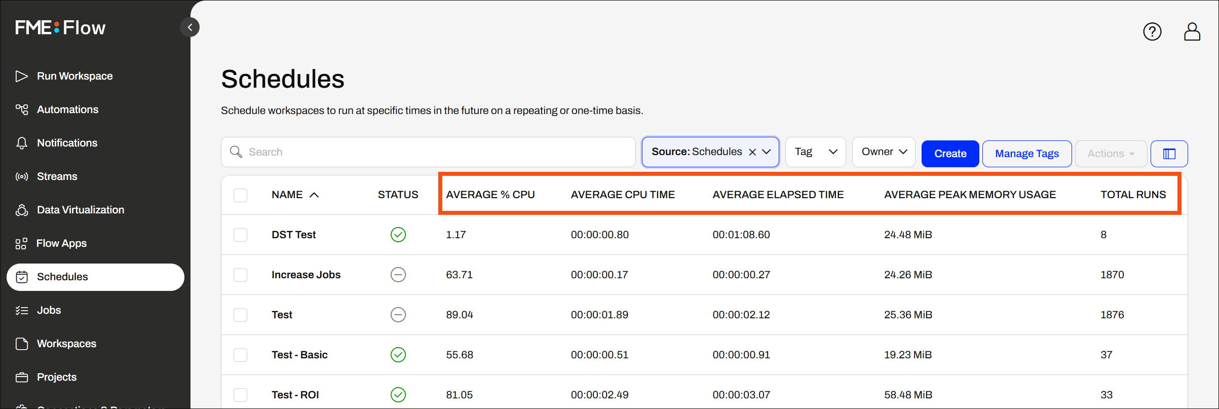

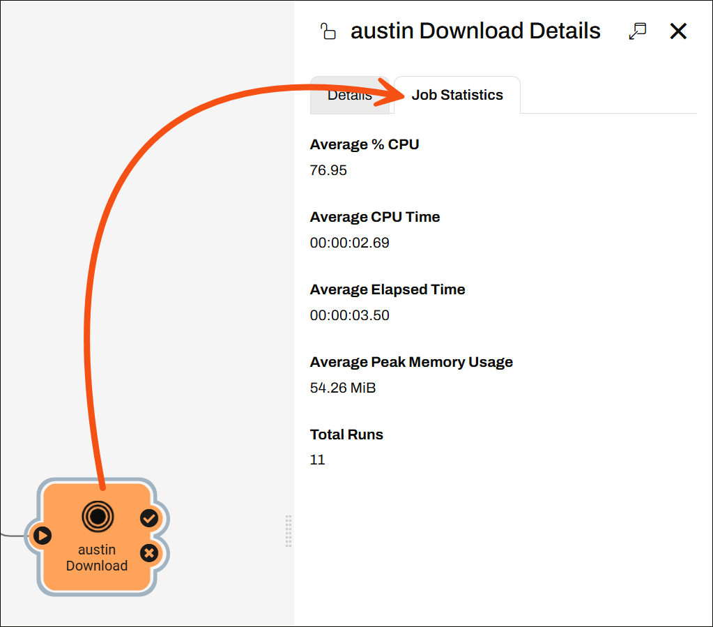

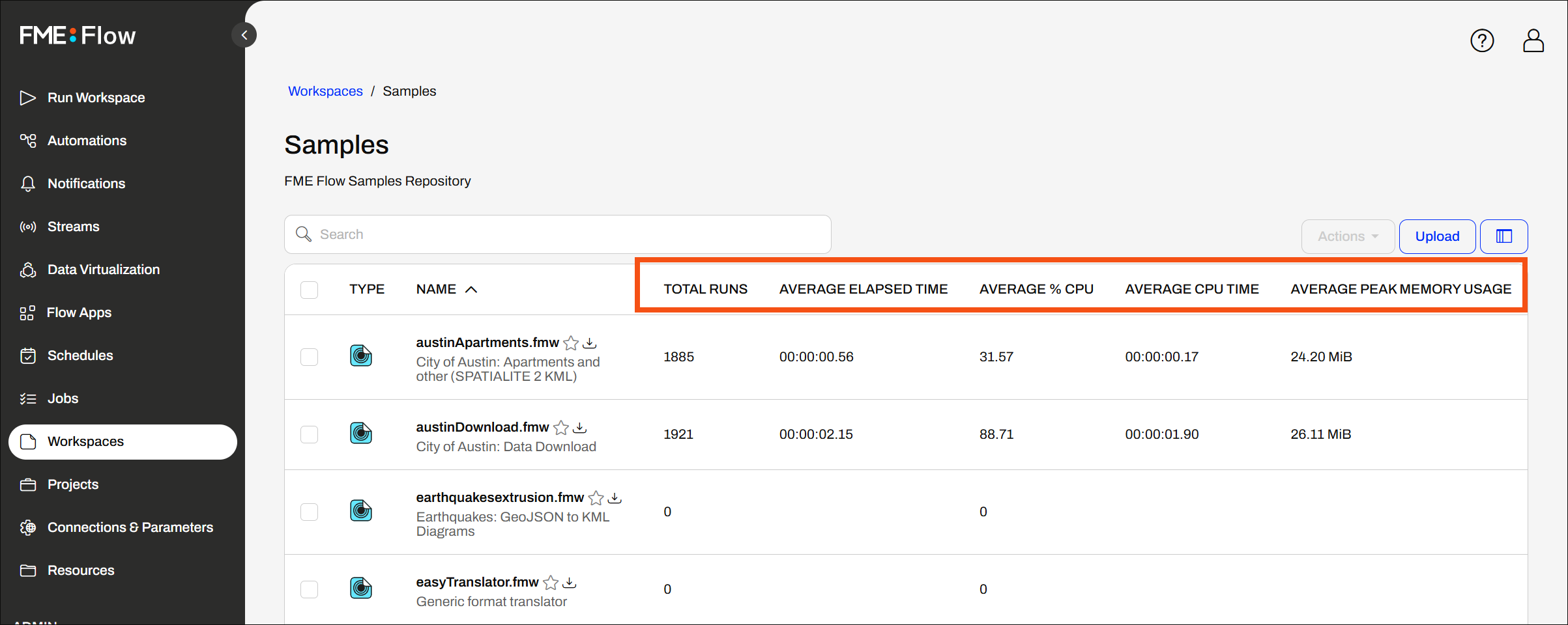

Statistics Available Per Workspace, Schedule, or Automation
- Total Runs: The number of times that the workspace has been run.
- Average Elapsed Time: The average elapsed time across all runs.
- Average CPU Time: The average CPU time across all invocations.
- Average CPU Percent: The average CPU percent across all invocations.
- Average Peak Memory Usage: The average amount of memory an FME Workspace required while it was processing. This is the average of the Peak Memory Usage above.
Workspaces
Schedules
Automations

All Workspaces by Repository
[GET] /fmeapiv4/repositories/<repo>/items -
Per Workspace
[GET] /fmeapiv4/repositories/<repo>/items/<item> -

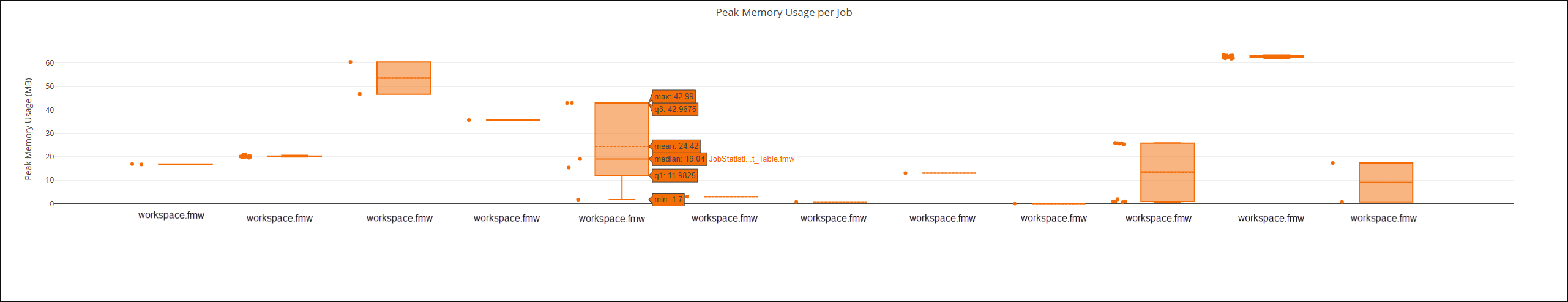

The following example uses a pre-made workspace that will be published to FME Flow to generate a dashboard. The dashboard will use a third-party tool, Plotly.js, to generate a Box Plot showing peak memory usage per job, along with information retrieved from the jobs/completed endpoint. If you want to build your own workspace from scratch, check out the Tips for Working with the FME REST API in FME Workbench article for some things to look at while getting started.

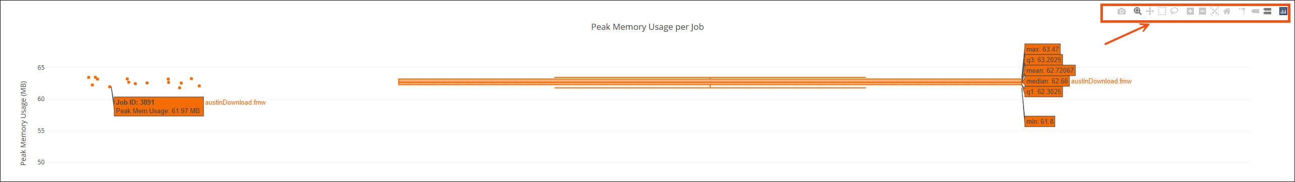

5. View Dashboard
Go to Jobs > Dashboards and from the Name select PeakMemoryUsage. This is the name of the HTML file that this workspace creates and can be modified in the Writer dataset in FME Workbench.
The third-party tool, Plotly, used to generate this workspace has an interactive interface. Explore your result by highlighting a section to zoom in, or hover over a box/point to get additional details about the job statistics.

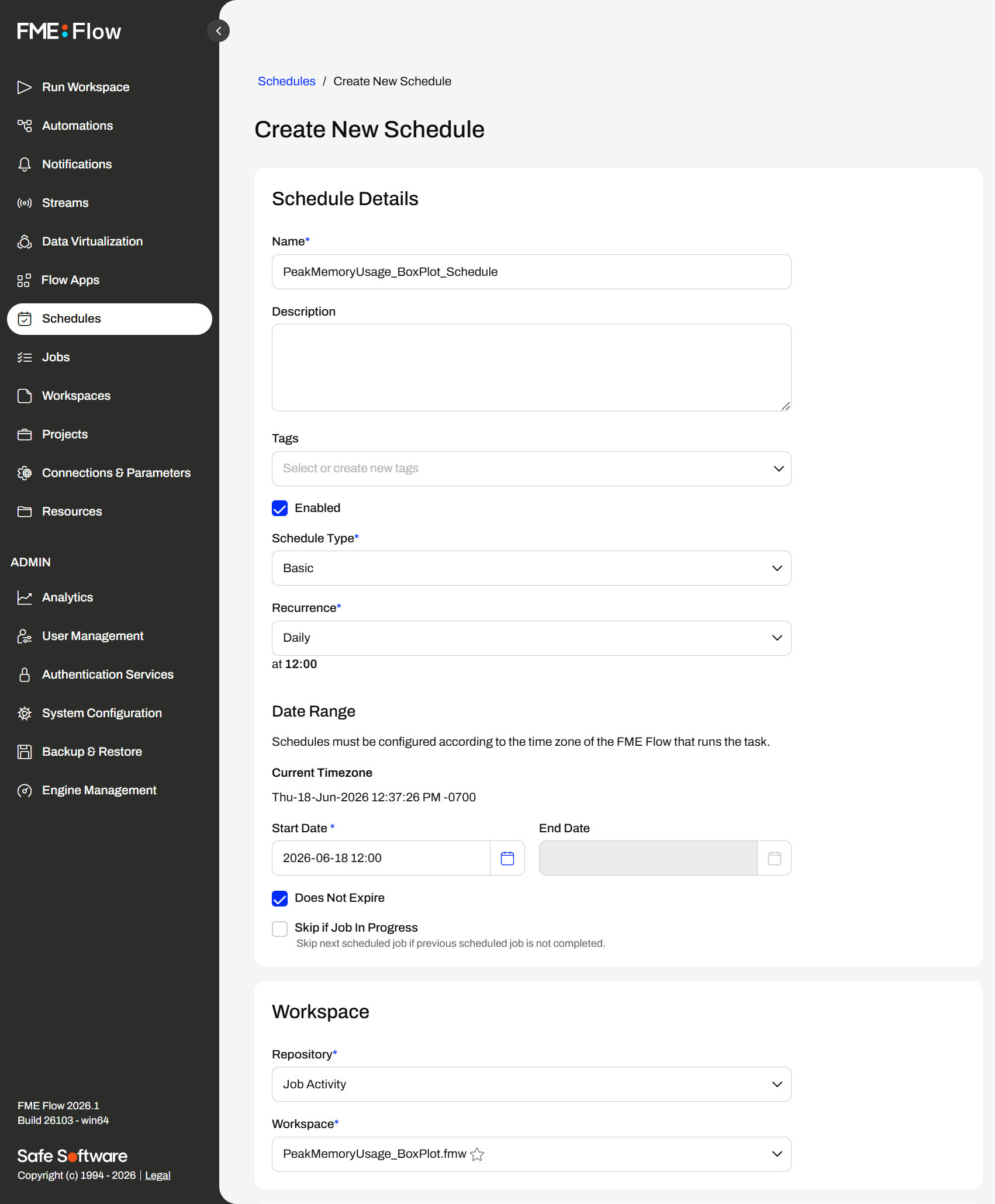

6. Configure Schedule
For the dashboard to remain up to date and show the latest statistics, the workspace must be run at a repeat interval. On FME Flow Web UI, go to Schedules > Create.
Specify the interval at which you want the workspace to run (i.e., how often the dashboard should be updated
Now the dashboard is all set up and will keep up-to-date!

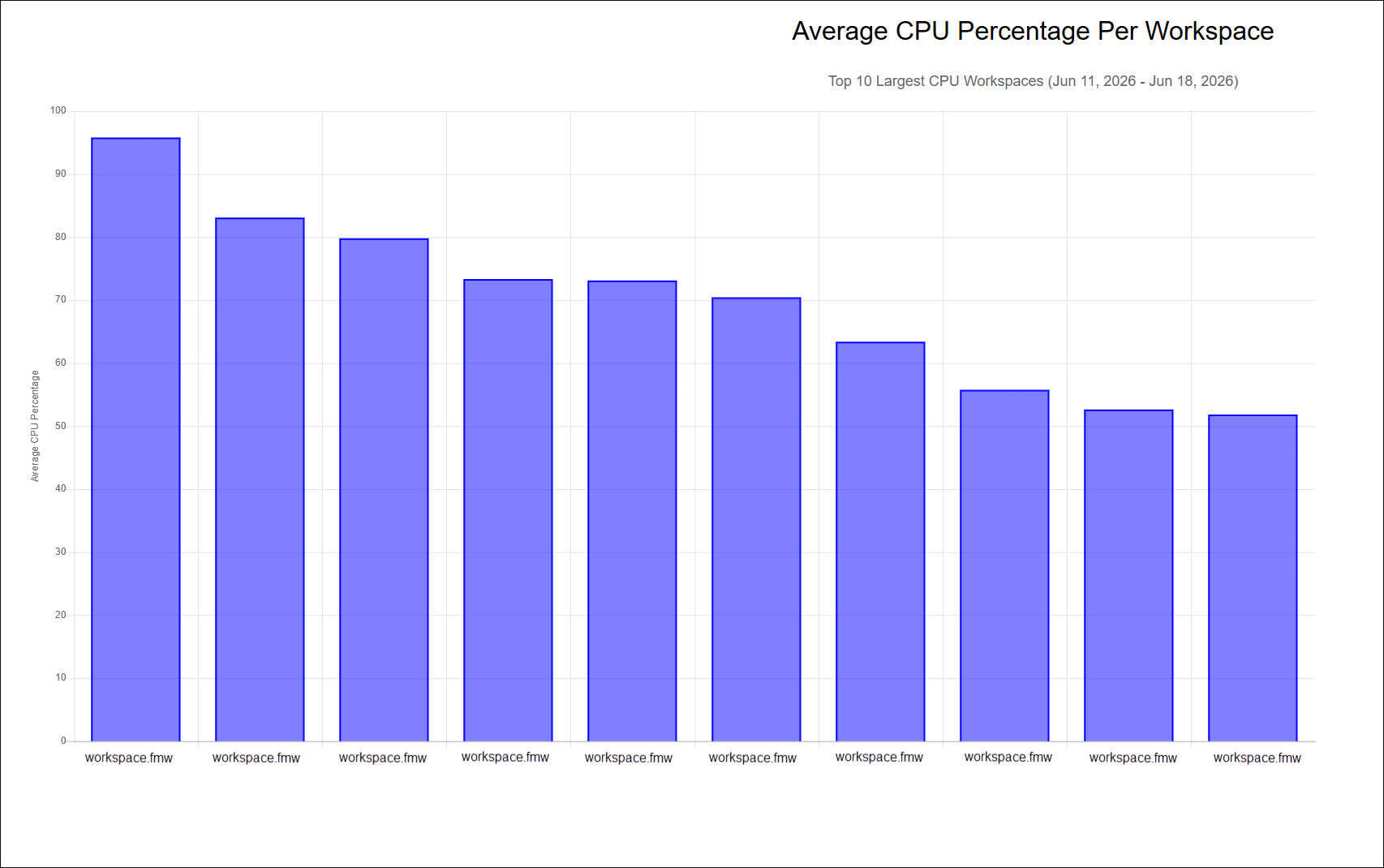

Average CPU Time/CPU % and Peak Memory Usage Per Workspace
A basic bar chart to cover each new statistic using the /jobs endpoint. Specify the number of workspaces to return and a date range (e.g., up to 7 days ago). Additionally, filter results for a single repository.

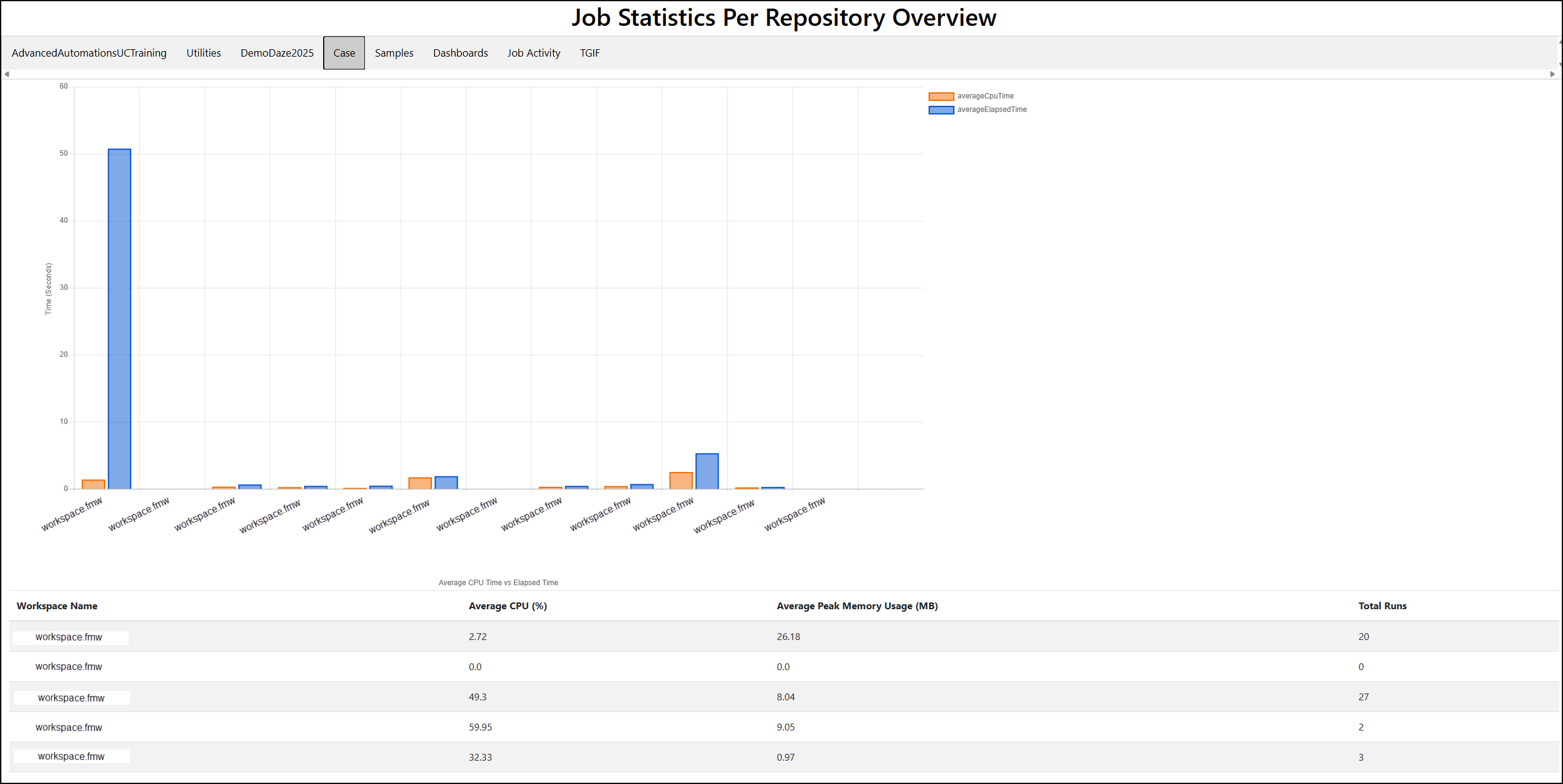

Job Statistics Per Repository Overview
Dashboard to display all the new job statistics using the /repositories/<repo>/items endpoint. A report has been created for each repository, divided into tabs. Each report contains a bar graph displaying the average CPU usage versus elapsed time per workspace, and underneath the table, it lists the CPU percentage and peak memory usage, as well as the number of job runs this information is based on. Optionally filter by Repository name. Results cover the period since the statistics were last reset.

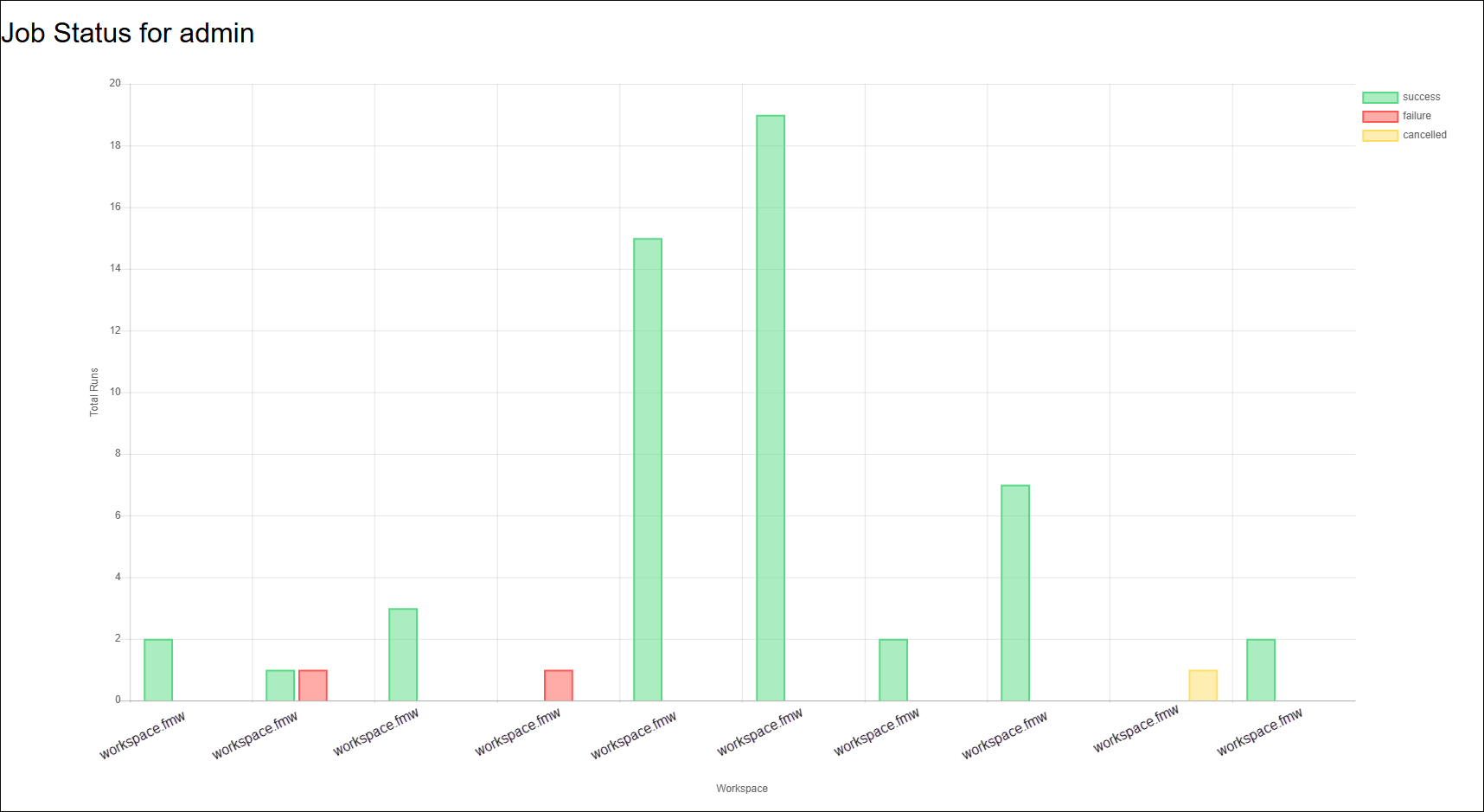

Workspace Status per User
As a user, you may want to perform a health check of all the jobs you own, or, as an administrator, you might like to see how active each of your FME Flow users is. This workspace utilizes the /jobs endpoint to generate a report of all workspaces belonging to a user, along with the number of times they’ve been run, sorted by job status.
