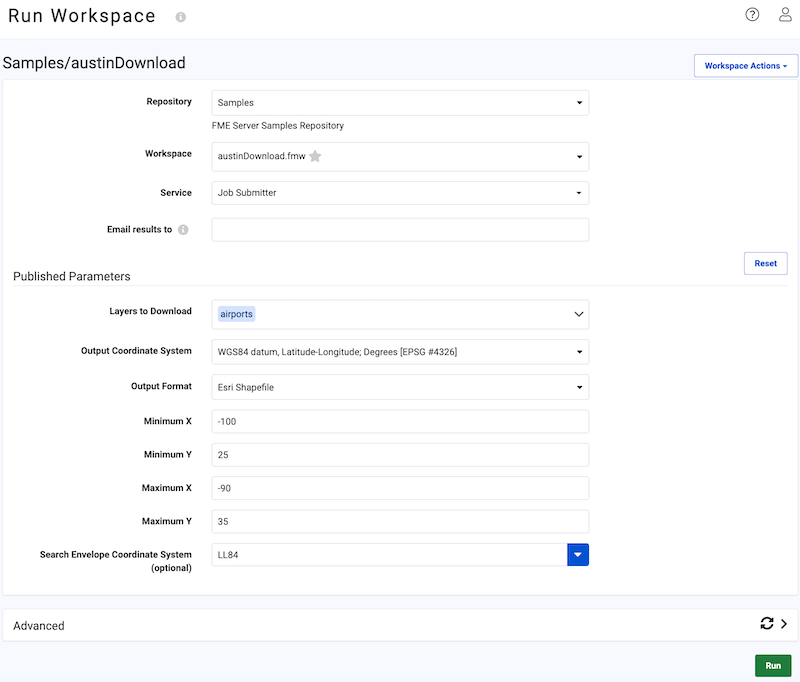

Whenever possible, review the workflow or data before building an API request. From the FME Flow Run Workspace page, select the “Samples” Repository and “austinDownloads.fmw” as the Workspace.

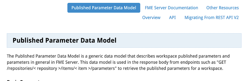

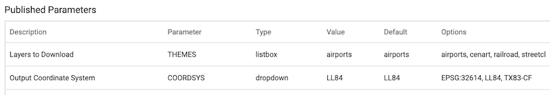

Published Parameters can be set inside the request body of any REST API job submission. For any workspace, there are a couple of ways to find which parameters are available to use.
From the Run Workspace page, scroll to find and expand the Advanced section. At the bottom of this section, you will find a table named Published Parameters. The Parameter column contains each available parameter. The Options column lists its accepted inputs. These values can be used with our API job requests.
Workspace published parameters may also be fetched by API request. Read more about how to retrieve and submit different types of published parameters in the Published Parameter Data Model tab of the FME Flow REST API Documentation.

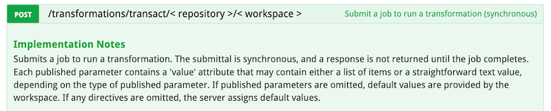

This section demonstrates the Transact request that runs a job synchronously on FME Flow. A Transact request instructs FME Flow to submit the job and only return a response upon the job’s completion. This means that you will wait until the translation is complete and the response message contains the job results.
The FME Flow REST API documentation contains more information about the Transact request in the Transformations section.

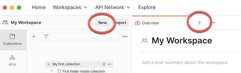

In Postman, a new request can be started by selecting New > HTTP Request or the plus sign ("+") button above the workspace window.

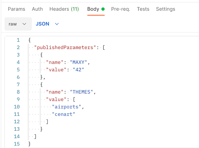

The body of every POST request contains data to send to FME Flow. The transact request body will contain the parameters and values of our workspace published in JSON.
Select and copy the following JSON body to use with our request:
  "publishedParameters": [
      "name": "MAXY",
      "value": "42"
      "name": "THEMES",
      "value": [
        "airports",
        "cenart"
In Postman, select the Body tab below the POST request. Select the raw option, change the type to JSON by clicking on the drop-down arrow, then paste the JSON in the space below.
 Notes on the request JSON: You may notice that our JSON does not specify all the parameters available for austinApartments.fmw. Whenever parameter values are not specified like this, FME Flow uses default values. Additionally, the name value refers to the workspace User Parameter name, not the label (as you might see from the Run Workspace page).

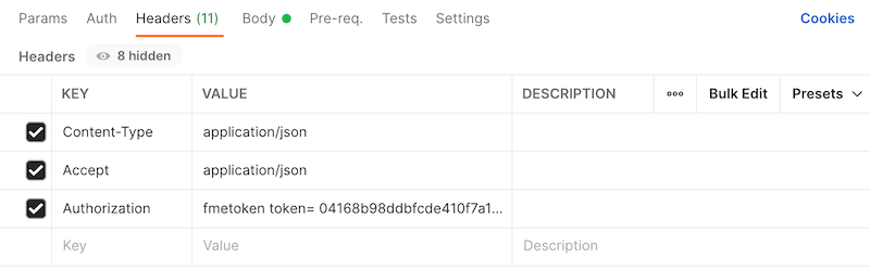

3. Create Headers
Headers allow us to tell FME Flow more information about our API request.
We can start by telling FME Flow that our Body content is in JSON format with a “Content-Type” header.
Next, we can ask FME Flow to return its response in JSON format with the “Accept” header.
Lastly, with an “Authorization” header, we can supply our unique token value. Replace <yourTOKEN> with your token value. If you do not already have a token, create one by following our FME Flow REST API Authorization tutorial or from the FME Flow Token Management page.
Select the Headers tab in Postman to add these headers and their values to this job request:
Key Value
Content-Type application/json
Accept application/json
Authorization fmetoken token= <yourTOKEN>
The Headers configuration should resemble the screenshot below. Note that Postman may include other default headers that can be ignored or hidden.

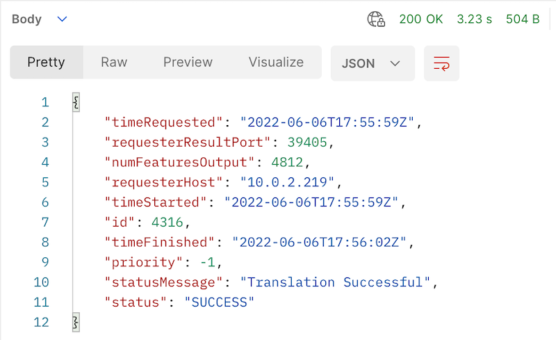

4. Run the Job by Transact REST API Request
In Postman, click Send. Wait 5-10 seconds while FME Flow receives the request and submits the job. Upon completion of the translation, Postman will display a response message from FME Flow.
The response from a Transact request contains information about the completed job: the job ID, status, how many features were handled, the time and duration of the request, and any messages. A synchronous request waits until the translation finishes before a response is returned so FME Flow can immediately share the job summary.

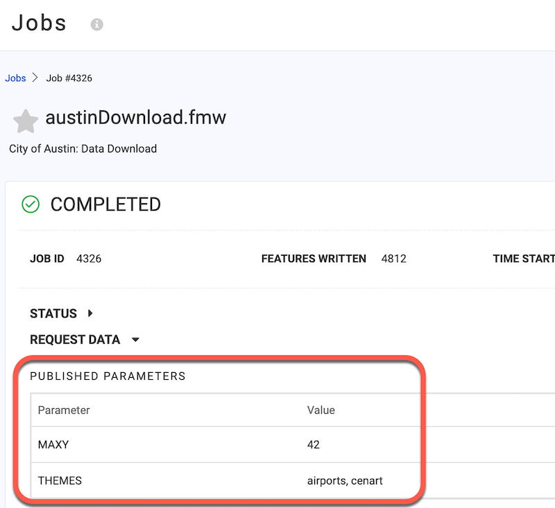

Log into FME Flow. From the left sidebar, navigate to the Jobs > Completed page. Find the recently run austinApartments.fmw job by matching the “id” number returned in the API response message.
JobHistory.pngNote: a job submitted by REST API will be listed as run by the User account that created the authentication token.
6. Review the Job Log
Click on the job to find more details.
An FME Flow job log contains a detailed description of the job translation. Inside, you can review information such as workspace parameters, the number of features read and written, which engine was used, error or warning messages, etc.
At the top of the page, the COMPLETED section contains high-level summary information. Expand Request Data to see the PUBLISHED PARAMETERS sent from our API request. These parameters should align with the JSON values supplied inside our request body:

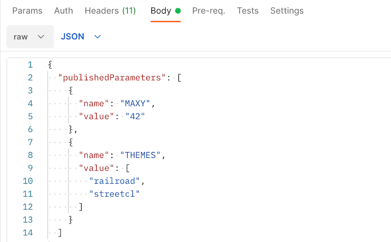

7. Send a Transact Request with Different Parameters

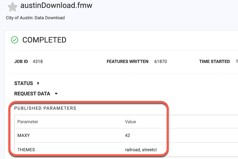

Back in Postman, select the Body tab. This time, we’re going to submit different values to the “THEMES” parameter. Update the value list to contain “railroad” and “streetcl” instead of “airports” and “cenart”.
PostmanNewParameters.pngTIP: Refer to the Introduction section, Review Workflow Options, to locate all the parameter values available to use with this workspace.
Click Send to submit the updated request. Wait 5-10 seconds to receive a successful response. Note the job’s “id” in the response message.
8. Find the Job in FME Flow

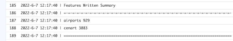

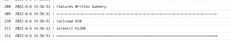

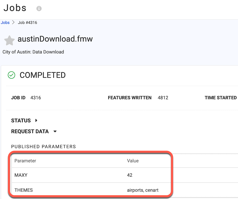

In FME Flow, navigate back to the Jobs > Completed page. Find the last submitted job by ID and select it to review the log.
Under REQUEST DATA, find the updated parameters.
Scroll down the log to find the Features Written Summary line to review the final output data, as determined by the "THEMES" parameter.
Congratulations! You’ve now sent a synchronous job request via the FME Flow Transact endpoint. Use this request to run jobs and receive the results in the same request.

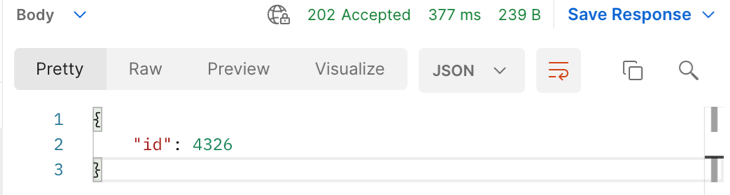

In Postman, click Send. Wait ~5 seconds while FME Flow receives the request and submits the job. Immediately after the job is received, Postman will display a response message from FME Flow.
The response from a Submit request only contains the job’s “ID”. Because an asynchronous request doesn’t wait until the translation finishes, there is no other information to report. However, the job ID can be used in subsequent API requests to retrieve the job results and status.
TIP: Take a moment to compare this response to the Transact (synchronous) response (Part 1, Step 4). How does it differ?

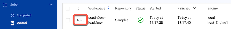

First, look for the recently run austinApartments.fmw job by matching the “id” returned in the API response message. However, since we’ve submitted an asynchronous request, the translation may still be in progress. If the job is not found on the Completed page, look for it on the Running or Queued pages.
Select the job to view the translation log. Expanding REQUEST DATA displays the parameters used in the Submit API request.
Scrolling further down the log, we can also view the total number of Features Written and other summary statistics.

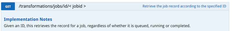

Now that we have a Job ID, we can use a Job ID REST API request to retrieve our job’s status and results.
Back in Postman, open a new tab. Copy this URL to use with our request:
GET http://<yourServerHost>/fmerest/v3/transformations/jobs/id/<JobID>
Paste the URL into the space provided in Postman. Update <yourServerHost> to your FME Flow’s domain name. Replace <JobId> with the “id” you received from the response in the previous call.
This time, leave the method as "GET". A GET method requests information from FME Flow.

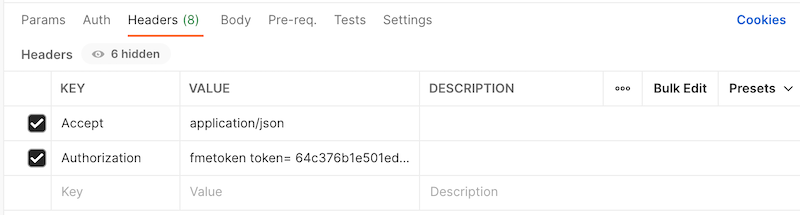

Select the Headers tab in Postman. When retrieving job information, we don't need to send any data with GET requests, eliminating the need for the Content-type Header.
Key Value
The Headers configuration should resemble the screenshot below. Remember to replace <yourTOKEN> with your actual token. Note that Postman may include other default headers that can be ignored or hidden.

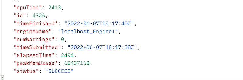

8. Retrieve Job Information by REST API Request
In Postman, click Send. Wait ~5 seconds while FME Flow receives the request and performs the query. When the request is finished, a response message returns information such as the translation summary, workspace details, user, and resources. Find the job id near the bottom of the response.
Congratulations! You’ve now sent a request via the FME Flow Job ID endpoint. Use this request to fetch translation statuses and results after a Submit request.

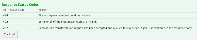

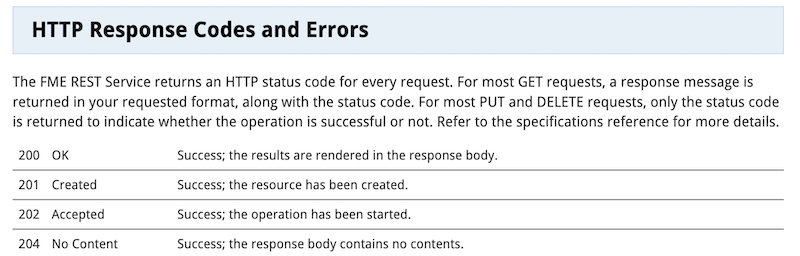

The FME Flow REST API returns an error when it rejects a request. The API response contains the error’s code and message.
For an overview of general error codes and their corresponding messages, review the HTTP Response Codes and Errors section of the FME Flow REST API documentation.
Error messages may also be specific to the request type. For example, a job request might be rejected when a published parameter is invalid. Select a request in the documentation to view its specific Response Status Codes:

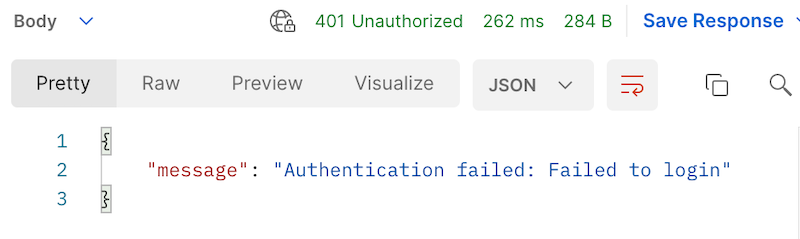

Authentication Errors
When a token is rejected, you’ll receive a “401 Unauthorized” error code.
Tokens are likely to be rejected when they expire or if permission is not given to access the workflow dependencies. For authentication options and troubleshooting, please review the Authorization section of the FME Flow REST API documentation or the Authorization section of the FME Flow REST API documentation.
