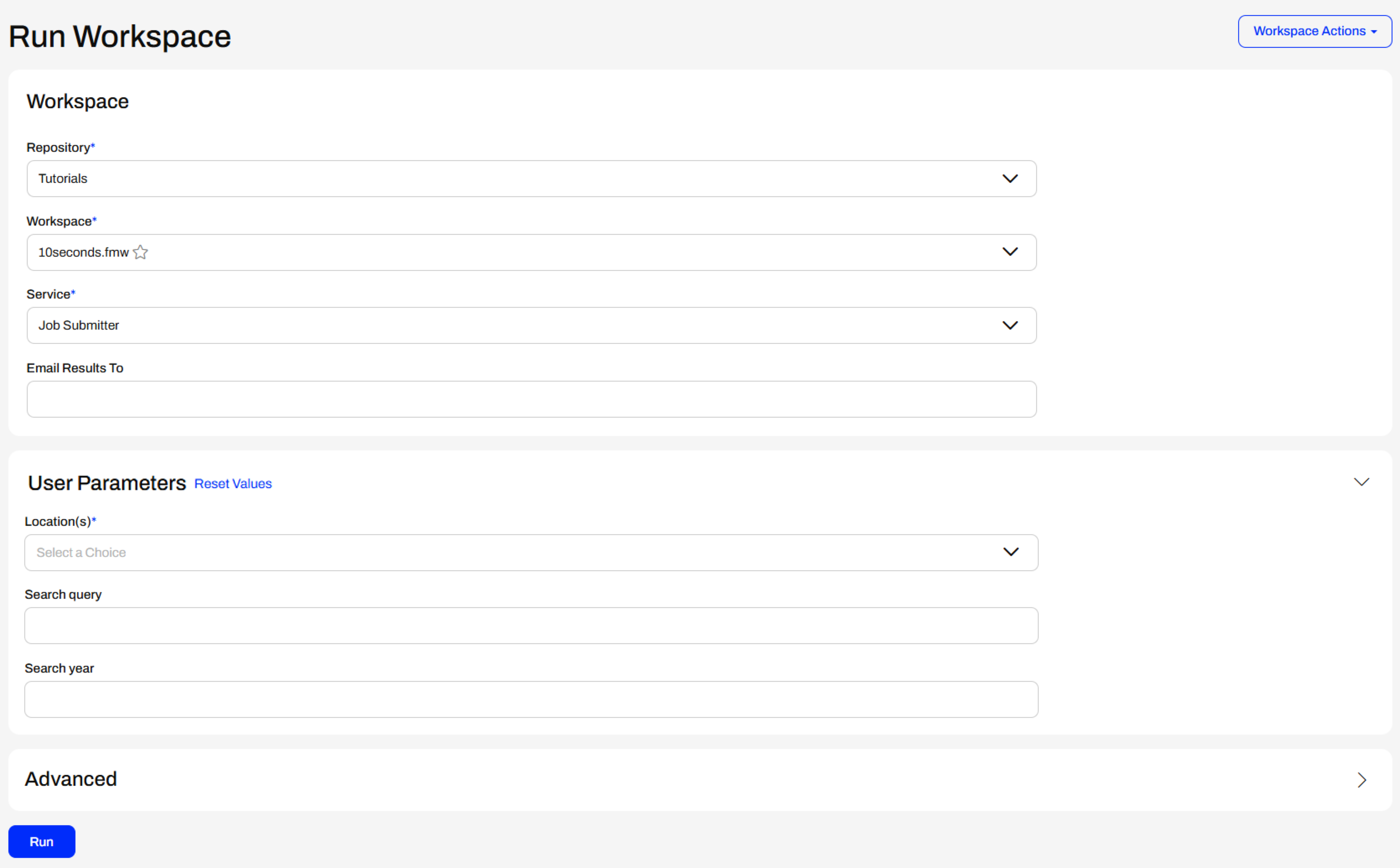

Download the workspace in the Attachments section and publish it to Flow with the Job Submitter service selected. Once published, open the Run Workspace page and review its Published Parameters. It is generally best practice to review data or parameters before making API requests.
Published Parameters are set in the request body of job submission API calls. There are a couple of ways to find which parameters are available.
The first is via the Advanced section at the bottom of the Run Workspace page. Here, you'll find a table named Published Parameters, with a Parameter column containing each available parameter. The Options column contains a parameter's accepted inputs (blank means anything is accepted), and Type contains its data type.
The second method is fetching published parameters via the endpoint GET /workspaces/{repository}/{workspace}/parameters. See the API documentation for more information on this endpoint.

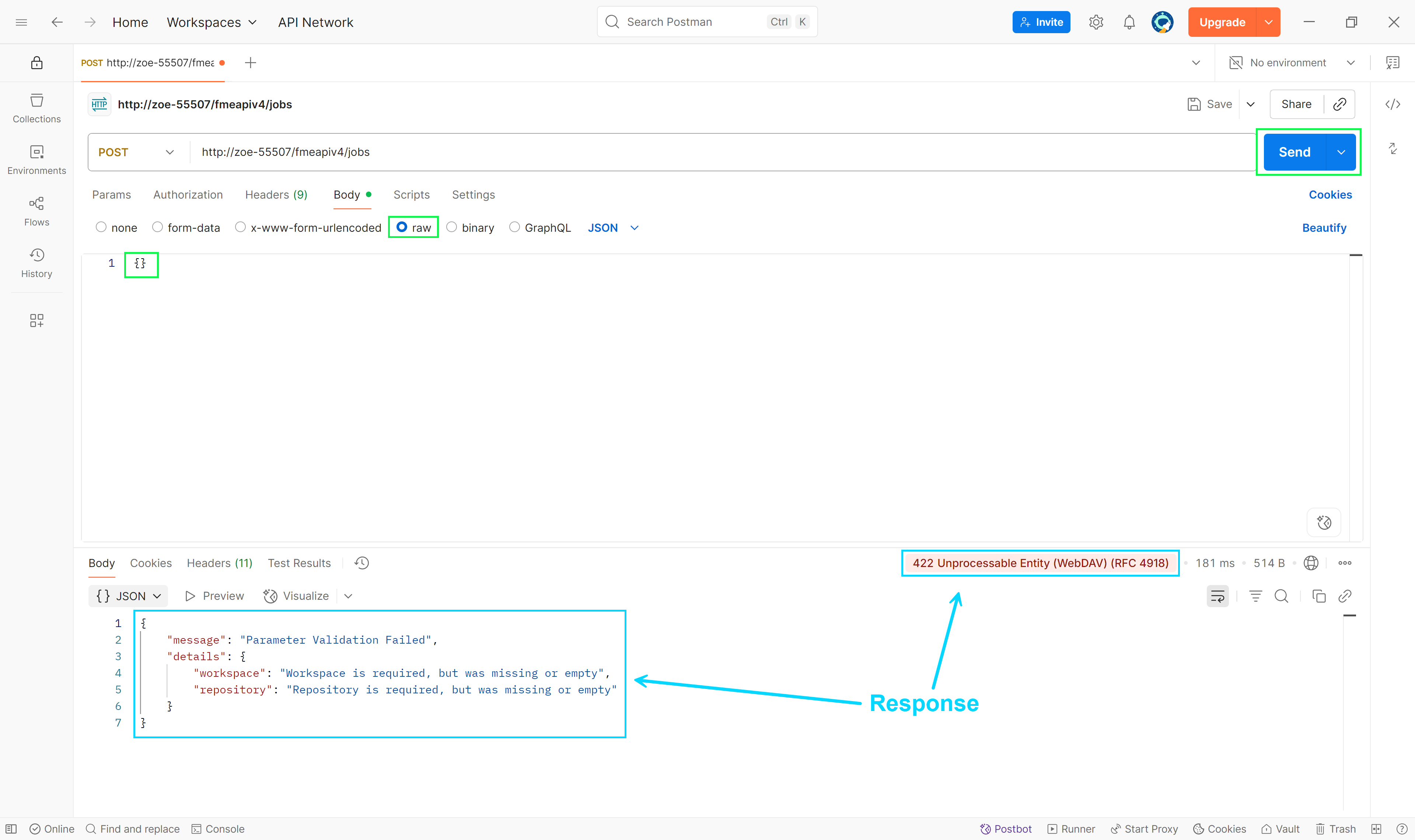

In the Body tab, set the type to "raw" and the content to "{}". Click Send and ensure you get the following response:
This response is expected as we could authenticate correctly, but included an invalid request body - empty JSON in this case.

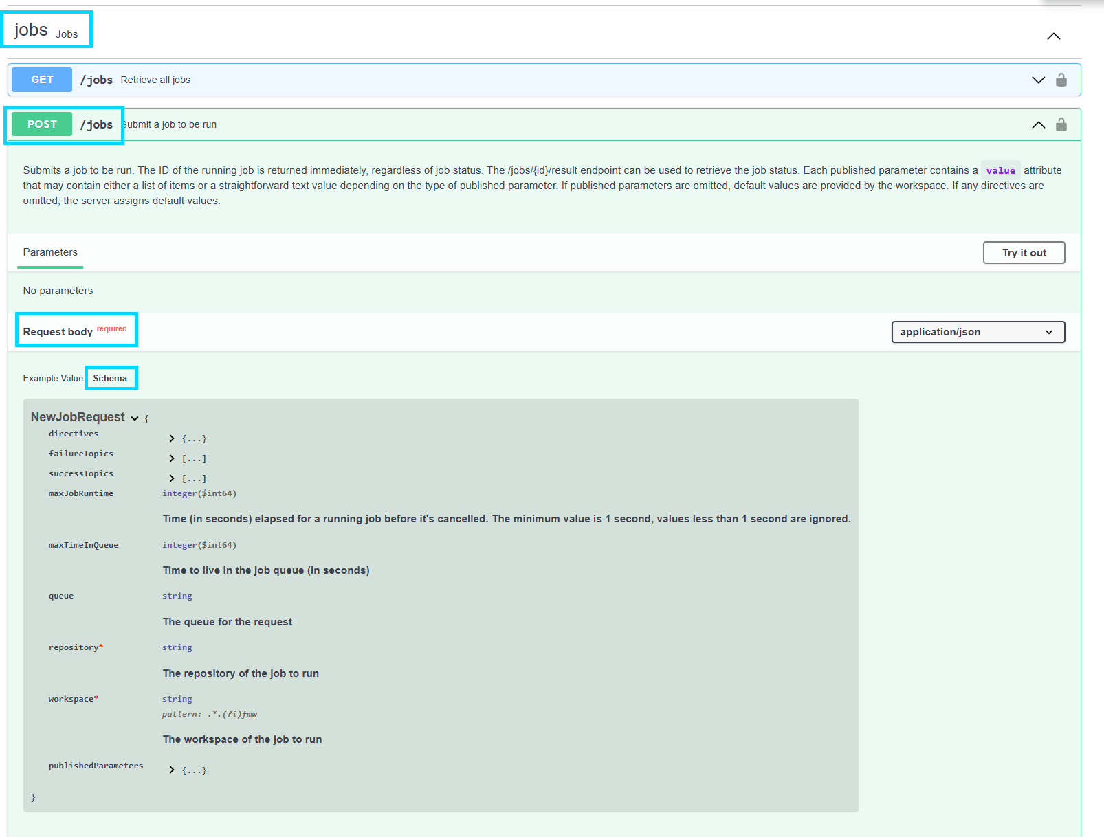

In the REST API docs, expand the GET /jobs endpoint (found under the Jobs section) and click Schema in the Request Body section:
From this Schema, we see only repository and workspace are necessary in the general case. The location published parameter is also necessary in our case, though, since it's set to required in the workspace. From this, we can construct the following request body, with the optional year parameter also being specified:

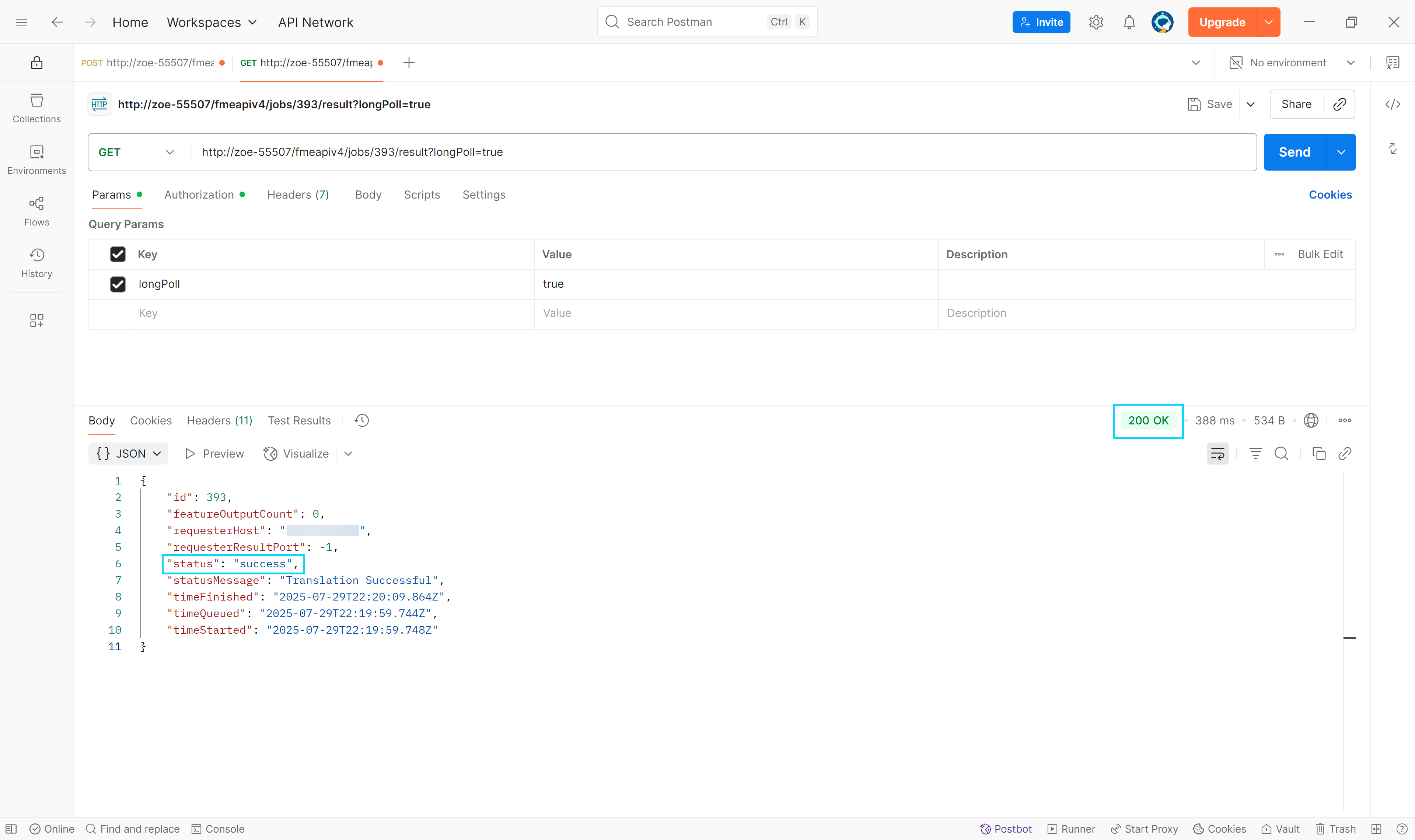

  • URL: <Flow Hostname>/fmeapiv4/jobs/{Job ID from previous response}/result?longPoll=true*
  • Method: GET
  • Headers: [same Authorization header and value as before]
  • Body: none
*When you enter this URL, Postman will populate the Query Params table automatically - this is expected.
Hit Send. You should see a response with the attribute "status" showing "success":
4. Observe Synchronous Behaviour.
With the two API requests open in different Postman tabs, submit another job (run the first request), copy the ID, paste it into the second request's URL, and fetch its information. You should see the request take a while to complete.

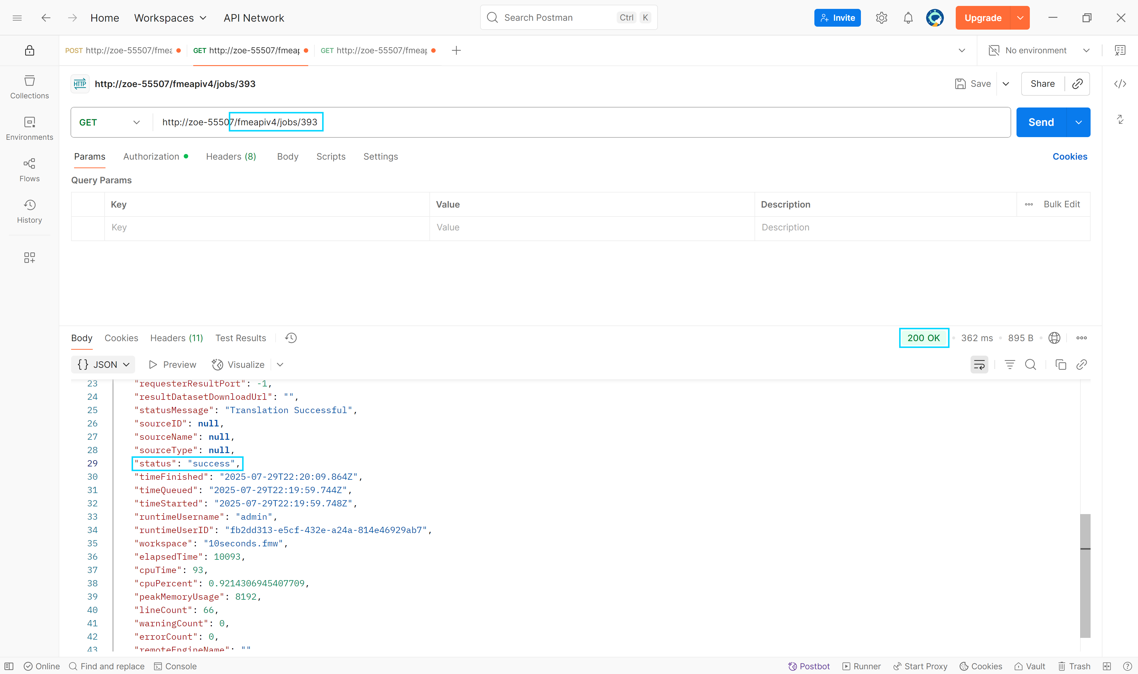

In the URL of the duplicated request, remove /result?longPoll=True, keeping everything up to and including the job ID. Hit send and verify you get a similar 200 response with a longer body, but with the same "status": "success" attribute:
2. Observe Asynchronous Behavior
Submit another job with the POST request, copy the ID, and submit the asynchronous GET request just created. You should see a similar response as before, but with "status": "running" instead:
Keep making the same request until the status changes to "complete". This should happen 15 seconds after the job is submitted.

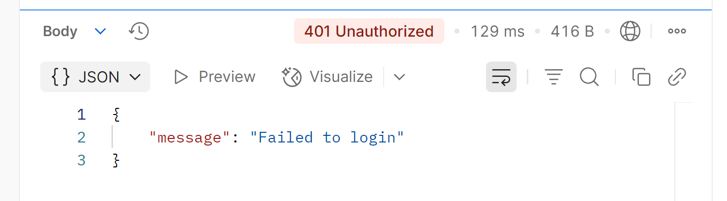

401 (Unauthorized) Errors
If a token is invalid, you’ll receive a 401 error code.
Tokens are likely to be rejected when they expire or if permission is not given to access the workspace or its dependencies. For authentication options and troubleshooting, please review the Authorization section of the FME Flow REST API documentation or the Authorization section of the FME Flow REST API documentation.
