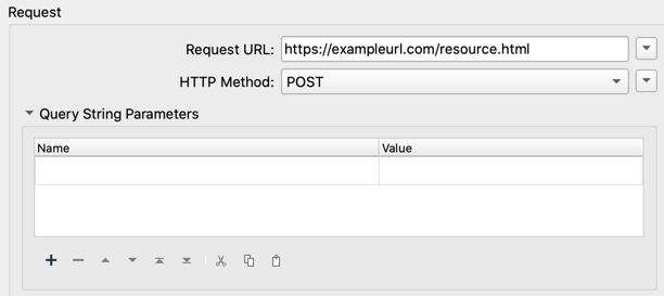

Locator and Method
The Request URL and Request Method indicate the resource location and request type to send to the server, respectively. Query string parameters that would otherwise be a part of the URL can be input using a table. The transformer applies any URL encoding to entries.

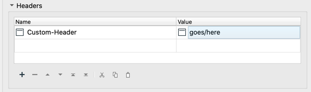

The Headers table can be used to create custom HTTP headers for a request. The Name column supplies a dropdown list of commonly used headers, or create your own by typing them in or using attributes.

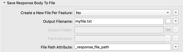

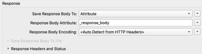

In Workbench, the returned response body can be saved to an attribute or file. Choosing File prompts more menu options for storing the message on your desktop. This is useful if you are downloading a file from the web service. This file can be read into the workspace after the HTTPCaller with a FeatureReader.
Saving the response body to an attribute stores the message to an attribute _response_body by default. It is viewable in Visual Preview and easily passed downstream to be used in the workflow. Use Response Body Encoding to specify the character encoding of the message. If unfilled, it’ll be detected from the headers returned with the HTTP response.

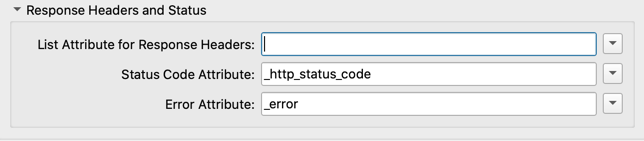

When a List Attribute is specified, returned headers will be stored with the feature, viewable in the Feature Information window or usable in the workflow.
Status codes returned with an HTTP response are saved to the _http_status_code attribute by default. For unsuccessful requests, the _error attribute contains a brief error message. This allows you to easily confirm successful requests or troubleshoot unexpected responses.

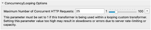

Concurrency
Concurrency Image
Making multiple HTTP requests can slow down a workspace that would otherwise be quite fast. The Maximum Number of Concurrent HTTP Requests allows a user to make multiple requests at the same time. Let’s say you are sending 100 requests to the HTTPCaller, if the concurrent requests are set to 25, FME will submit 25 requests at a time for a total of 4 times. If the concurrent requests are set to 1, FME will submit 1 request at a time for a total of 100 times. The more requests you submit at one time, the more useful this parameter will be!
HTTPCaller Concurrency
Please note that not all web services will support the concurrent requests and reject them. If there is an issue, set the concurrent requests to 1 or try rate-limiting as mentioned below.
If you are using an HTTPCaller in a custom transformer with a loop, set the concurrent requests to 1. Looping will not work with concurrent requests.

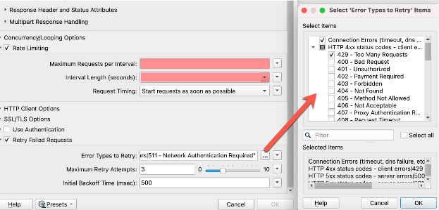

Rate Limiting
Rate limiting overview

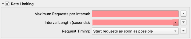

APIs often have rate limits. These will prevent a user from submitting too many transactions at one time, overwhelming the web service. In most cases, you will not need to use the rate-limiting option in the HTTPCaller. However, if you start to see errors such as 429- Too Many Requests error from the API, then you can use the rate-limiting feature.  Typically, your API documentation should outline rate limits that can be applied in the HTTPCaller.
Rate Limiting
Retry Failed Requests
Retries
Requests can automatically be retried by the HTTPCaller. This can be helpful if you encounter network issues from the web service you are connecting to. Network issues can arise unexpectedly; therefore, by retrying the requests, we can help mitigate these issues before they arise.
