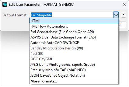

2. Open the Generic Writer Published Parameters

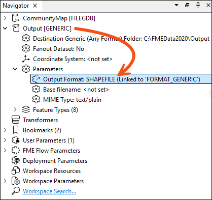

In the Navigator window, expand the Output [GENERIC] writer by clicking the arrow to the left, then expand Parameters.
Double-click the Output Format parameter to open the parameters. The user can currently select from any format in the formats gallery.
But that’s not what we want. The goal is to present the user with a list of four formats. So, we will create a new user parameter and define it accordingly.

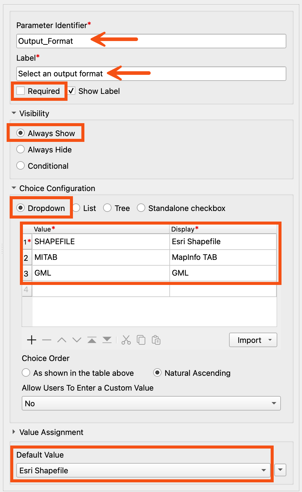

3. Create a New User Parameter

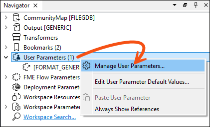

In the Navigator window, right-click on User Parameters and select Manage User Parameters.

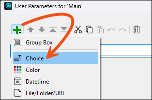

Click on the green plus sign, then select Choice.

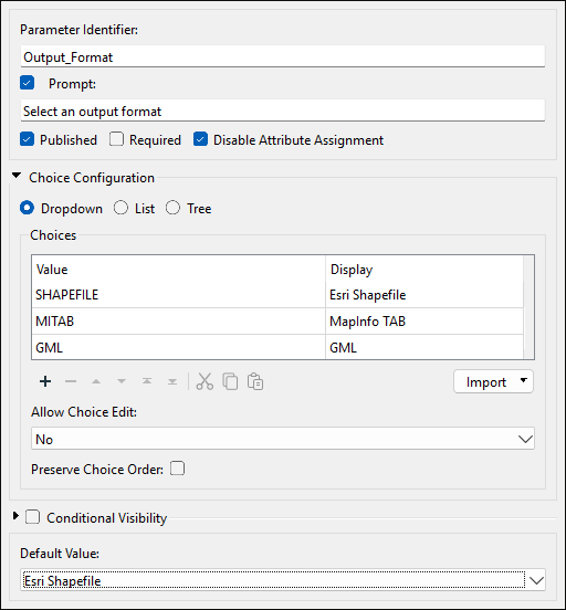

On the right-hand side, fill in the following parameter properties:
  • Parameter Identifier: Output_Format
  • Prompt: Select an output format
  • Published: Enabled
  • Required: Disabled
  • Disable Attribute Assignment: Enabled
  • Choice Configuration: Drop-down
  • Choices:
    • Value: SHAPEFILE
      • Display: Esri Shapefile
    • Value: MITAB
      • Display: MapInfo TAB
    • Value: GML
      • Display: GML
  • Default Value: Esri Shapefile

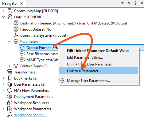

4. Link Published Parameter to Output Format Parameter

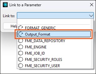

Our new Output_Format parameter appears under User Parameters > Published Parameters, but we still have to link it to the Generic Writer’s Output Format parameter. Locate the Output [GENERIC] Writer, and expand it with the arrow to view the Parameters, the first one being Output Format. Right-click on Output Format, select Link to a Parameter.
Select the new Output_Format parameter we just created.

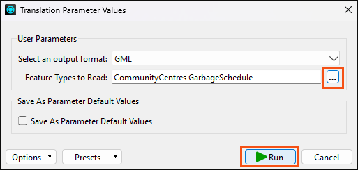

5. Run the Workspace
If you run the workspace immediately, it will use the default value and output an Esri Shapefile. We need to be prompted to change the parameters. Click the drop-down arrow next to Run, select Prompt for User Parameters, then click Run. You will be prompted to choose the output format. Notice that only those four formats are presented now in the drop-down list. Pick GML and click Run.

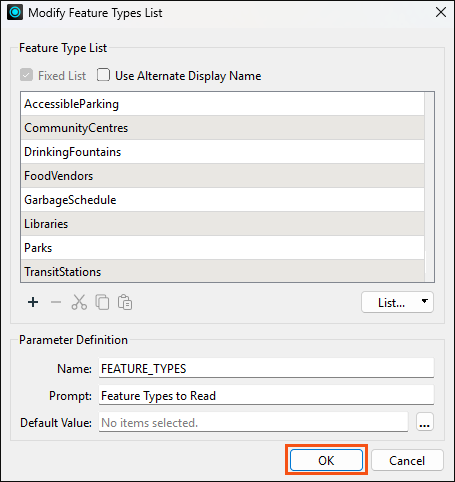

6. Publish Feature Types to Read Parameter
Now, let’s set up the workspace so that the user can choose which feature types to request.

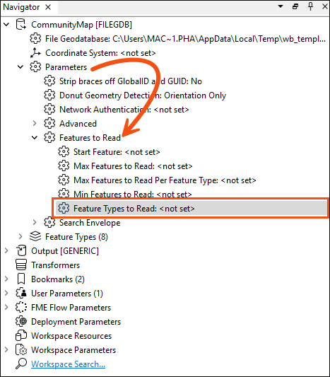

In the Navigator, expand the CommunityMap [FILEGDB] File Geodatabase Reader > Parameters > and double click Features to Read. This parameter lets the user decide which feature types to process when the workspace runs. Close the dialogue.
Right-click on Feature Types to Read parameter and select Create User Parameter. Use the defaults for the definition, and click OK. Confirm the new parameter appears under Published Parameters.
7. Run Workspace Again
Ensure Prompt for User Parameters is still enabled, then rerun the workspace using Run > Rerun Entire Workspace.
Notice that this time, there are two parameters to set. Set the parameters to whatever you wish, then click Run. Confirm that the workspace runs correctly.

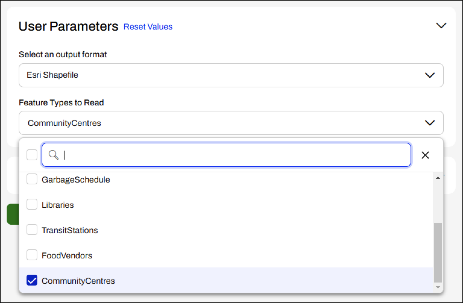

10. Run Workspace

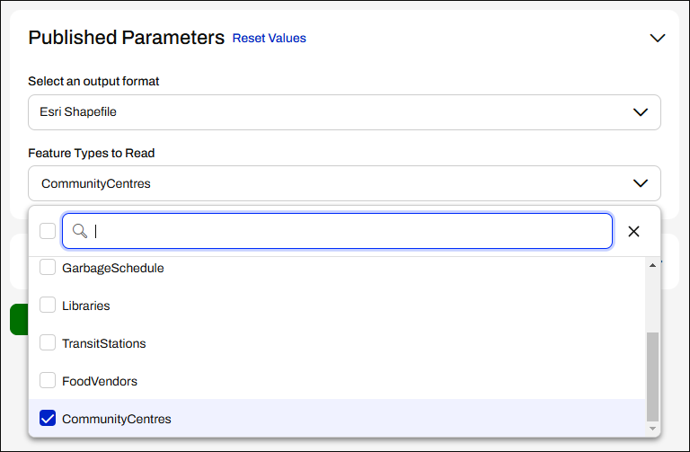

On the side menu bar in FME Flow, click on Run Workspace. On the Run Workspace page, select Flow Tutorial for the Repository and the CommunityMapping workspace. Select Data Download for the Service.
Review the Published Parameters. The two parameters that were set up and just tested in FME Workbench are shown. Just as before, select an output format, and select one or more feature types.
Once you have selected the parameters, click Run.
10. View the Results
The Data Download service presents a URL link to the translation results in a zip file. A quick inspection of the contents of the zip file confirms that the results are as expected.
