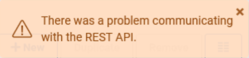

Are you seeing this error in the FME Flow UI? “There was a problem communicating with the REST API”
If so, view the developer tools to see if there are any errors. To do this, follow the steps below:
  • Right-click and select Inspect
  • In the side panel, go to the Network Tab
  • Refresh the page
  • See if there are any errors
image.pngIf you do create a support case, please download the HAR file and attach it to the case.
