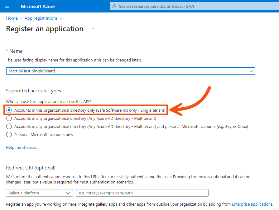

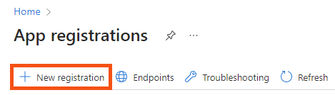

Add a new registration.
New App Registration
Choose ‘Accounts in this organizational directory only (Single tenant)’. Leave the Redirect URI blank for now, we will update this in a later step. Click Register.
Single Tenant Registration

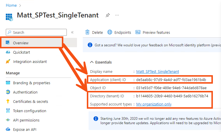

2. Obtain the Client ID and Tenant ID
On the new app’s Overview page, take note of the Application (client) ID and the Directory (tenant) ID - these will be used to configure the web service later.
Note: you can confirm that your app is a single tenant app if the value of ‘Supported account types’ is ‘My organization only’.
Client and Tenant IDs

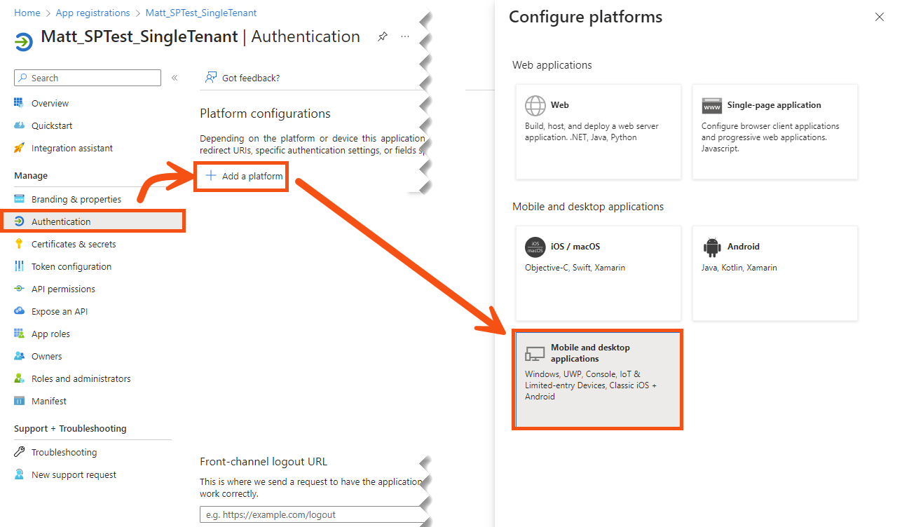

Click Authentication and then 'Add a platform'. Choose Mobile and desktop applications.
Add Mobile and Desktop Platform

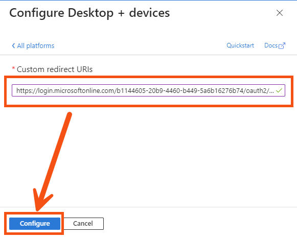

For the Custom redirect URIs, enter:
https://login.microsoftonline.com/[TENANT ID]/oauth2/nativeclient
Replace [TENANT ID] with the value of Directory (tenant) ID from the app registration overview.
Click Configure.
Configure redirect URI

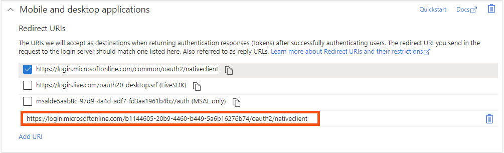

You should now see Mobile and desktop applications with the redirect URI added in the previous step enabled, as well as additional default URIs added by Azure.
Enabled Redirect URI

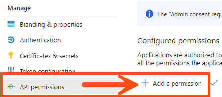

Click API permissions and then 'Add a permission'.
Add API Permission

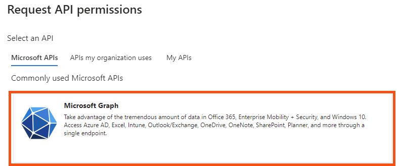

Choose Microsoft Graph from Request API permissions.
Graph API Permissions

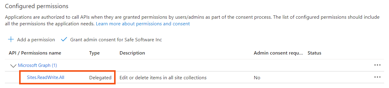

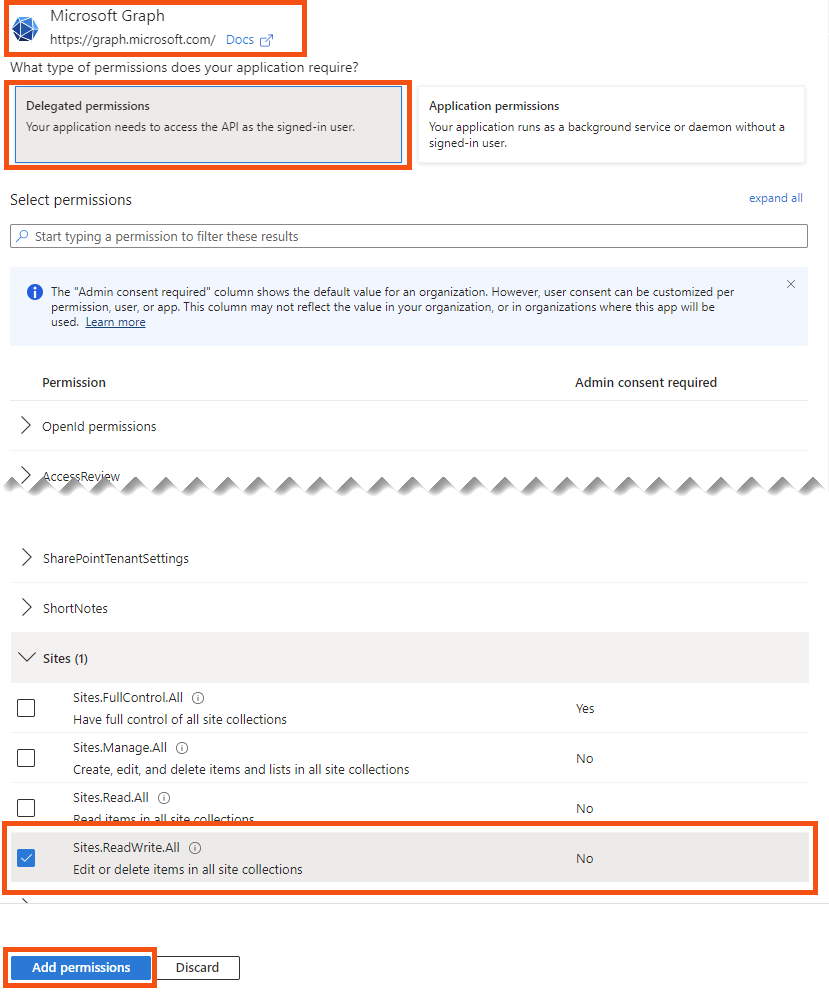

Click Delegated permissions. Search for and then check off Sites.ReadWrite.All. Click Add Permissions.
Configure Graph API Permissions
Once added, you should see the Sites.ReadWrite.All permission in the list of Configured permissions.
Your single tenant Azure app registration is complete.
If you wish to assign more restrictive permissions, you can use a combination of Sites.Read.All and Files.ReadWrite.All instead of Sites.ReadWrite.All. Other permissions may also work, but you may be required to perform additional configuration and testing outside the scope of this article.

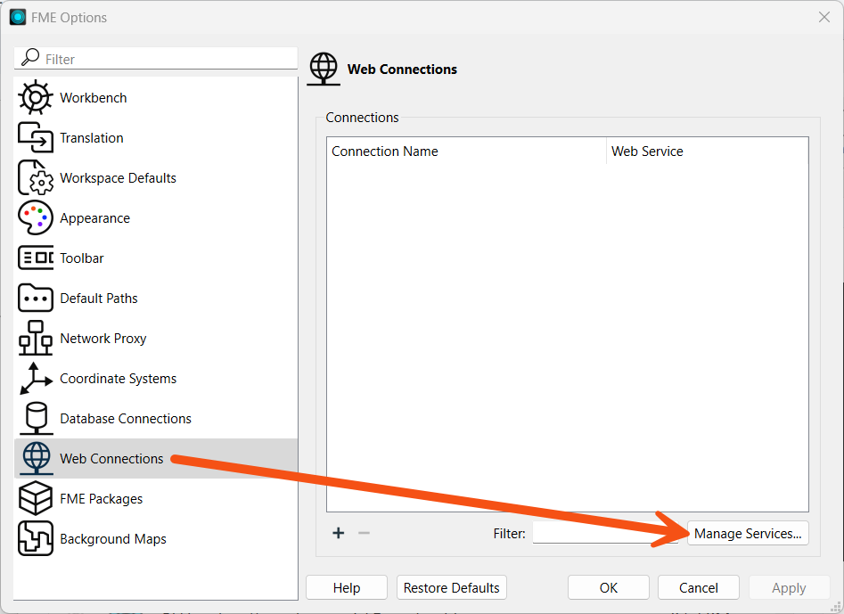

1. Open Web Services
In FME Form, go to Tools > FME Options > Web Connections > Manage Services.

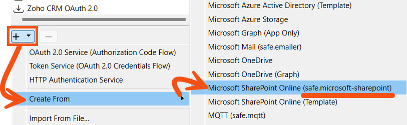

2. Create a New Web Service
On the Manage Web Services screen, click the plus sign below the list of web services and then Create From > Microsoft SharePoint Online (safe.microsoft-sharepoint).
Do not choose Microsoft SharePoint Online (Template). It is for the SharePoint List Reader/Writer and will not work with the SharePointOnlineConnector.
In FME Form 2022 and earlier, you will not be able to create a new web service from the Microsoft SharePoint Online (safe.microsoft-sharepoint) template. Select the Microsoft SharePoint Online (safe.microsoft-sharepoint) web service from the list and edit its parameters following the instructions in the next step. The web service name is not editable.

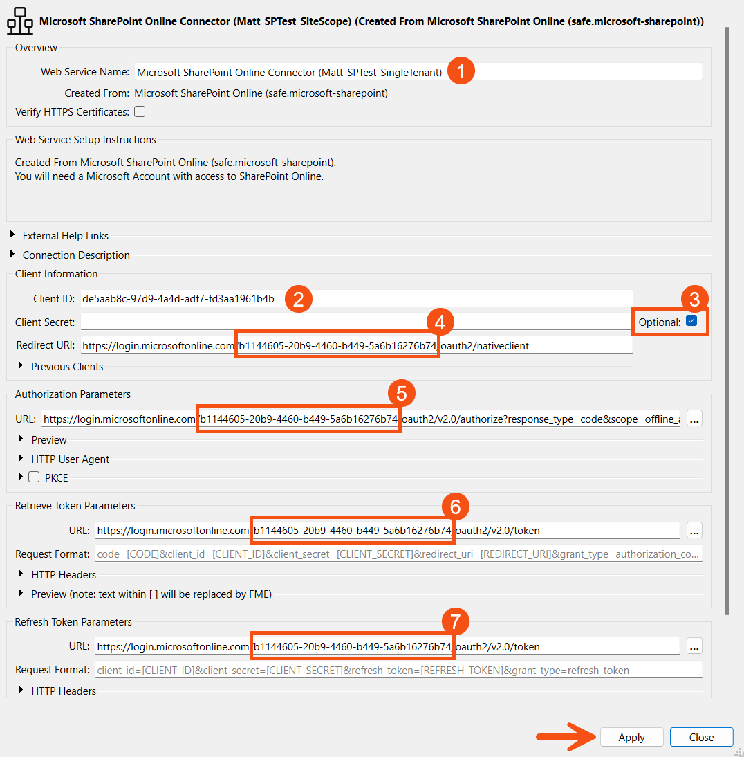

3. Populate the Web Service
Single Tenant applications cannot use the /common/ endpoints. The ‘/common/’ endpoints are for multitenant Azure app registrations. Replace all instances of /common/ with your Tenant ID.
  1. Web Service Name: provide a unique name. It’s recommended to include the transformer that this web service will be used for and the Azure app registration name, so that you can cross-reference it.
  2. Client ID: the Application (client) ID from the SharePoint single tenant app
  3. Optional: leave this checked - the client secret should only be added in FME Flow
  4. Redirect URI: https://login.microsoftonline.com/[TENANT ID]/oauth2/nativeclient
  5. Authorization Parameters URL: replace common with your Tenant ID
  6. Retrieve Token Parameters URL: Replace common with your Tenant ID
  7. Refresh Token Parameters URL: Replace common with your Tenant ID
It’s also important to ensure that the web service’s Redirect URI value matches the custom redirect URI that was applied to the Azure registered application in Create the Azure App Registration step 3. If these two values do not match, the web service will not function properly.
Click Apply.

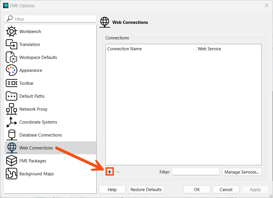

5. Create the Web Connection

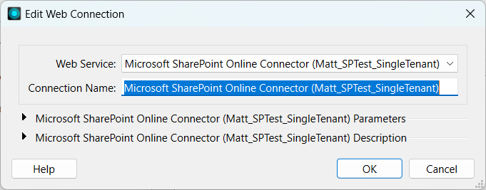

From Web Connections, click the plus (+) button to add a new connection.
Choose the web service you created and give the connection a unique name. Click OK.
You will be prompted again to authenticate with Microsoft.
After successfully authenticating, your web connection and service are ready to use in FME Form. Note that the Microsoft account you authenticate with must have access to the SharePoint resources you want to connect to in FME.
