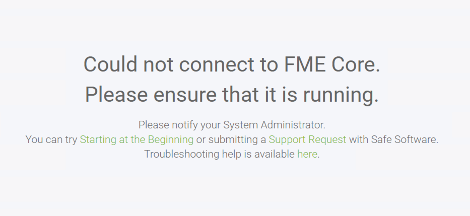

FME Flow may fail to load completely in the web browser when using AnyDesk Virtual Machine after installation or a restart. Symptoms include seeing only the "Backup and Restore" page, or the following browser errors:
"Error communicating with FME Flow host."
"FME Flow could not connect to FME Core."
